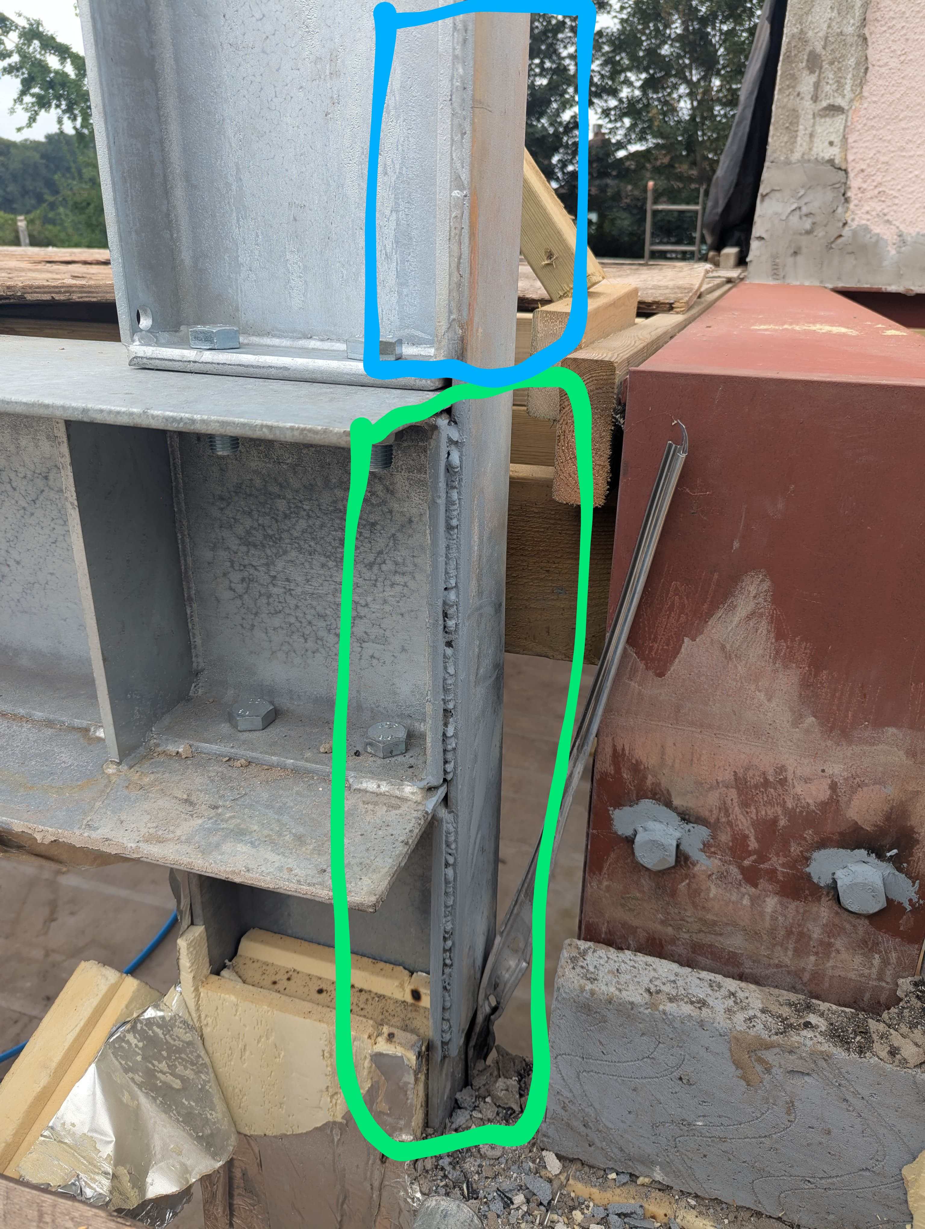

Ay8452 Posted August 19, 2025 Posted August 19, 2025 Hi guys, Can anyone advise if the quality of welding here is acceptable? The blue section was neatly done off site and supplied like this. The Green section was done on site but it really doesn't look right to me. Building inspector coming tomorrow. This is a structural element in a two story extension for a vertical steel column. Thanks guys

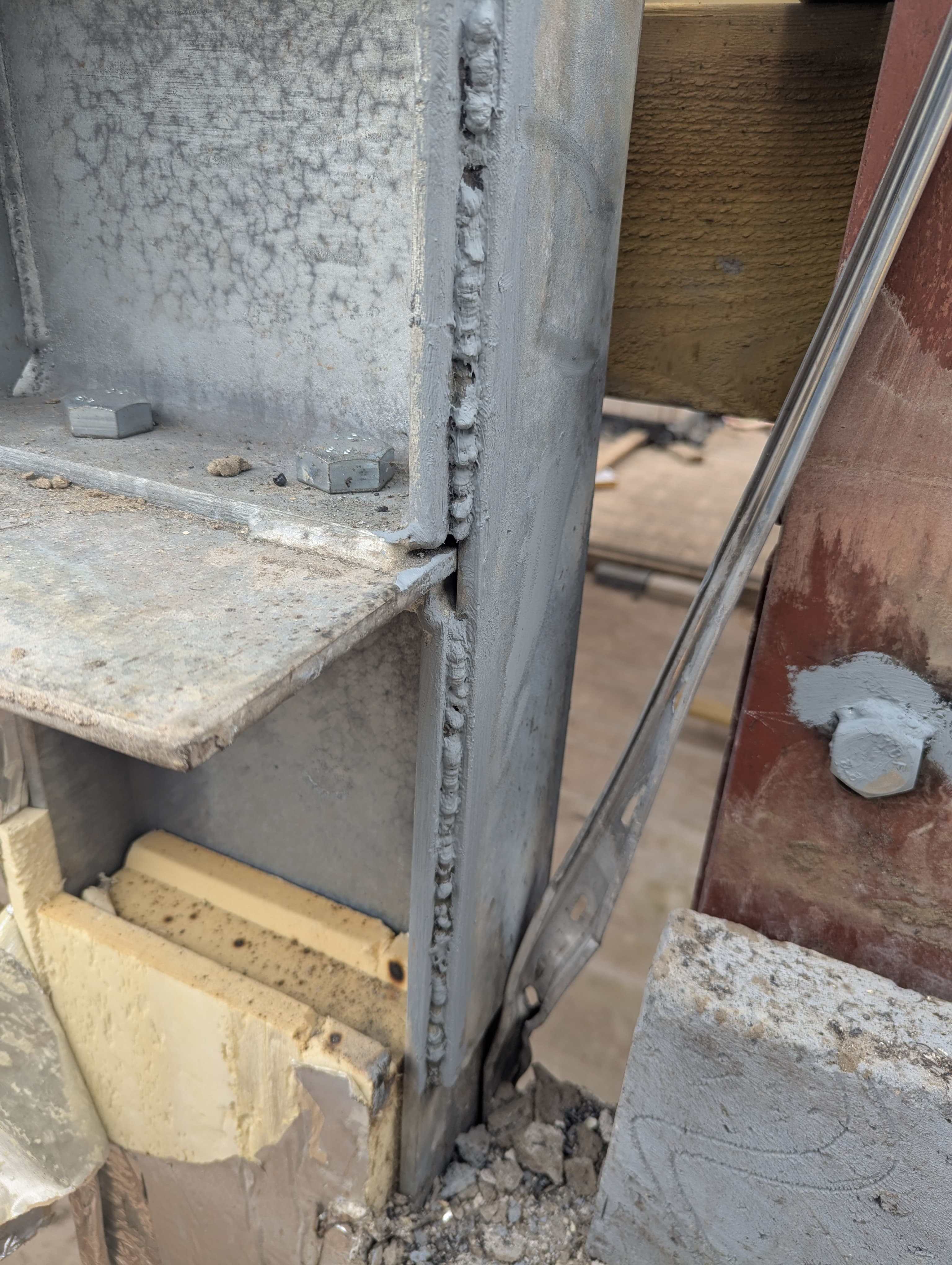

JohnMo Posted August 19, 2025 Posted August 19, 2025 Short answer is no. Longer answer is the weld should penetrate both materials. The weld you are focussing is basically sitting on the base material, so offers zero strength. Look at the other weld near the bolt, looks about 50mm long, that is what the full seam weld should look like. It needs to ground out and the weld be done correctly with a correct sized welder and filler material.
Roger440 Posted August 19, 2025 Posted August 19, 2025 What JohnMo said. Looks like someone had a go with a baby mig. Hopeless.
Nickfromwales Posted August 19, 2025 Posted August 19, 2025 This is what on-site welding with a decent size MIG can produce, in the hands of a seasoned, expert, fabricator and welder. What you have is just a pile of heated wire laying on cold metal that the unit didn’t have the power to heat and fuse it all together. Almost looks like a crap stick weld from an arc welder, but the guy we had on site made the stick welds exceptionally good too, so this one’s got zero excuse…..they just cannot weld. Ask for it to be all taken apart, ground out, and for it to be welded again properly. Utter shite. 👎👎👎👎👎 1

Mr Punter Posted August 19, 2025 Posted August 19, 2025 Well spotted. Not terrible but you are paying for a proper job. Tell them to redo it. No fun onsite welding but if they priced for it they should do it properly.

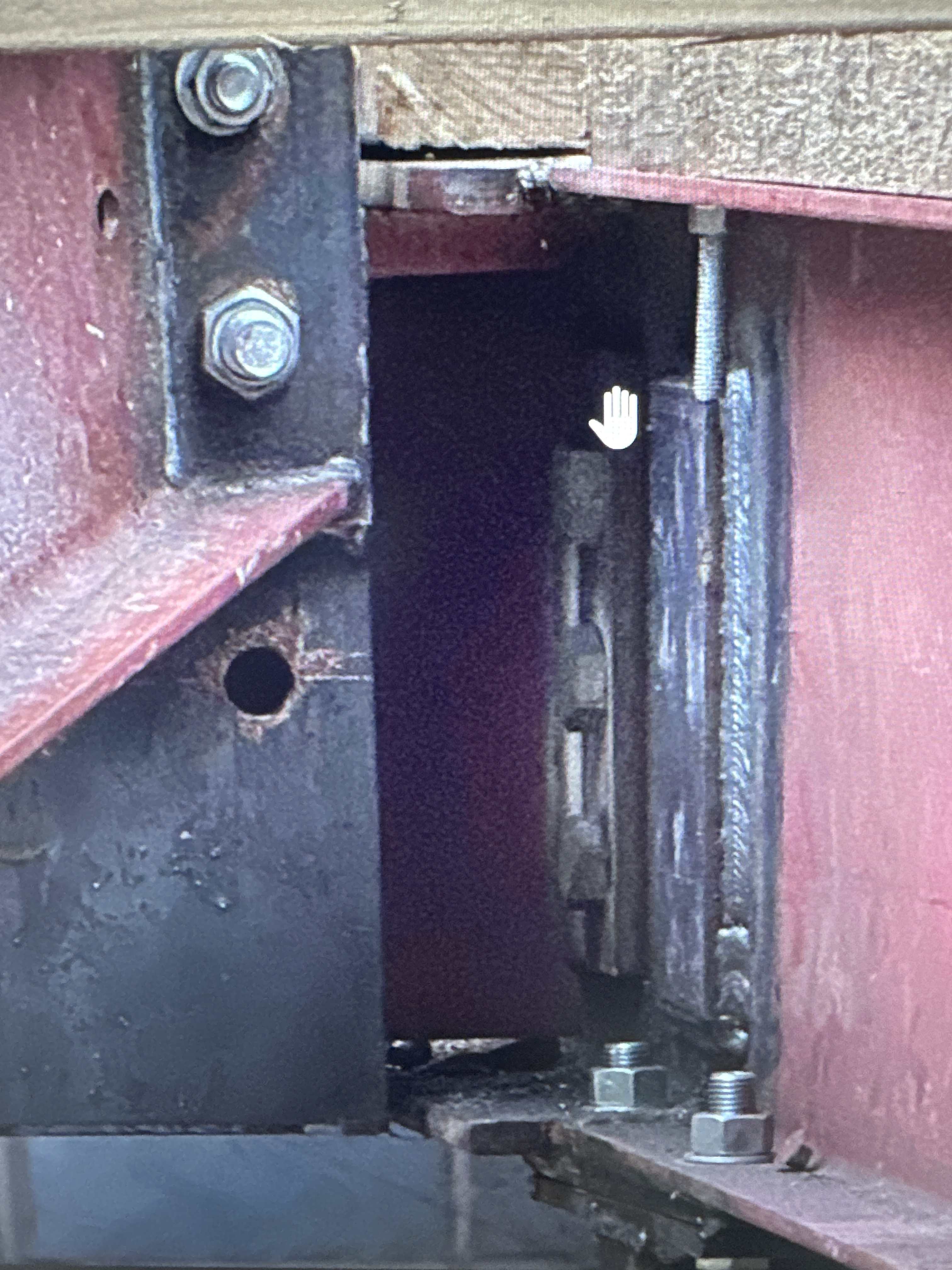

Nickfromwales Posted August 19, 2025 Posted August 19, 2025 14 minutes ago, Gus Potter said: So @Nickfromwales I won't be passing the welds you have shown either based on your photos! One simply knows when two pieces of metal have been fused together sufficiently. Given the 2 adjoining ridge beams were firstly, at my request, fully welded together (ahead of the fitment of the 2x plates (front and not visible rear)) I am more than happy with the results. Before you fail them, maybe it would be beneficial that you'd perhaps better understand the overall situation, and after those facts are in I will take your punches squarely on the chin Until then, no dice old boy
Gus Potter Posted August 19, 2025 Posted August 19, 2025 1 minute ago, Nickfromwales said: Before you fail them, maybe it would be beneficial that you'd perhaps better understand the overall situation, and after those facts are in I will take your punches squarely on the chin On the face of it Nick I would say the welds are concave and not standard. I'm entitled to do this based on the photos, to make reasonable enquiry without being a tosser as best you can. NIck, I'm just saying as an SE that welds look concave and if this was standard SE stuff then it's fair for me to ask as part of my due dilligence to ask is that ok? are the welds heavily loaded? Welds can be pretty strong after all if not subject to bending forces. Now if the loads are low then you can reduce the throat width and the ones you show may be just fine. So yes of course I don't understand the overall context.. but what I'm trying to do in my posts on BH is to give self builders tools and reference documents that they can use to get the best out of things and to provide informationto help them say to a builder.. that looks no good and here is why I think this way. But I'm not going to back off from this. If the weld you show in your picture has been designed on a 6.0. mm leg length which gives you an effective throat width of 4.2 mm and I can clearly see that the weld is concave then it just looks off! Now it may be just fine as the loads will be low, but I'm trying to alert folk on BH about how SE's design normally, to support them when their gut feeling is telling them... that does @Ay8452 not look right to me. The whole connection and what is round about is looks seriously iffy to me as an SE. @Ay8452 banter hat off .. get your SE to check this as built on site for your own safety. You have thermailite or similar block in there be safe and ask questions. 24 minutes ago, Nickfromwales said: Until then, no dice old boy Ok banter on BH keeps the ball rolling. So in that spirit.. If we all got on all the time it would be totally boring. In Scotland we say.. "come on ya yadge" I think in Wales you break into song.. xxx 1

Nickfromwales Posted August 20, 2025 Posted August 20, 2025 9 hours ago, Gus Potter said: On the face of it Nick I would say the welds are concave and not standard. I'm entitled to do this based on the photos, to make reasonable enquiry without being a tosser as best you can. NIck, I'm just saying as an SE that welds look concave and if this was standard SE stuff then it's fair for me to ask as part of my due dilligence to ask is that ok? are the welds heavily loaded? Welds can be pretty strong after all if not subject to bending forces. Now if the loads are low then you can reduce the throat width and the ones you show may be just fine. So yes of course I don't understand the overall context.. but what I'm trying to do in my posts on BH is to give self builders tools and reference documents that they can use to get the best out of things and to provide informationto help them say to a builder.. that looks no good and here is why I think this way. But I'm not going to back off from this. If the weld you show in your picture has been designed on a 6.0. mm leg length which gives you an effective throat width of 4.2 mm and I can clearly see that the weld is concave then it just looks off! Now it may be just fine as the loads will be low, but I'm trying to alert folk on BH about how SE's design normally, to support them when their gut feeling is telling them... that does @Ay8452 not look right to me. The whole connection and what is round about is looks seriously iffy to me as an SE. @Ay8452 banter hat off .. get your SE to check this as built on site for your own safety. You have thermailite or similar block in there be safe and ask questions. Ok banter on BH keeps the ball rolling. So in that spirit.. If we all got on all the time it would be totally boring. In Scotland we say.. "come on ya yadge" I think in Wales you break into song.. xxx It’s fully welded at the butt joint, as well as additional mechanical fixing. It’s also now plated that side, and also on the reverse, for belt + belt + braces. Needed adapting (beefing up) as we moved the point where the crown sent the load down to founds, on to the smaller width RB2 vs the original wider RB1 that it was first placed with. Originally RB2 just sat alongside RB1 with zero connection. We also introduced a connecting plate at the underside, to accept the rising post, which we drilled and bolted and then also continuously welded too, for more braces. If this moves even 1000th of a mm I’ll buy the drinks. SE will get pics, and sign it off accordingly, and BCO will inspect and nod / smile / shrug shoulders and so on. Loads are small, just a simple (now) roof, so if anything it’s ott.

Temp Posted August 21, 2025 Posted August 21, 2025 My son sections and inspects welds for a living. Took one look at the photo and said the bit done on site looks horrible and should be redone. He suspected some might even come off if you run a hammer down it.

LnP Posted August 21, 2025 Posted August 21, 2025 (edited) There is a gap between the two pieces which are to be welded together. Throat thickness and leg length don't mean much if the welder is trying to fill the gap with weld. The two pieces have been bolted up incorrectly. Edited August 21, 2025 by LnP
