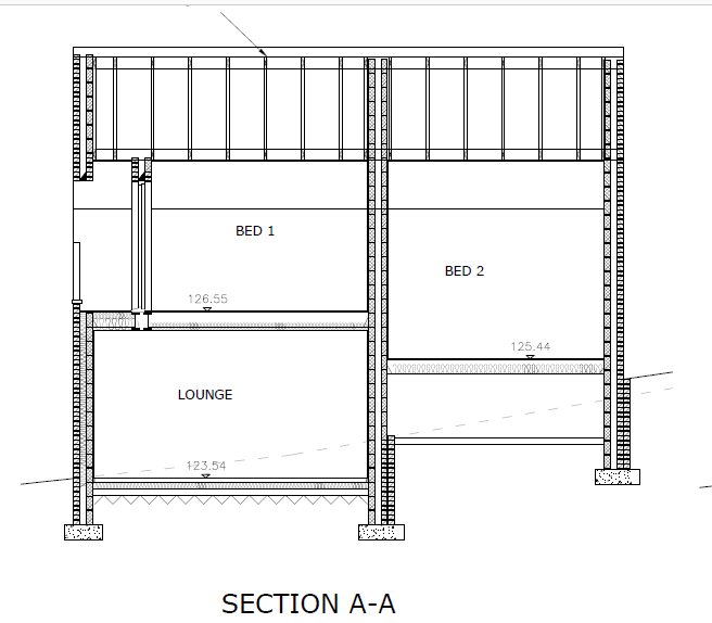

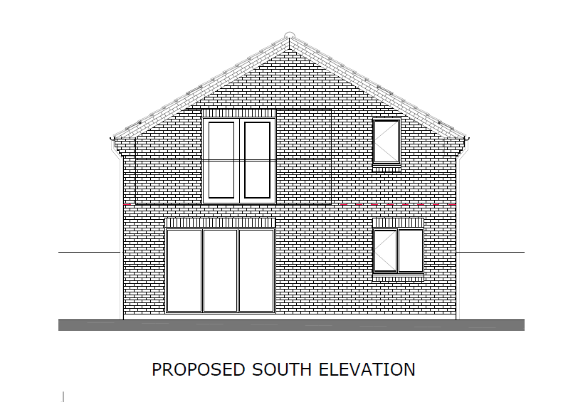

Hecateh Posted January 4, 2018 Posted January 4, 2018 My design has an inset balcony to the main bedroom. It's only very narrow, just wide enough for me to sit out with a cup of coffee on a nice morning. Below are sections of drawings from my architect. My builder is now asking me how the gable end is supported as there is nowhere to support a steel at the roof side. It appears to me to be one more thing my architect has not addressed - or is it up to me to find a solution
le-cerveau Posted January 4, 2018 Posted January 4, 2018 Classic of the architect sadrawing and saying the engineers will sort it out!
Jeremy Harris Posted January 4, 2018 Posted January 4, 2018 Some steel work should sort it, but that then creates another problem - how do you mitigate the potential thermal bridging where the steel goes? The steel would also have to be specially fabricated as a sort of truncated A shape, to rest on the walls either side and support the brickwork across the set back opening. In terms of reducing the thermal bridge problem, and potentially the need to fire protect the steel, I wonder if the steel could be designed as an architectural feature on the open side, with a plate to support the brickwork above? 1

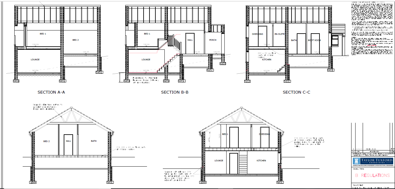

Hecateh Posted January 4, 2018 Author Posted January 4, 2018 (edited) 27 minutes ago, PeterW said: Isn’t your architect married to the SE...?? Not married - work partners - I'll go straight to him, I no longer have any confidence in her - Every dealing I had with her my confidence gradually ebbed away. Another issue she has left me with. Notice on the elevations there are velux windows. Now look at the cross sections DD and EE - So how are the velux windoes going to work b elevations.pdf e cross section.pdf Edited January 4, 2018 by Hecateh
AliG Posted January 4, 2018 Posted January 4, 2018 (edited) You can certainly see from the section that no steel is envisioned. It shows a lintel. I have steels in my roof exactly that truncated A shape. Cold bridging shouldn't be an issue as only at the right hand side would it be bridging to the interior, everywhere else it is the exterior of the balcony behind it. More difficult will be hiding the steel with a brick finish. It would go inline with the inside wall with a plate holding up the outside wall. When you look up at the underside of the wall though you are going to see a 300mm wide metal plate. Really SE should advise and if they have already been paid they have clearly made a mistake not to include it. Edited January 4, 2018 by AliG 1
AliG Posted January 4, 2018 Posted January 4, 2018 Are the Velux windows not supposed to just fit between the trusses, they look to be the correct size for that. If not the trusses can be cut and reformed around the Velux, that is not unusual.
Hecateh Posted January 4, 2018 Author Posted January 4, 2018 (edited) 5 minutes ago, AliG said: Are the Velux windows not supposed to just fit between the trusses, they look to be the correct size for that. If not the trusses can be cut and reformed around the Velux, that is not unusual. Ceiling heights are set at 2.4m which puts the windows into the loft space Edited January 4, 2018 by Hecateh
Oz07 Posted January 4, 2018 Posted January 4, 2018 Either drop the roof windows into the pitched ceiling or just form some boxes coming down to the flat ceiling.
Ferdinand Posted January 4, 2018 Posted January 4, 2018 (edited) It does say If in doubt, Ask in large red letters in the notes, so presumably they welcome questions . On your roof windows, you could decide to leave your trusses exposed and insulate on the slope if you like that look. F Edited January 4, 2018 by Ferdinand
AliG Posted January 4, 2018 Posted January 4, 2018 1 hour ago, Hecateh said: Ceiling heights are set at 2.4m which puts the windows into the loft space Ah right. You can move them down the roof or create boxes as suggested. However, to get them in below the ceiling they would basically be at the gutter. Looking at the elevations, 2 of the Velux windows are directly above normal windows. Did the architect intend them to light up the loft space? Unless they are lighting spaces that don't have windows I would be inclined just to leave them out. Hard to say without the floorplan. They are an expensive way of lighting the loft. I would certainly not have the 2 that are above windows, they would look odd from the inside and seem unnecessary.

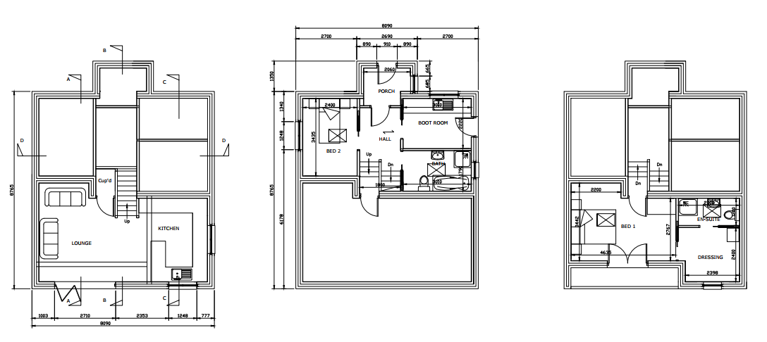

Hecateh Posted January 4, 2018 Author Posted January 4, 2018 (edited) 17 minutes ago, AliG said: Ah right. You can move them down the roof or create boxes as suggested. However, to get them in below the ceiling they would basically be at the gutter. Looking at the elevations, 2 of the Velux windows are directly above normal windows. Did the architect intend them to light up the loft space? Unless they are lighting spaces that don't have windows I would be inclined just to leave them out. Hard to say without the floorplan. They are an expensive way of lighting the loft. I would certainly not have the 2 that are above windows, they would look odd from the inside and seem unnecessary. Pretty much along the lines I was thinking. There was potentially an issue that the windows below would have to be obscure glass as they are close to a boundary and the vellux were added for this eventuality however planning had no problems with the windows (one metre and 3 metres from boundaries). The only one I really want is the one in my bedroom, directly above where my bed weill be so I can lie in bed and look at the stars. That room I want to be fully vaulted, the rest I'm going to wait and see whether it is cheaper to fully vault all of it or to separate the rest off and and the ceilings as shown. This partly depends on the level difference between the floors as the builder thinks the stairs may well end up being 6 and 7 rather than 9 and 4 as shown These are last floor plans produced but I am now having an understairs loo on the lounge floor, and the bathroom is moving to be a small ensuite in the second bedroom, leaving a large boot/utility/hobby room. Edited January 4, 2018 by Hecateh
AliG Posted January 4, 2018 Posted January 4, 2018 @Hecateh you may have posted your plans originally and I didn't see them. Just looking at them, the master en suite looks uncomfortably small. I would make it wider and the dressing room a little smaller. I would also put a nice big shower right across the end of the room. When you say the bathroom will be an ensuite, how will that works as it is across the hall? 1
Hecateh Posted January 4, 2018 Author Posted January 4, 2018 9 minutes ago, AliG said: Just looking at them, the master en suite looks uncomfortably small. I would make it wider and the dressing room a little smaller. I would also put a nice big shower right across the end of the room. When you say the bathroom will be an ensuite, how will that works as it is across the hall? Master ensuite not yet really fixed and won't be finalised until I can get in there and really visualise it. The washer/dryer is going in there somewhere - most washing is clothes. Almost happy to have it as one big room as modern ventilation should ensure no damp problems. A good size shower is a priority, may need disabled access at (hopefully not) at sometime. Bathroom is moving across to be a mini en-suite off bed 2 (next to the mid wall) as with a downstairs loo and an upstairs ensuite, it will only be used a couple of times a year, although this is the one that is on the entry level so will have to meet building regs for access. The then big utility will be a hobby come storage room - I refinish furniture as a profitable hobby so need space for diy and painting in there 1
