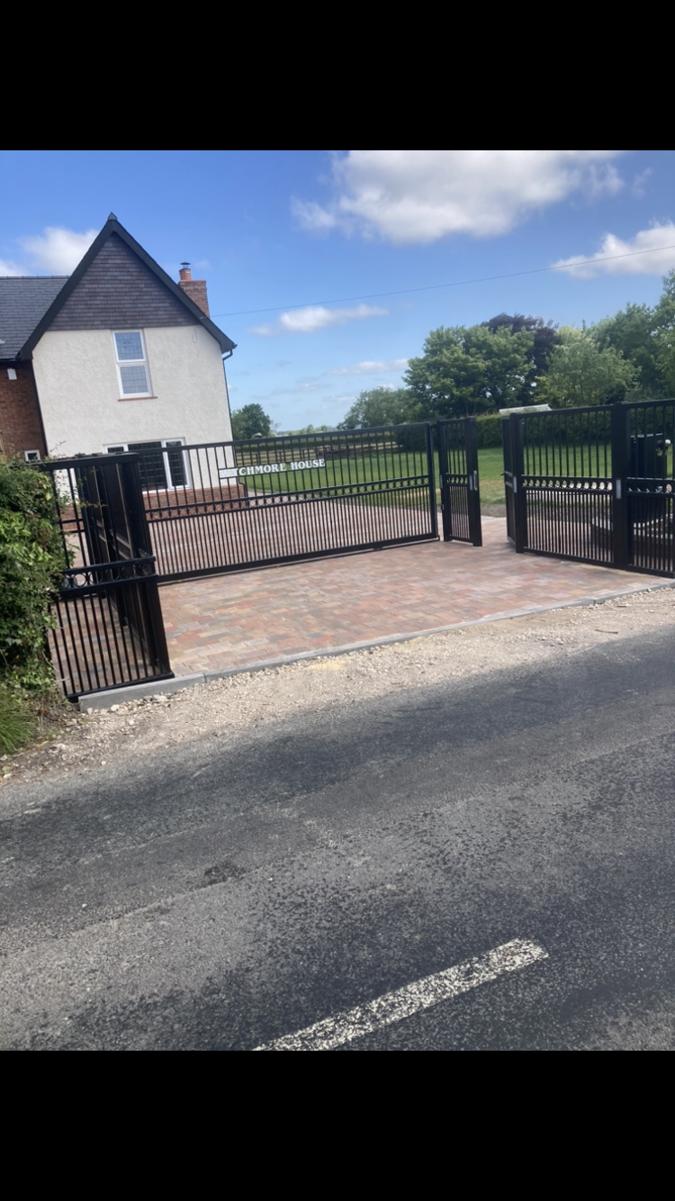

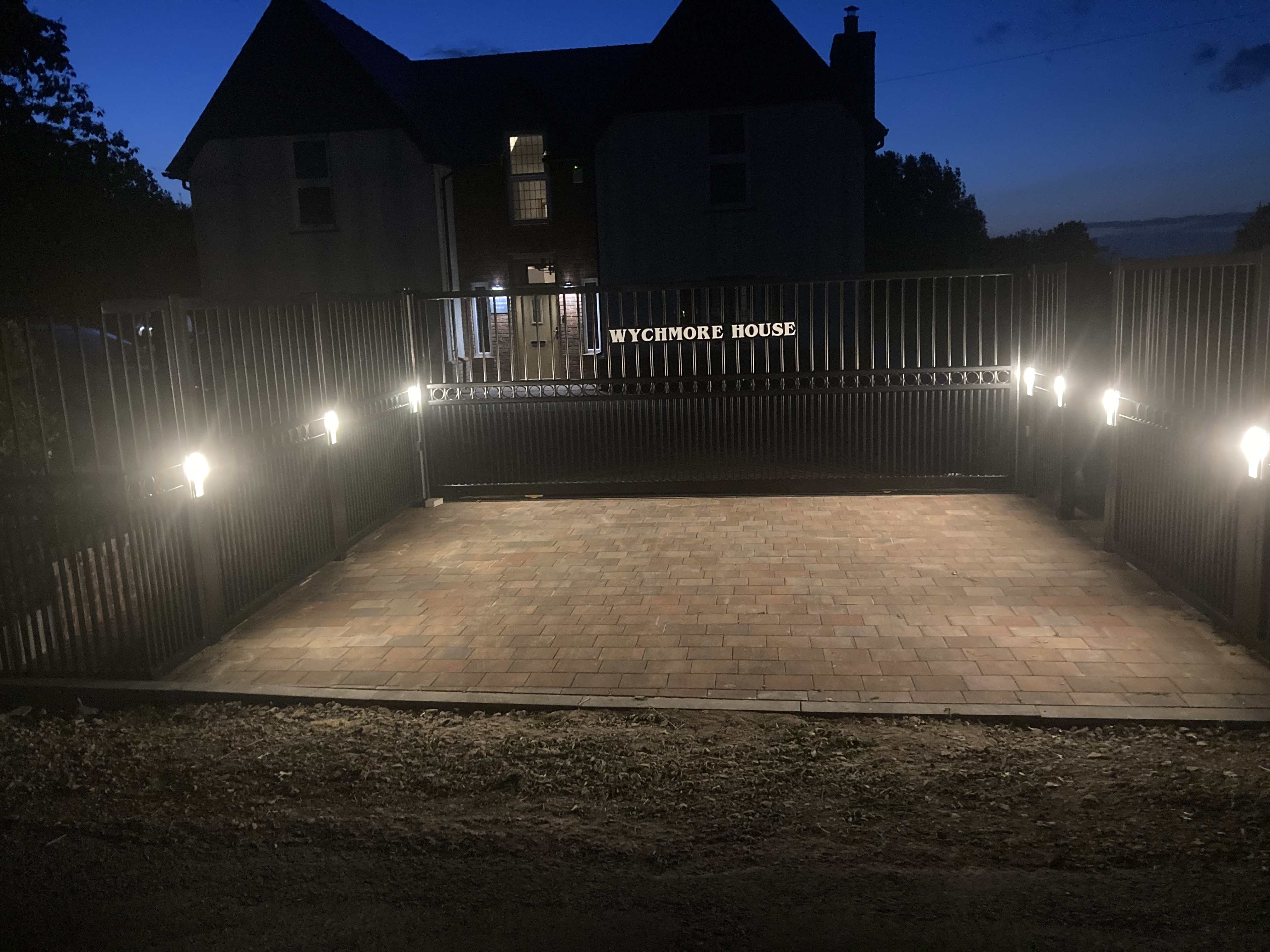

nod Posted Saturday at 06:52 Posted Saturday at 06:52 We’ve just done ours The magic number seems to be 3 meters We’ve set ours at 4 to allow a vehicle to safely stop if there’s no one home to open the gate We are on a country lane with no pavement and 60 mph limit 1

nod Posted Saturday at 07:16 Posted Saturday at 07:16 12 minutes ago, Alan Ambrose said: My local highway guys say 3.7m to 5.5m as part of our planning conditions. Our last build had a pavement and grass verge and good splay vision Our highways simply said NO We ended up putting gates at the side of the house Some eight meters in BUT a build that was completed 12 months after ours (4years ago) Sited there’s at the edge of the pavement About 1 meter from a busy main road As clear as mud
