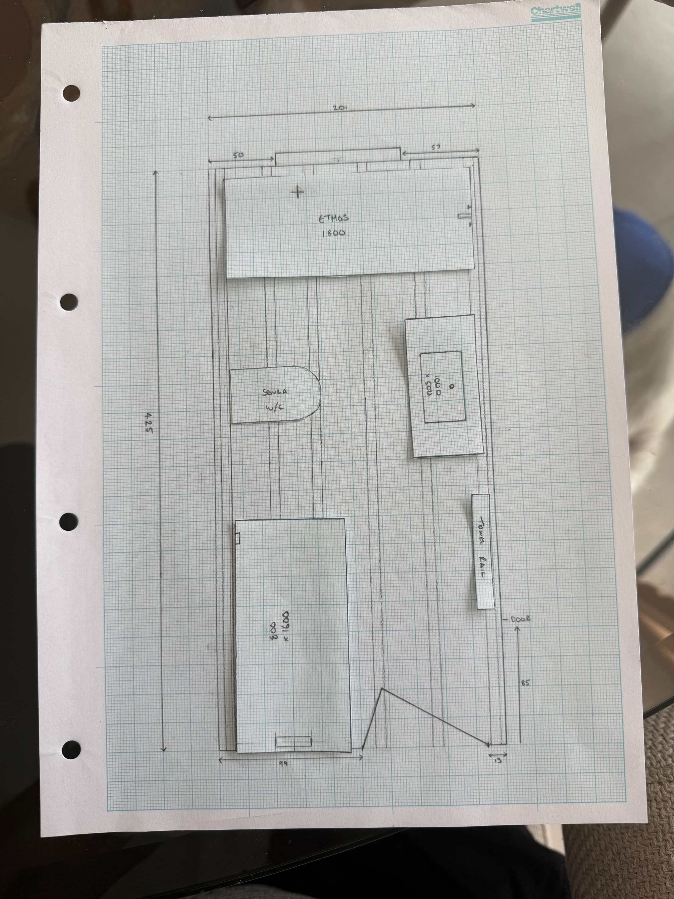

richo106 Posted April 21, 2025 Posted April 21, 2025 Hi All We have finally got round to starting our main bathroom I have drawn it up and with the wife chose majority of the items we would like in there, however my one concern is the gap between the toiler and vanity unit too small? It will be 645mm We want the 1800mm bath to fit tight between the walls and where the waste comes up of the toilet it will be about there anyway by the time its studded off etc. We can reduce the size of the shower tray to either 800 x 1500 or 800 x 1400 to help with a little bit of room. Please see attached layout, pretty much anything can move apart from the toilet that has to be on the left hand side Any ideas/feedback would be greatly appreciated
G and J Posted April 21, 2025 Posted April 21, 2025 Can you build the cistern into the wall and maybe use a floating potty? That will increase the feeling of space in that area and increase the actual ‘knee’ gap.
Iceverge Posted April 21, 2025 Posted April 21, 2025 645 is fine. I would consider putting the shower head on the long wall rather than the short one. It would feel much more comfy to use with the extra elbow room.
ProDave Posted April 21, 2025 Posted April 21, 2025 Is this subject to building control? If so that may dictate the spaces you need? How far in are you? too late to change to a wet room for the shower area? 1
Mr Punter Posted April 21, 2025 Posted April 21, 2025 You could fit a bidet. Not fashionable here, compulsory in several European countries. Easy to freshen up without getting undressed. 1
Spinny Posted April 21, 2025 Posted April 21, 2025 People may be nicely silhouetted against the window when getting in and out of the bath at night ? Where will you put the extractor and the heated mirror ?

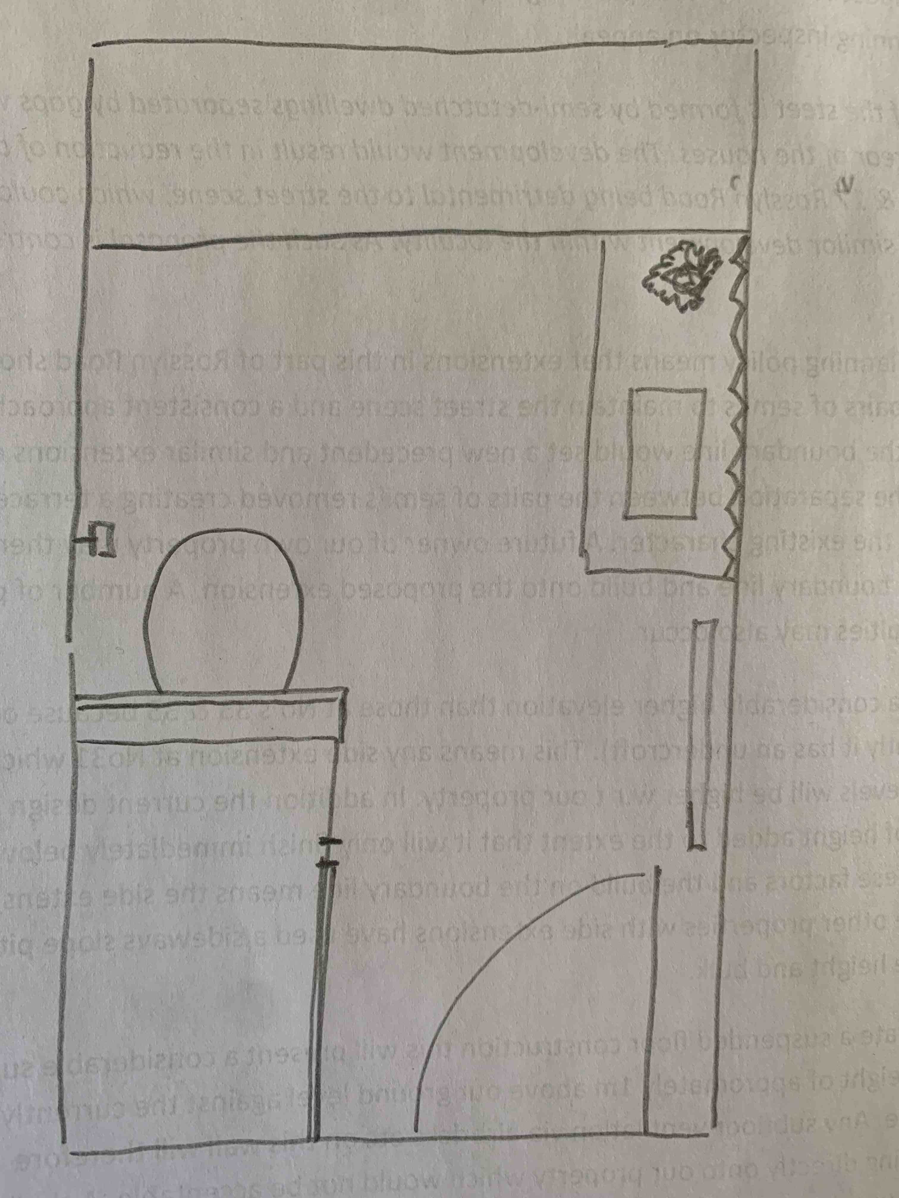

bungledlow Posted April 21, 2025 Posted April 21, 2025 Our bathroom is almost identical in shape and dimensions, albeit 50cm shorter. We lost a few centimetres from tiling so consider that too. We had considered a similar layout to your diagram but went with this in the end and are generally happy with it. The bath is 170 as we didn't want it to look too crammed in, and have some hope for cleaning around it. It feels plenty big enough. A different style may be more suited to filling the space. The shower is rarely used so it's not too bad keeping it all clean, but might be an issue otherwise. The mirror does steam up but we don't find it an issue particularly. Things we would consider doing differently: - Somewhere to store shampoo and soap for both shower and bath (will probably solve this with furniture) - More width around the toilet - Don't buy the cheapest toilet seat, it's awful and will be replaced - The bath towel rails are behind the door and bad planning meant the door handle conflicts with them - Not sure the colour of the window frame works but it is what it is - We are going to use plants to add colour and interest - We will eventually put a blind in to reduce the silhouette issue - Some may find the shower glass a bit exposed but it's been ok in practice even with toddlers 2

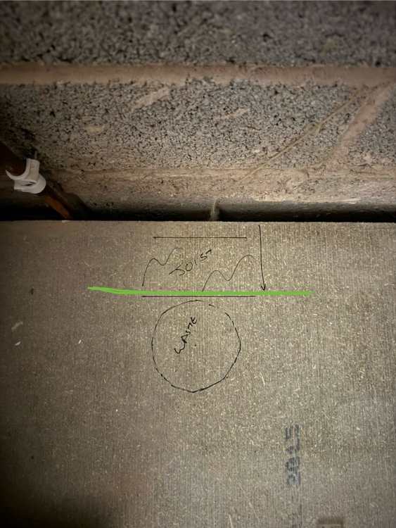

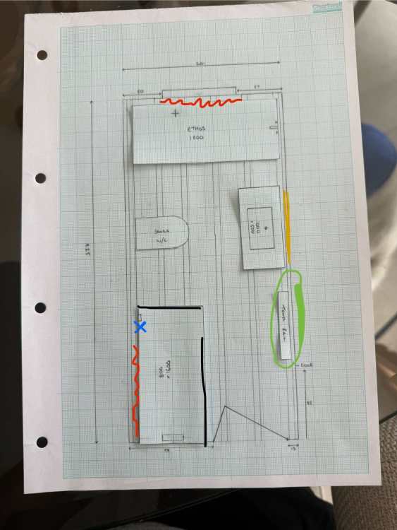

richo106 Posted April 21, 2025 Author Posted April 21, 2025 Hi all, thank you all for your feedback been very useful! In terms of situation its completely empty, floorboards down, plastered ceiling and spots, breeze block walls. The biggest issue for me is trying to dodge the posi joists with the wastes! I have attached my marked up plan which shows Niches (in red), shower valves (blue cross) Towel rail (green - just next to where door opens to), Heated mirror (yellow) I am not a fan of shower doors so want 2 fixed pieces of glass in place (black) I don't need specific extraction as have MVHR installed. We have a freestanding bath in our en-suite but as this will be primarily our kids bathroom we wanted the bath a tight fit, we are going for a rectangle freestanding bath - https://www.lussostone.com/stone-resin-baths-c1/ethos-freestanding-stone-bath-1800mm-p309 Like the look of yours @bungledlow, but have a couple of bad experiences with wet rooms albeit being poor install related issues! Yes good point on storage, we will be having a vanity unit but only half shelving type
richo106 Posted April 21, 2025 Author Posted April 21, 2025 One thing I could really do with some advice on is which would be the best toilet type to lose as little of the room as possible. I am more concerned about the level of the tiled wall, i could do with the finished wall as close to the breeze block as possible I have attached a photo below, due the position of my joists the centre of toilet waste is around 160mm into the room. Would it be best to have a closed coupled back to the wall or wall hung? https://www.lussostone.com/toilets-c5/senza-close-coupled-rimless-toilet-with-soft-close-seat-p4457 https://www.lussostone.com/toilets-c5/senza-back-to-wall-rimless-toilet-with-concealed-cistern-and-brushed-stainless-flush-plate-p5060 https://www.lussostone.com/toilets-c5/senza-wall-hung-rimless-toilet-with-concealed-cistern-frame-and-brushed-stainless-flush-plate-p5063 These are my options but i can't for the life of me work out which will be best! Any advice on this question would be amazing

Nickfromwales Posted April 21, 2025 Posted April 21, 2025 Why the joist, and not just a batten on the blocks, levelled accordingly, to save space?
richo106 Posted April 21, 2025 Author Posted April 21, 2025 1 minute ago, Nickfromwales said: Why the joist, and not just a batten on the blocks, levelled accordingly, to save space? That's the posi joist below 1
bmj1 Posted April 21, 2025 Posted April 21, 2025 11 hours ago, bungledlow said: Our bathroom is almost identical in shape and dimensions, albeit 50cm shorter. We lost a few centimetres from tiling so consider that too. We had considered a similar layout to your diagram but went with this in the end and are generally happy with it. The bath is 170 as we didn't want it to look too crammed in, and have some hope for cleaning around it. It feels plenty big enough. A different style may be more suited to filling the space. The shower is rarely used so it's not too bad keeping it all clean, but might be an issue otherwise. The mirror does steam up but we don't find it an issue particularly. Things we would consider doing differently: - Somewhere to store shampoo and soap for both shower and bath (will probably solve this with furniture) - More width around the toilet - Don't buy the cheapest toilet seat, it's awful and will be replaced - The bath towel rails are behind the door and bad planning meant the door handle conflicts with them - Not sure the colour of the window frame works but it is what it is - We are going to use plants to add colour and interest - We will eventually put a blind in to reduce the silhouette issue - Some may find the shower glass a bit exposed but it's been ok in practice even with toddlers I thought this design is a really clever use of space, and should be given the love it deserves. So much is right about this. Needs to be a wet room style (i.e. invisible) shower tray, which is my preference anyway (we did all ours like this). Floating vanity is gorgeous and minimalistic, but no reason you couldn't go heavier. Also consider built in storage in the doorway wall (on your left as you walk in - above the toilet height) - I.e. thicken that first doorway wall and build storage in 1

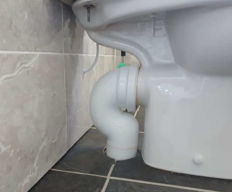

ProDave Posted April 22, 2025 Posted April 22, 2025 12 hours ago, richo106 said: If that is where your soil pope for the WC is going to emerge through the floor then you are going to struggle to get the WC close enough to the wall. Our downstairs WC is a close coupled type and the edge of the soil pipe connector is touching the wall, and it fits well with a standard rigid pan connector. I cannot see how it would work without forcing the whole pan and cistern away from the wall in your situation. What is below that? What can you change? Though I generally hate them, I think the best bet to get the WC as close to the wall as possible is one of those long flexible pan connectors terminated at or below floor level. Alternatively if all posi joists, then you could route the soil pipe to the other side of the room, if that is joisted differently that would allow you to get the pipe closer to the wall?
richo106 Posted April 22, 2025 Author Posted April 22, 2025 4 minutes ago, ProDave said: If that is where your soil pope for the WC is going to emerge through the floor then you are going to struggle to get the WC close enough to the wall. What is below that? What can you change? Though I generally hate them, I think the best bet to get the WC as close to the wall as possible is one of those long flexible pan connectors terminated at or below floor level. Alternatively if all posi joists, then you could route the soil pipe to the other side of the room, if that is joisted differently that would allow you to get the pipe closer to the wall? Unfortunately its joisted the same the other side, as this was my first build project joist locations wasn't considered and i just accepted the posi drawing that was given. Obviously this is just one of the many lessons learnt throughout the build. My idea was to install a drain connector flush with the floorboards - https://www.screwfix.com/p/mcalpine-push-fit-single-socket-drain-connector-black-110mm/4255V?tc=OT2&gad_source=1&gbraid=0AAAAAD8IdPyBDb62AI3EMbaFBjKf8DRXf&gclid=EAIaIQobChMIvcHl257rjAMVdZJoCR3srxruEAQYAiABEgIW8vD_BwE&gclsrc=aw.ds Then a space saving swan neck pan connector - https://www.snhtradecentre.co.uk/product/mcalpine-90-degree-space-saving-pan-connector-wc-conq/ Will this allow me to get the toilet back to the level of the joist or so do you think? Please my dodgy drawing below, I am hoping my green line will be the line of the tiled wall? Is this doable? Certainly any other ways to do this would be greatly appreciated
dpmiller Posted April 22, 2025 Posted April 22, 2025 we had similar to contend with, swan-neck did the job fine 1
Spinny Posted April 22, 2025 Posted April 22, 2025 Couldn't you cut a section of the joist out and put a couple of trimmers in hung off the concrete block wall to create a gap for the toilet pipe wherever you need it ? (Or can you not do this with posi joists ?) Not keen on close coupled myself, much prefer the look of back to wall with a hidden cistern. Looking at your layout again, I am not sure it is ideal to have the toilet opposite the basin. The photographed layout above looks better. I tend to prefer the toilet somewhat tucked away as it is not normally a focal point and is a possible source of hygiene risk. Build a half height stud wall out across the end of the shower nearest the window, then turn the toilet through 90 degrees and back it onto this stud wall, conceal the cistern in the stud wall. Then have glass panel from above the stud wall up to the ceiling. ? (Would allow the toilet roll holder to be mounted on the wall then). Then you could push the basin down towards the bath more. (Even connect it to the bath with some cabinetry creating more storage and a longer counter top with a large mirror or mirror and shelves above for ornaments/pot plant ?) 1
