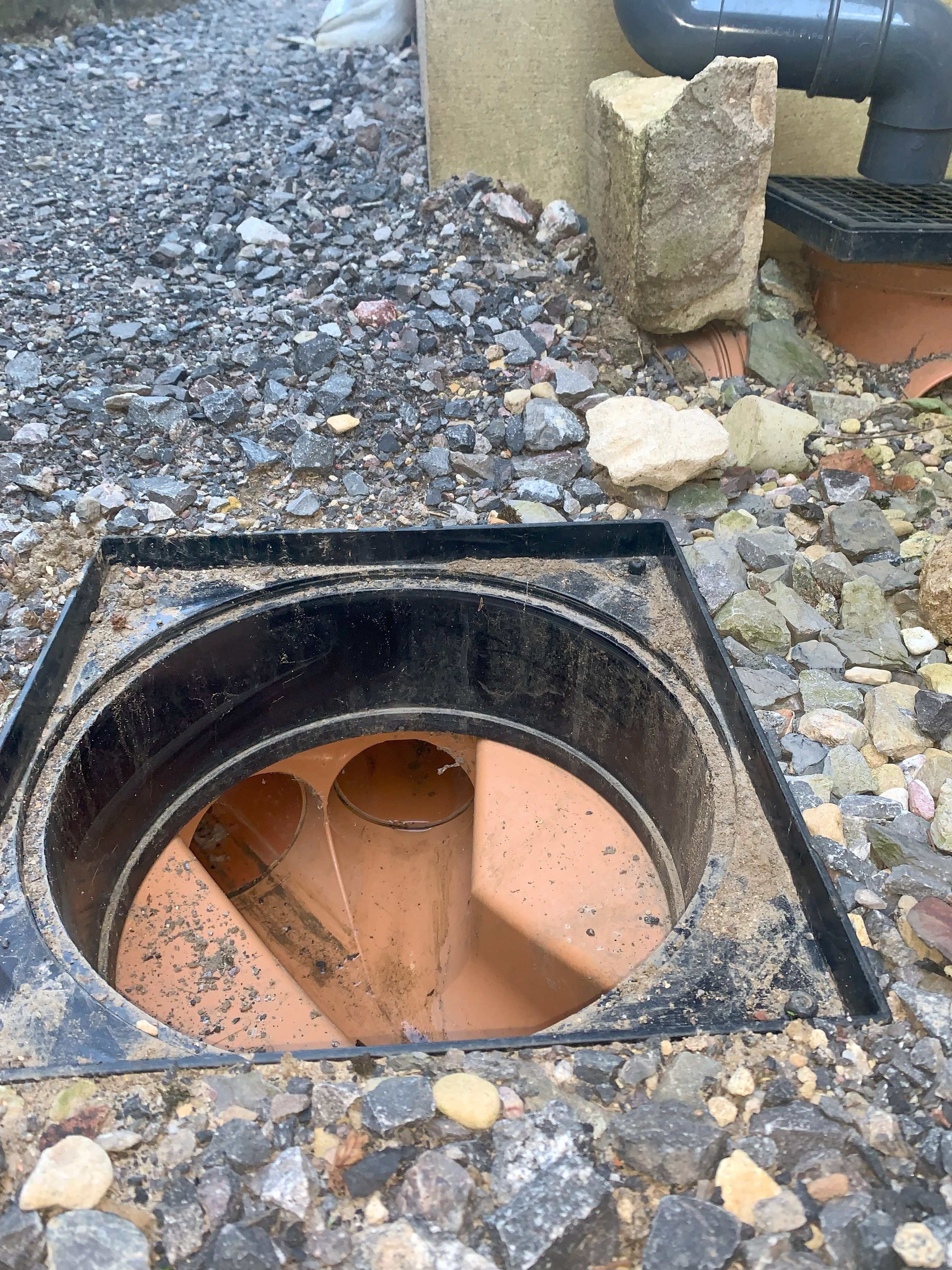

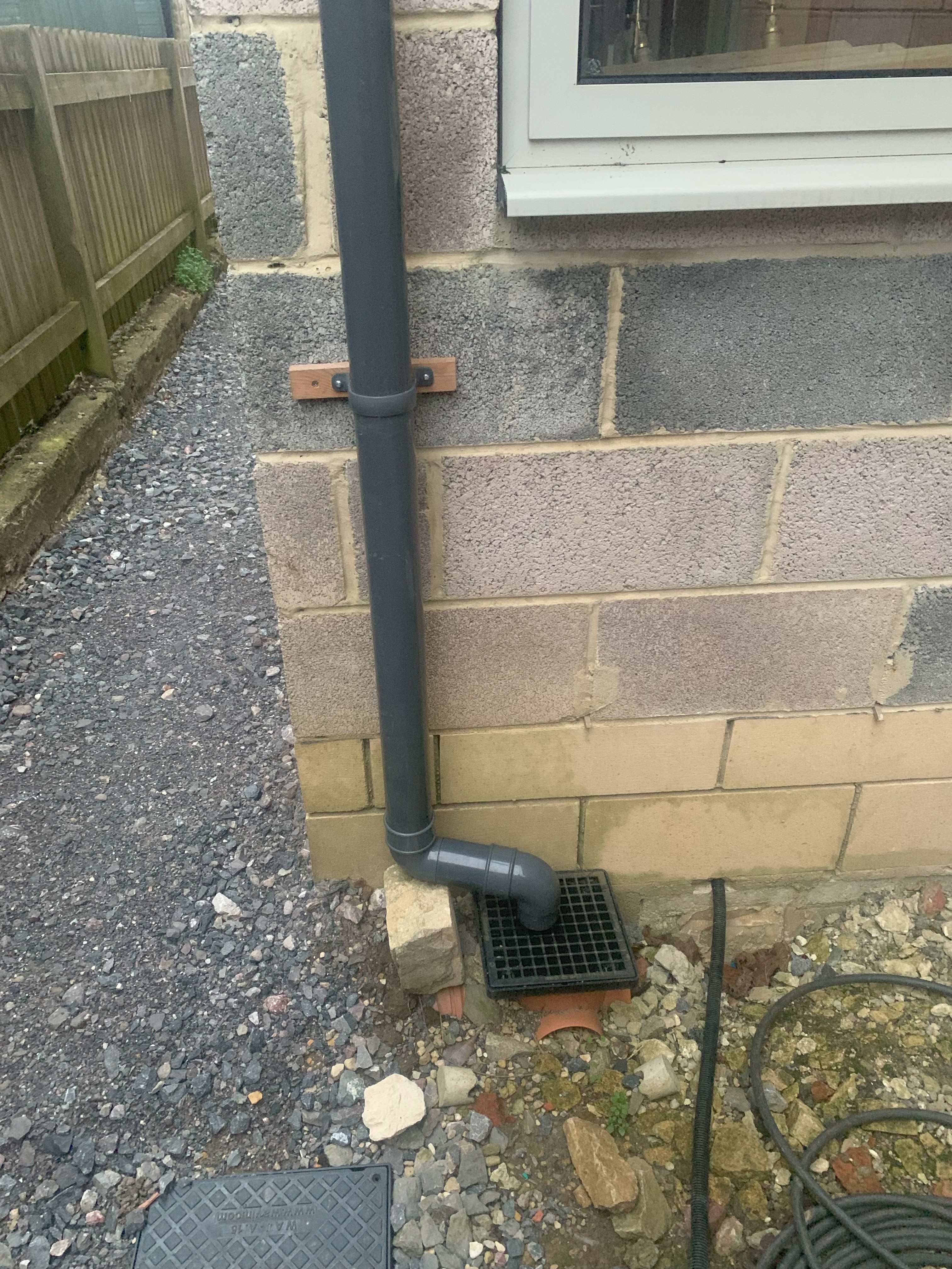

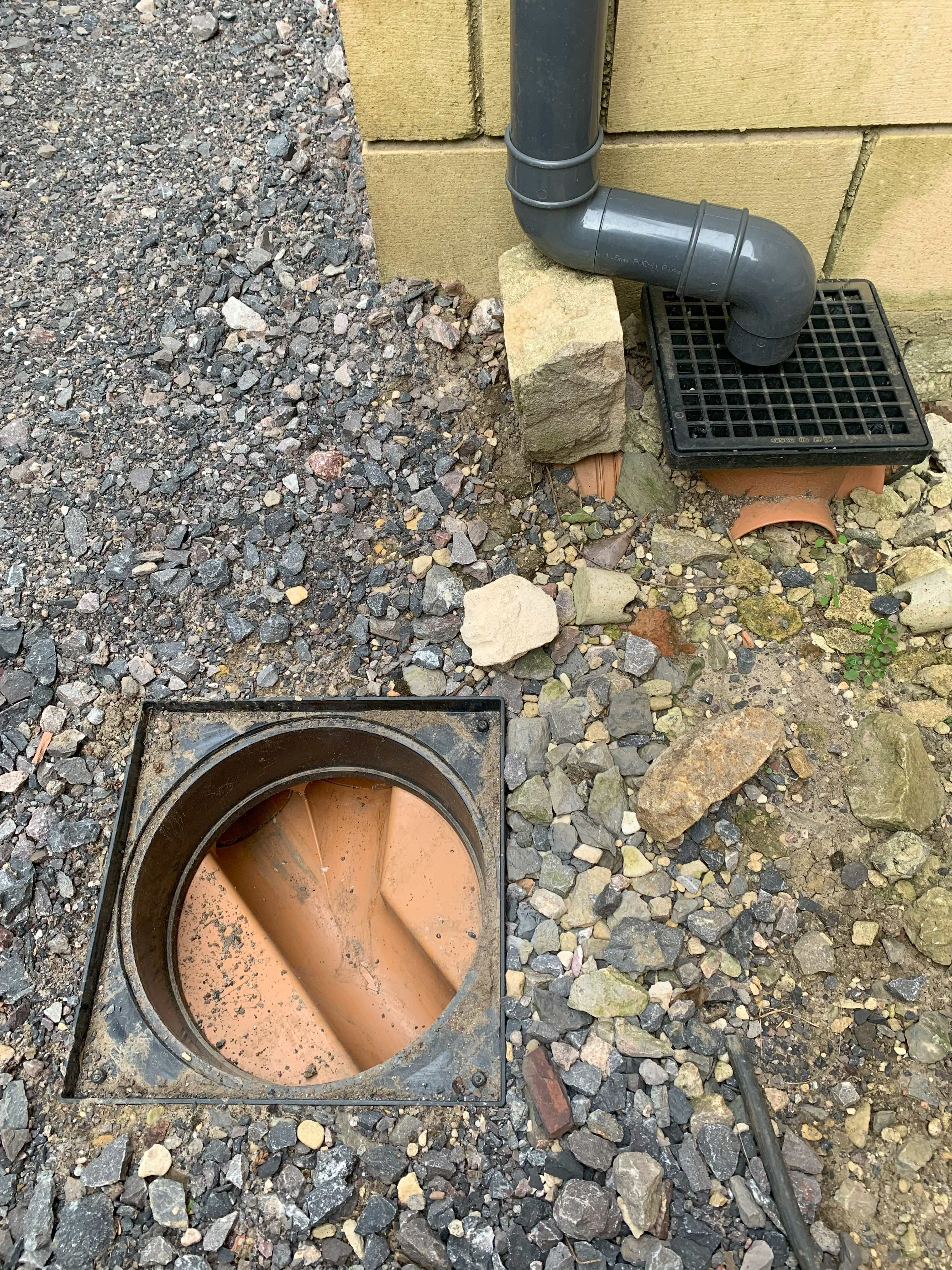

Spinny Posted March 19, 2025 Posted March 19, 2025 Hi, my departed builders installed a rainwater drain somewhat in the wrong place. It was supposed to be directly underneath the drain pipe position but has been put under the window instead. Is this going to be feasible to fix and how ? See photo's...
Mr Punter Posted March 19, 2025 Posted March 19, 2025 Yes, dig it out and reroute it. If it is feeding into that y branch it will be shallow. 1
nod Posted March 19, 2025 Posted March 19, 2025 Real easy fix Id to move two A dodgy self builder put them on the wrong side of the corner 😁 1
saveasteading Posted March 19, 2025 Posted March 19, 2025 2 hours ago, Mr Punter said: If it is feeding into that y branch IF. It's best to know. Put some water down and see if it comes through. 1

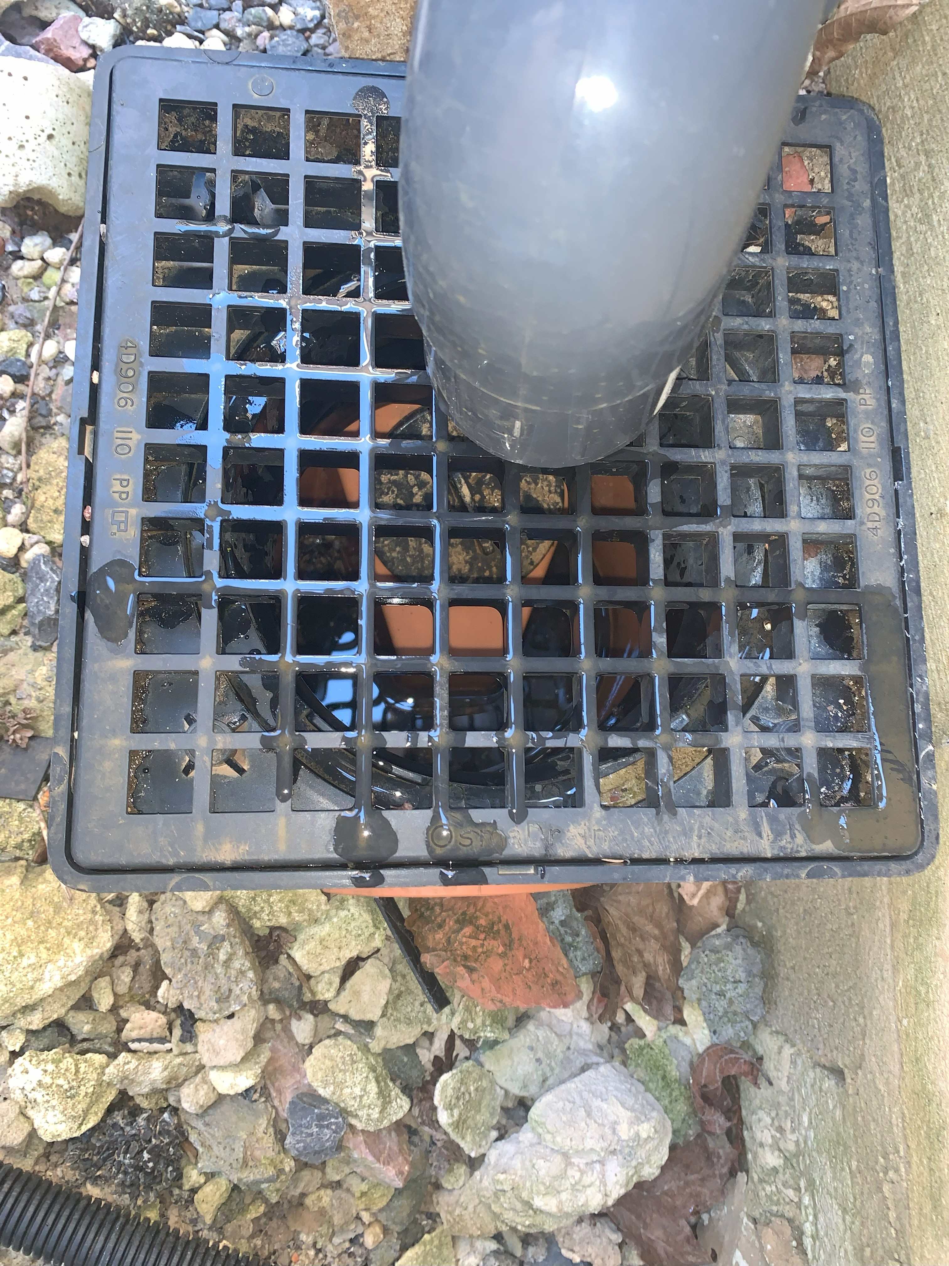

Spinny Posted March 20, 2025 Author Posted March 20, 2025 Thanks for replies. I have put some water down and it is indeed feeding into the y branch. Looking at the current position, I am thinking the builders must have put it where it is for a reason - usually convenience and speed for them. It looks as though there is a pipe connected to the inspection chamber outlet with presumably a 90deg bend and then the gully on the end of that. So that is presumably why they deviated from the plan and it has ended up where it is. So any idea what parts would allow it to be connected in the correct position - can the gully be twisted relative to the grill on the top ? I attach more photos. Any idea what part/manufacturer the gully is, it seems to have something with a cap on it inside - maybe a rodding point ?
Eric Posted March 20, 2025 Posted March 20, 2025 That is a grease trap / gully, meant for kitchen / utility. Just a rain head & elbow is all you need. 1

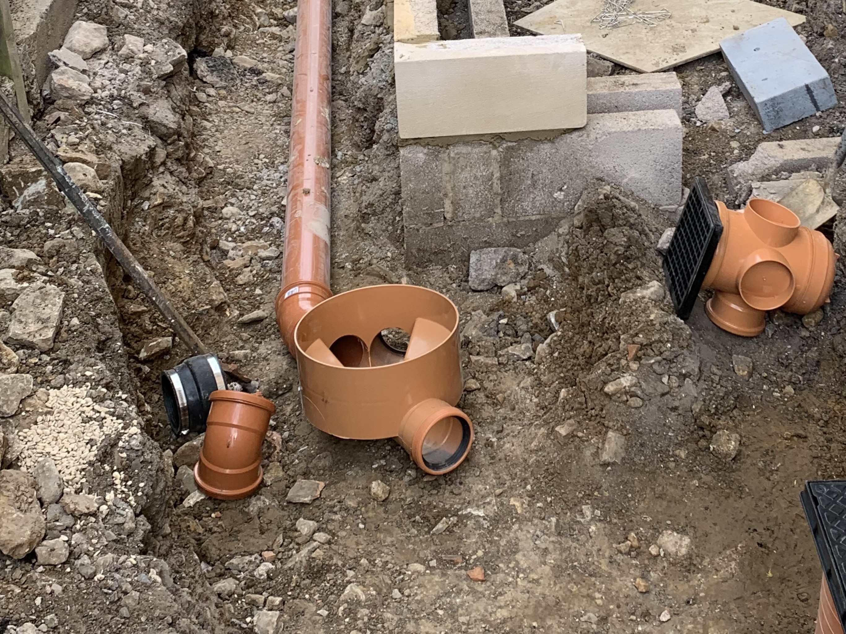

Spinny Posted March 21, 2025 Author Posted March 21, 2025 Thanks Eric, I think I have found it - looks to be an OsmaDrain bottle gully as shown below. I do need something with a water trap to stop smells because this particular rainwater pipe connects into the foul water drain to the sewer. It also rotates which is helpful. I am not sure what the purpose of the fixed internal baffle is ? It is roddable which is also useful but not really essential here as it could be rodded from the nearby chamber. All in all I guess I might as well reuse it, it is just going to be a case of sorting out how to pipe it into the fixed chamber. Am I right in thinking this is all going to be push fit ? Am I supposed to have some sort of support under the bottom of the gully ?

Mr Punter Posted March 21, 2025 Posted March 21, 2025 That is a bottle gulley and has a water trap to stop smells escaping. The grid will stop most leaves. You can fit an interceptor on the downpipe to catch leaves if they become a problem. You would normally be the gulley onto concrete for support. 1

Nickfromwales Posted March 21, 2025 Posted March 21, 2025 7 hours ago, Spinny said: I am not sure what the purpose of the fixed internal baffle is ? It’s to create a throat so a body of water is trapped and prevents gasses escaping.

BotusBuild Posted March 22, 2025 Posted March 22, 2025 Spinny, The pipes will most likely all be push fit. It might be a fight to get them apart, depending on how your builders fixed them in the ground (hopefully they didn't set in concrete). If you do get them apart check the rubber seals are not damaged before trying to re-use them - if they are, then easier to replace the whole fitting fo peace of mind. You will likely need to do some pipe cutting to be able to move the trap/gulley closer to the Y-branch. Lots of measuring and checking and imagery in your head as to how it will all fit back together. Take you time with the refitting and it will all slot into place. Don't beat yourself up if you end up having to recut pipes a couple of times 1
Spinny Posted March 22, 2025 Author Posted March 22, 2025 Thanks. The pipes are not set in concrete, just shingle and hardcore over. Am I right to think the rubber seals are attached to the pipe and NOT to the chamber inlets ? (There is no way I want to risk replacing the chamber itself as it connects backward to the main kitchen drain and forwards to the main drain.)
Spinny Posted March 22, 2025 Author Posted March 22, 2025 Just found this photo. So the rubber seals are part of the chamber. uh-oh. There is no way I want to have to change the chamber given it is connected elsewhere. Changing the chamber would mean taking a whole load of other stuff up too. How likely is it to damage the seal when removing the pipe ?
gaz_moose Posted March 22, 2025 Posted March 22, 2025 should just pull out. might need a bit of a wiggle. use some washing up liquid as lube when putting it all back together. 1
Gone West Posted March 23, 2025 Posted March 23, 2025 I wouldn't use washing up liquid or Vaseline on rubber seals, as over time the seal will be degraded. Use silicone grease which is the correct lubricant for rubber seals. 1
ProDave Posted March 23, 2025 Posted March 23, 2025 What nobody has mentioned yet, is if you cut any of the pipes to reconfigure the run to move the drain, then make sure you chamfer the outer edge of the cut so it feeds into the seal gently (with the correct silicon lubricant as already mentioned) Trying to insert a blunt square edge cut is a common reason for damaging the seal. 1

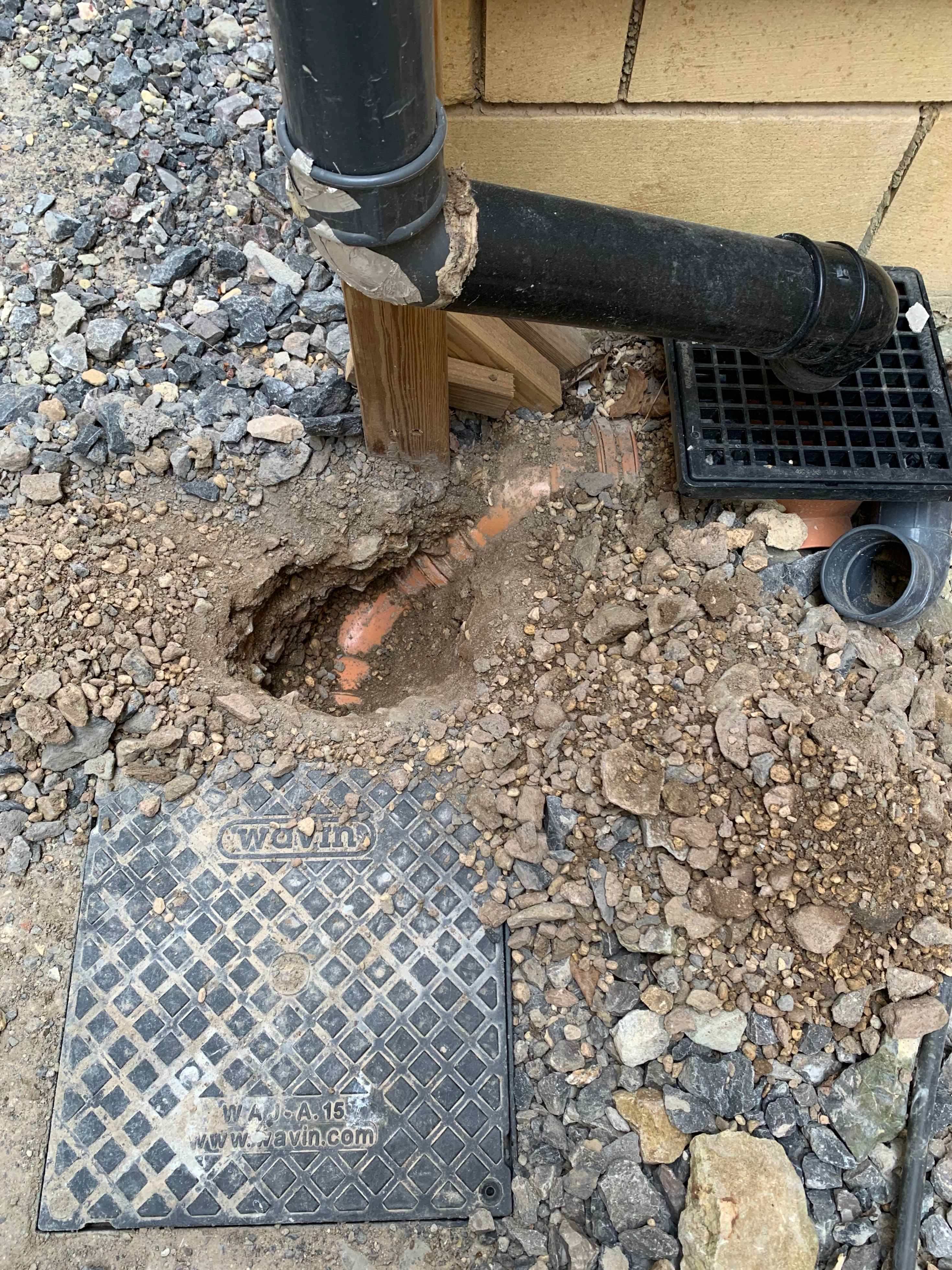

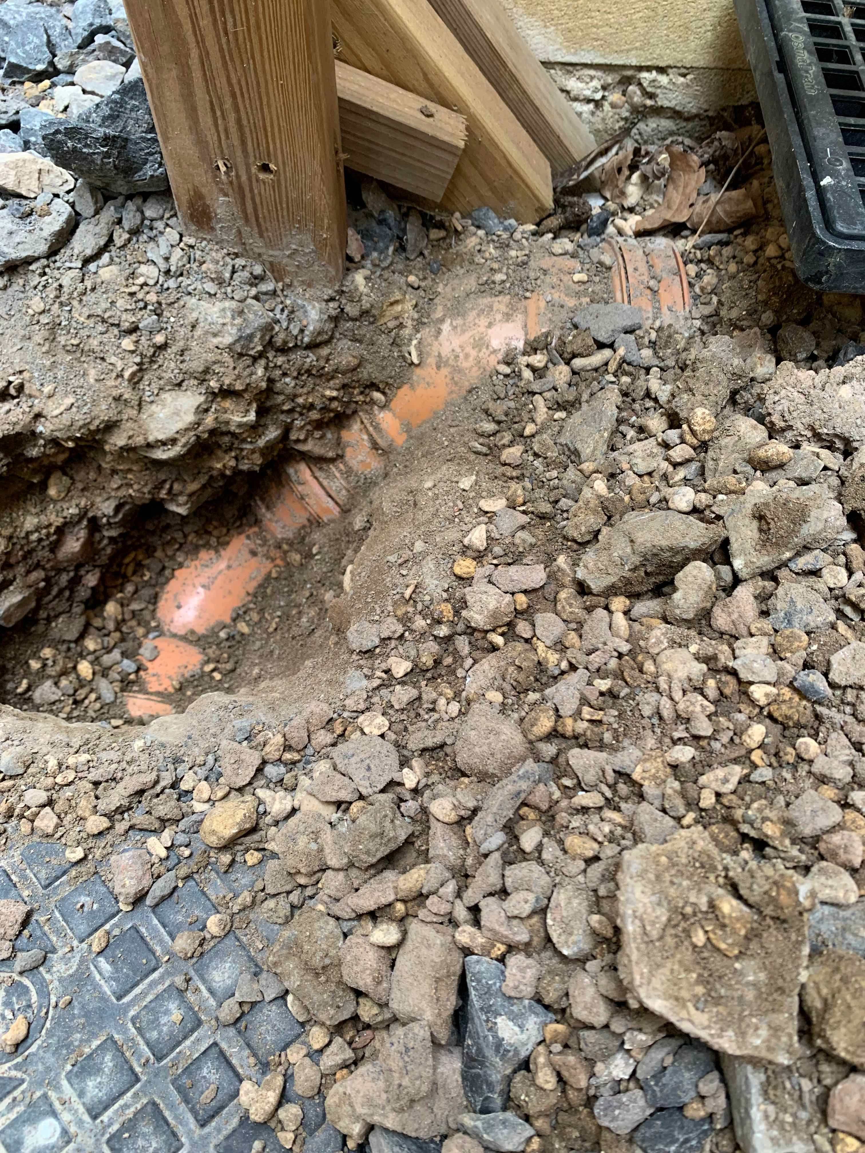

Spinny Posted April 27 Author Posted April 27 (edited) Coming back to this one now. Have cleared out some hard core to show the drain pipes that are there - looks like two 45 degree bends connected together. What pieces can I use to move this drain about 6 inches to the left ? (without moving the wavin chamber) (PS might there be any way to connect a small shallow drain/waste pipe into this gully to carry discharge from a water softener inside an adjacent wall about 1m away ? For example by attaching a 40mm pipe into the side bush somehow ?) Edited April 27 by Spinny
Oz07 Posted April 27 Posted April 27 Till you pull it all out you won't really know if you can make the bend to fit the gully to the ic. It looks tight. If it's only rainwater and softened water going in you could use a back inlet gully. Connect that one to the ic, maybe even where you want your softener, then connect some 110mm into the back of that gully and run it to the corner where you want this downpipe to finish. Might be even easier to keep gully where it is then used some dished channel drainage or similar and put a shoe on the bottom of downpipe

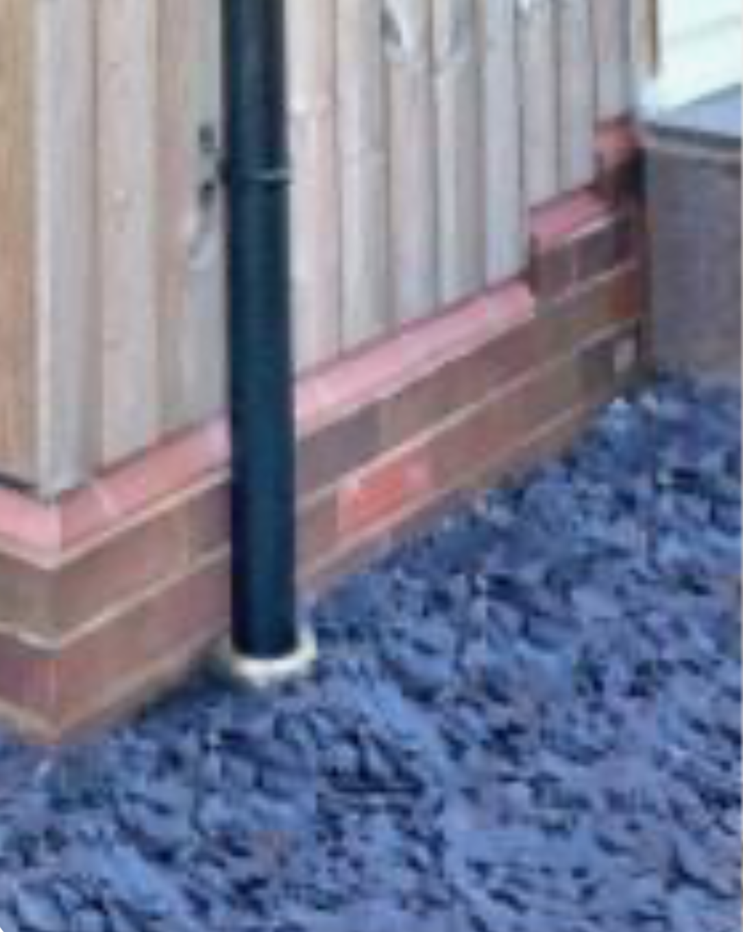

Nickfromwales Posted April 27 Posted April 27 If its just rainwater, with no stench, then just drop the downpipe so its below grade and fit it into a rubber bung in a 110mm bend. Will look a bit like this, just use a black 110mm bend
Spinny Posted April 27 Author Posted April 27 Thanks. It is a rainwater downpipe, but it is feeding into the foul drain/sewer and not into a soakaway. It only drains a small portion of the extension roof and one of the downpipes for the original house roof drains down onto it. So was acceptable to BC - almost all of the extension roof water will go to a rear soakaway. It is also the only surface drain in that area, so would like to retain that. 1
