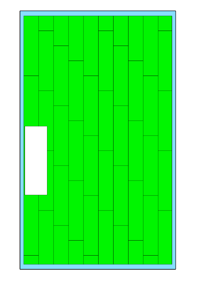

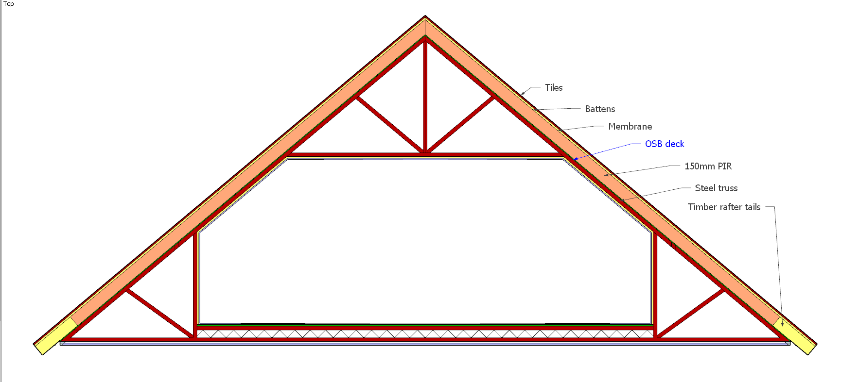

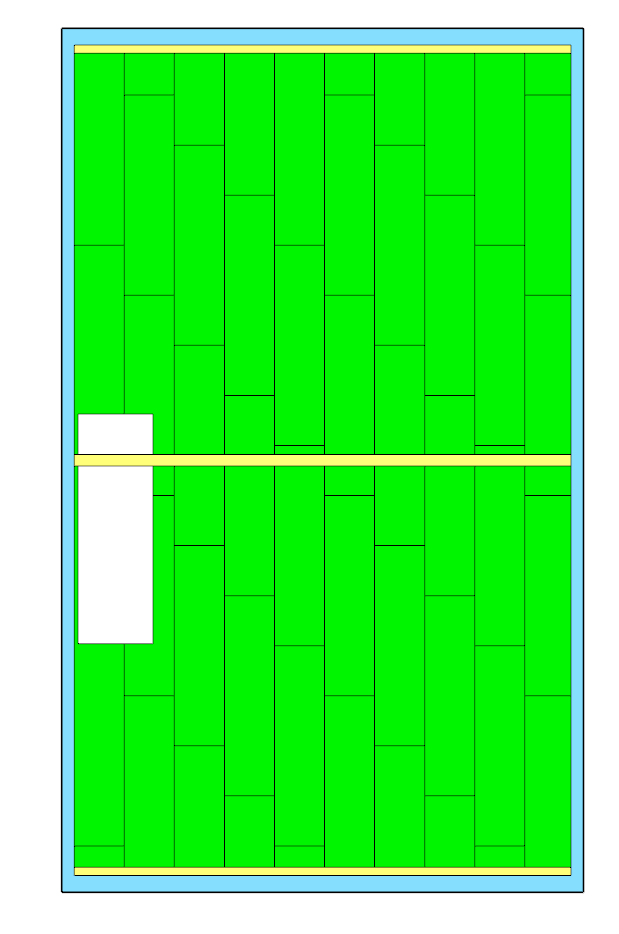

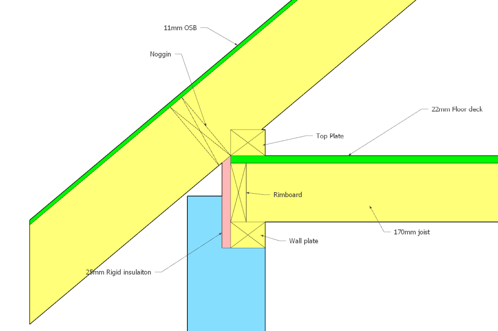

Ok here's a proposal.
Install a Filch beam of 180x30 steel and 45x170mm timbers midway on the short wall, I assume the intermediate wall is strong enough to hold it.
Bolt 45mmx170mm ledgers  to the perimeter walls and use joist hangers to hold them.  Add an airtight membrane behind them and you'll have a continuous airtight barrier from the existing first floor
Floor with 22mm Caberdeck or similar
Add wall plates on top of the caberdeck and a 120 x240mm ridge beam.
This will allow you to drop 220mm cut timber joists conventionally on as a roof.
That's my detail for the eaves

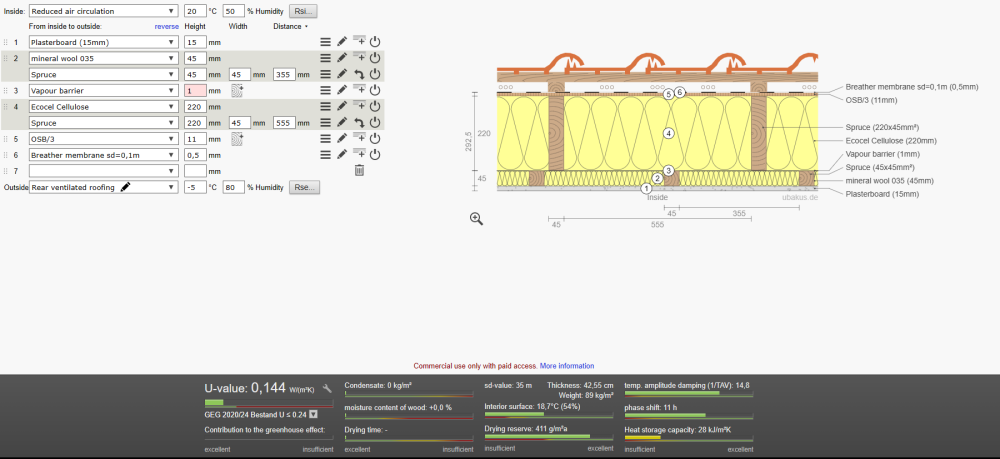

And here's how I'd run a membrane to ensure excellent airtightness.
This is the roof buildup i'd use.
Floor thickness ~200mm.
Roof U Value = compliant
No crane needed.
Excellent air tightness, noise protection, fire performance, heat protection. rodent protection.
All off the shelf materials apart from filch beam.

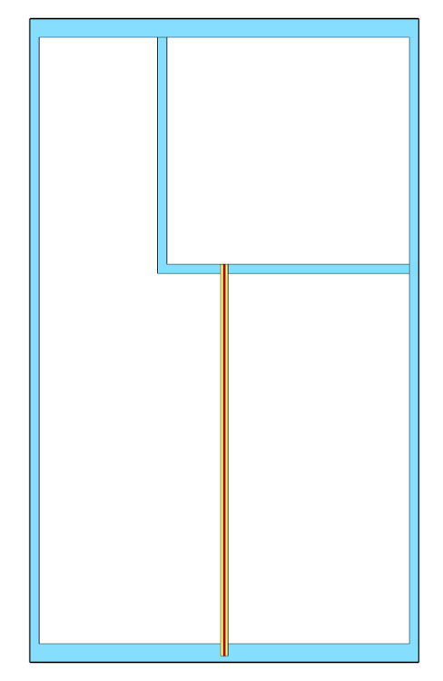

So Iceverge's Flitch Beam dimension prompted me to check the previous RSJ calculation performed by Deepseek/ChatGPT.
There was a flaw in their assumption which led them to oversize the RSJ to ~350mm depth. They assumed the RSJ would carry the entire floor width however in reality it probably only carries half the floor (one masonry wall will carry a quarter of the load and the other masonry wall carrying the other quarter).
Does this sound about right?
As far as the foundation goes, both masonry walls go right down to the foundation. the foundation is clay but compacted like iron and more than a meter deep. If we go down the RSJ route, I'll have to get structural engineer to sign off on the foundation.
Thanks again

Interesting thread this and @saveasteading makes a great point  offering up the cold formed steel joist option. They can be remarkably cost effective when you take into account the labour element.
On 13/03/2025 at 01:24, Pappa said:
I'm attaching a sketch I've made of the structure of my first floor.
Good set of diagrams, well done. Having had a very quick glance at this I can see that the primary span that needs navigation is (5.995m) say 6.1 m over the centre of the supports. I assume there will be some Velux, maybe a dormer so you have some point loads here from trimmers.

I'm going to lead you down the route of considering cold formed steel joists here. Now cold formed steel joist design often entails some horrific calculations and unless you have (as an SE) a good knowledge of this and software / spreads sheets it's not your bag. For me this is in my comfort zone so it goes in my toolbox of attic / barn conversion tricks and design methods. Incedentally there are a  few companies that use "extendable " cold formed (cf) joists as a solution. Essentially you sister the existing timbers with cf joists and avoid disrupting the noggings holding the ceilings below.
If I was doing this I would check early that I can get a compliant stair in and headroom in the attic, see where the point loads are, say from roof trimmings. Look to see if I can increase the structural floor thickness (but then you may need that one extra step in the stair that mucks up everything!) and check the existing eaves detail to make sure I can get good support, ideally spreading the loads.. Depending on where you are in the country you have different arrangements of structural eaves detail and it is essential to get your head round this. Have a look on the internet on how a pole plate roof works and a 1/3 rafter / joist eaves works.
Now many posters have suggested timber type solutions but attic conversion are tricky as it's the detail that is often the issue. I can see how many posters on BH are suggesting ideas but attic conversion are a different animal.. as not least they are conversions.
Hope this helps a bit.

So the RSJ we were considering as per @Iceverge plan above... The top masonry wall there is a door in that position at ground floor (which isn't a huge problem, we can brick that door). However, on the south side of the plan... that wall doesn't actually go down to the foundation. There is an opening underneath it for a bay window! So it's likely that wall is already resting on a steel beam (did they have steel beams 120 years ago?).
We could potentially have the RSJ slightly to the left so the new spans would be 4m and 2m. Span table says we should be able to get a 75mm x 175mm joists across the 4m span. To keep the joist depth low.

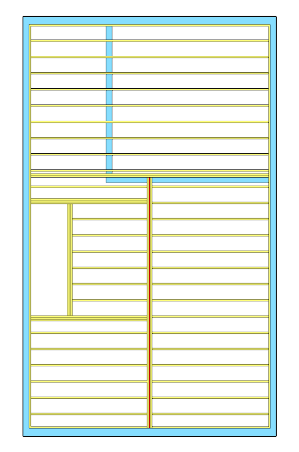

Bear in mind what @Gus Potter pointed out.  You won't easily get these to bear on the party walls and there is likely a lintel over a window on the outside walls which will mess you up.
Thanks
This new design evades windows and doors downstairs.
400 centers.
bottom right quadrant is made up of 72 x 170 timbers
everywhere else 44 x 170
I'm not sure if the top connection of the RSJ is too close to the adjacent door.
The RSJ is basically 5 x 10mm steel plates bolted together but I'm sure a SE will be able to come up with something more efficient.
Thoughts please?

@Gus Potter and the other SEs on here....
could we consider plating a very big timber on that cross wall and flying it across the space to pick up 4 or so joist ends.
or bolt a steel channel there?
Al joists then parallel to the stair opening.
The more I consider this the more I wonder why we don't use bolt together steel trusses for loft conversions.
Say something like 50x50x5mm angle iron, precut and all holes drilled. Carry them up the stairs and bolt them together in situ. Cost might be £300 per truss but say 15 of them £4500 could be absorbed in the cost of the conversion.
Relatively light weight and (guessing here) should easily be able to span the 10m in OP's house.
You'd need to take an airtightness layer on the outside and Insulation on the deck like a warm roof but there's no rocket science involved.
Something like this.
Edited by Iceverge
