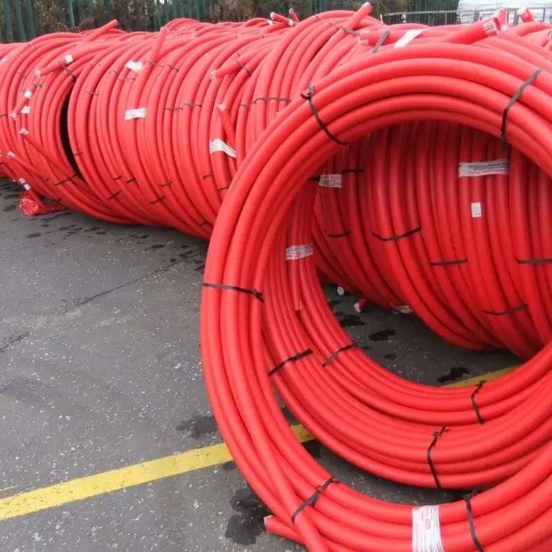

Iceverge Posted March 10, 2025 Posted March 10, 2025 Plain string with nothing tied to it is often fine to get pulled through a duct by a vacuum. Your situation sounds unfortunate but not to worry, we're all learning and in the grand scheme of things, it won't be a major life regret. The plan to dig, add an accessible junction box and run a bigger duct is probably the best options at this stage. This stuff isn't that dear.
