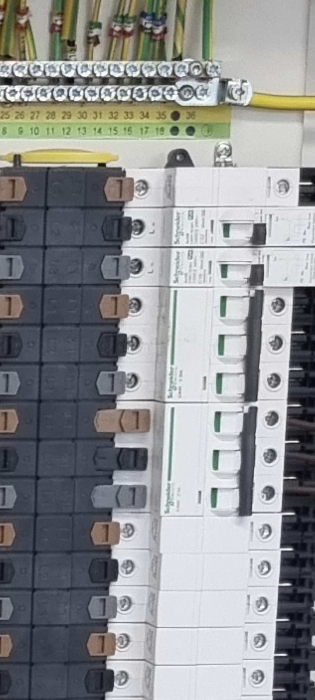

January 1, 20251 yr Ok so I work on the industrial side of things, mainly 3 phase.  But the schneider acti9 isobar gear is the ultimate in reliability and safety for my 2p. The 3 phase boards have a link kit so they can be converted to single phase. So an 8 way board becomes 24 ways  It's pricey though. But I guess you get what you pay for. Hager are fair, but unless you keep all the breakers perfectly square, the fronts are a bugger to get on and off without tripping breakers.... (but we all shouldn't be taking covers off live anyways)   Edited January 1, 20251 yr by FuerteStu
January 1, 20251 yr 46 minutes ago, FuerteStu said: But the schneider acti9 isobar gear is the ultimate in reliability and safety for my 2p.  Is that the new stuff with incomers that like plug in on springy clips? Saw a brand new board burnt out.
January 1, 20251 yr 8 minutes ago, Onoff said:  Is that the new stuff with incomers that like plug in on springy clips? Saw a brand new board burnt out. I liked the old square D QOE boards because you could hot swap the clip in MCB's to save shutting down a whole office block. Not that I would admit to doing that.
January 1, 20251 yr The thing for me is the sliders, it makes the bus bar teeth safe when disengaged, and covers the breaker terminal when engaged.  The breakers clip into the board and don't need a neutral or earth fly lead for their rcbo's  I've only ever seen one board with a failure, and that was due to terminals being loosely tightened. The metal and plastic seems much better quality than other brands
January 2, 20251 yr 6 hours ago, FuerteStu said: The thing for me is the sliders, it makes the bus bar teeth safe when disengaged, and covers the breaker terminal when engaged.  The breakers clip into the board and don't need a neutral or earth fly lead for their rcbo's  I've only ever seen one board with a failure, and that was due to terminals being loosely tightened. The metal and plastic seems much better quality than other brands  The one I saw was burned out on one of the theoretically maintenance free connections, the sliders, on the DP switch. Assembly fault, spring tension issue etc ???  It went straight back to the supplier and was exchanged.  Might have a pic somewhere.
