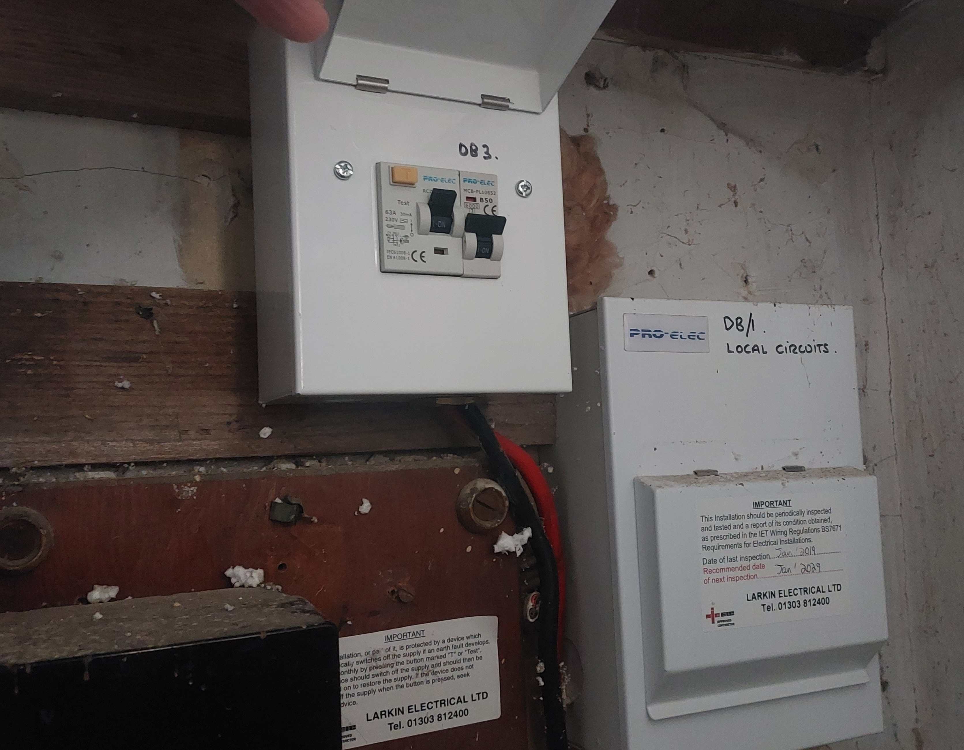

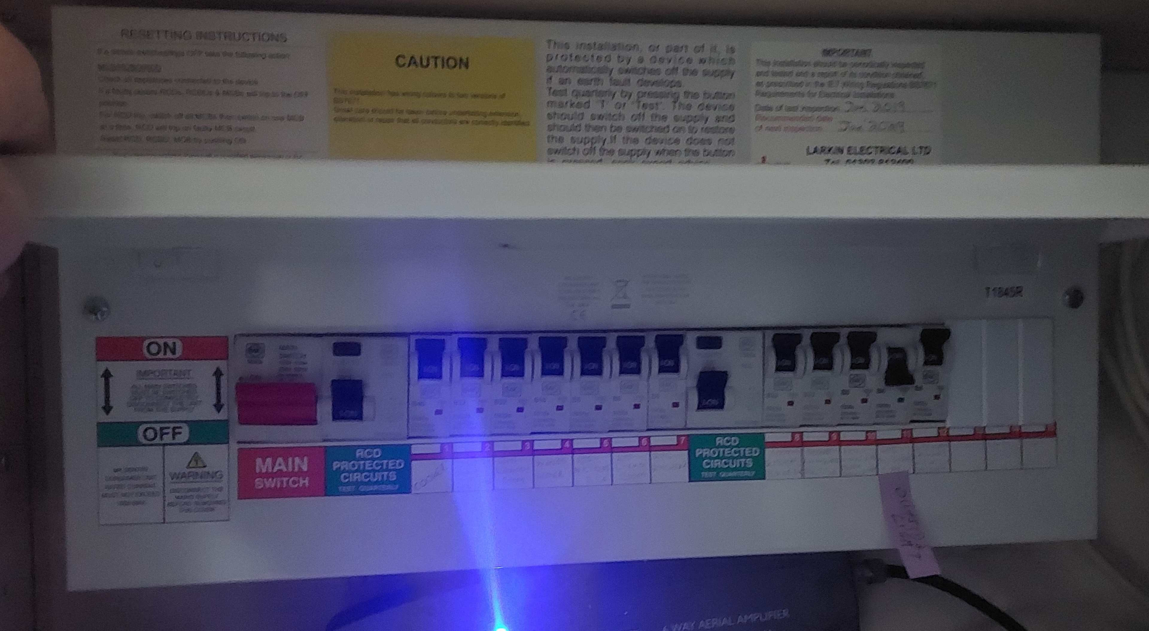

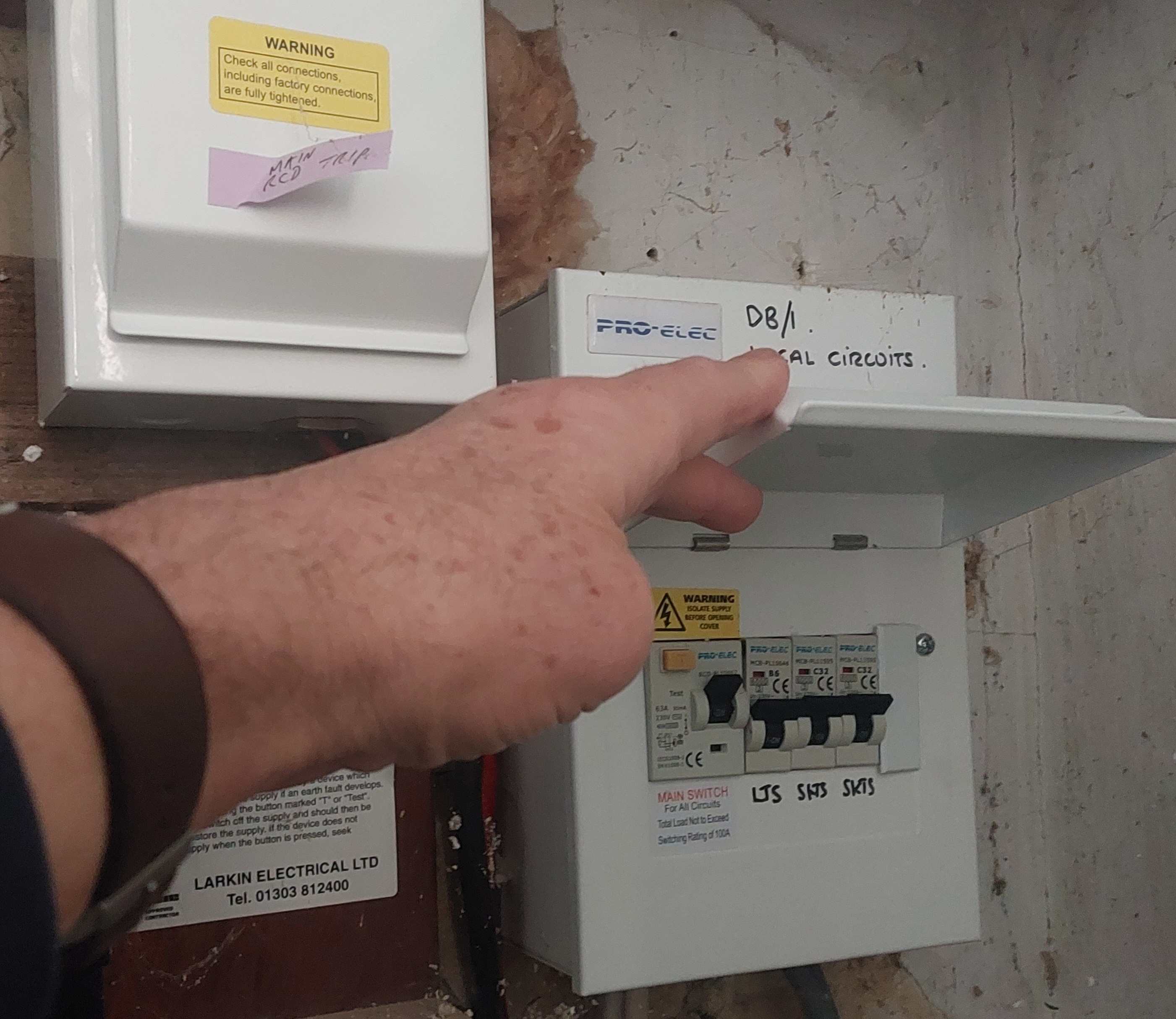

saveasteading Posted yesterday at 10:07 Author Share Posted yesterday at 10:07 Attached photos of the apparatus. The old black box on the far left isn't an issue. Next along trips sometimes. The next along is a different subcircuit. Picture 2 is inside the second box for completeness..not relevant though. This power flies through the attic to the box in pic 3. It can ping on the orange switch to the left. At the adjacent black 'fuses' I found which circuit was the problem and then which switch, which is currently taped over and out of use....hence the fuse turned on again. Link to comment Share on other sites More sharing options...

saveasteading Posted 23 hours ago Author Share Posted 23 hours ago @SteamyTea wondering if you could continue your instructive, with reference to the photos. I don't understand why one pings rather than another, esp as the fault under discussion can trigger either. 44 minutes ago, elite said: attic switch Switch in a room, up to the attic above where we would hope any damage is fairly obvious. Link to comment Share on other sites More sharing options...

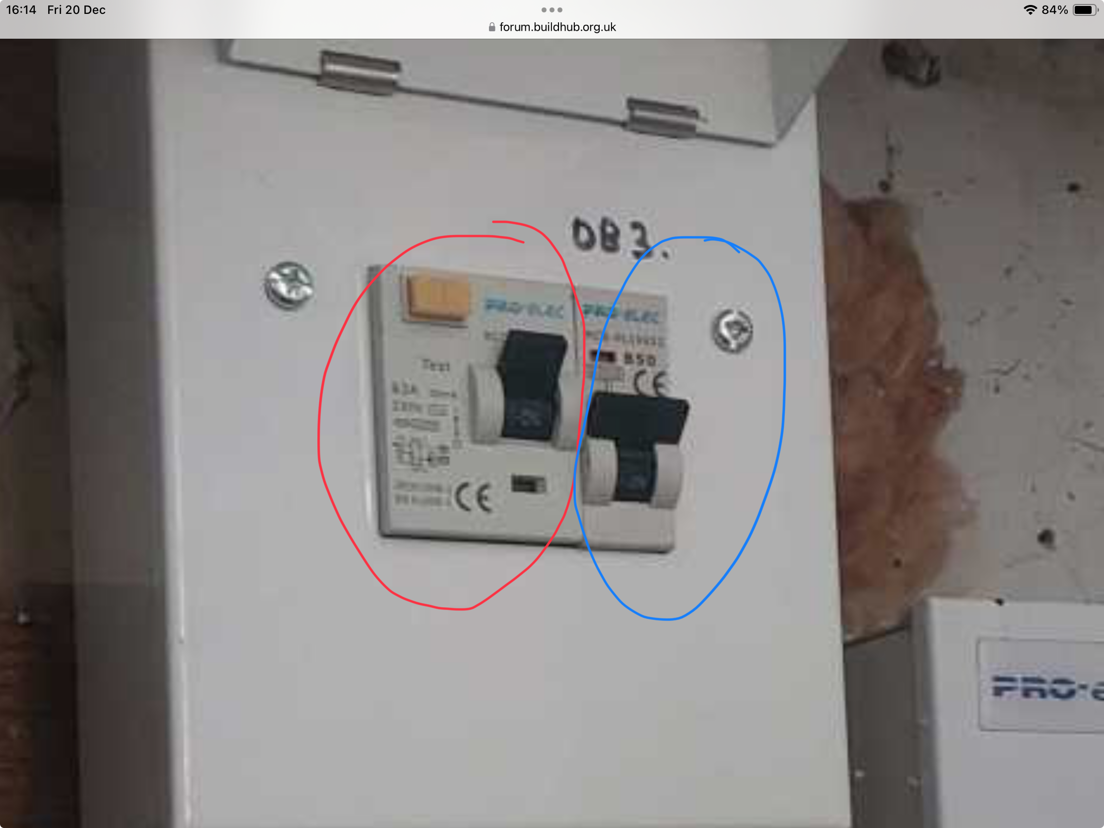

SteamyTea Posted 22 hours ago Share Posted 22 hours ago 27 minutes ago, saveasteading said: wondering if you could continue your instructive, with reference to the photos I would like to, but for a change, I am going out tonight, very rare occurrence for me that is. A quick look at them and the seems to be MCBs (mini circuit breakers which are simple over current devices, or modern fuse wire), with RCDs (residual current devices) on the incoming supply. @ProDave may be better placed to identify the components. It is always possible that the MCB has gone faulty. Link to comment Share on other sites More sharing options...
G and J Posted 22 hours ago Share Posted 22 hours ago I believe the one ringed in red will trip if there is an imbalance in the current in the live vs the neutral, i.e. some juice is leaking out of the circuit, usually to earth. (In this case probably through a still gooey mouse corpse - but the good news is they dry and as they do their insulation level increases till it doesn’t trip out any more). The one ringed in blue will trip if too much current is taken. Say if the mouse body is shorting between the switched wire (i.e. a live wire) and a neutral. You could wait and see if said body (or bodies) dries enough to save you having to firkle through the loft. But popping your head up to put some good snap traps up to reduce or remove the population would be a really good idea. I’d not recommend bait, it encourages them in (they think it’s a yummy food source) and then they die and stink. If you are going to bait, do it outside and reduce the population nearby. Our experience is that that is the most effective long term approach. Link to comment Share on other sites More sharing options...
andyscotland Posted 19 hours ago Share Posted 19 hours ago @saveasteading just to be sure I've understood: the box marked DB3 that @G and J has marked up is at the origin of your supply, and the power is fed from there to the multi-way split load board in your final photo? And the trip that is going is the one G&J has circled red, knocking out the whole system? As @G and J says, that one is an RCD and will trip on a very small imbalance between the current going out on the phase (live) conductor and coming back on the neutral. It's not possible to see in the photo what rating that is, it will likely either be 30mA or 100mA. The one you have marked/switched off in the downstream board is an MCB and will only fail on overload (likely 6A if it's a standard lighting circuit). Therefore you have a fault that is causing a very small amount of current leakage. This means either a high-resistance short between phase and earth (e.g. a mouse body, or degraded insulation) or possibly a dead short between neutral and earth : the neutral is not quite at zero volts so connecting to earth will cause a very small current to flow. Assuming you haven't recently made any changes to the system, and have tried removing/replacing the lamp itself then the most likely explanation is either recent cable damage, moisture ingress to a connection point, or failure of a connected electronic circuit (which sounds unlikely if you have isolated it to only happening when a specific light is switched on even with the lamp removed). There could be a couple of reasons why it is tripping at the origin rather than at the RCD protecting the right hand half of your downstream board: * Possibly, both RCDs are 30mA and the same type. You would generally try to avoid wiring RCDs in series like that because there is no guarantee which will trip first on a fault. Usually I would either try to run cable between boards in a way that means it doesn't need an upstream RCD (eg using steel wire armoured cable) or use a 100mA time delay RCD upstream to increase the chances that the downstream RCD trips first. However it is not always possible/allowable to do this and so you get the nuisance that sometimes a fault will trip the whole installation. * It may also be that the lighting circuit itself is only producing a very low leakage but there is leakage elsewhere in the installation which means when it all adds up at the origin it is just enough to trip the RCD. It's common for electronics (computers, LED drivers, smart stuff) to produce a small level of background leakage due to the way electronic transformers work. In fact it is even possible that the lighting circuit has always had some cable damage causing leakage but only recently have you connected more electronics elsewhere and so it has now become a problem. Ultimately the only thing you can really do is get a proper insulation resistance tester and try first to isolate whether there's any part of the system with a lower-than-expected live / neutral resistance to earth. You will need to be very careful to disconnect absolutely everything electronic before testing to avoid damage. Link to comment Share on other sites More sharing options...
