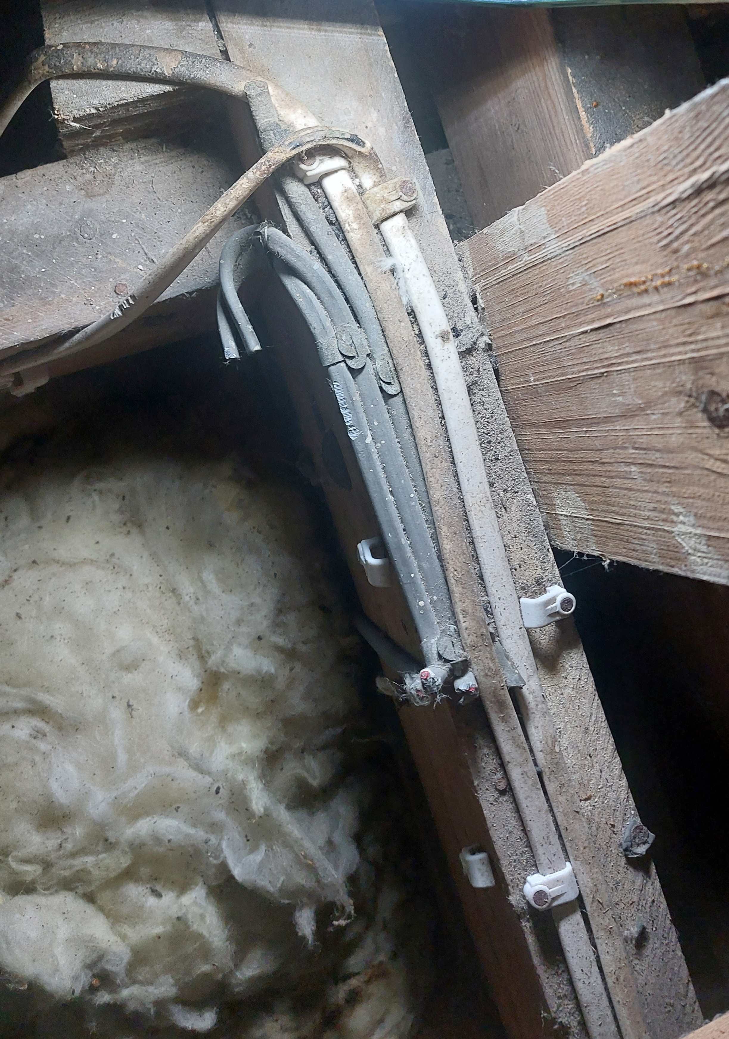

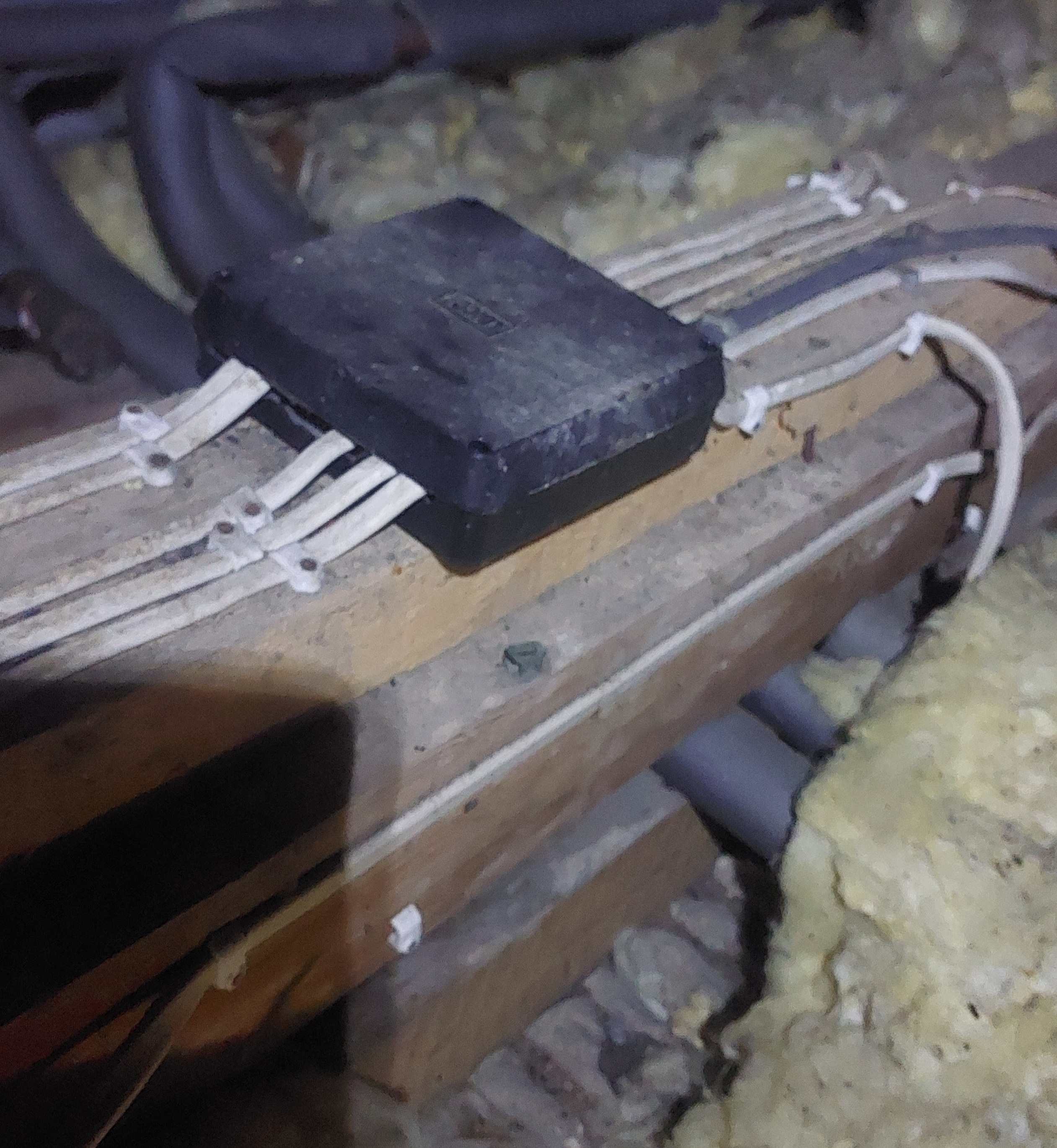

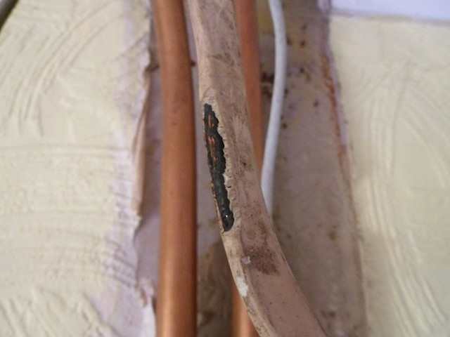

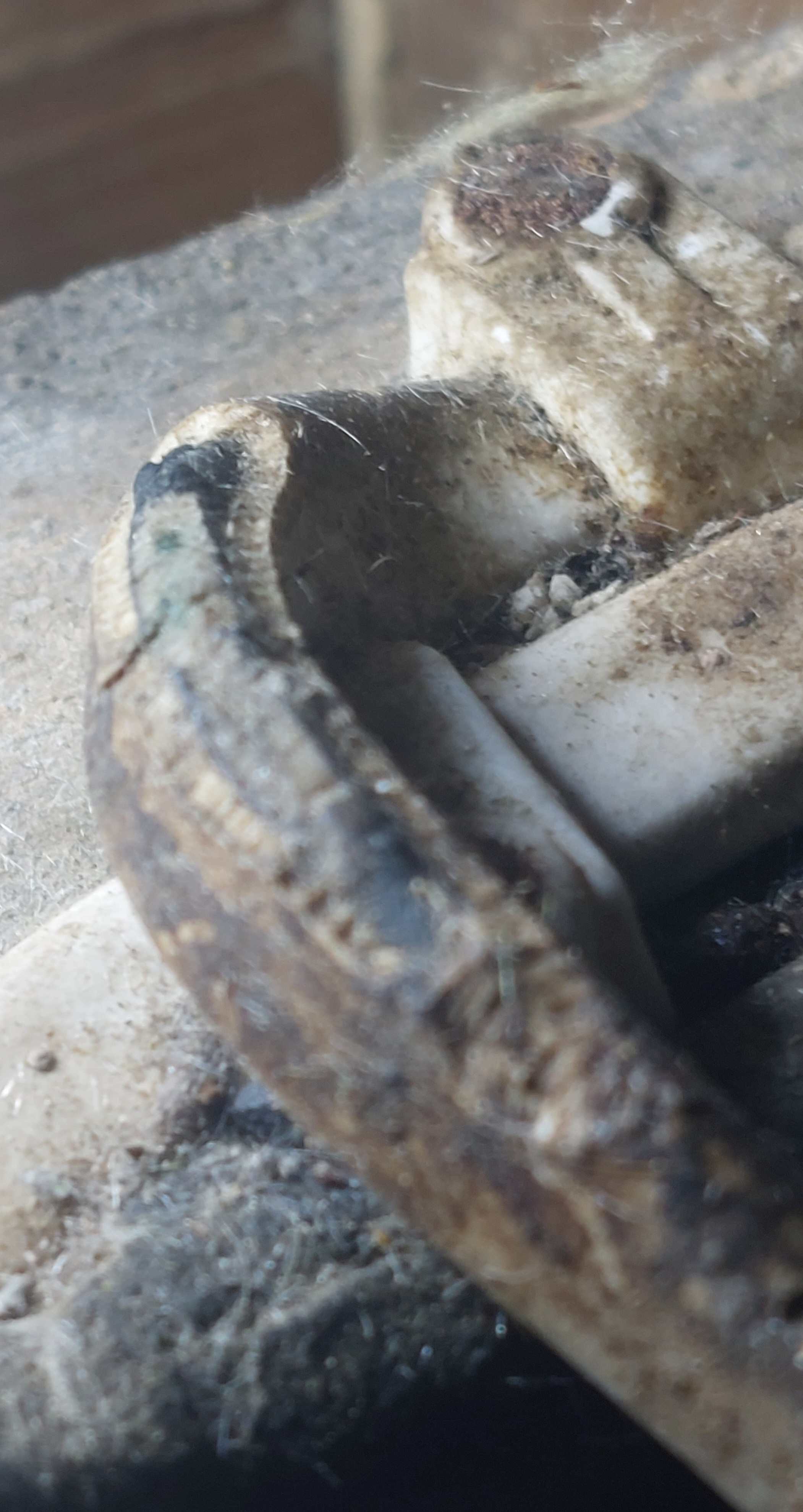

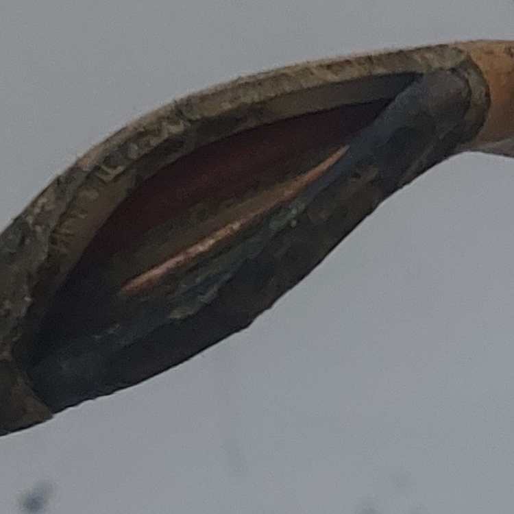

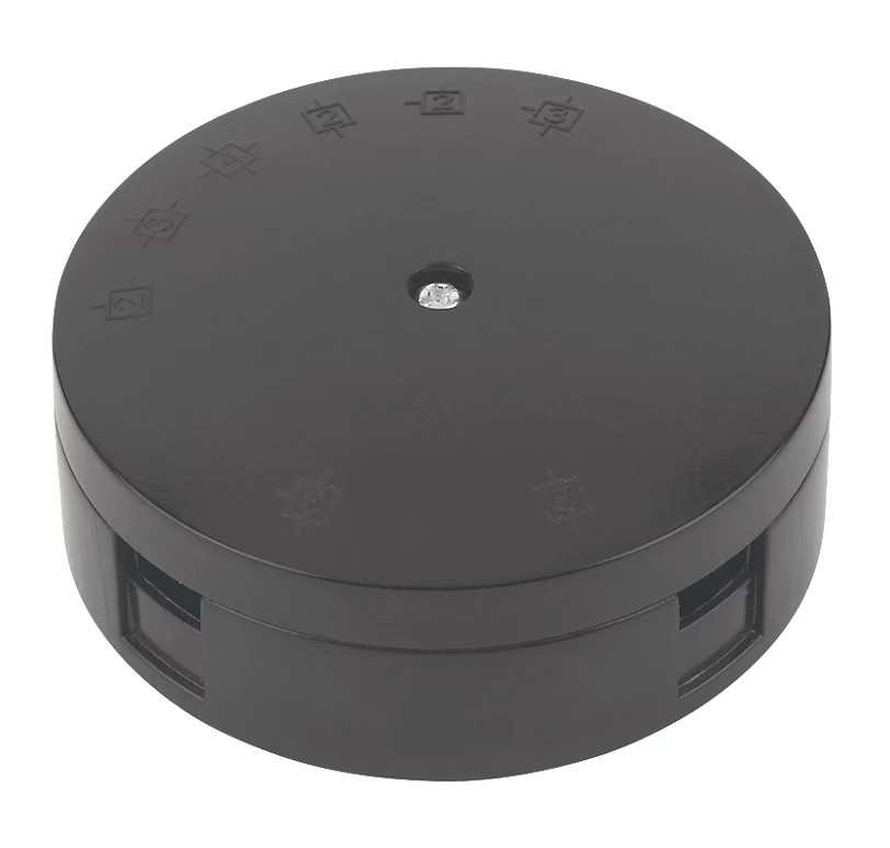

December 22, 20241 yr Author I've done it. I fought through the cobwebs like Prince Charming, but the good news is the absence of clutter in that remote corner. There is rodent damage. Also a strange brown crud on the cables there. on the first photo we see both the lamp and switch cables. They run to a large connection box. The black wire is exposed over about 30mm but does not look to be nibbled itself. There are some more mouse nibbles near, to the left, but very shallow. I actually see more clearly on the photo than I could up close, but should have snapped it further back to get the focus better. The near, out of focus, bit looks worse than it did in real time. I'm thinking the brown stain might be wood resin dripping from above, perhaps in summer heat or from occasional leaks. Thus attracting nibbling. Then that water now gets into the cable? There was no sign of dampness but it has been very wet and windy and this is under the ridge and one drop might do it....or some of that resin has built up inside. I'd have thought that I'd have to see copper for any short but I don't know. No dead things. Lots of historic mouse (and some rat) droppings But the second dose of bait is untouched so there weren't many around. I didn't look in the connection box. Well, I lifted a loose corner and nothing was apparent. The cables simply drop through the lath and plaster ceiling. Nothing dead visible in the holes. The grey cables are long redundant. I'm guessing and welcome any expert or other input.

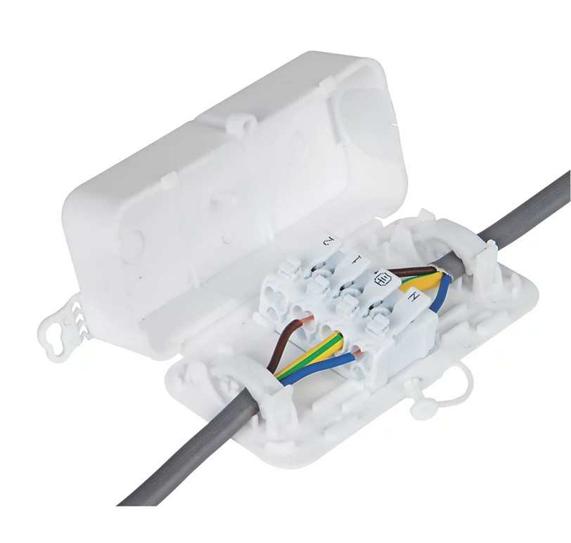

December 22, 20241 yr Author 1 hour ago, SteamyTea said: So how you going to fix it? I'm hoping that someone is going to say, yes that's obviously causing the issue. Or otherwise. And why this shorts when only one core seems to be damaged. Then I'm thinking I replace that portion of cable, preferably without taking down the lamp fitting because....it all makes work.... Can I sensibly cut out 1m and join with a box or a connector each end? I know one electrician who refuses to use sometimes, especially the push fit type.
December 22, 20241 yr I think you can use WAGO connectors as a permanent fix, ask @ProDave as he knows what he is doing up your way. 22 minutes ago, saveasteading said: And why this shorts when only one core seems to be damaged. Who knows, electricity is a quantum phenomena, so all sorts of magic is happening. There may be another problem that has been masked by this small amount of damage i.e. shared neutrals, but you need to change that bit of cable anyway, so nothing lost really.
December 22, 20241 yr Author 25 minutes ago, SteamyTea said: he knows what he is doing up your way. I'm down this way, nearly France, but electricicles behave the same. Good reminder. It was Wagos that the electrician didn't like. I had done cabling on another daughters old house and asked him to do the final connections but he replaced them all. I will take advice from @ProDaveor other experts if they would please advise. Edited December 22, 20241 yr by saveasteading

December 22, 20241 yr It's possible that's enough damage to the cable to trigger nuisance tripping. The only way to be sure is to isolate the cable and see if the problem persists.. But it could just mean you're isolating the problem that's further upstream. It's a multiple test scenario. There was a stage when the grey pvc on twin and earth broke down and left an oily residue. I think they changed the formula. It was rather tasty to our rodent friends, I've seen them strip off metre long sections, leaving only the inner cores. It doesn't take much removal to trip an rcd if there is moisture in the air, opening a section allows capillary action to trigger conductivity through what can barely be seen. If it was in the live it would just vapourise the water, but the neutral to earth allows an alternative path and the rcd doesn't like that. My suggestion, replace.. And see if it's still a problem, then investigate further.
December 22, 20241 yr Author 1 hour ago, FuerteStu said: My suggestion, replace.. Yes that's the plan. I was hoping for such an obvious bit of damage so it's good news. I need advice now on an acceptable way of patching in a repair, eg the boxes. They seem appropriate to me as I can fix them to the joist to avoid any trailing cable. 2 hours ago, G and J said: try it a few times I did, including after the visitors left, taking multiple chargers with them.
