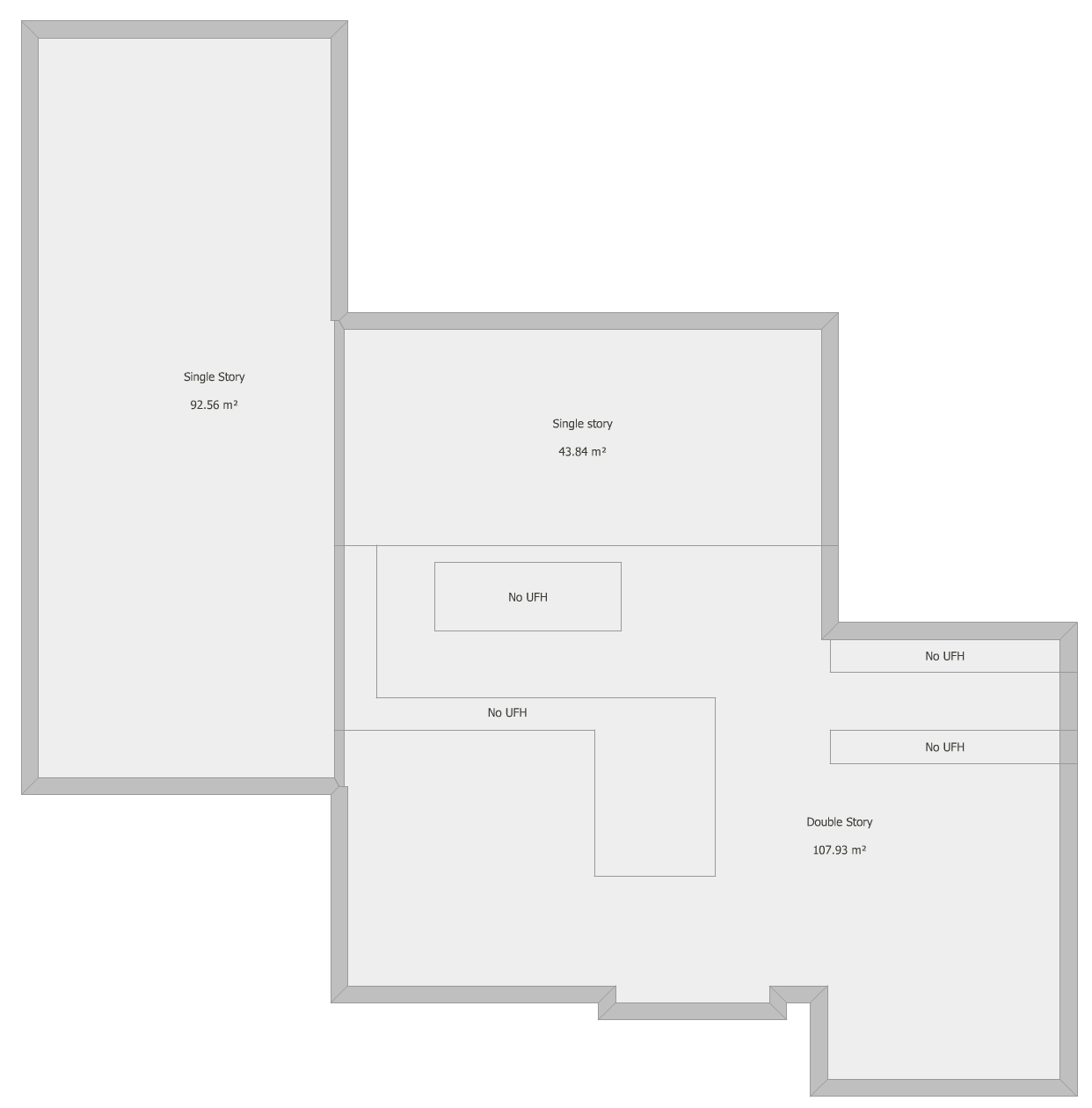

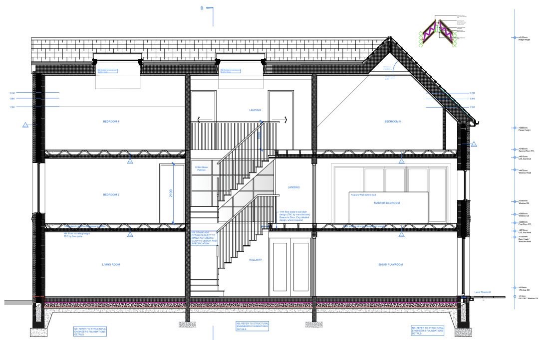

SBMS Posted November 23, 2024 Posted November 23, 2024 (edited) Planning our upstairs heating for our build. Downstairs is wet UFH, ASHP. We’ve got a first and second floor (attic rooms). Some small risk from overheating due to a fair bit of glazing so would like some active cooling upstairs. Trying to decide what to put upstairs. UFH upstairs on two floors is coming out expensive. Mainly labour costs (we are not going to fit it ourselves). Seems that it’s overkill if heat requirement is low? And we can’t cool. I thought about putting split AC units in each of the 5 bedrooms and using them for heat as well. But not sure about having to remember to turn them on if it gets nippy, fans running etc? But cooling would be fine. I therefore thought about a ducted AC system upstairs (maybe a couple of zones) that could do heat and cooling? Other option is fan coils. I don’t quite understand the condensation risk - does all pipe work need to be lagged? Do I need condensate drain off at each unit? Are they as effective at cooling as an AC system? Would appreciate peoples throughts: Upstairs options option 1 - UFH + split AC option 2 - radiators + split AC option 3 - split AC (heat and cool) option 4 - ducted AC (heat and cool) option 5 - fan coil units (heat and cool) Edited November 23, 2024 by SBMS

ProDave Posted November 23, 2024 Posted November 23, 2024 I am another who put electric points for bedroom panel heaters and have never used them. But @SBMS mentions upper floors, so is this a THREE storey house? If you wanted to fut UFH just in case, the parts are very cheap, why not DIY?

SBMS Posted November 23, 2024 Author Posted November 23, 2024 (edited) 4 minutes ago, ProDave said: I am another who put electric points for bedroom panel heaters and have never used them. But @SBMS mentions upper floors, so is this a THREE storey house? If you wanted to fut UFH just in case, the parts are very cheap, why not DIY? @ProDave correct - its rooms in the attic so technically 3 floors. I could do UFH upstairs (would rather not fit myself as I simply don't have the time for that - will be doing as much as I can such as MVHR but need to be realistic).. but it doesn't provide any cooling hence looking at either ducted AC/split AC or fan coils? House section for context: Edited November 23, 2024 by SBMS

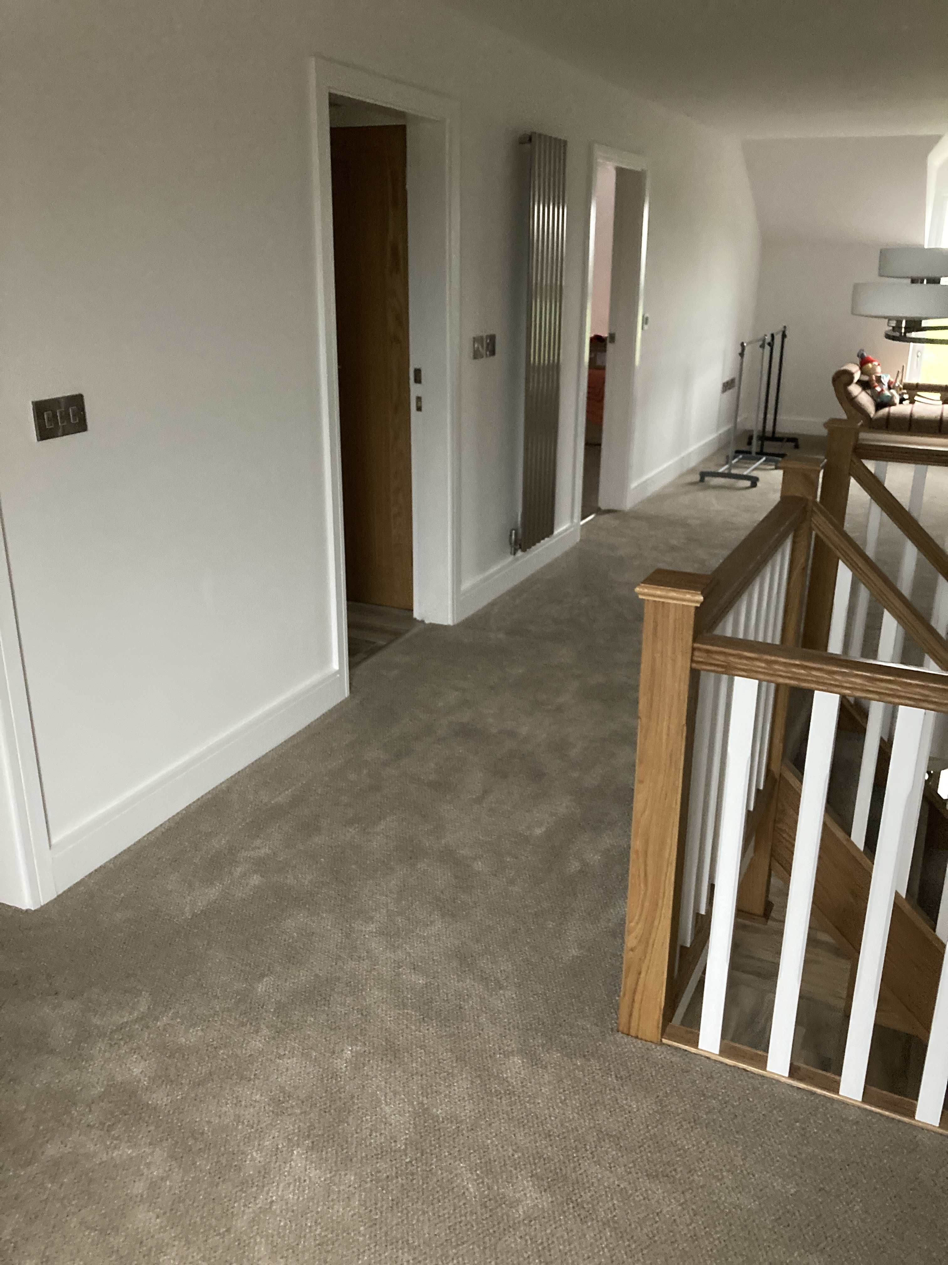

nod Posted November 23, 2024 Posted November 23, 2024 33 minutes ago, SBMS said: Nod - agreed and we are pretty well insulated to be honest. 200mm cavity, blown beads etc. I know your last build you put radiators and never used them but I can’t bring myself to put no heating upstairs. Cold wife and cold children. I agree I would definitely put Rads in the bedrooms and bathrooms We did that previously and against my wife’s wishes have installed stainless Rads But we will never use them BUT we would of had difficulty selling our previous house without the option I definitely wouldn’t go to the trouble and expense of UFH in bedrooms though UFH isn’t great with carpets Definitely not thick wool carpets that we like

SBMS Posted November 23, 2024 Author Posted November 23, 2024 13 minutes ago, nod said: I agree I would definitely put Rads in the bedrooms and bathrooms We did that previously and against my wife’s wishes have installed stainless Rads But we will never use them BUT we would of had difficulty selling our previous house without the option I definitely wouldn’t go to the trouble and expense of UFH in bedrooms though UFH isn’t great with carpets Definitely not thick wool carpets that we like This is actually a great point. All our rooms upstairs except wet rooms will be carpeted and with thick wool as my wife likes that... I think that knocks UFH out (although might price up wet UFH in the bathrooms). Would you consider an AC system (split or ducted) upstairs - or fan coils, or just standard rads and hope it doesn't overheat?
