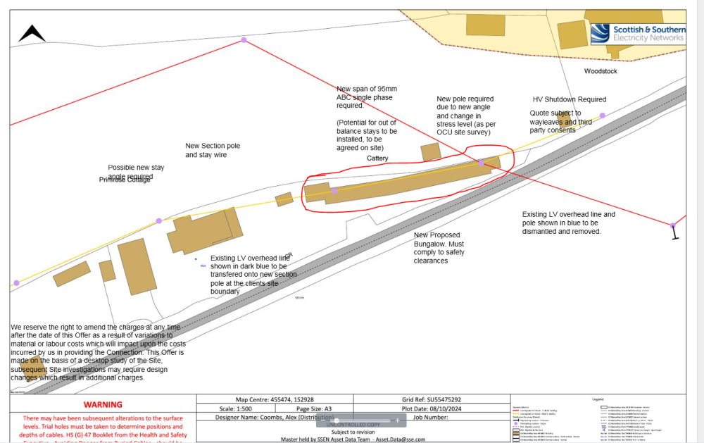

flanagaj Posted October 18, 2024 Posted October 18, 2024 I was planning on hiring a 7 tonne excavator with a pecker to break up 200m2 of concrete slab. I was conscious that there is an LV line that runs along the north boundary and a HV line that runs across the far east side. I was hoping that I could simply crack on and spray hazard markings on the concrete where the HV line runs over. As I am using a pecker, there is no requirement to be extending the boom vertically, so the likelihood of any incident is very small. I am just conscious that if I have to request that it is isolated then once again, I am going to be paying thousands and it's money we don't have. The plan of the concrete that I need to remove is shown below, circled in red. The original plan was to hire a 1.5 tonne machine, but I don't think it will do the job. Any thoughts on this one.
Conor Posted October 18, 2024 Posted October 18, 2024 Don't wing this. Think you'd be best speaking to an expert on this, and getting the DNO to approve the RAMS. It could be as simple as goal posts and restricting machine type so it cannot reach within the min safety distance to the HV line.
flanagaj Posted October 18, 2024 Author Posted October 18, 2024 4 minutes ago, Conor said: Don't wing this. Think you'd be best speaking to an expert on this, and getting the DNO to approve the RAMS. It could be as simple as goal posts and restricting machine type so it cannot reach within the min safety distance to the HV line. Ok, thanks. It's ***** expense after expense. I imagine that said expert is going to be £££.
Conor Posted October 18, 2024 Posted October 18, 2024 Just now, flanagaj said: Ok, thanks. It's ***** expense after expense. I imagine that said expert is going to be £££. It's part of the process. You need to budget for these things. I had a H&S expert do a site risk assessment and provide template documentation and recommendations. £250. Pennies in the big scheme of things, I spent more on spray foam. So far this year in our company, we've had one electrical fatality and at least one other near miss. The near miss would have been a fatality if it wasn't for the use of an insulated fibreglass shovel, as specified by the RAMS. 1
flanagaj Posted October 18, 2024 Author Posted October 18, 2024 3 minutes ago, Conor said: It's part of the process. You need to budget for these things. I had a H&S expert do a site risk assessment and provide template documentation and recommendations. £250. Pennies in the big scheme of things, I spent more on spray foam. So far this year in our company, we've had one electrical fatality and at least one other near miss. The near miss would have been a fatality if it wasn't for the use of an insulated fibreglass shovel, as specified by the RAMS. Am I not able to do my own H&S assessment? I was hoping that I could simply follow the guidelines as per document Avoiding danger from overhead power lines GS6 (hse.gov.uk) so long as the excavator boom / dipper cannot reach the overhead line and provide enough clearance, is that not enough?
Conor Posted October 18, 2024 Posted October 18, 2024 4 minutes ago, flanagaj said: Am I not able to do my own H&S assessment? I was hoping that I could simply follow the guidelines as per document Avoiding danger from overhead power lines GS6 (hse.gov.uk) so long as the excavator boom / dipper cannot reach the overhead line and provide enough clearance, is that not enough? I can't comment on your competency There are scenarios you need to cover that might not be obvious to a non expect. E.g. how do you control for ground level changes (e.g. machine operating on a rubble pile) or visiting plant / vehicles? For context, how high are the lines? I'm assuming as HV they are well out of the way? And are you building directly under the lines?
Alan Ambrose Posted October 18, 2024 Posted October 18, 2024 You could transfer the risk by getting someone in. Less than a £1K including disposal / or crushing if you can use the hardcore? The LV line is actually under the slab? You may be able to get free shrouding on the HV line: https://www.ssen.co.uk/our-services/existing-electricity-supplies/shrouding/
flanagaj Posted October 18, 2024 Author Posted October 18, 2024 15 minutes ago, Conor said: I can't comment on your competency There are scenarios you need to cover that might not be obvious to a non expect. E.g. how do you control for ground level changes (e.g. machine operating on a rubble pile) or visiting plant / vehicles? For context, how high are the lines? I'm assuming as HV they are well out of the way? And are you building directly under the lines? The ground directly under the line is a flat concrete slab, so the excavator will always be on solid level ground. Regarding line height, that is a question that I cannot answer.
flanagaj Posted October 18, 2024 Author Posted October 18, 2024 7 minutes ago, Alan Ambrose said: You could transfer the risk by getting someone in. Less than a £1K including disposal / or crushing if you can use the hardcore? The LV line is actually under the slab? You may be able to get free shrouding on the HV line: https://www.ssen.co.uk/our-services/existing-electricity-supplies/shrouding/ I doubt very much that breaking up 200m2 of concrete slab including the disposal is going to cost £1k I suspect the job alone will be in excess of 5k Both the HV and LV are above ground.

flanagaj Posted October 18, 2024 Author Posted October 18, 2024 Thanks all. I have contacted SSEN and they are sending someone out to advise.

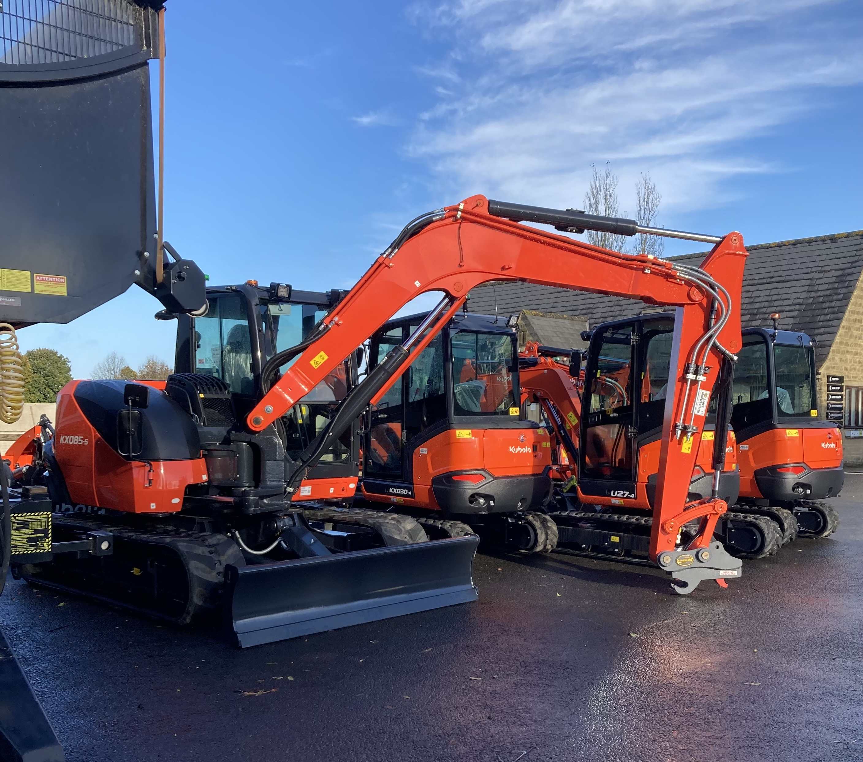

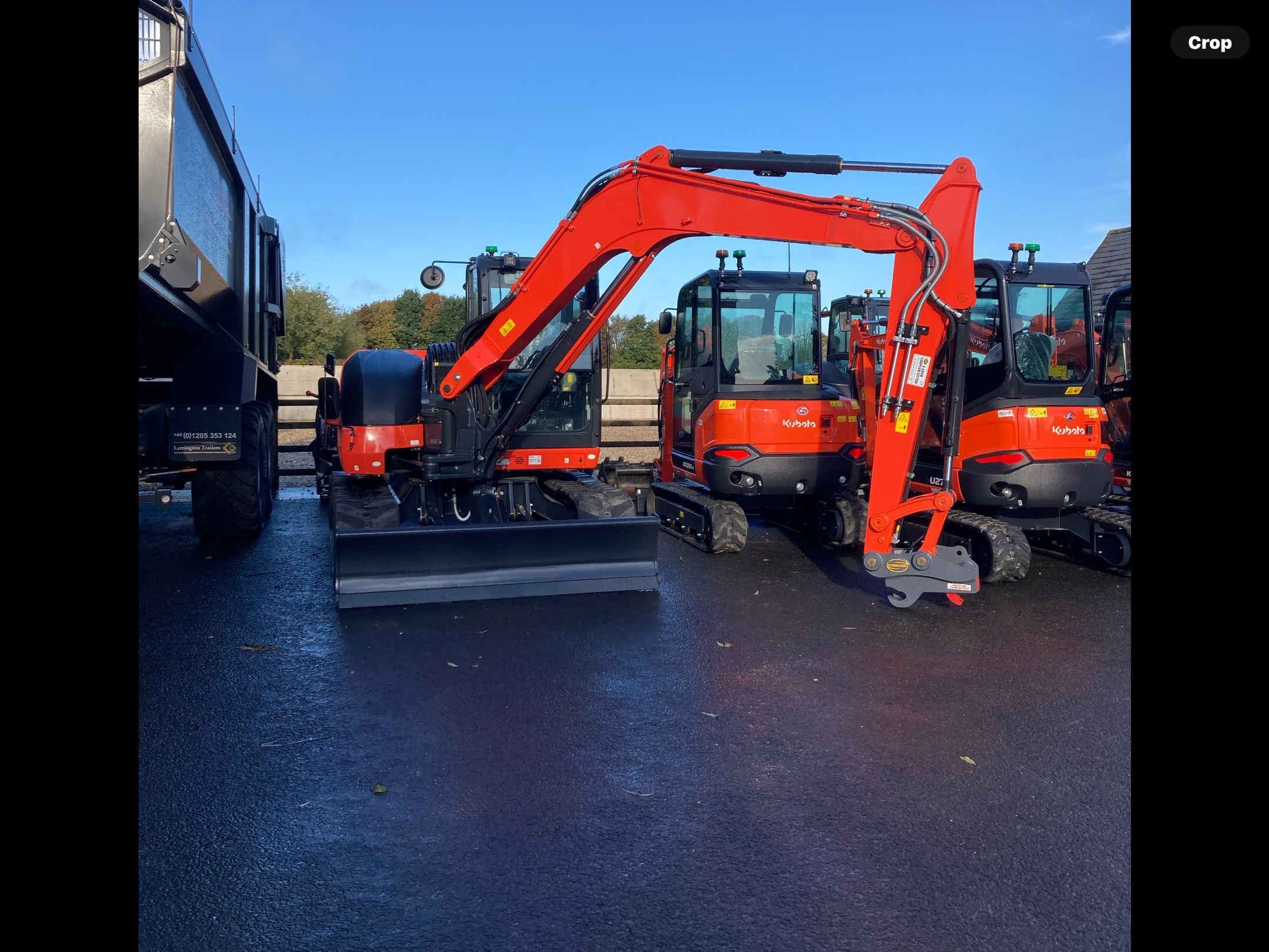

Russell griffiths Posted October 19, 2024 Posted October 19, 2024 for a bit of context I was at kubota this morning. the big machine in the pic is an 8 tonner, next to it is a 3. considerable bigger reach and height. 1
