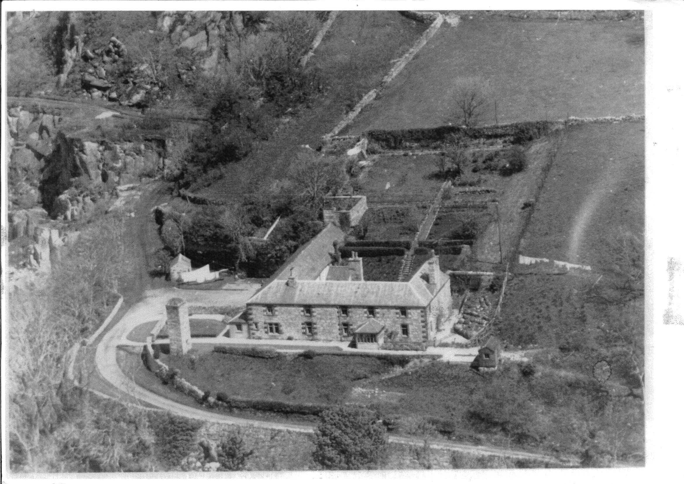

scottishjohn Posted October 13, 2024 Share Posted October 13, 2024 (edited) this discussion It depends what we are really talking about the savings from insulating all houses properly would drop energy consumption so much and it is needed for any system to be effiecent , that that is the way it should go first as a country just chucking heat into to leaky houses is never going to be a good solution to the base problem alot of houses are not big enough to do the obvious of internal insulation , like stud walls etc ,especially the older ones so massive exterior insulation must be the way for those dwellings. non of this is cheap -but insulation is a once only cost Edited October 13, 2024 by scottishjohn Link to comment Share on other sites More sharing options...

scottishjohn Posted October 13, 2024 Share Posted October 13, 2024 9 minutes ago, Beelbeebub said: 27 minutes ago, scottishjohn said: I agree we need to upinsulate alot of houses and external is the preference but that bumps into a raft of issues itself. Fire safety is obviously top of a lot of minds but also damp prevention especially when the roof overhangs are less than the cladding thickness. Then there is the biggie - appearance. External insulation will change the appearance of buildings. In places. Like the cotswolds this is going to be unacceptable. Nationally we need to reach a consensus about priorities, climate change or olde worlde cottages. yes you might have to extend the roof line and as for exterior appearnce ,whilst it would not be cheap you could still apply cotswold stone slips to outside and keep it looking like it did its a money not a tehcnical problem maybe the rates need to go up on badly insulated properties to make people do it .a bit like the window tax of the 1700,s there certainly will be little chance of grants the way the economy is and maybbe a better defintionn of what should have listed status - a lot really should not have it Link to comment Share on other sites More sharing options...

scottishjohn Posted October 13, 2024 Share Posted October 13, 2024 you tell me the reason why one is listed and one not first one is not listed the second is Link to comment Share on other sites More sharing options...

ToughButterCup Posted October 13, 2024 Share Posted October 13, 2024 14 minutes ago, scottishjohn said: you tell me the reason why one is listed and one not ... The golf club , or the Rotary Circle, squash club , Freemasons, or a friend of a friend ..... 1 Link to comment Share on other sites More sharing options...
saveasteading Posted October 13, 2024 Share Posted October 13, 2024 Someone puts a good case for listing. No one disagrees. Listed. It doesn't have to be an amazing building, just significant or rare. Link to comment Share on other sites More sharing options...
