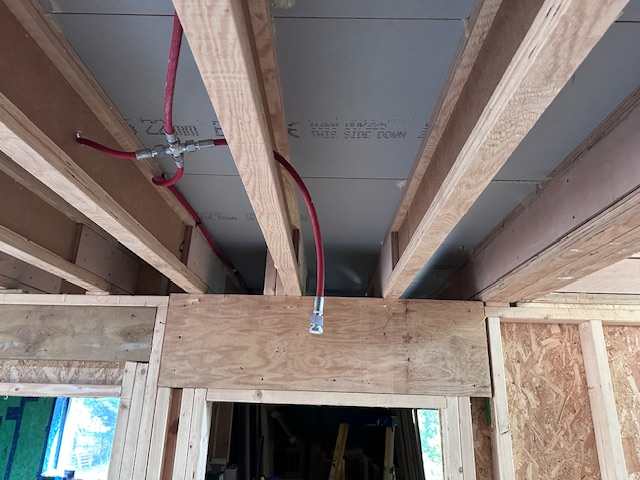

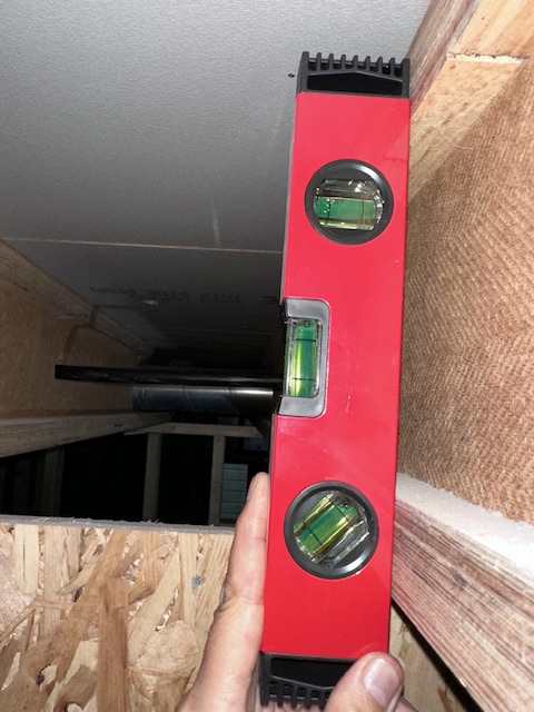

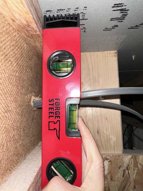

Omnibuswoman Posted September 6 Share Posted September 6 Following some enquiries with the joist manufacturer, a number of issues have been identified with the fitting of the I-joists and build that are going to require remediation. These include a failure to place blocking plates between joists as they sail across the supporting walls, meaning that the joists are beginning to twist (see photos below). The joists are glued to the eggerboard above, so making the joists straight again to fit the blocking plates is going to be extremely tricky. If they are not straightened, they won’t perform the function they are designed for. In addition, the supporting walls that sit above each other are not, in fact, sat above each other. There is approx 50mm between the face of the wall on the first floor and the face of the wall on the second floor (we discovered this when trying to send a pipe up from one to the next, and realised that it emerges in a different place than expected). The technical manager at the I-joist company is “very concerned” about this, as the joists are not designed to carry the second floor load - it should be transferred down via the walls sitting atop each other. We now need to explain these issues to our builder and ask him to undertake the difficult job of remediating these issues. Has anyone experienced anything similar? And does anyone have any advice about how to go about this? Should we consider getting an independent structural survey done, or involve Building Control to strengthen our position? cheers Omnibuswoman Link to comment Share on other sites More sharing options...

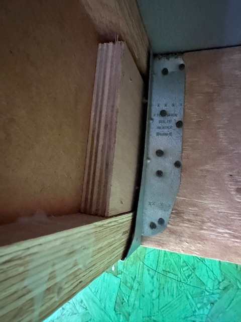

Omnibuswoman Posted September 6 Author Share Posted September 6 This joist has been rested on a scrap bit of OSB because the wall was built too short… Not all hangers have been nailed to the joists. Link to comment Share on other sites More sharing options...
joe90 Posted September 6 Share Posted September 6 43 minutes ago, Omnibuswoman said: Not all hangers have been nailed to the joists. 48 minutes ago, Omnibuswoman said: Should we consider getting an independent structural survey done Not in my opinion, tell the builder it’s not right and to correct it. Why should you spend more money. 48 minutes ago, Omnibuswoman said: The technical manager at the I-joist company is “very concerned” about this, as the joists are not designed to carry the second floor load - it should be transferred down via the walls sitting atop each other. Tell the builder this. 1 Link to comment Share on other sites More sharing options...

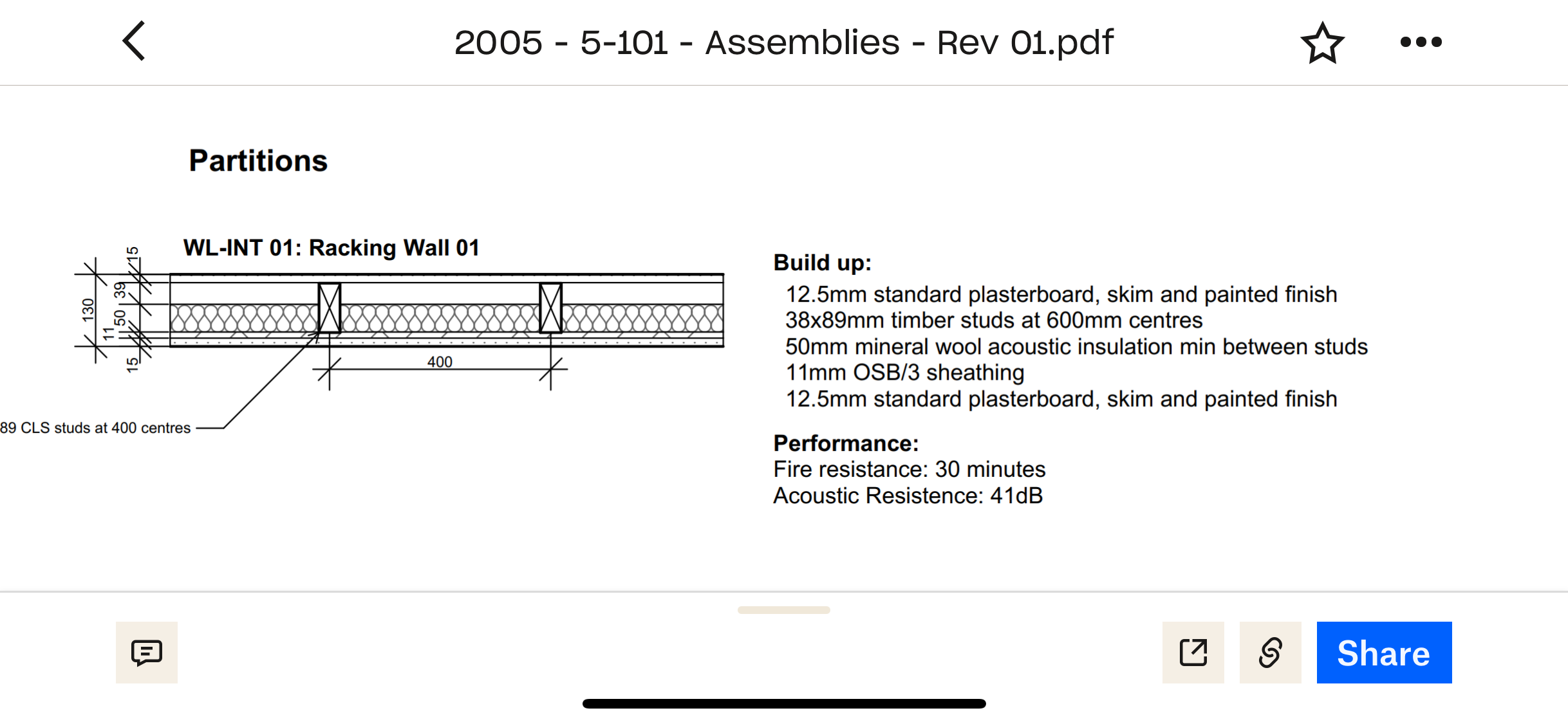

ProDave Posted September 6 Share Posted September 6 1 hour ago, Omnibuswoman said: This joist has been rested on a scrap bit of OSB because the wall was built too short… There is something more fundamentally wrong here. That does NOT look like a load bearing wall, there should be a double header. Anyone else care to confirm that or tell me it is okay? 1 Link to comment Share on other sites More sharing options...

FuerteStu Posted September 6 Share Posted September 6 2 hours ago, Omnibuswoman said: This joist has been rested on a scrap bit of OSB because the wall was built too short… Not all hangers have been nailed to the joists. It also doesn't feel like there is enough fixings across this joint. Especially because it looks like there are no washers and the nail/screw is buried. What was the manufacturer's design for this connection? Link to comment Share on other sites More sharing options...

Omnibuswoman Posted September 6 Author Share Posted September 6 11 minutes ago, FuerteStu said: It also doesn't feel like there is enough fixings across this joint. Especially because it looks like there are no washers and the nail/screw is buried. What was the manufacturer's design for this connection? Well, the design is to have a continuous joist run the whole length of the house, and not be cut in two and stuck back together… but stiffening plates or joints should be fixed from each side equally, in a staggered formation - top right and bottom left from one side, and the same in reverse from the other. They haven’t done that, but the I-joist technician felt that was the least of our concerns 🤦♀️ He said I-joists are not meant to be cut and “scabbed” together, but it’s would be ok if there was a blocking plate in place between the joists (perpendicular to the direction they run) holding the joists straight. Link to comment Share on other sites More sharing options...
Omnibuswoman Posted September 6 Author Share Posted September 6 1 hour ago, ProDave said: There is something more fundamentally wrong here. That does NOT look like a load bearing wall, there should be a double header. Anyone else care to confirm that or tell me it is okay? I’ve checked the structural engineer’s drawings and the building control drawings, and while both show a cross section of the wall build-up neither shows the top or sole plate. So I can’t say if they should have a double top plate or not. What I can say is that my workshop, which I built, has a double top plate at one side, and a quadruple one at the other side. My (former builder) uncle reckoned I could have built a second storey on top if I wanted to 😂 Link to comment Share on other sites More sharing options...

SteamyTea Posted September 7 Share Posted September 7 12 hours ago, Omnibuswoman said: the supporting walls that sit above each other are not, in fact, sat above each other. Is that because someone measured incorrectly? The joists twist may or may not be a problem. Ideally the forces need to go directly though the web, the greater the twist, the less load the joist can take, which causes buckling. Buckling tends to be a catastrophic failure, not just a bit of extra 'bounce'. This is because as the sin of the angle increases, the sideward forces increase (or is it the cosine, makes no difference, it is the angle that is important). I would not be happy (structurally) with walls in the wrong place, twisted joists and brackets not fitted right. You seem to be doing the right things in involving the manufacturer, builder and possibly a SE. 2 Link to comment Share on other sites More sharing options...
Omnibuswoman Posted September 7 Author Share Posted September 7 Thanks Steamy. This is just what the technical manager explained yesterday - about the risk of failure by the joists not bearing the forces in the correct plane, and because of the supporting walls not sitting directly atop each other. The joists simply won’t function as they should and this could cause catastrophic joist failure. I’ve drafted and polished the email to the builder. Will see what he has to say in response…. 1 Link to comment Share on other sites More sharing options...

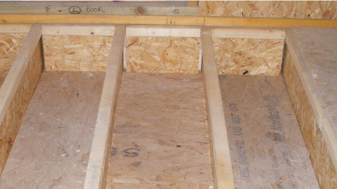

ProDave Posted September 7 Share Posted September 7 This is how ours were done Short sections of I beam came with the kit to go in between the main ibeams where they rested on a supporting wall. They did not fill in the web, but that might be because our beams came made up as 11 metre long beams to span the entire length of the house resting on supporting walls on the way, so no joint between separate ibeams as you have in your case. 1 Link to comment Share on other sites More sharing options...

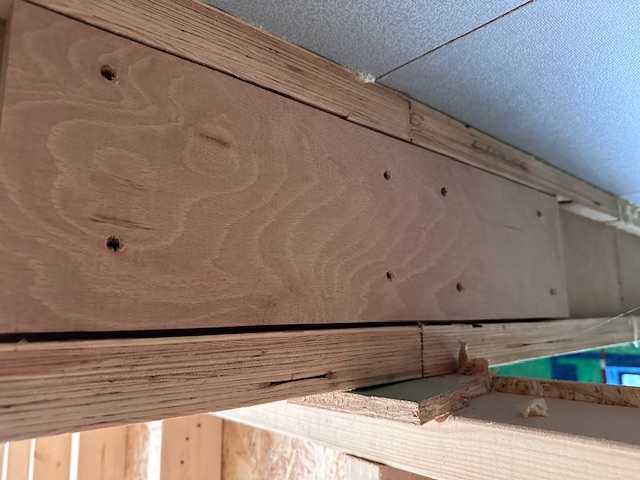

Omnibuswoman Posted September 7 Author Share Posted September 7 @ProDave ours were meant to be continuous, but somewhere along the way someone decided to cut them and then stick them back together…!! The solution to the twisting issue is what you have - I-joist pieces or solid LVL plates between each joist. That’s the design detail that should have been built in from the start. Link to comment Share on other sites More sharing options...

ProDave Posted September 8 Share Posted September 8 9 hours ago, Omnibuswoman said: @ProDave ours were meant to be continuous, but somewhere along the way someone decided to cut them and then stick them back together…!! The solution to the twisting issue is what you have - I-joist pieces or solid LVL plates between each joist. That’s the design detail that should have been built in from the start. Oh dear. Why on earth would they cut continuous long beams? As others have said. Halt any more work and any more payments and get BCO and if necessary a SE to look at what has been done. In an ideal world it would all be re done, but now it has been built up on top of those joists the easiest solution is likely to be to get a SE to specify exactly what to do to make the present work safe and stable, and then watch them like a hawk to ensure they do that exactly, even things like using the screws or nails that the SE specifies, not what happens to be in the back of the van. P.S our joists also have more sections of I beam at mid span acting as noggins as well as those in my photograph above the bearing points. 1 1 Link to comment Share on other sites More sharing options...
Oz07 Posted September 8 Share Posted September 8 Be okay if was just a partition but that looks poor for a load bearing stud. I can't believe the cut in the middle of joist is designed like that. How many are cut like that? Whats the bottom of that stud sitting on, is the floor below load bearing? 1 Link to comment Share on other sites More sharing options...
