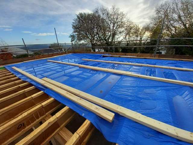

  • Is that because someone measured incorrectly?   The joists twist may or may not be a problem.  Ideally the forces need to go directly though the web, the greater the twist, the less load the
  • If this is wrong what else is wrong. I had an issue I identified. I got an independent SE to come and look at that issue and he identified several more. Get an SE in to do a review of the whole buildi
  • Oh dear.  Why on earth would they cut continuous long beams?   As others have said.  Halt any more work and any more payments and get BCO and if necessary a SE to look at what has been done.

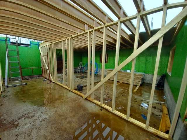

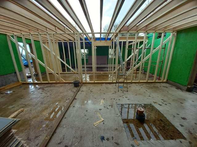

was all that osb on the floor covered in puddles just temporary ?
It’s not OSB on the floor - it’s actually muddy concrete! I think it’s a artefact of the photo that makes it look a lot like OSB.
Regardless whether the builder will fix the defects they do need to be fixed so that you can move on. When it happened to us the remediation was done through a combination of the  Heb Homes builder, and the joiner I’d hired and me. My focus was getting the build back on track so it cost me extra money which HH have verbally agreed to reimburse.

He has said that he won’t replace the little OSB packers that sit under the joists on top of the ground floor wall as he believes the compressive strength is sufficient for them not to compress over time (he quoted a measure of 15.4N/mm2 compressive strength on horizontal use). I don’t have a problem with that.
Whilst we didn’t much appreciate the tone of his response, which was rather tetchy and a bit defensive, we are expecting him to now put things right. Watch this space!
