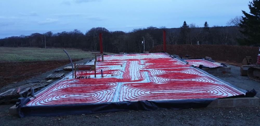

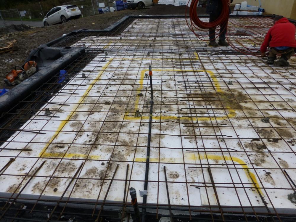

Tin Soldier Posted August 13, 2018 Author Share Posted August 13, 2018 @russ_fae_fyvie Hi Russ. I got on pretty well to be honest looking back, still miles away from being finished but trying to do a lot myself, whilst having three kids under 6 and a million things to do is proving challenging laid 300mm of eps70 insulation no bother at all, took a couple of days, Working with the steel mess and upstands I didn't like so much, and the UFH loops were more time consuming than you would think - was still doing it at midgnight 7 hours before concrete pour. so if you want to test it, best give yourself plenty time. happy to answer any questions you have, or give you pointers to some cheap trades if you need I like your plans , very nice 1 Link to comment Share on other sites More sharing options...

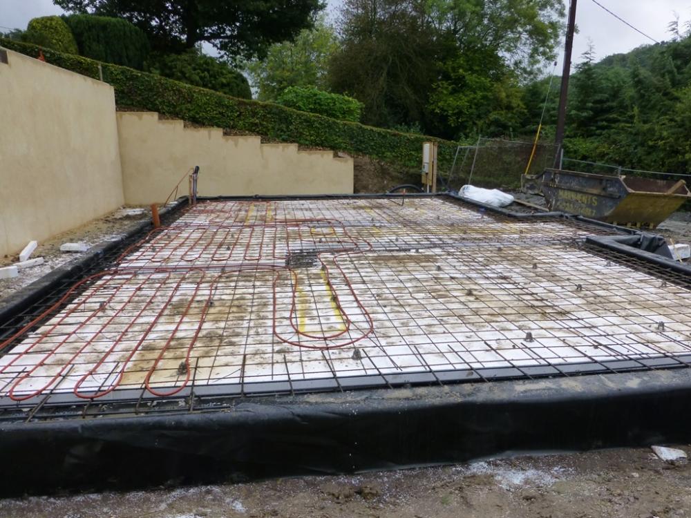

Alexphd1 Posted August 13, 2018 Share Posted August 13, 2018 (edited) I know the feeling with finishing off before the concrete lorry arrived, we stepped off the slab when the concrete lorry was reversing in in to the pump..... Thankfully we got a little help from the concrete guys (8 guys arrived at 7am, lorry 8am) with tie wrapping the last of the pipe or we would not have made it! Everything went smooth after that. Edited August 13, 2018 by Alexphd1 1 Link to comment Share on other sites More sharing options...
