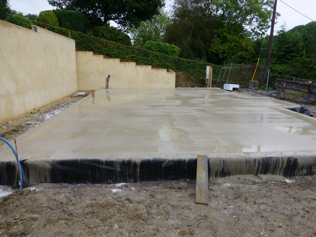

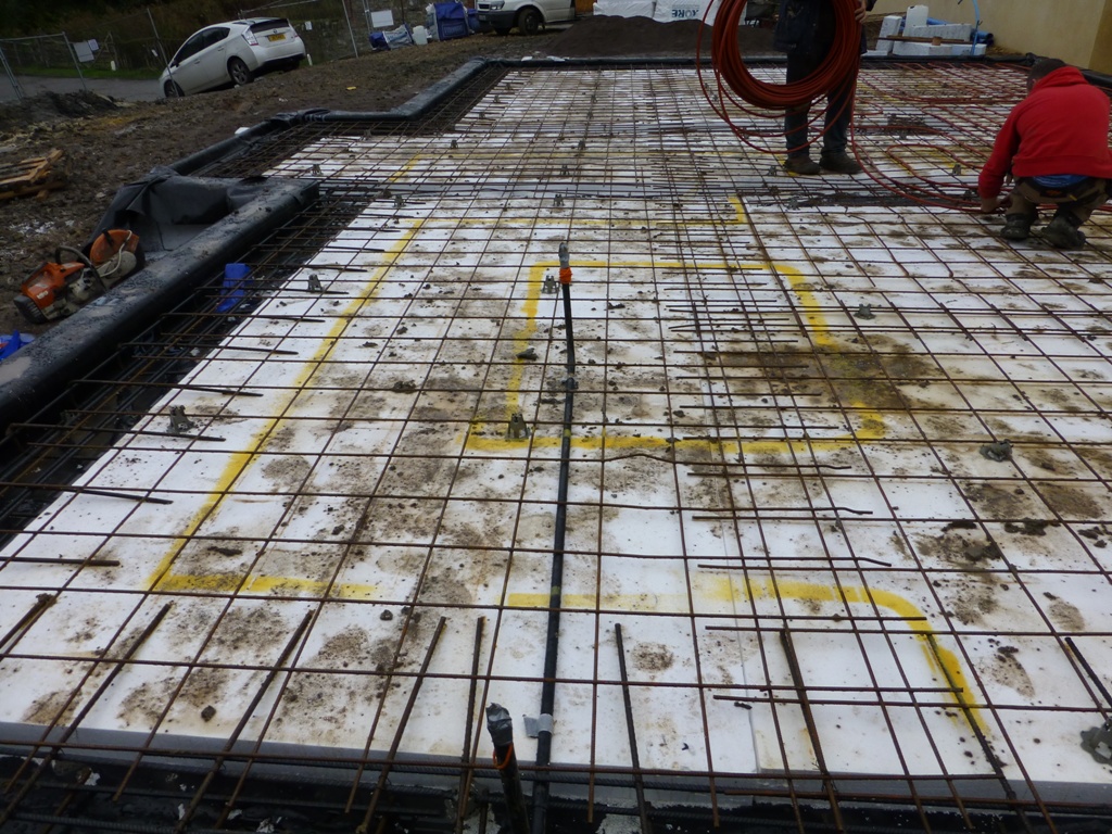

Jeremy Harris Posted November 3, 2017 Share Posted November 3, 2017 (edited) 2 hours ago, chrisb said: I've just done this - see other thread that I can't link to on my phone :-( Don't underestimate the work involved in cable-tying UFH pipe to mesh. Also, walking on the mesh (necessary to install pipe) caused it to bend and lift in places. The builder and concrete chap were concerned about it rising up when the concrete was being laid. We had a 120mm slab. In the end, the whole thing took an extra 2m3 of concrete as the EPS underneath compessed, so the actual thickness is a bit more than 120mm. Perhaps consider 150mm slab thickness so you have no worries about covering the mesh/pipes? Chris Something seriously awry, there. Our slab is 100mm, laid on 300mm of EPS 100, with mesh. The UFH pipes are tied to the mesh. At a guess it took two guys maybe half a day to lay and secure the UFH pipe, if that. There was zero movement in the mesh or the EPS, everything stayed dead flat, and there was no extra concrete used. Here are the photos: Edited November 3, 2017 by JSHarris Link to comment Share on other sites More sharing options...
chrisb Posted November 3, 2017 Share Posted November 3, 2017 The issue seemed to arise because when standing on the mesh, even without the UFH pipe attached, it gets bent a small amount (as it's held on 50mm chairs). This tends to lift the edges of the mesh upwards where it pivots on the chair. After attaching the UFH pipe, this is then harder to level out as there is now pipe tied to the mesh on one side, holding it in that position. In the end, there is no UFH pip, or mesh at the surface, so I think all is fine. Link to comment Share on other sites More sharing options...
Jeremy Harris Posted November 3, 2017 Share Posted November 3, 2017 10 minutes ago, chrisb said: The issue seemed to arise because when standing on the mesh, even without the UFH pipe attached, it gets bent a small amount (as it's held on 50mm chairs). This tends to lift the edges of the mesh upwards where it pivots on the chair. After attaching the UFH pipe, this is then harder to level out as there is now pipe tied to the mesh on one side, holding it in that position. In the end, there is no UFH pip, or mesh at the surface, so I think all is fine. If you look closely, you'll see that the chairs were temporarily pulled out from the areas where pipe was being laid, then the mesh was lifted back up on to them afterwards. Get's around the problem and makes the job easier and quicker. Link to comment Share on other sites More sharing options...
Tin Soldier Posted November 3, 2017 Author Share Posted November 3, 2017 those are really great pictures to see JSHarris so heres another probably naïve question If my 100mm slab is sitting on top of 250mm eps insulation, how to do you inslate the side of the slab from the blockwork. I assume insulation and looking at my current drawings its noted as 30mm Kingspan tw55 upstand for self leveling screed. is this enough or should it be wider, and if it is wider, how does that effect the studwork/battening that I guess would be going directly above it? Link to comment Share on other sites More sharing options...
Jeremy Harris Posted November 3, 2017 Share Posted November 3, 2017 Ours is a passive slab, so the outer 2/3rds of the 300mm thick frame sits over a 200mm wide EPS 100 upstand, with only the inner 100mm of the frame (the load bearing part) sitting on the warm, reinforced concrete, ring beam around the edge of the slab. This means the edge of the slab has 200mm of insulation all around it, which pretty much prevents any heat loss out sideways. For other build methods you have to come up with ways of mitigating the edge loss and thermal bridging that can occur, and a great deal depends on the exact detail of your build. Link to comment Share on other sites More sharing options...
