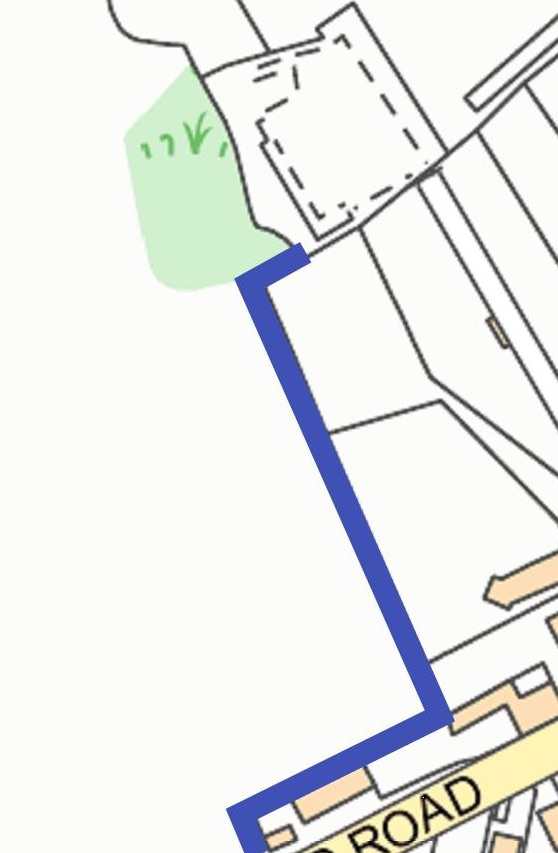

Oz07 Posted August 22, 2024 Posted August 22, 2024 The plot I am looking at has an easement through a neighbouring field for the utility connections. Unfortunately the route is approx 220m long and has 3 90deg bends in it. I am trying to get an idea for utility costings. I can do the work on the field side but obviously need the utility companies for the small bit at the road connection. Water isn't too much of an issue. Long trench with long pipe. Albeit a few joins. Maybe a duct and maybe have the welded joint if possible. Shouldn't imagine cost is any more than usual for the actual connection. Elec presents more of an issue. I had a service put in once where I had dug and installed the duct and it made me ill when I spotted the 63mm cable they had rolled up ready to pull through. Luckily it was straight trench and my duct laying must of been okay because it pulled through fine. They did lift up half the digger and use one of the tracks as a winch to pull the drawcord. How would you go about it in this case? I can't see a cable threading through a 90 deg bend very well and 220m is a hell of a distance. What is the usual procedure? Leave holes every so often and at bends? Leave the trench open and let the utility company (western power) just lay the cable straight in? Would they even let you do this or would they want to back fill so cable isn't exposed? Does anyone have any idea of costs when it comes to a connection like this? Do they charge by the metre or is each job individual? I would guess the connection at the road end makes up the bulk of the cost with the digging and traffic management. Telecom I am guessing is not too bad. I have had Openreach supply me duct and cable before and I have buried this and installed the cable ready for the engineers to come and connect up. Thanks

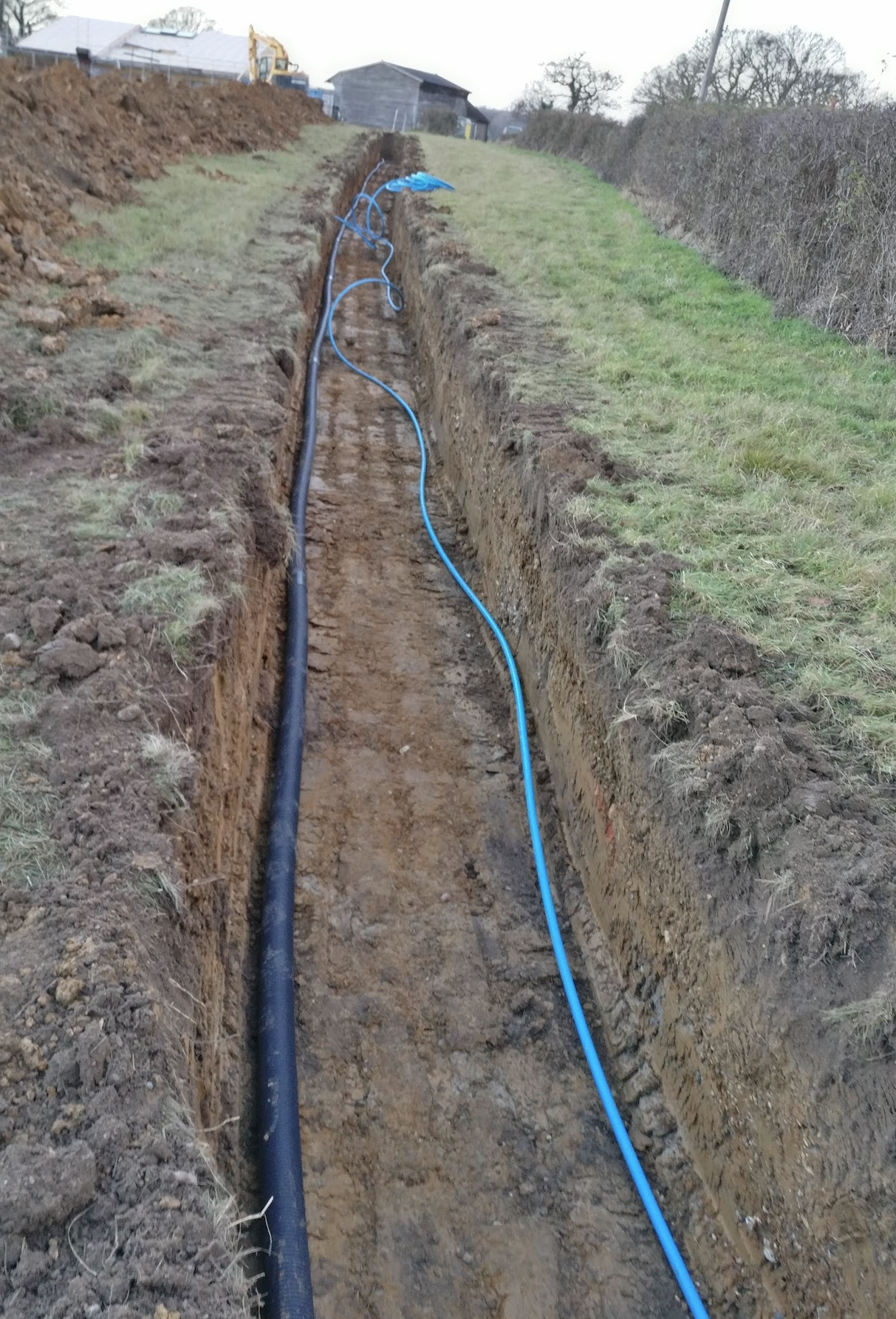

IanR Posted August 22, 2024 Posted August 22, 2024 (edited) 1 hour ago, Oz07 said: Unfortunately the route is approx 220m long and has 3 90deg bends in it. Mine is a gently curving 130m, across a field. As mine was judged to be a potentaily deep-ploughed field I had to adhere to the extra depth, 1,100mm iirc rather than 750mm for power and water. I put the water pipe in the trench, you can get long coils of the pipe to save having connections in the field, but they wanted to see the pipe before I back filled to ensure depth. Power wanted to pull the cable through, but were happy for me to put the ducting in and backfill without them inspecting it. Power did specify Ø160mm duct, but my "expereinced" ground workers said that wasn't needed and Ø100 would be OK. It really wasn't, and Power Networks nearly gave up on the pull-through. The loads were beyond the limit of their cable puller, but they only just achieved it in the end. I couldn't convince Power Networks to come right up to the curtilage with the large, public network cable, they said their rules were to stop 35m from the property and join to a domestic cable. This was still installed by Power Networks, but meant a joint in the field. For yours, I'm sure it will need to be done in 3 pulls, maybe in seperate lengths with joints. My power installation (for 3 phase) was around £4,500 (in 2017) for the pull-through, and connection at either end, then another £3K for a transformer upgrade. Edited August 22, 2024 by IanR 2

Oz07 Posted August 22, 2024 Author Posted August 22, 2024 11 hours ago, IanR said: Mine is a gently curving 130m, across a field. As mine was judged to be a potentaily deep-ploughed field I had to adhere to the extra depth, 1,100mm iirc rather than 750mm for power and water. I put the water pipe in the trench, you can get long coils of the pipe to save having connections in the field, but they wanted to see the pipe before I back filled to ensure depth. Power wanted to pull the cable through, but were happy for me to put the ducting in and backfill without them inspecting it. Power did specify Ø160mm duct, but my "expereinced" ground workers said that wasn't needed and Ø100 would be OK. It really wasn't, and Power Networks nearly gave up on the pull-through. The loads were beyond the limit of their cable puller, but they only just achieved it in the end. I couldn't convince Power Networks to come right up to the curtilage with the large, public network cable, they said their rules were to stop 35m from the property and join to a domestic cable. This was still installed by Power Networks, but meant a joint in the field. For yours, I'm sure it will need to be done in 3 pulls, maybe in seperate lengths with joints. My power installation (for 3 phase) was around £4,500 (in 2017) for the pull-through, and connection at either end, then another £3K for a transformer upgrade. Whats that a 600 bucket been used? Is that for separation between services? I would go for longer continuous water pipe if available. The easement is shaped so its along the edge of the field presumably away from ploughing area. Maybe still have to go deeper who sets the depth rules water board? Did anyone see the pipe burier clarkson had in clarksons farm? Great bit of kit just went on back of his tractor. Not sure how would cope with bends though.

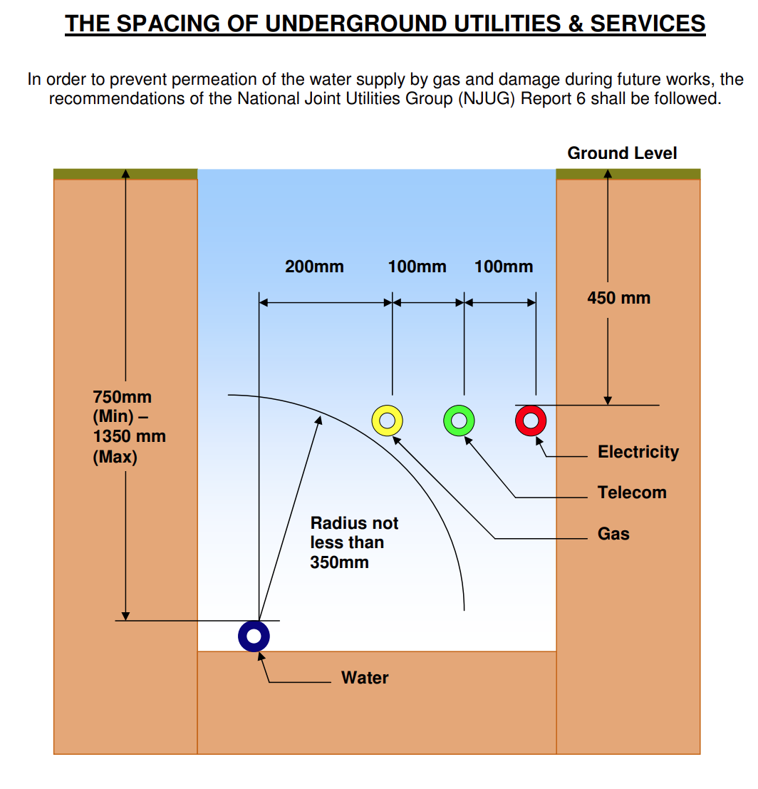

saveasteading Posted August 22, 2024 Posted August 22, 2024 19 minutes ago, Oz07 said: a 600 bucket been used? these 2 pipes need to ne 450mm apart. 20 minutes ago, Oz07 said: who sets the depth rules water board? water at -750, electric at -450, generally. 20 minutes ago, Oz07 said: Great bit of kit just went on back of his tractor. A plough that simply slits the ground for the pipe to go in behind it, and closes itself behind. Ok for a farm doing its own thing. I don't think they go deep enough for the water company rules, nor do they lay a warning tape above the pipe.

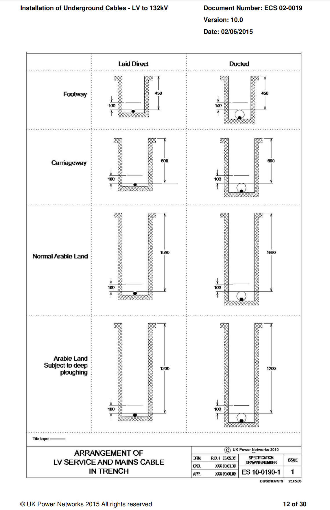

IanR Posted August 22, 2024 Posted August 22, 2024 36 minutes ago, Oz07 said: Whats that a 600 bucket been used? Is that for separation between services? I used a 1000mm bucket (13T excavator), but could have used a 600mm. 1000mm allowed me to use a big vibrating roller to compact the back-fill down. It's UK Power Networks that have the "deep ploughed" depth requirement, although it's 1,200mm. Don't know why they came up with "deep plough", the field is pasture and hadn't been ploughed in 20 years. Water was 750mm minimum, up to 1,350mm With Water and Power in the bottom of the trench, I back-filled around 500mm and then put in the Open Reach ducting (Ø50 rigid) + 2 more ducts for power and data to the gate. This is from UKPN And this from Essex & Suffolk Water.
Oz07 Posted August 23, 2024 Author Posted August 23, 2024 I was aware of the 750 - 1350 requirement from water utility provider just wanted clarification on the 'deep ploughed' situation cheers. 1M bucket no wonder the spoil pile looks massive! Next step really is to get a quote off Western Power. Just hoping they are happy to lay cable in an open trench but if they might start specifying all silly h&s rules if trench is over 1m deep due to 'deep ploughed' requirement.

Onoff Posted July 15, 2025 Posted July 15, 2025 Any thoughts on service layout in a 9" wide trench: 20 or 25mm mains water 63mm cable duct 110mm waste I'd have said water at 750mm, electric at 600mm but where to put the 110 waste? All in pea shingle with cable tape etc.
Russell griffiths Posted July 15, 2025 Posted July 15, 2025 You shouldn’t be putting 110mm in a 9inch trench, not enough room for the pea gravel to come up to required spec. 12inch bucket on the digger for 110mm pipe. 1
Onoff Posted July 16, 2025 Posted July 16, 2025 11 hours ago, Russell griffiths said: not enough room for the pea gravel to come up to required spec. Thanks. Any pointers as to what that coverage criteria is? Cheers.
Russell griffiths Posted July 16, 2025 Posted July 16, 2025 30 minutes ago, Onoff said: Thanks. Any pointers as to what that coverage criteria is? Cheers. I think covering is down to ground conditions, clean dirt no stones then I believe you can use the dug material, stones bigger than 25-40mm then clean gravel surrounding the pipe.
