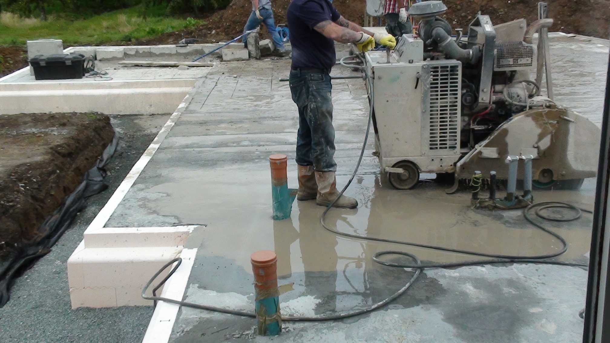

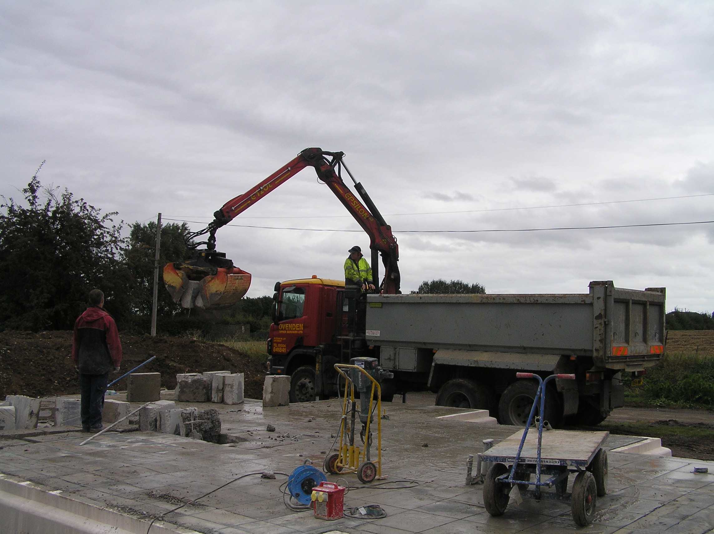

Gone West Posted August 17, 2024 Posted August 17, 2024 14 hours ago, puntloos said: how many "major" preventable mistakes happened with your build The major one was having to completely dig up and replace the the whole insulated concrete slab foundation. Surely things couldn't get any worse?.......
joe90 Posted August 17, 2024 Posted August 17, 2024 11 minutes ago, Gone West said: The major one was having to completely dig up and replace the the whole insulated concrete slab foundation. Why 🤷♂️

ToughButterCup Posted August 17, 2024 Posted August 17, 2024 41 minutes ago, Gone West said: ... having to completely dig up and replace the the whole insulated concrete slab foundation... How on earth do you recover from that? Our wall collapse pales into insignificance by comparison. And as for @Pocster's little glazing episode, well.... It's honesty like this that offers us all valuable perspective. Thanks very much.

Gone West Posted August 17, 2024 Posted August 17, 2024 4 hours ago, joe90 said: Why 🤷♂️ 3 hours ago, ToughButterCup said: How on earth do you recover from that? Back in 2010 we were the first Isoquick foundation system to be laid in England. Unfortunately the concrete laying did not go well. A combination of cost cutting, by not using a pump, and the concrete setting too quickly left large voids in the 200mm slab which were detected using ultrasonic testing. The results were confirmed by drilling core samples. Fortunately I had videoed the whole process which showed the mistakes made by the concrete installers, and the company doing the work for us accepted full responsibility. A month later we had a completely new slab. We just carried on, but a few weeks later than we had expected, but as the whole build took eight years it wasn't too bad. 2 1
