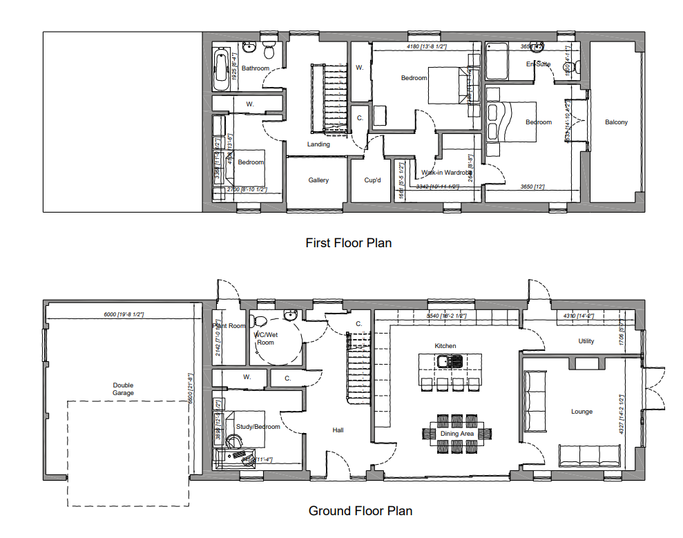

flanagaj Posted August 3 Author Share Posted August 3 Another thing that made me question the architect is the floor plan option below that we were sent. Keen to see whether anyone else can spot the error. Link to comment Share on other sites More sharing options...
MikeSharp01 Posted August 3 Share Posted August 3 Its a long walk everywhere upstairs and you have to go to bed via the wardrobe, the study bedroom appears to have the desk chair on the bed and there are several places where doors clash. 1 Link to comment Share on other sites More sharing options...
Alan Ambrose Posted August 3 Share Posted August 3 I wonder whether you've just been sent an early/unfinished draft? I wouldn't sweat it, just send the problems back and get them changed. To set the tone, maybe tell them you're surprised and I hope you will get an apology. 1 Link to comment Share on other sites More sharing options...
flanagaj Posted August 3 Author Share Posted August 3 The stairs don’t even line up, so it’s complete garbage. 1 Link to comment Share on other sites More sharing options...
G and J Posted August 3 Share Posted August 3 26 minutes ago, flanagaj said: The stairs don’t even line up, so it’s complete garbage. Au contraire. You lack the vision and creativity of an architect. Imagine how impressed your friends will be to ascend half a staircase then clamber over a banister to finish the climb. No one else will have a feature like it. 😉 2 2 Link to comment Share on other sites More sharing options...
flanagaj Posted August 3 Author Share Posted August 3 53 minutes ago, G and J said: Au contraire. You lack the vision and creativity of an architect. Imagine how impressed your friends will be to ascend half a staircase then clamber over a banister to finish the climb. No one else will have a feature like it. 😉 😂 Link to comment Share on other sites More sharing options...

PNAmble Posted August 3 Share Posted August 3 I’d also say you want to access your plant room from inside, do you want to go outside to clean your MVHR filters, reset your internet, reboot the iboost etc etc. 1 Link to comment Share on other sites More sharing options...
torre Posted August 3 Share Posted August 3 On 31/07/2024 at 17:06, flanagaj said: She is super cheap, and her fees for drawings and planning submission is only £1800. The first elevation looks pretty close to your image and you've not given a huge budget to evolve other ideas so you may need to temper expectations a bit or give a bit of feedback and budget to evolve the design - @ETC's sketches are a nice start in terms of ideas to build on the original. Personally I'd prefer the hall to be more central to the main rooms (and of course stairs to line up). It sounds like you're not too impressed so far though - cheap is great but not if it means a battle to direct your architect to deliver what you want. In terms of the application, perhaps show the new and old elevations overlaid so it's clear you're not actually going much if any higher at the ridge, and make another attempt to win over the neighbours, telling them how much the new design means to you and why. In person may work better than email. 1 Link to comment Share on other sites More sharing options...

flanagaj Posted August 4 Author Share Posted August 4 After some consideration, we have decided to part company with the architect who did the initial sketches. My wife and I need to get this right, and we need an architect who specialises in modernist design, but who can also do some good 3d drawings of how the property will sit on the plot, and how it will look from the lane. These will hopefully enable the locals, the Parish Council and the planners to visualise that a modernist home will look good and actually enhance the lane. 1 Link to comment Share on other sites More sharing options...
Jilly Posted August 4 Share Posted August 4 I think it’s better to get the same architect to produce both the planning and Building Control construction drawings. There were lots of mistakes because I tried to save money using a different architects as I didn’t understand the pitfalls as a newbie. 1 Link to comment Share on other sites More sharing options...
