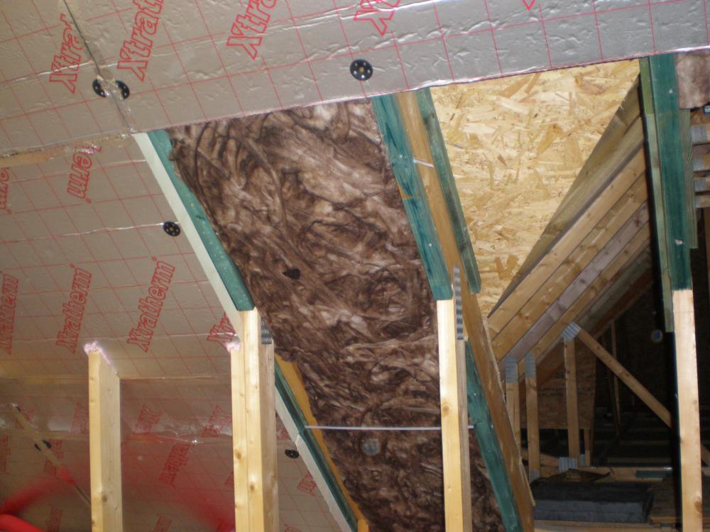

janedevon Posted June 14, 2016 Author Posted June 14, 2016 To update and see if my options can be improved, the timber frame company have informed me that the rafters will be 197mm deep, is there a cheaper product that I can use in a thicker format that's relatively easy to self install, bearing in mind I'm after hitting my target .16 not going excessive. hoping to use a breather membrane, fill rafters with the cheapest easiest to fill insulation then opt for the layer beneath rafters before adding standard plasterboard.
Jeremy Harris Posted June 14, 2016 Posted June 14, 2016 200mm mineral wool between the rafters is cheap, but won't get you to 0.16 W/m2.K without some additional insulation inside or outside to both mitigate cold bridging through the rafters and to give the needed level of insulation. It's a reasonably good choice for a roof, though, as it has a medium length decrement delay (better than foams and other very low heat capacity insulation) and it is easier to fit than cutting foam to fit and then going around filling all the gaps with expanding foam. I don't have my U value calculator here on this machine, but would guess that you'd get between 0.18 and 0.19 W/m2.K with just the mineral wool, so you'd need to add a layer of higher performance rigid foam insulation either over the rafters or under them. If the latter, then you can possibly use a foil-coated board and tape the joints to also give you the necessary VCL internally. 1
Declan52 Posted June 14, 2016 Posted June 14, 2016 One of the high density earth wool type products. Very easy to fit as it springs out and fills the rafter. Not as bad to work with itch wise as it was years ago. cuts with a hand saw. Mine was from knauf but there are others available. If you cross batten the roof on the outside and use a breather tile membrane you don't need to leave an air gap so you get the full depth. 200mm of this type of product will get you a u value near 0.16 so you could get away with 50mm pir under the rafters. Then your vcl and a service cavity if you want then your plasterboard. And as has been mentioned before the insulation underneath and the plasterboard buy it separately will be much cheaper. 1
janedevon Posted June 14, 2016 Author Posted June 14, 2016 Many thanks, I think we are getting somewhere now so membrane, 200mm mineral wool then is the rigid foam something like celotex? What sort of thickness are we talking and will this provide a vcl if fitted correctly? Then add standard plaster board afterwards.?
ADLIan Posted June 14, 2016 Posted June 14, 2016 +1 JSH & Declan52 200mm dense mineral wool (0.035 W/mK) underdrawn with 25mm PUR should give approx U=0.16 W/m2K (rafters at 600mm c/c). Use 30mm PUR if rafters at 400mm c/c. Ian 1
Declan52 Posted June 14, 2016 Posted June 14, 2016 2 hours ago, janedevon said: Many thanks, i think we are getting somewhere now so membrane, 200mm mineral wool then is the rigid foam something like celotex? What sort of thickness are we talking and will this provide a vcl if fitted correctly? Then add standard plaster board afterwards.? Yep pretty much that. It has to be the higher density roll not just your standard loft type stuff. It's specific for this application. The thickness of the pir( Kingspan,celotex all the same) will depend on your budget. The thicker you go the better it will be but will cost more. If you tape all the joints it can act as a vcl. I taped mine and put a separate vcl in as well. Jeremy used to have a spreadsheet on Ebuild where you could play about with figures and see the difference in 50,60,70,80,100mm of pir and then weigh up with what your budget allows. Not sure it has made it over here yet. After the pir then if you are going for a service cavity then it's done if not then plasterboard screwed through to the truss. 1
