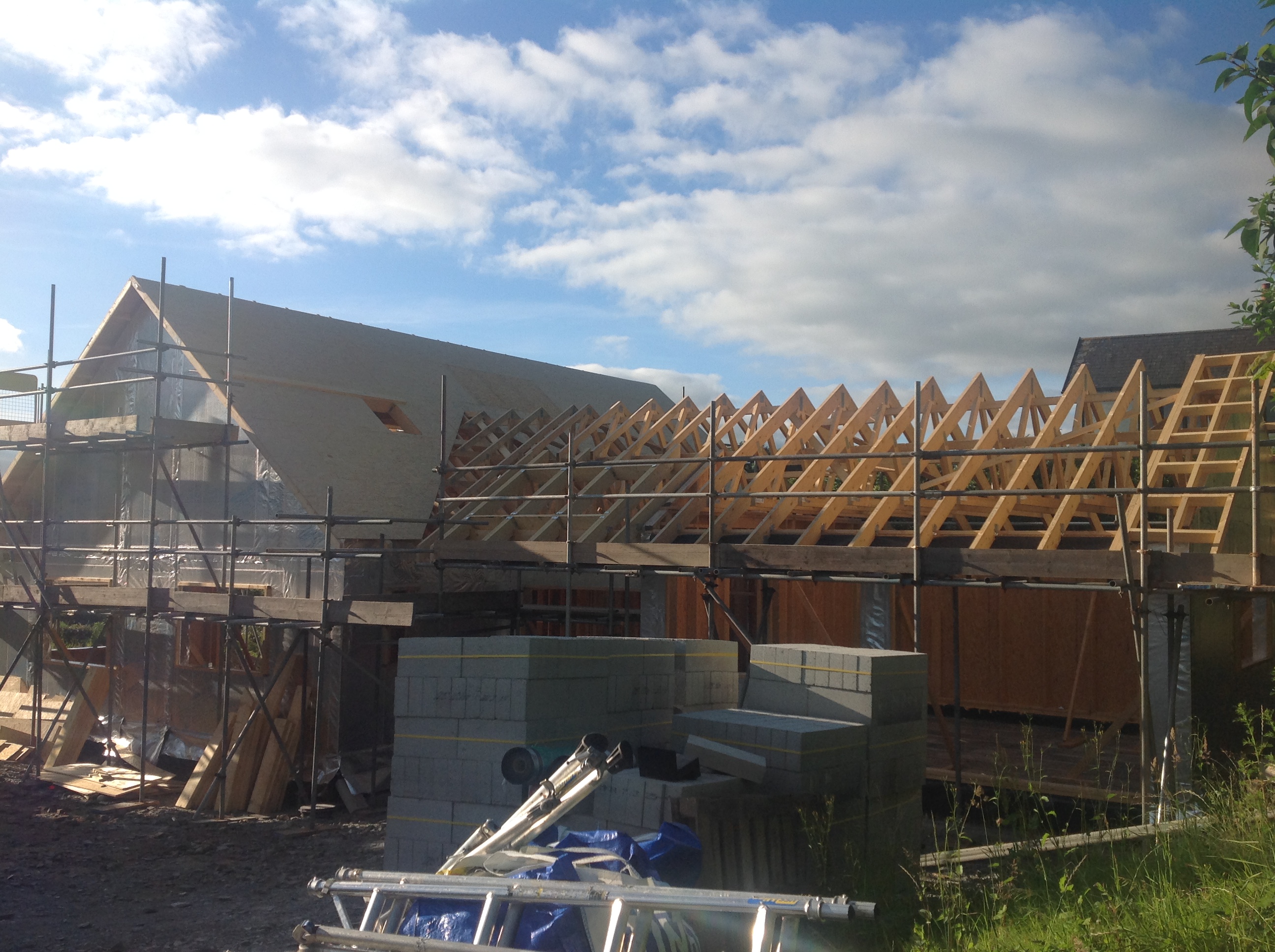

Hi again guys just a quick question reference the above pic on my build, had the building inspector around today she was checking roof structure and talking about insulation for the roof, i said the sarked roof is  a warm pitched roof which will have inulation between and under  rafters then the rest is cold roof which will have piles of earthwool inside, she said no its all a cold roof as to be a warm roof the insulation needs to be above rafters and the rest of the roof ie the un sarked  area would still need between rafter insulation.
she left me a bit perplexed and when checking my plans the insulation is as i described, i do however have a bit of a quandry where what i call the cold roof,cuts,into the warm one presumably i just carry all the way down with between rafter insulation and try to avoid cold bridging.
the sarked area has counterbatten the unsarked area hasnt.
any clues?

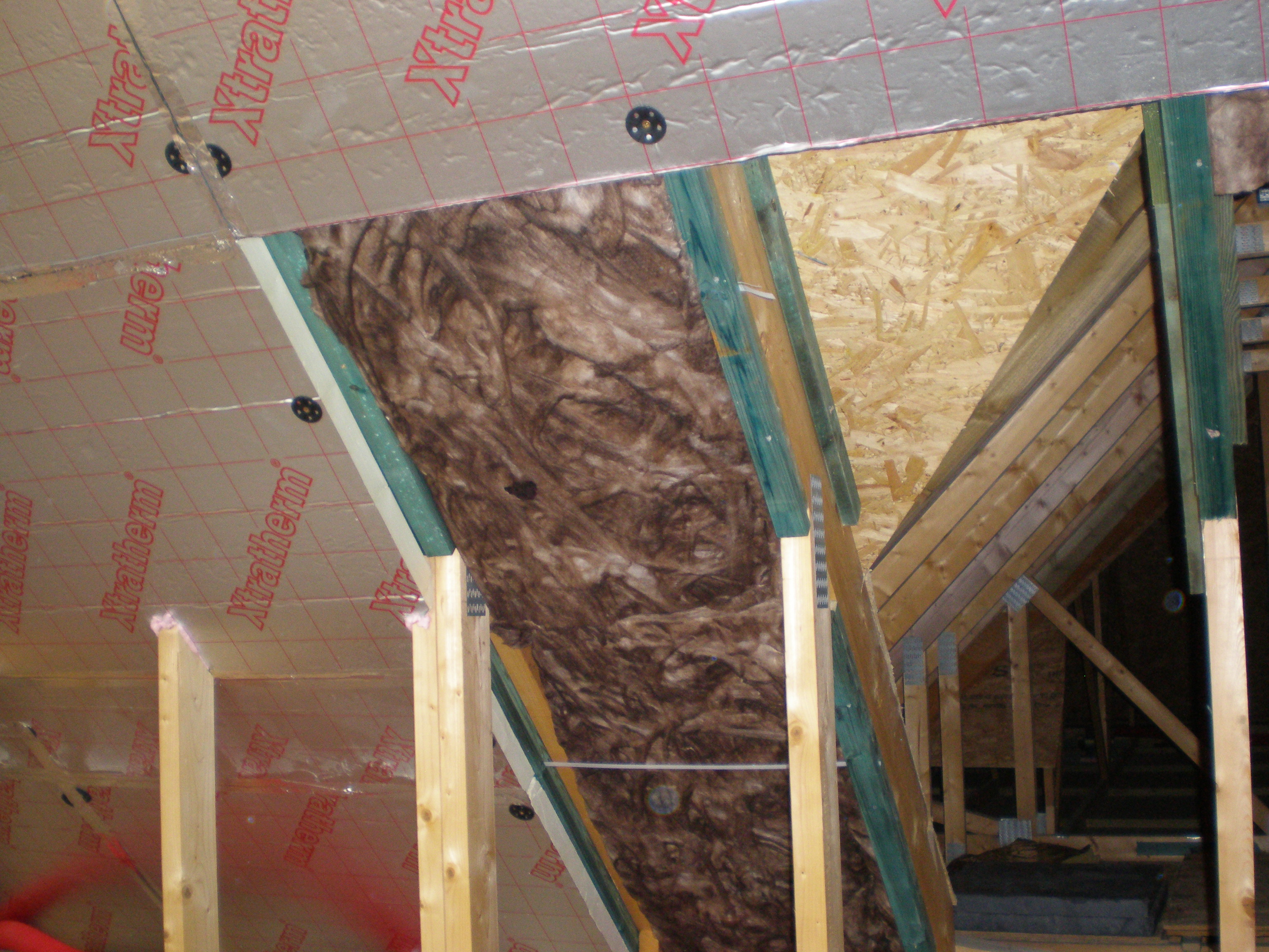

Ok so its now insulation time, started today with what the timber frame company had left me as spare.
a few questions if you knowlegable lot could help out,
im going 180mm frametherm topped with 25mm celotex then vcl prior to boarding.
do i go right down to soffits with insulation?
and what happens where my warm roof meets cold roof? Do i continue my frametherm right down?
in the eaves there will be celotex 140mm between and behind studwork
and what happens on the flat spaces above the dormers im putting 300 mm of earthwool over voids before boarding do i continue my batts all the way up as well?
couple pics to help
Pic 2 shows where warm roof will meet cold roof near the miriad of ducting
Edited by janedevon
Link to comment
Share on other sites
We have a cold roof - this is how we are doing it:
Battens fixed to roof trusses / rafters immediately underneath OSB sarking.  This is to prevent the insulation pushing up against or being in contact with OSB and the condensation issues that could arise.  The battens ensure a 45mm ventilation gap between insulation and sarking.  Another batten fitted to the underside of the truss / rafter so that there is enough depth left between rafters (180 mm) to take 2 x 90 mm frametherm 35 batts.  50 mm board insualtion across the rafters, joints taped and foamed.  We have taken our insulation right down to the wall plate (it actually extends out over all the EWI we have)  There will be further battens on top of the insulation boards to create a small service cavity then plasterboard.  A large part of our roof is vaulted, so no truss uprights to worry about, but where we have them they will have nothing more than plasterboard as they are within the insulated envelope. The gap through you can see leads to a section of the house with normal ceilings.  This area will have 450mm earthwool, which will simply be brought up to the back of the frametherm batts.

I would take the Frametherm and Celotex topping all the way down in the habitable bit of the roof, thus insulating the voids. Then no need to insulate them as well and it gives you a warm storage space if you care to put a couple of trap doors in.

I get so,confused over warm roof cold roof, the area im insulating,is as im led to believe a warm roof ie open to habitable rooms was advised to not bother with batten and could insulate up to sarking as a breathable membrane is being used, the area beyond where all the ducting is going, is what i thought a cold roof so boarded below and will have 2 huge layers of rockwool over rafters before boarding.
see how easily im confused is your roof space habitable? And why is it a cold roof not a warm one lol
