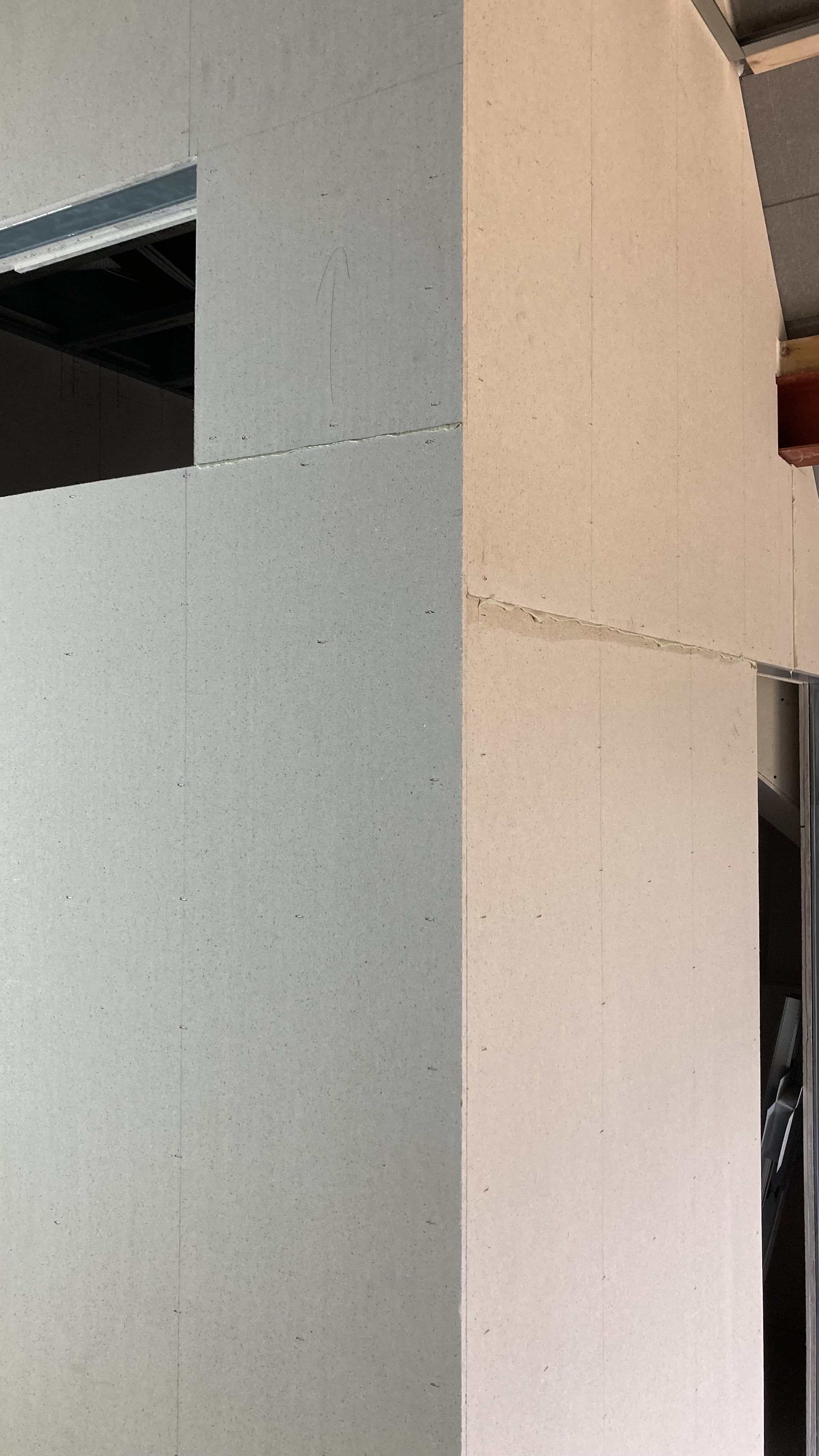

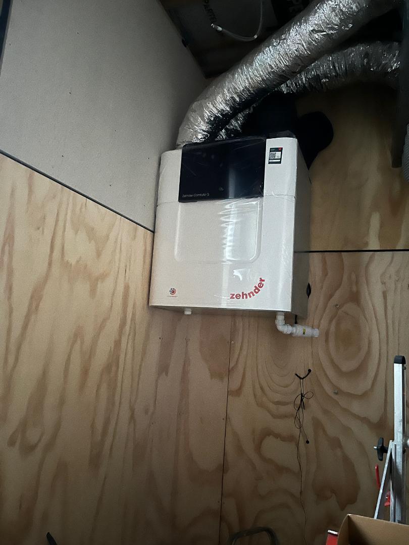

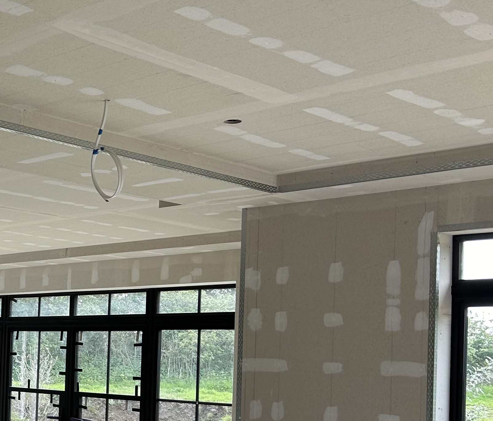

Nick1c Posted August 23, 2024 Share Posted August 23, 2024 We went for fermacell walls & PB ceilings due to both the weight of fermacell & the lack of requirement for impact resistance. The insulated timber frame was supplied by PYC & used smartply on the inner face. It feels really solid, is great to hang things off & adds to the racking….but the edges aren’t as clean as I had hoped. I am not sure how to make them super sharp, maybe FST on all the edges would work. The house is remarkably quiet, the combination of warmcell, a CLT first floor & (possibly)the fermacell) really works. 1 Link to comment Share on other sites More sharing options...
markharro Posted August 23, 2024 Share Posted August 23, 2024 Thats just what we are thinking @Nick1c Did you fit yourself? When you say edges do you mean corners rather than where the boards butt together? I take it you didn't use an edge bead? Link to comment Share on other sites More sharing options...

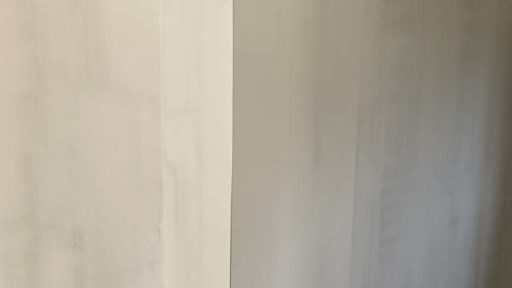

Nick1c Posted August 23, 2024 Share Posted August 23, 2024 We had them fitted. Where the sheets butt up is great, it’s the cut edges I am referring to. We have no architrave or skirting which obviously massively exacerbates the problem. As far as I could see if you use beads to clean up the edges you would then have to use a conventional skim rather than the FST. Link to comment Share on other sites More sharing options...
markharro Posted August 24, 2024 Share Posted August 24, 2024 Thanks @Nick1c thats very helpful. What you have done is exactly what I am planning and trying to figure out - using Fermacell and a small shadow gap at the bottom where it meets the concrete slab rather than skirting and also a shadow gap detail around doors ie no conventional architrave. I also was hoping to try applying the FST myself rather than getting a plasterer in to skim but I dont know how realistic that is. Have you done the FST skim and if so how did it go? I wondered about using a bead with the FST....is the problem the fact that the FST layer would be too thin to cover the bead properly? I did see a blog where an architect self-builder had used Fermacell and a bead at the bottom but he had then had the boards skimmed by a plasterer. This has got me thinking whether Fermacell could perhaps recommend a bead product that might be compatible with their FST!? PS I dont suppose you could post any photos of how your edges have ended up looking? Thanks Link to comment Share on other sites More sharing options...

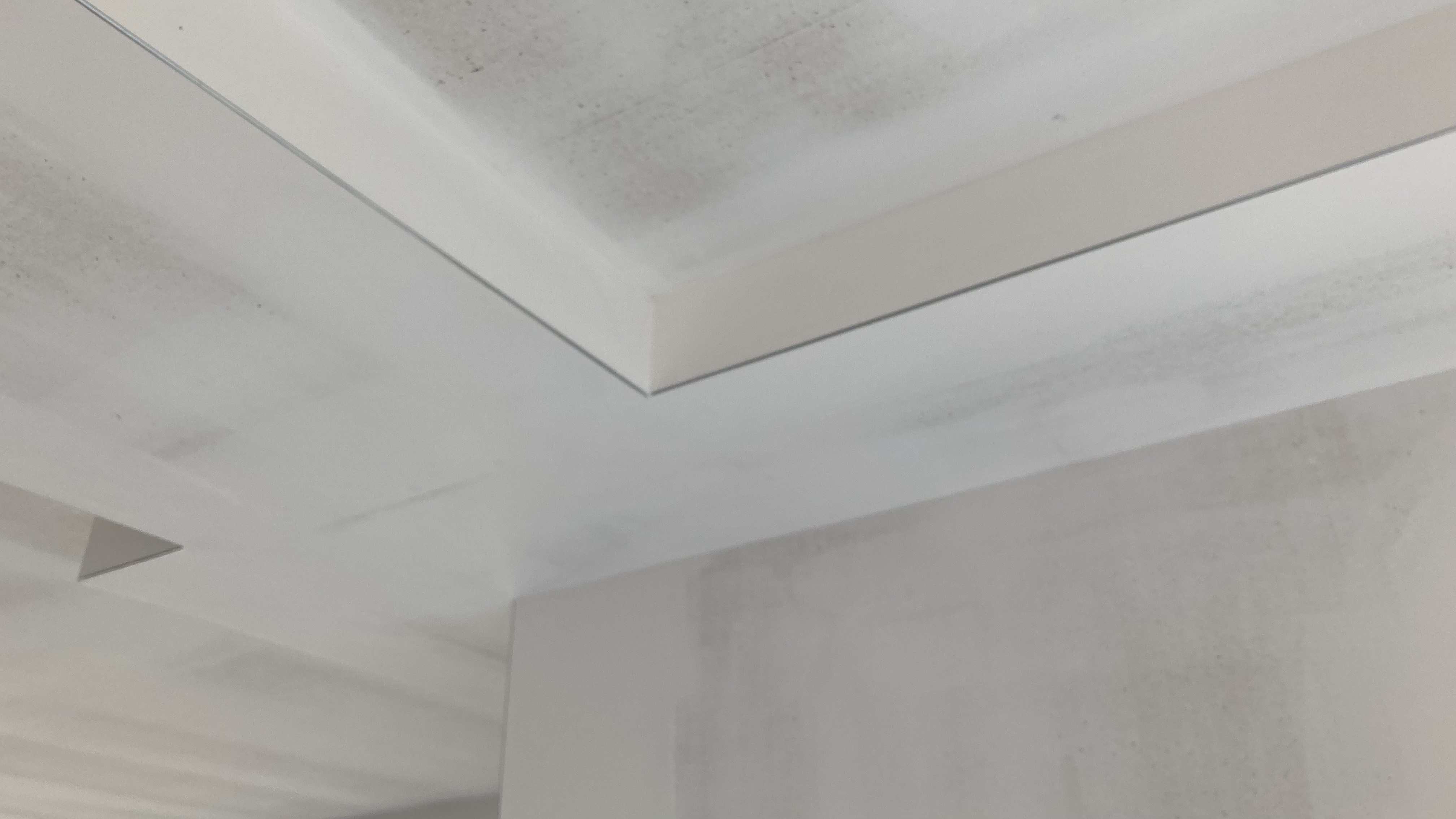

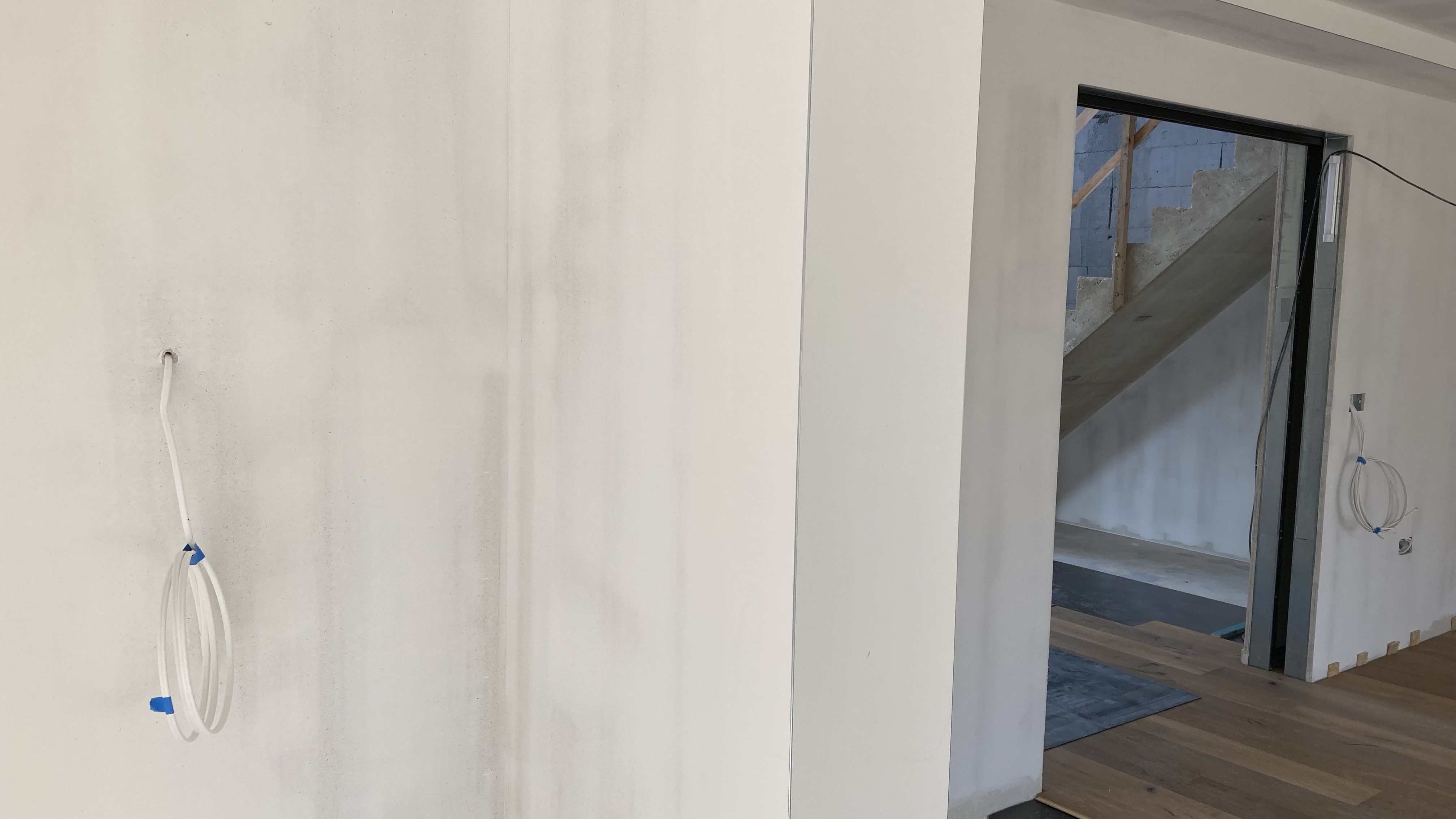

Nick Laslett Posted August 24, 2024 Share Posted August 24, 2024 I am away this weekend, but happy to post pics of various edge finishes, just board, aluminum bead, paper bead. I did the corner bead and FST for our plant room. I had a tape & jointer do the FST for the rest of the house. Applying the FST and joint filler to finish fermacell boards is very straight forward. It is just hard work. https://www.belmoretools.co.uk/levelline-drywall-corner-tape-2-75-in-x-100-ft-roll.html Link to comment Share on other sites More sharing options...
G and J Posted August 24, 2024 Author Share Posted August 24, 2024 1 hour ago, Nick Laslett said: I am away this weekend, but happy to post pics of various edge finishes, just board, aluminum bead, paper bead. I did the corner bead and FST for our plant room. I had a tape & jointer do the FST for the rest of the house. Applying the FST and joint filler to finish fermacell boards is very straight forward. It is just hard work. https://www.belmoretools.co.uk/levelline-drywall-corner-tape-2-75-in-x-100-ft-roll.html Most importantly @Nick Laslett are you happy with the finish? And was the cost of having tape/jointing/FST done very different from a traditional skim? Link to comment Share on other sites More sharing options...

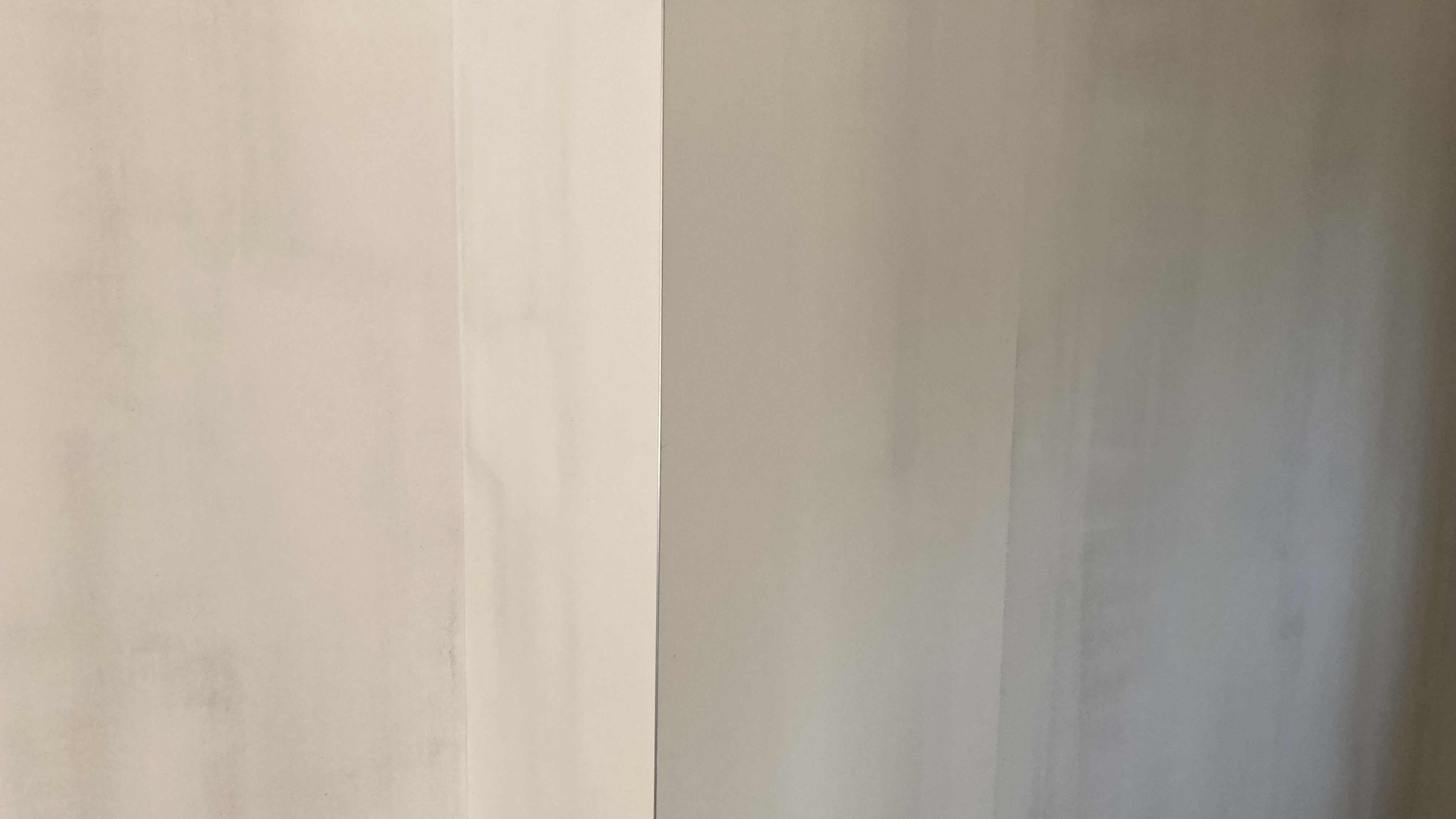

markharro Posted August 31, 2024 Share Posted August 31, 2024 Hi @Nick1c and @Nick Laslett sorry to hassle but it would be great to see some photos showing the Fermacell edge finish with and without bead. And @Nick Laslett are you saying you used a bead and then the FST to cover it? How did that work out? Could you apply it thickly enough at the bead to cover it properly? thanks Link to comment Share on other sites More sharing options...
Nick Laslett Posted August 31, 2024 Share Posted August 31, 2024 5 hours ago, markharro said: Hi @Nick1c and @Nick Laslett sorry to hassle but it would be great to see some photos showing the Fermacell edge finish with and without bead. And @Nick Laslett are you saying you used a bead and then the FST to cover it? How did that work out? Could you apply it thickly enough at the bead to cover it properly? thanks No, you use the fermacell joint filler to fix and feather the corner beads. The levelline bead is about 1.5mm thick. I will get so pictures after the F1 qualifying. Link to comment Share on other sites More sharing options...
SteamyTea Posted August 31, 2024 Share Posted August 31, 2024 I have just been reading about OSB4, which I think meets some airtightness standard or other. Anyone know more than the marketing BS on the websites. Link to comment Share on other sites More sharing options...
Nick Laslett Posted August 31, 2024 Share Posted August 31, 2024 (edited) My tape and jointer guys used aluminium corner beads. He stapled them onto the fermacell, then used joint filler to create the corner and hide the beads. He used the joint filler over all of the staples/screws and over the jointstick where the boards meet. We did all the boarding ourselves and followed the Fermacell installation instructions to our best abilities. After the joint filler and FST was applied all the boards were lightly sanded. Here are some pictures: 1. Ceiling showing stapled aluminium corner beads, with joint filler and FST 2. Wall showing joint filler to cover joints and staples with the rest of board covered in FST. 3. Corner bead 1. 4. Corner bead 2. 5. Raw fermacell boards, showing routed corner and fermacell jointstick for the board joints. 6. Corner beads before joint filler and FST. Just the screws and joints have been joint filled. Edited August 31, 2024 by Nick Laslett 1 Link to comment Share on other sites More sharing options...
markharro Posted September 1, 2024 Share Posted September 1, 2024 Thanks @Nick Laslett thats really helpful. Can I ask did you consider omitting a bead at external corners and instead creating a rounded edge with a rasp or similar......just wondering if that is feasible with Fermacell? And did you leave a shadow gap at the bottom of walls? That is the detail I am most interested in seeing with and without a bead. Link to comment Share on other sites More sharing options...
Nick Laslett Posted September 1, 2024 Share Posted September 1, 2024 46 minutes ago, markharro said: Thanks @Nick Laslett thats really helpful. Can I ask did you consider omitting a bead at external corners and instead creating a rounded edge with a rasp or similar......just wondering if that is feasible with Fermacell? And did you leave a shadow gap at the bottom of walls? That is the detail I am most interested in seeing with and without a bead. I am going with traditional skirting boards. Never considered a shadow gap, it would also not suit the house style. You could create rounded edges with a router bit. Never considered leaving the Fermacell without corner beads. Although the boards are strong, I would still worry about the long term wear and tear at corners. Link to comment Share on other sites More sharing options...
