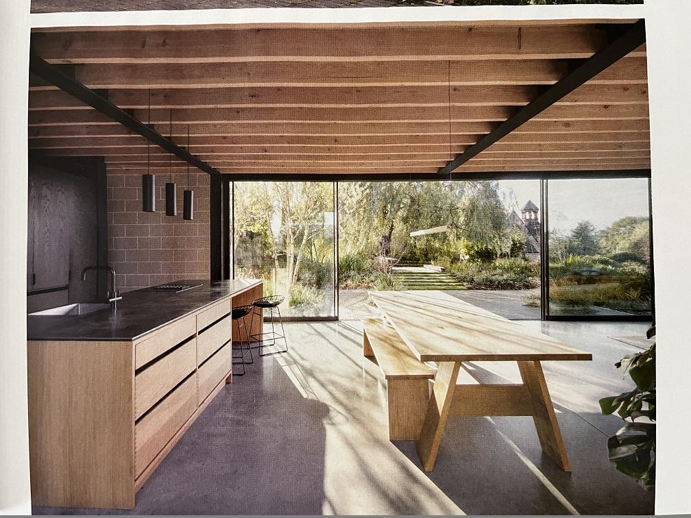

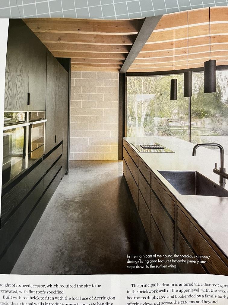

Alan Ambrose Posted June 18, 2024 Posted June 18, 2024 (edited) In this issue of Homebuilding & Renovating p24-31 (the 1st image doesn't have a wavy ceiling, it's just the way the magazine is sitting on my desk). I like the look a lot. My question is: how do they do this without covering the whole thing in plasterboard etc for fire protection? Standard paint over intumescent paint maybe? Edited June 18, 2024 by Alan Ambrose

Alan Ambrose Posted June 18, 2024 Author Posted June 18, 2024 But it looks like, from the article, they do:

Gus Potter Posted June 18, 2024 Posted June 18, 2024 9 hours ago, Alan Ambrose said: In this issue of Homebuilding & Renovating p24-31 (the 1st image doesn't have a wavy ceiling, it's just the way the magazine is sitting on my desk). I like the look a lot. My question is: how do they do this without covering the whole thing in plasterboard etc for fire protection? Standard paint over intumescent paint maybe? The starting point here is to actually understand how the structure works. Only then can you come to an informed view. Every design if different. 7 hours ago, nod said: NO Now it gets technical as while it may not be carrying any vertical load it may be contributing to the stability of another element that requires a higher level of fire protection. 7 hours ago, Russell griffiths said: As John said. Unless a habitable room above then no fire protection needed. the timber however would need a treatment to stop the spread of flame. so a treatment so a fire will not roll across the ceiling and spread to another area. Yes this is a slightly different part of the regs.. fire spread. Clearly what @Alan Ambrose has posted is a habitable space.. but not an apartment i.e a bedroom. 4 hours ago, MikeSharp01 said: That is possible but these days you can get many colours in intumescent. We did our only steels, two uprights supporting a cross beam, in white intumescent they look good but only a portion of them will show. Agree. 2 hours ago, Conor said: Just because it's in a magazine doesn't mean it's compliant or passed inspection. Bet half the stuff on grand designs never gets passed without something major being changed. And I've seen several examples in home building mags, e.g. a set of stairs with absolutely no guarding or handrail. Edited 1 hour ago by Conor Yes some of the stuff you see is complete bollocks and not compliant. My summary for folk on BH.. Use your common sense if starting out on the self building journey. If you want to refine you BC and SE design then great.. we call that value Engineering. But for fire.. be safe folks as there is often no second chance. I'm an SE / Designer and we often design for folk and builders doing daft things, we call this robustness and alternative load paths. This means that if sometihng fails you will see the building protesting.. cracking and groaning so you will get yourself and your family out in time. That is why in the UK we don't read about lots of folk getting hurt due to structural failures. But fire.. look at Grenfell and if you read the local papers you'll see that lots more folk die just in their "wee houses".. many more than Grenfell every year. My advice.. don't cut corners on fire design and safety. For a bit of insight. The fire regs are intended to meet these basic but not all criteria. 1/ They are intended to allow folk to escape from a building. 2/ They are intended not to put the fire fighter's lives at risk.and their families that they support financially. 3/ They are intended to not set light to surrounding buildings and this part of the regs dates back to the fire of London. 4/ They are not intended to allow you to save money and put other folk at risk. This means that if you cock up you may be asked to prove that you were not at fault.. you may have to fight a publically funded body not least to prove you were not at fault ..and could lose your shirt.. everything. My advice folks. If in any doubt play safe and don't cut corners on fire safety.. as if your house does go on fire and if you have taken the piss out the regs (have a mercenary streak) your insurer may not also pay out. There is a bit in the building regs in Scotland that says even if you get regs approval the liability lies with the designer. In summary there is a lot of good comments on BH about this.. but every project is different so please do your research. Good research can save you a lot of money and you can still be safe.. but it takes time and effort. There are no short cuts.

Alan Ambrose Posted June 19, 2024 Author Posted June 19, 2024 Apologies - I was not intending to cause controversy - I was just asking, as a fire regs newbe, 'how does this meet the regs'. Reading this article and looking at the pictures more closely, I think that structurally it is probably a steel frame building entirely (i.e. not a few random steels dropped in for span purposes). It actually appeals to my meccano-kid 5-year old self. So, I suppose nicely coloured intumescent paint is the simple answer.
