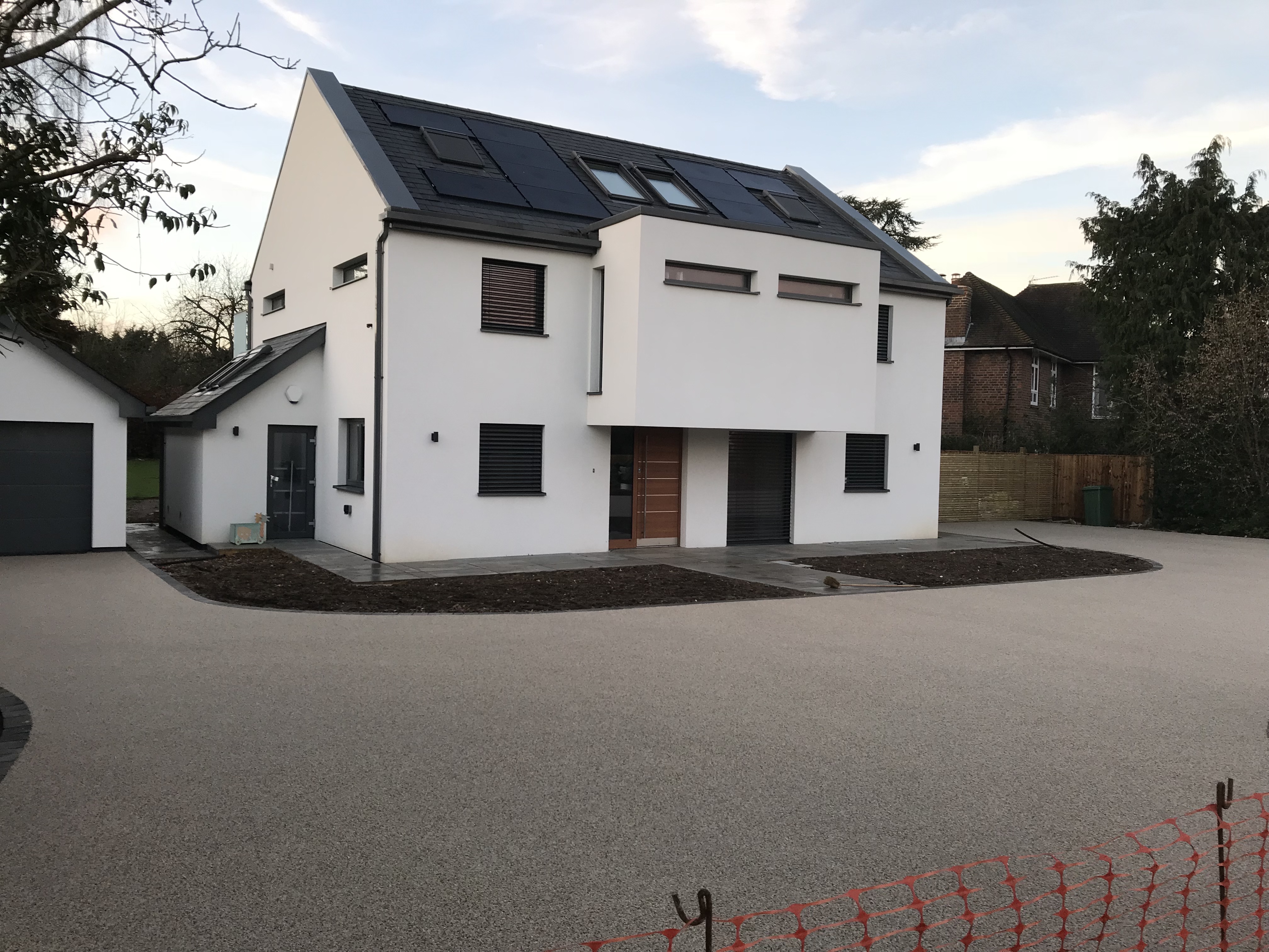

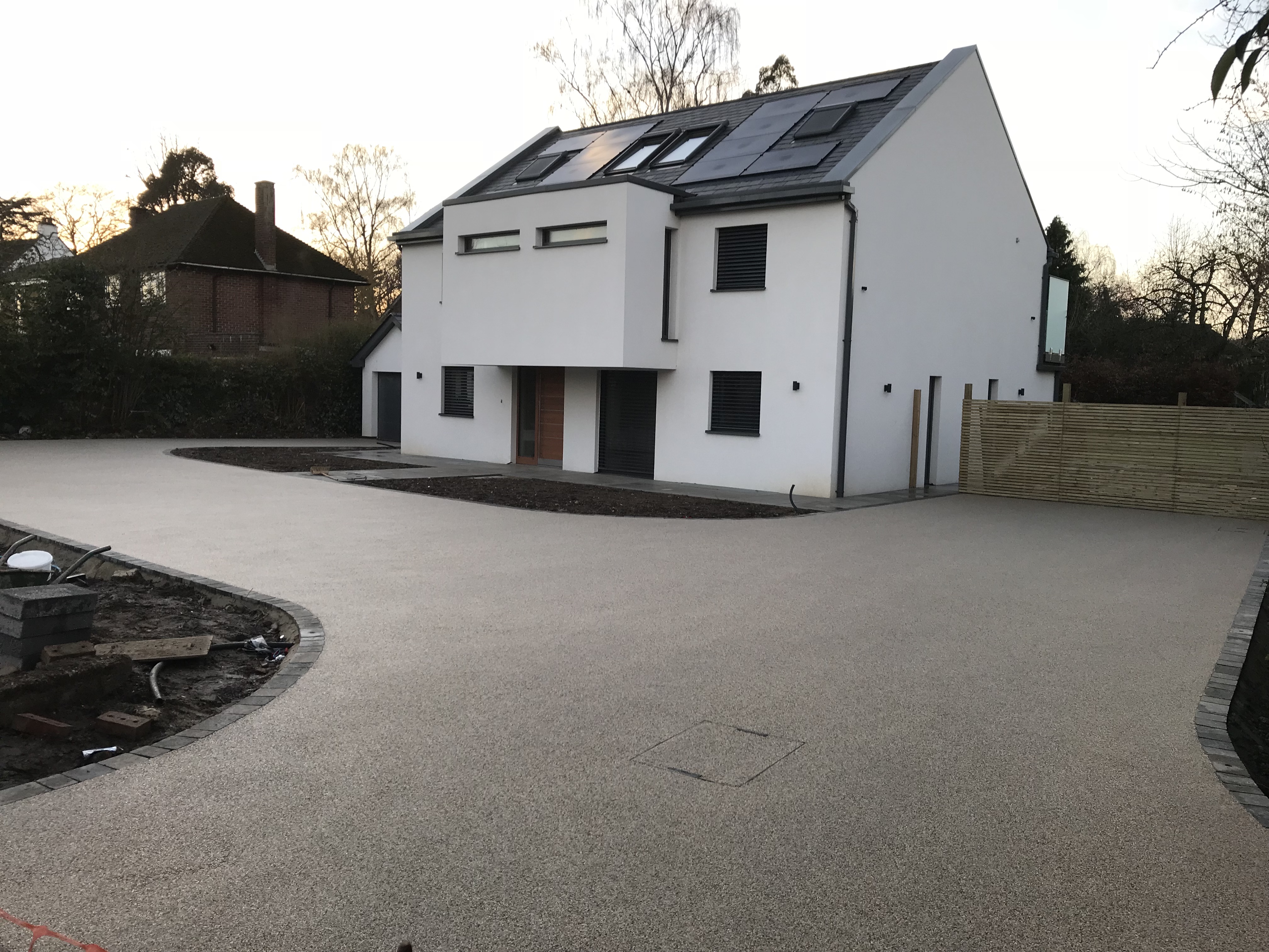

Bitpipe Posted January 10, 2018 Share Posted January 10, 2018 I'm having mine laid as I type - just had the resin bound/bonded discussion with the contractor. He's amazed that architects interchange the two when they are quite different - bound is permeable and the bonded is not. Spec is pretty much same as Peter. We've laid a block perimeter to enclose the resin and have a substantial sub base, competed in layers, before the permeable tarmac and resin is laid. Our landscaper did all the prep work. Very surprised at the speed. Our H shaped drive is about 250m2 and the tarmac was down and level in half a day. They're back today doing the resin and after an hour have already done about 20%. They're using a specialist mixer to blend the resin, aggregate and sand (looks like a candy floss machine) as he says standard bell mixers don't mix as well and the resin collects at the bottom. Hand troweled finish and a dusting of powdered glass for grip and sparkle! Cost wise (and these are SE prices), tarmac is £25/ms and the resin bound gravel is £51/m2, although we've gone for a very light colour which necessitates more expensive clear resin. Darker colours can use the cheaper yellow resin and are more like £30/m2. Like any high value service, there are lots of chancers in the game (glorified tarmackers) so we were careful to get a good recommendation and check the work of our guy. As we're a big job - he has about 8 lads on site right now so it will get all laid in a single day with no joins. For the bel mouths, we're going for blocks (to match the perimeter) with the gates as a transition point between the two materials. It's the final big spend of the build but a great note to end on as it looks spectacular. Link to comment Share on other sites More sharing options...
Bitpipe Posted January 10, 2018 Share Posted January 10, 2018 On 20/10/2017 at 16:28, PeterStarck said: The tarmac is permeable in my case. Permeable tarmac has been around for quite a while and is used on parts of some racing circuits where water lies. Same for us - I understand that it's not as hard wearing as the impermeable variety but as a base layer its fine. Link to comment Share on other sites More sharing options...
Bitpipe Posted January 13, 2018 Share Posted January 13, 2018 All done - just need to keep cars off it until we get the entrances paved next week. Then I can render wall, hang gates, plant hedge, turf front etc... I keep telling myself that we’re almost done ? 11 Link to comment Share on other sites More sharing options...

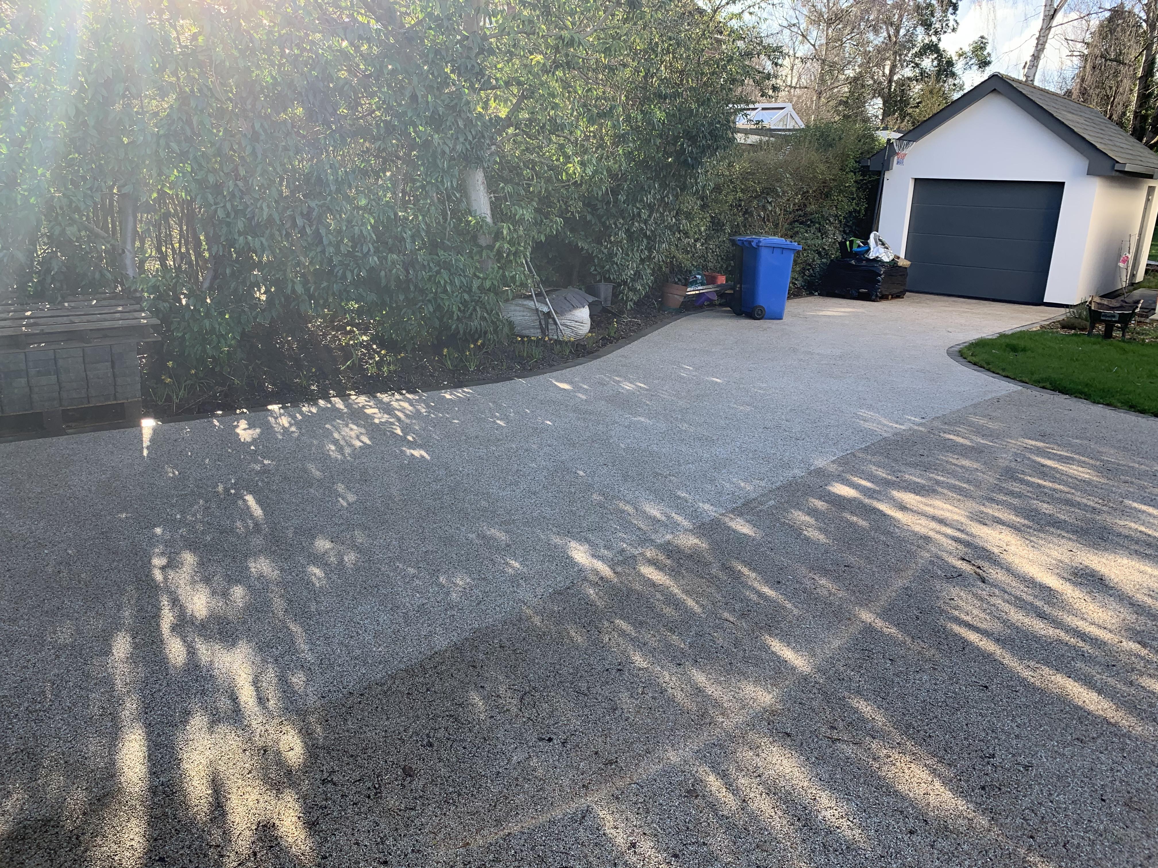

gc100 Posted February 29, 2020 Share Posted February 29, 2020 Just come across this by chance and I couldn’t believe how dirty resin bond could get. Hasn’t been touched for 4 years but still. Looks like a shaded area which isn’t going to help. Anyhow thought I’d share Link to comment Share on other sites More sharing options...
Onoff Posted February 29, 2020 Share Posted February 29, 2020 Overall he seemed to be quite thorough there. Mind he started off so well with his broom, wheelbarrow and shovel but then pushed a load of crap into the road rather than put it in the barrow. That's just plain lazy. Wtf does he think it's going to go? You'll quite likely drag some back onto the drive when you pull in next. Link to comment Share on other sites More sharing options...

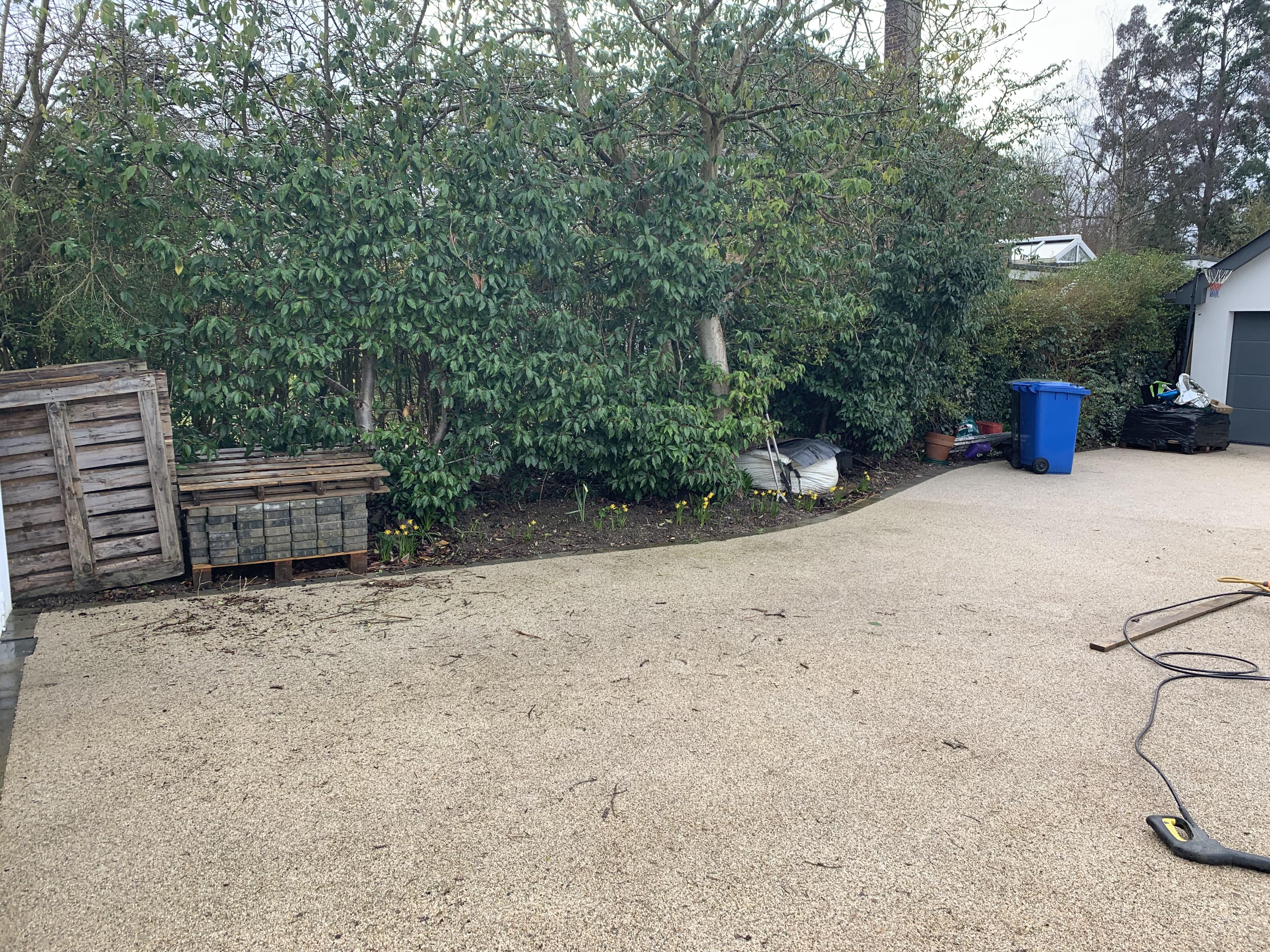

Bitpipe Posted February 29, 2020 Share Posted February 29, 2020 Ha - have just started to give mine its first proper clean. I noticed some blades of grass starting to grow in it - I suspect this is grass seed that washed off the front lawn bit that I finally finished before xmas. The lawn has already started to sprout and I'll probably overseed in spring when I see how it's taken. Need to hold the pressure waster quite close to the surface to dislodge any growth but it does look good. I think I'm about 10% there Link to comment Share on other sites More sharing options...
Declan52 Posted February 29, 2020 Share Posted February 29, 2020 He definitely done a good job cleaning that up. Don't think it will matter much though as with a driveway as white as that it will always look dirty with a tiny amount of grime on it. Link to comment Share on other sites More sharing options...
Declan52 Posted February 29, 2020 Share Posted February 29, 2020 1 minute ago, Bitpipe said: Ha - have just started to give mine its first proper clean. I noticed some blades of grass starting to grow in it - I suspect this is grass seed that washed off the front lawn bit that I finally finished before xmas. The lawn has already started to sprout and I'll probably overseed in spring when I see how it's taken. Need to hold the pressure waster quite close to the surface to dislodge any growth but it does look good. I think I'm about 10% there I'm just finished doing my pavers. Lidl had a patio cleaner attachment for a powerhose and it has done a great job. Had to abandon ship though with it mostly done as it's started to lash down. Link to comment Share on other sites More sharing options...
Bitpipe Posted February 29, 2020 Share Posted February 29, 2020 (edited) One leg of the H done, like you it’s too wet here and the water is starting to puddle on the drive as ground is saturated. Thats probably the worst bit - in shade and next to trees so a bit mossy. I have a flat circular head for the Karacher - it’s good for a general clean but not as effective when there’s ingrained dirt and moss. The only downside of bonded gravel is it’s inherent open texture which will always give the opportunity for things to grow on it. This is like carpet cleaning though - until you've done the first bit its hard to tell how filthy it is Edited February 29, 2020 by Bitpipe 1 Link to comment Share on other sites More sharing options...
