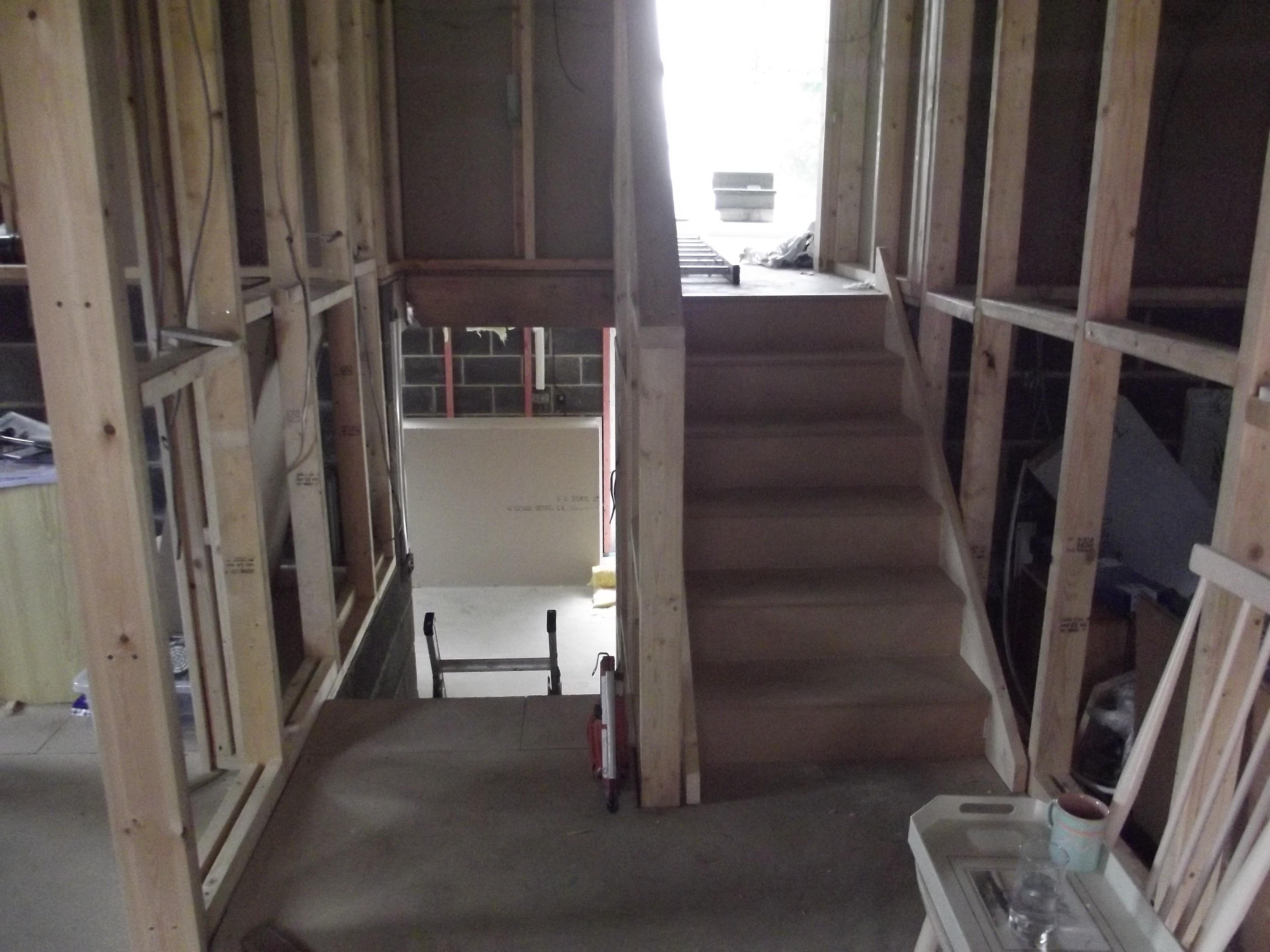

epsilonGreedy Posted June 20, 2018 Share Posted June 20, 2018 Woohoo, all it needs now is a nice man with a few sheets of plasterboard and a reel of cable to visit and oh a stairs would be useful. Link to comment Share on other sites More sharing options...
Hecateh Posted June 20, 2018 Author Share Posted June 20, 2018 Stairs are the next big thing for me. Currently I can only get downstairs by going outside and round. Unlike my fit joiners who easily jump up and down (although I most admit they are not so quick by the end of the day lol) Link to comment Share on other sites More sharing options...

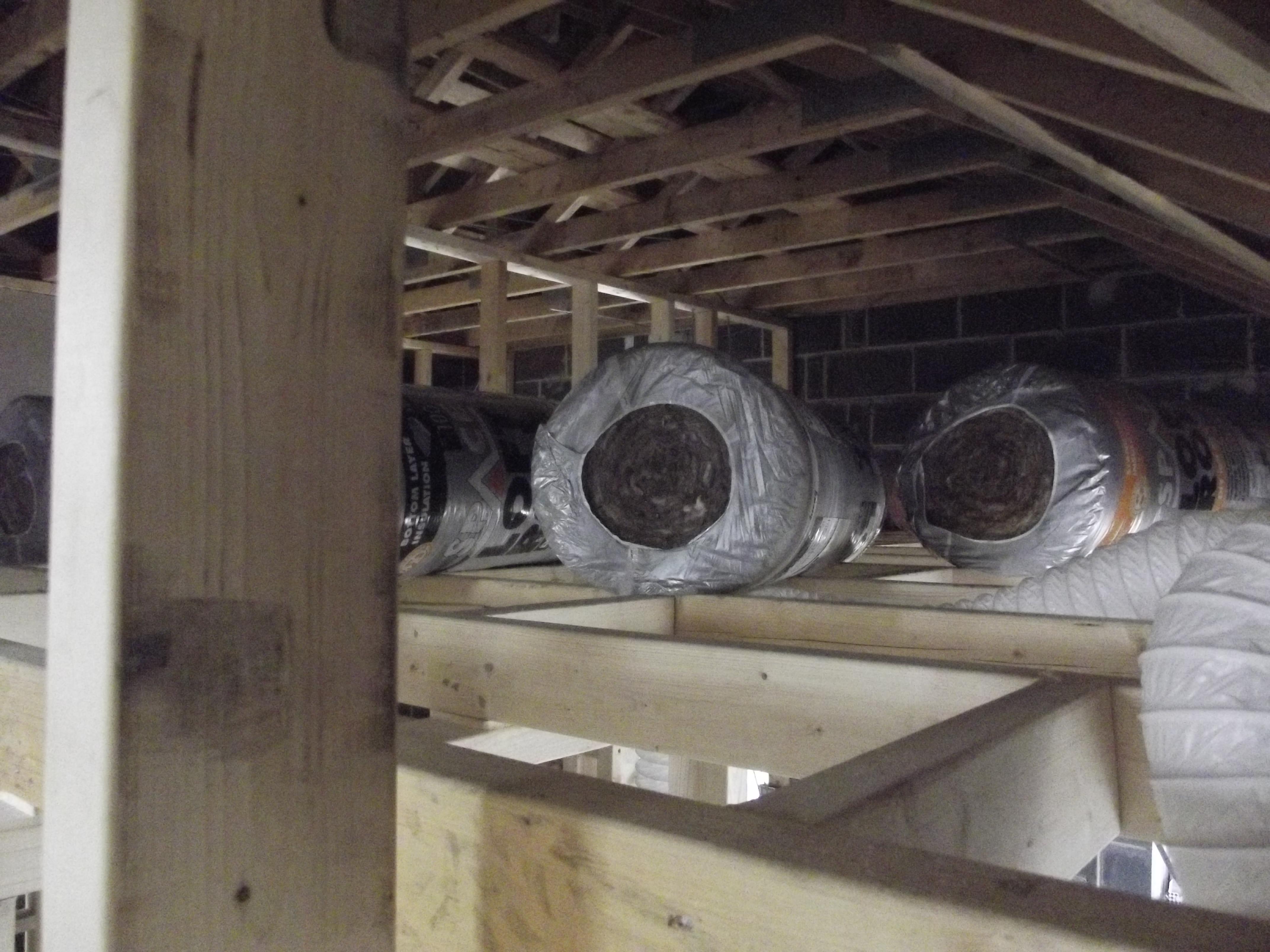

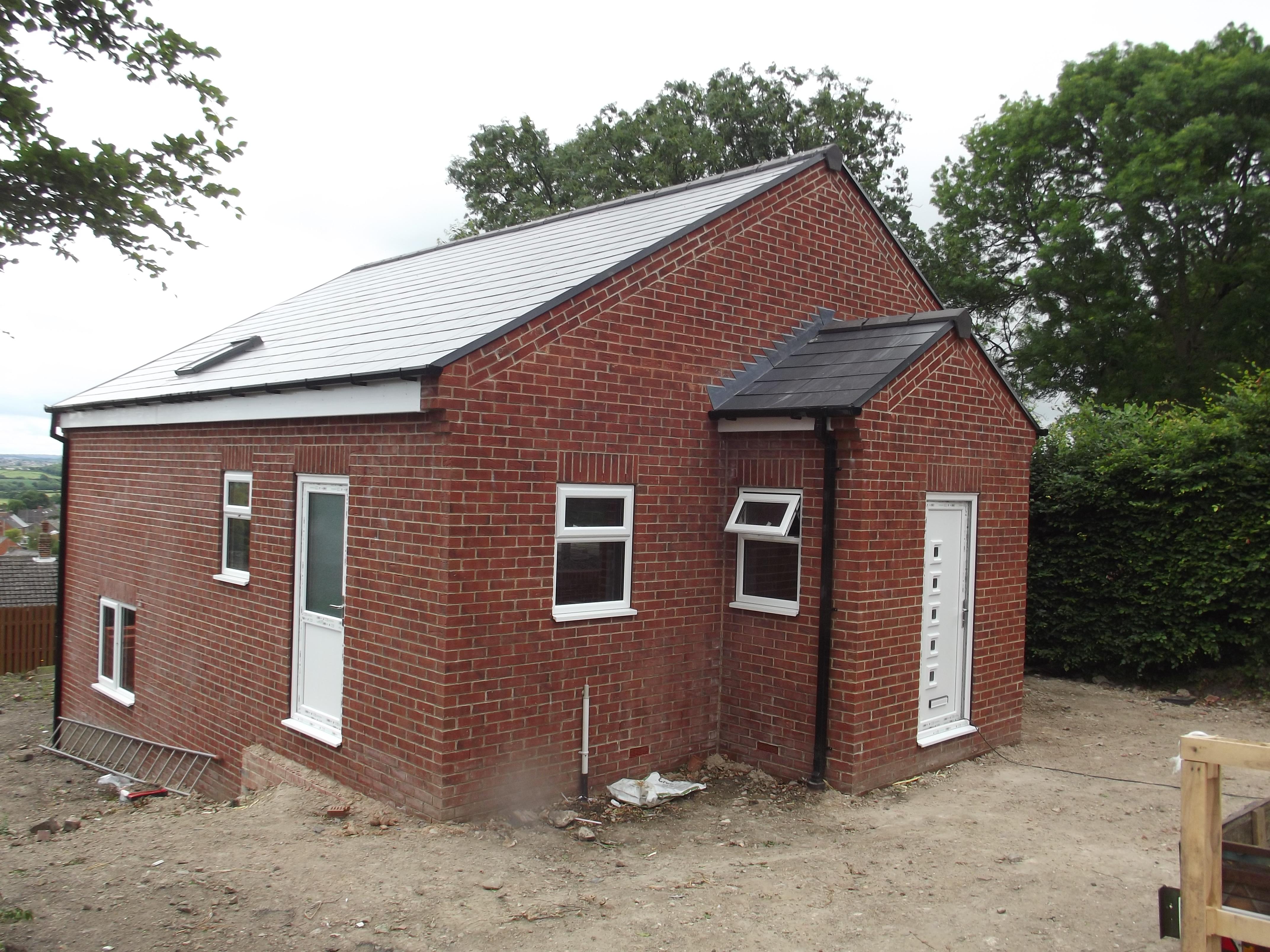

Hecateh Posted September 12, 2018 Author Share Posted September 12, 2018 Quite a lot done in the last couple of months but nothing worth photographing. (Sometimes it's the little things that make the most impact.) many many traumas along the way - budget - what budget, but I am getting there.... Stud walls all done; UFH piping installed; (including screed in lower ground and battens, insulation, spreader plates and overboarding on entry level; first fix plumbing and electricity; door frames; insulation; insulation; insulation; (luckily my handyman says he is immune to the fibreglass and it doesn't bother him but I insisted, and he agreed, he goggled and masked when crawling in the confined loft space) AND today I got S.T.A.I.R.S woo hoo - starting to look like a house. 4 Link to comment Share on other sites More sharing options...

Hecateh Posted September 12, 2018 Author Share Posted September 12, 2018 On 20/06/2018 at 14:31, epsilonGreedy said: Woohoo, all it needs now is a nice man with a few sheets of plasterboard and a reel of cable to visit and oh a stairs would be useful. Well it took a while but I do finally have stairs woop woop 1 Link to comment Share on other sites More sharing options...

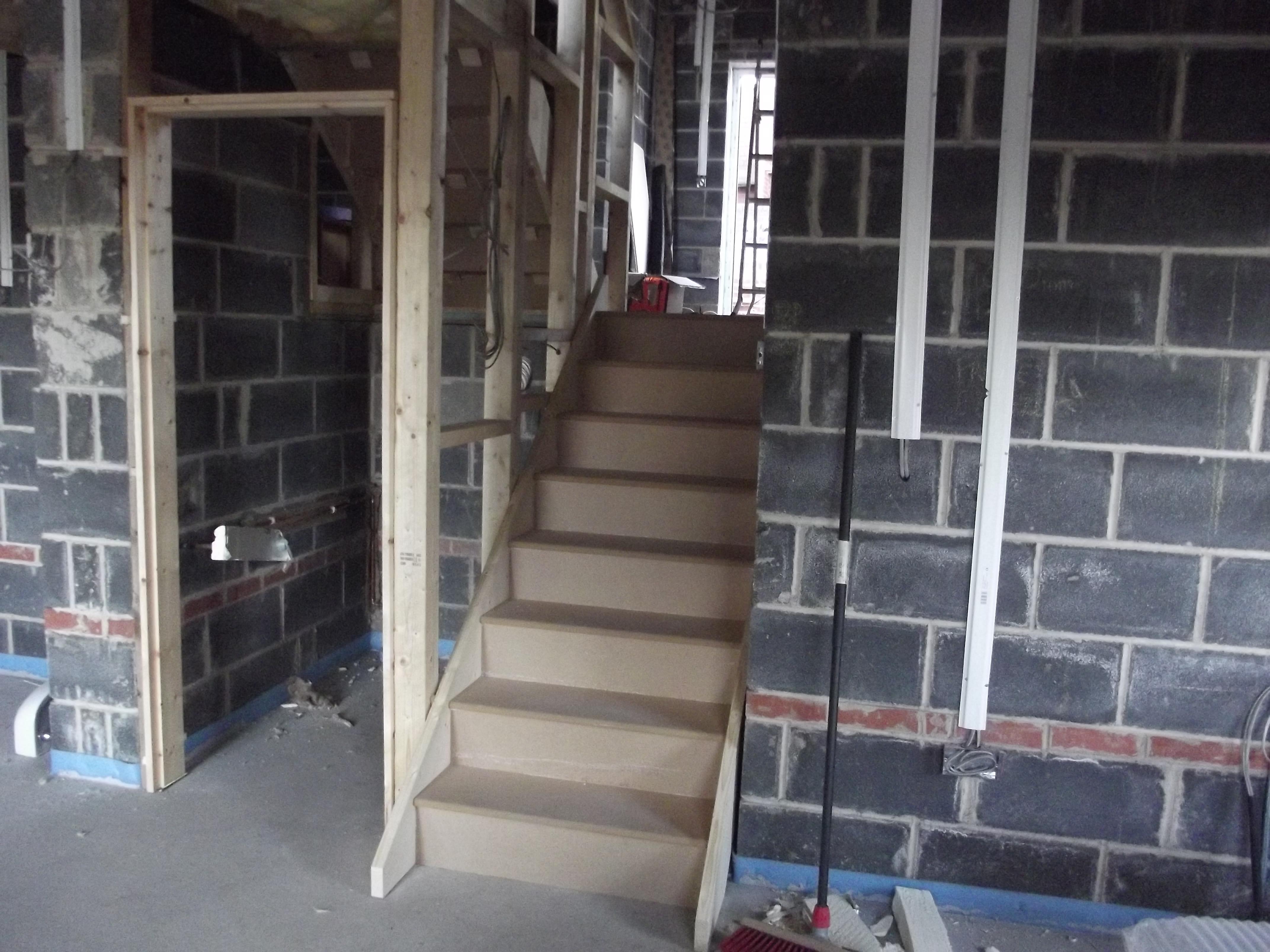

Onoff Posted September 12, 2018 Share Posted September 12, 2018 (edited) That pic where the broom is leaning, you have a bit of capping coming down the wall with two bits of cable in. Is there any socket etc going this side of the wall? Basically I'm suggesting that cabling might be "outside the zones". Nothing to stop you as I can see it drilling there and hitting the hidden cabling. To add you would usually look up/down, left and right from a socket or switch and know not to drill there in the "band" drawn up/down/left or right of the socket etc. Edited September 12, 2018 by Onoff Link to comment Share on other sites More sharing options...

Hecateh Posted September 13, 2018 Author Share Posted September 13, 2018 8 hours ago, Onoff said: That pic where the broom is leaning, you have a bit of capping coming down the wall with two bits of cable in. Is there any socket etc going this side of the wall? Basically I'm suggesting that cabling might be "outside the zones". Nothing to stop you as I can see it drilling there and hitting the hidden cabling. To add you would usually look up/down, left and right from a socket or switch and know not to drill there in the "band" drawn up/down/left or right of the socket etc. Mmm not sure. I hadn't really noticed it. I'll make sure it is marked on the wall when it is done and check with the electrician. That is where the fridge freezer is going so, if necessary I'll leave the wall marked. Link to comment Share on other sites More sharing options...
