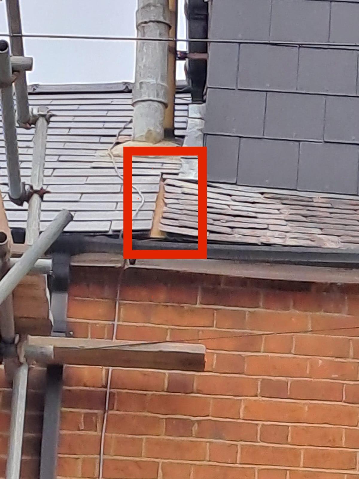

alman Posted June 2, 2024 Share Posted June 2, 2024 We have recently purchased an 1873 terraced house with original flint tiles roof. We had to do some internal sanitasing jobs and we have not moved in yet. Last week we went to finish some jobs and found our next door neighbour replacing their roof with some sort of plastic/composite tiles. Without any warning of any planned work, we found her roofers on our roof. Part of the original flint tiles on our roof had been removed. We talked to the roofers and to the neighbour and asked about party wall agreement, building control, etc. They tried to convince us nothing of this sort was needed and that we should be grateful that they are re-tiling part of our roof. Whilst we understand the roof may not be in its prime, we had no leaks, no problems. The roofers tried to convince us to change now our part of the roof too, quoting £9k, a discounted rate since they were already on the roof. Nevertheless, we do not have the funds and have no reason to prioritise this and we refused. We are unhappy with the fact that without consultation we had part of our tiles removed. Also with the fact that the bonding was installed on our part of the roof, not on the demarcation line of the properties. The bonding was installed in a busy area with chimneys and at the edge of our dormer. The likelihood of leaks is now high. We talked to the neighbour and provided her with the phone number of the council's building controllers. She said she could not go through therefore we called them and they confirmed there should have been an approval in place, a party wall agreement and building regs have to be adhered to. They promised to send someone to inspect, however the roofers have now "finished" their job and we do not know whether they've done a good job. It certainly doesn't look like it. They installed a secret valley, however this appears to be only from our dormer down. Our tiles linked to the valley are at a strange angle. There does not appear to be any valley installed at the back. Any advice Link to comment Share on other sites More sharing options...
alman Posted June 2, 2024 Author Share Posted June 2, 2024 I attach photos of how we discovered the roof was being replaced. Our house is at the right, the one with the dormer. The demarcation line between the properties is at the left of the downpipe Link to comment Share on other sites More sharing options...
joe90 Posted June 2, 2024 Share Posted June 2, 2024 Although this is wrong frankly tiling up to your dormer is a better method IMO. Link to comment Share on other sites More sharing options...

Tetrarch Posted June 3, 2024 Share Posted June 3, 2024 That "secret valley" looks very much like a sheet of plywood from your photo! Have you been up To take a look and take some close-up photos Regards Tet Link to comment Share on other sites More sharing options...

Kelvin Posted June 4, 2024 Share Posted June 4, 2024 Check what legal cover you have with your house insurance. I agree with the comment that the leading edge of your tiles don’t look like they’d survive the first high wind blowing in the right direction. You probably ought to get a professional survey done that way you’ll have something in writing rather than just your opinion. You aren’t going to get anywhere with the roofer for the time-being. Priority number 1 is to secure your roof though regardless of anything else as you don’t want any other problems. This will cost some money hence why you need to speak with your house insurance company. 1 Link to comment Share on other sites More sharing options...

Blooda Posted June 4, 2024 Share Posted June 4, 2024 You may also, kindly, suggest to your neighbour they get that Flue / Chimney checked out by HETAS registered company, urgently. It's hard to say from the photo what they have done, but it does not look right, as if they have just left it in place, and it has moved, whilst they were reroofing. They may have broken a seal, and judging by the info on this thread, they may no be bothered. Link to comment Share on other sites More sharing options...
joe90 Posted June 4, 2024 Share Posted June 4, 2024 Are those two flues yours or your neighbours? The front one is strapped to your dormer! Using Mortor to waterproof to slate is not a good idea, lead flashing would be better. Link to comment Share on other sites More sharing options...

Blooda Posted June 4, 2024 Share Posted June 4, 2024 1 hour ago, Alan Ambrose said: - track down the roofers - addresses, vehicle reg, trading names etc. It’s fantastic that you have pictures of them and their work. There is a sign in Photo, hanging on the scaffold, if you have any photos from a different angle it may show the name and phone number clearly. That sign will definitely not be a scaffold company sign, no scaffold company would put their name to that 💩. Link to comment Share on other sites More sharing options...
