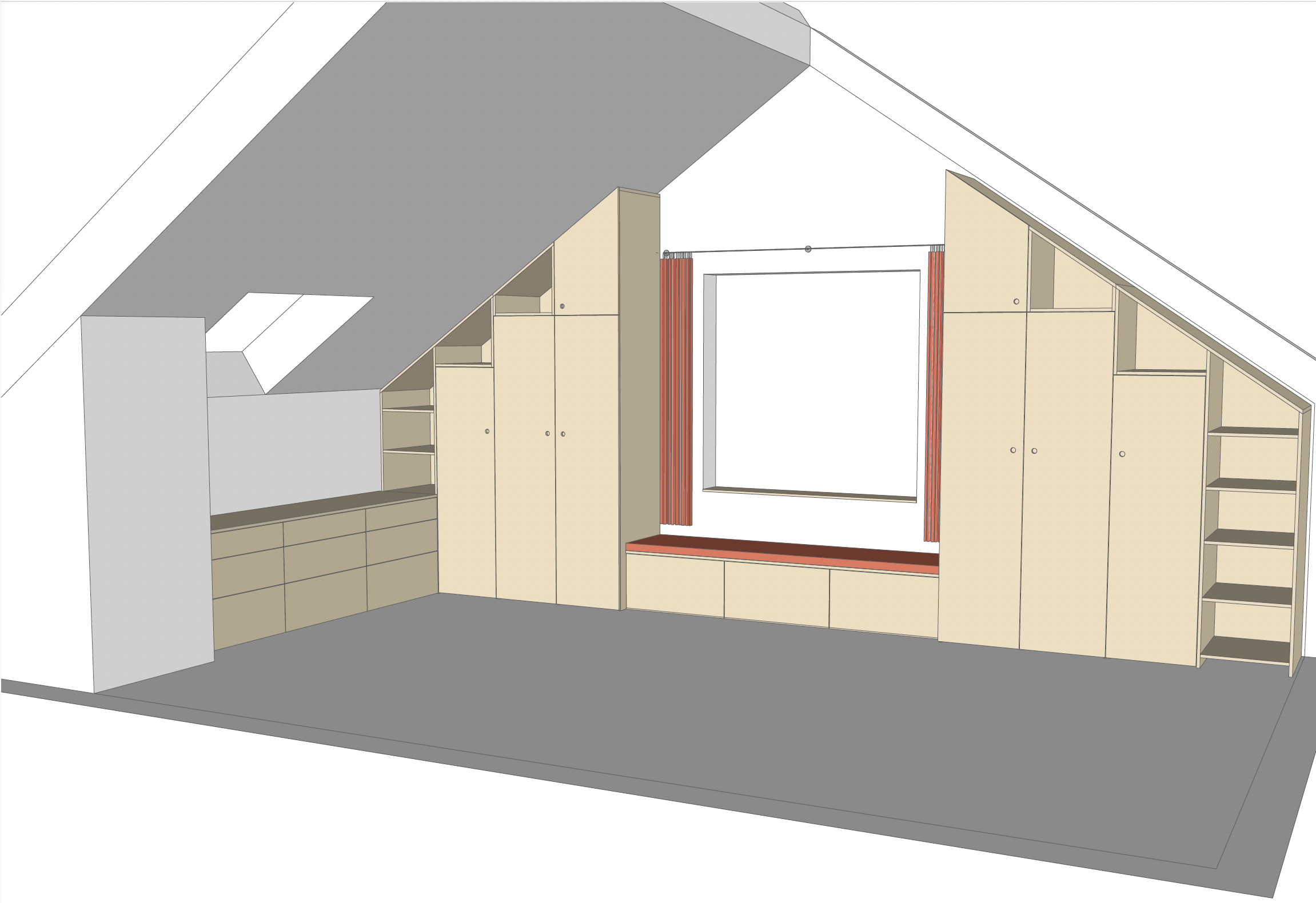

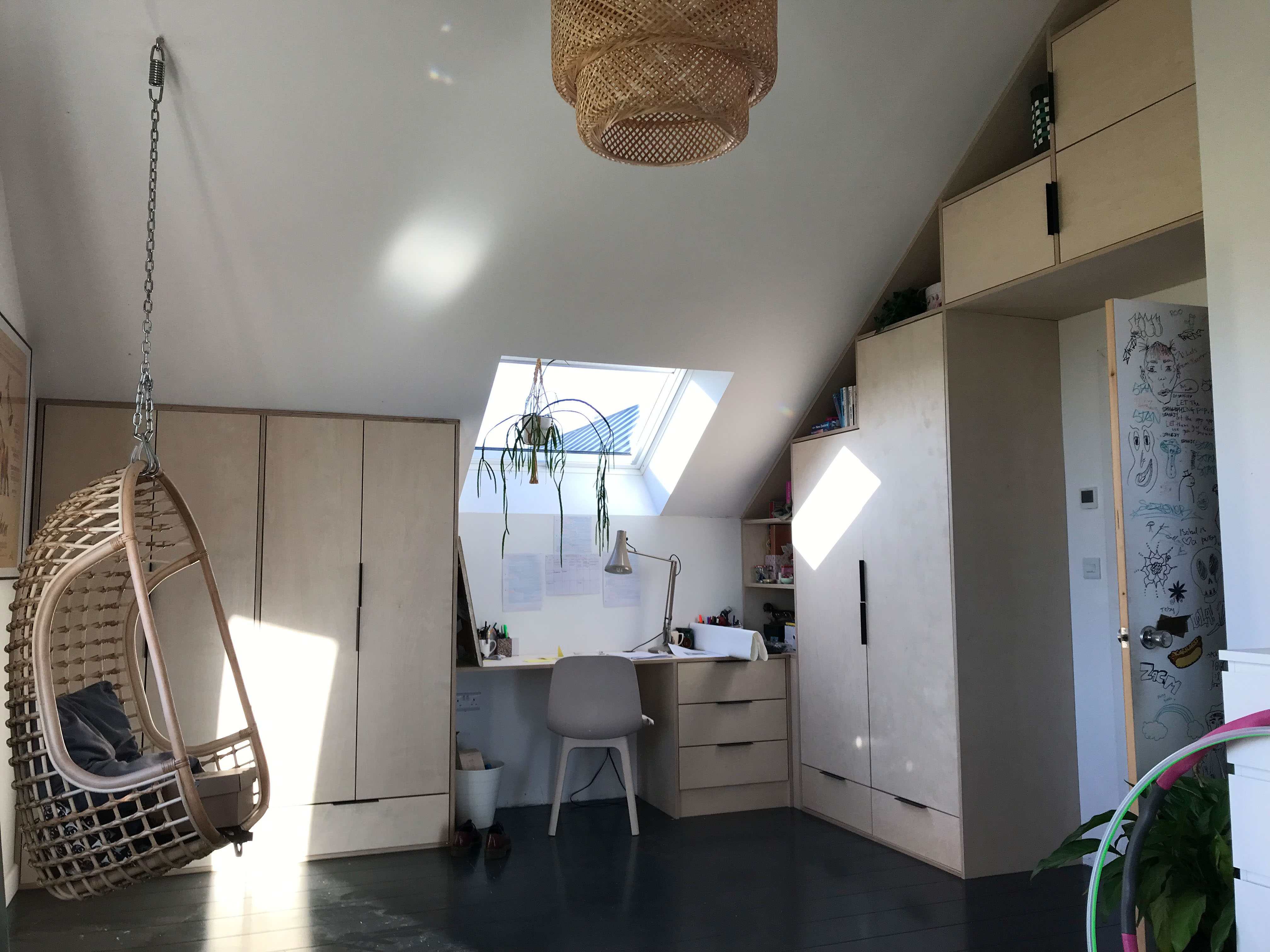

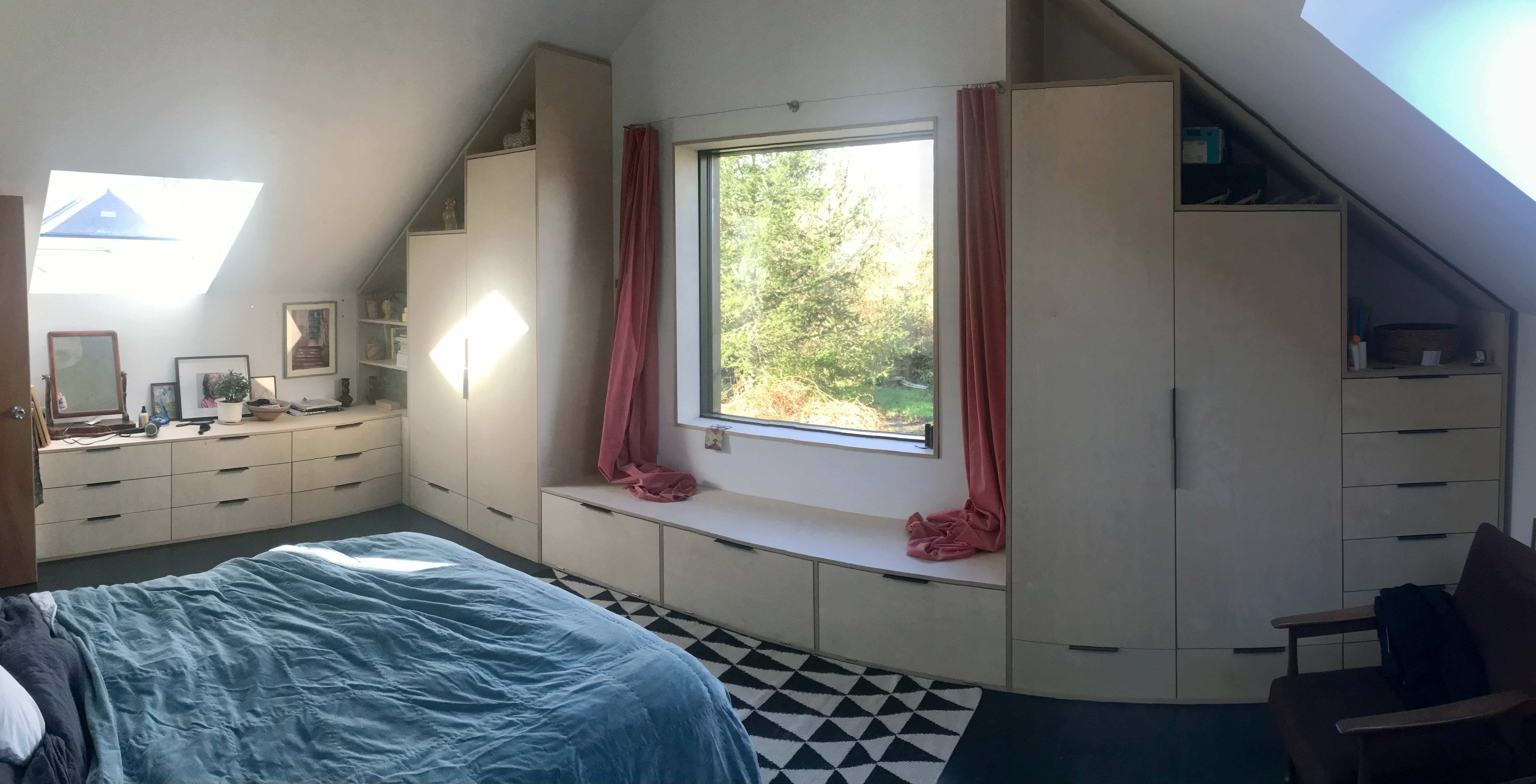

JamesP Posted June 1, 2024 Share Posted June 1, 2024 (edited) @AliG Can anyone recommend a cutting service ideally using plywood, I can provide accurate drawings. We are planning on some built in cupboards and drawers in 2 bedrooms but a recent quote (30K) means an alternative will be required. Any ideas appreciated. Example enclosed. Edited June 1, 2024 by JamesP Link to comment Share on other sites More sharing options...
AliG Posted June 1, 2024 Share Posted June 1, 2024 We ordered that kind of stuff from diyhomefit. There is also a company called Lark and Lark that offers a similar service and I have seen a new company called Fittingly but they don’t quote prices. I’d guess the cabinetry would cost around £7000 but the angled pieces would be an issue. You’d probably have to cut them on site. If you could make the design work using DIY Kithcens range of cabinets then it would be somewhat cheaper but I don’t think they would be flexible enough size wise. Then you can basically fit it yourself. It’s not difficult, or pay a joiner to do it. Personally I would not go down the plywood/MDF route. The finish is just not as good as a factory finish. 1 Link to comment Share on other sites More sharing options...

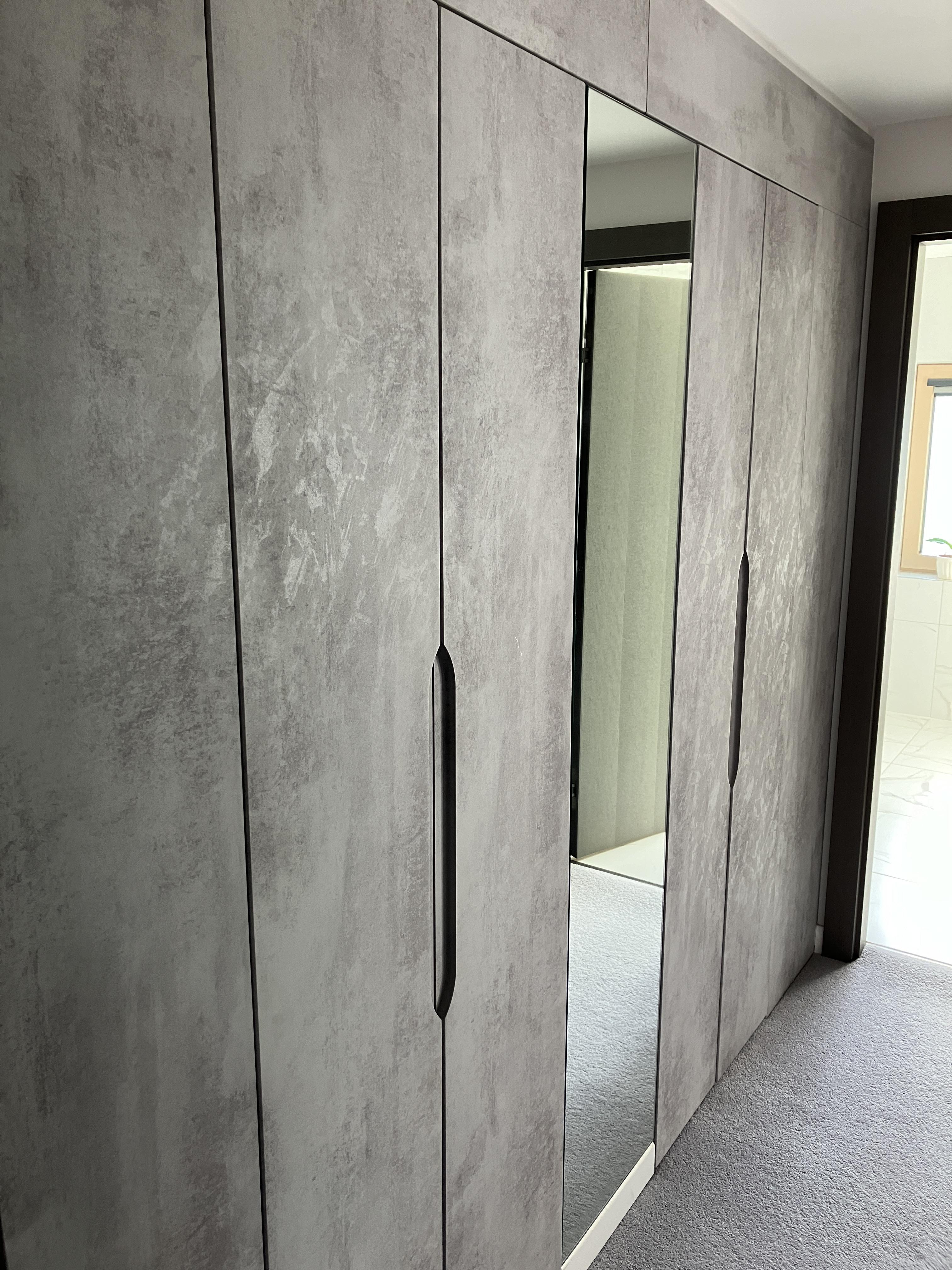

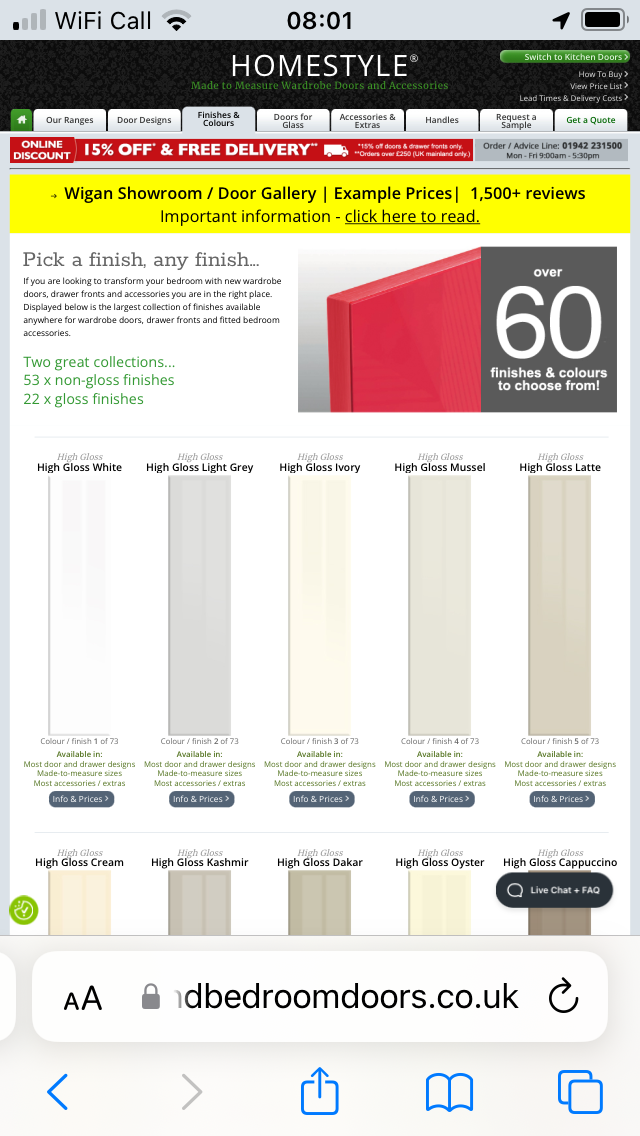

Russdl Posted June 2, 2024 Share Posted June 2, 2024 We used these peeps. Choose a finish, specify exact dimensions, where you want hinge holes etc and then wait for the delivery. We made a built in wardrobe and got all the doors and infill panels back panels etc from them for around £500. 1 1 Link to comment Share on other sites More sharing options...

JamesP Posted June 3, 2024 Author Share Posted June 3, 2024 @Bozza I do not doubt the quality and skill of the craftsmanship involved. We are near the end of the journey, broke ground in 2017 and moved in 3 years later. I have done most of the build except electrics, skimming and window fitting ( which was very poor ) so it is hard to justify spending over 10% of our total budget on two built in wardrobes. My build about £850/sqm. I have the tools and space but time is the issue as getting grief from you know who. I will start the drawings..... Link to comment Share on other sites More sharing options...

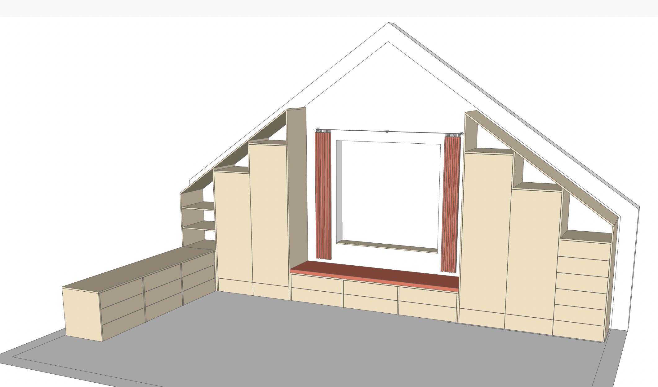

LnP Posted June 3, 2024 Share Posted June 3, 2024 @JamesPA bit off topic but what software did you use for the drawing? It looks good. Link to comment Share on other sites More sharing options...
JamesP Posted June 3, 2024 Author Share Posted June 3, 2024 2 hours ago, LnP said: @JamesPA bit off topic but what software did you use for the drawing? It looks good. I use Sketchup (Trimble) as a free version, though limited is available. 1 Link to comment Share on other sites More sharing options...

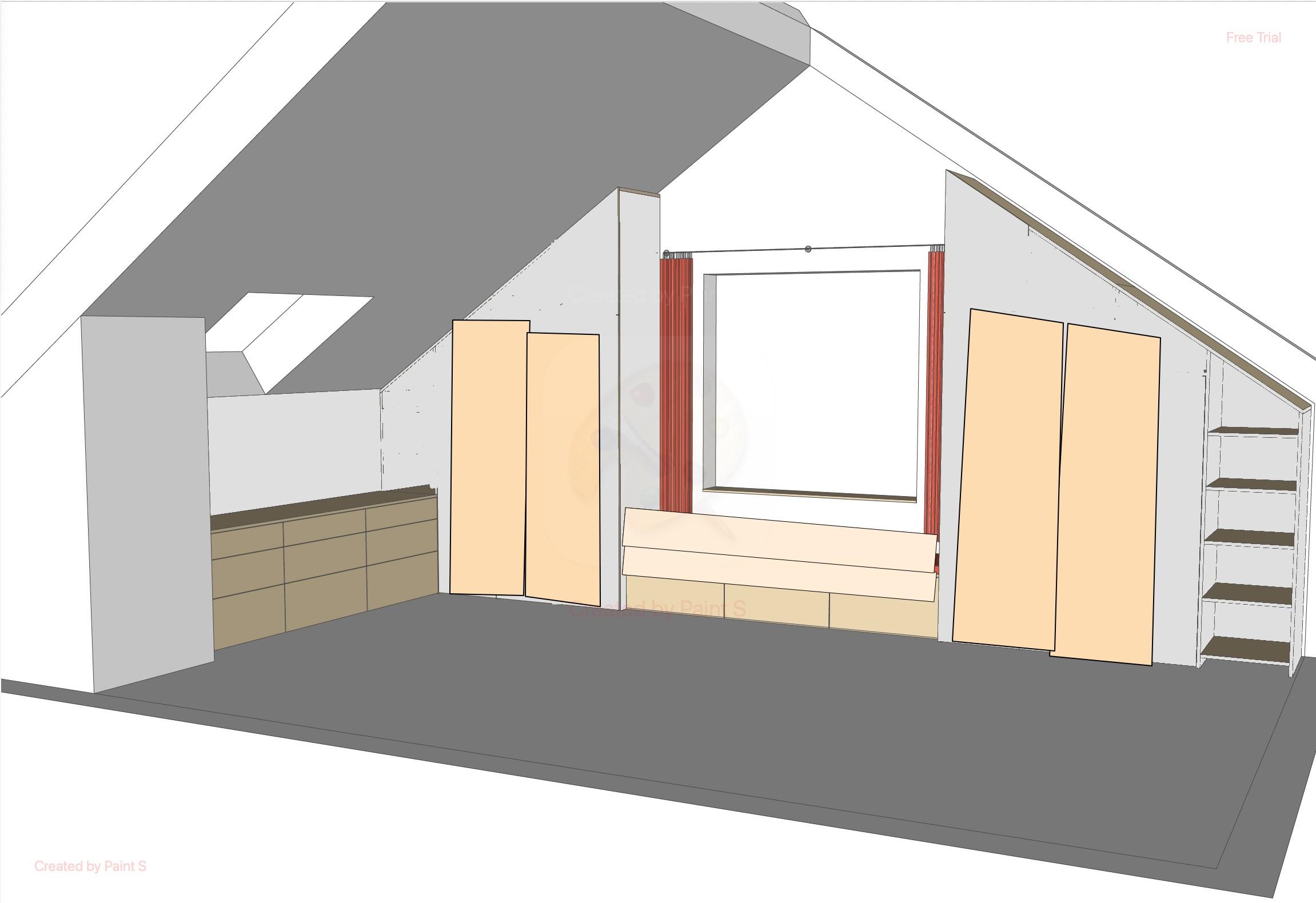

AliG Posted June 3, 2024 Share Posted June 3, 2024 Looking at this from another angle, so to speak - The design presented is unnecessarily fussy and expensive to make (not 30k expensive, but not easy) Looking at it, I was trying to figure out the best way to dal with the angled wall. Having considered it, I think the best thing to do would be to plasterboard in the area and out doors on it. Anything else leaves you with the odd shaped spaces on display and multiple heights of cupboard that just don't look right. I doubt you actually need all the shelves and you are just trying to fill in the spaces. Boxing them in with plasterboard would look better. Then you could add drawers in the space to the left and under the window. I think it would look better if they were the same height. Excuse the hand drawn perspective. Basically the little triangular areas aren't a lot of storage so just box them in. Alternatively take your existing design and box in the space above the cupboards in plasterboard. Link to comment Share on other sites More sharing options...

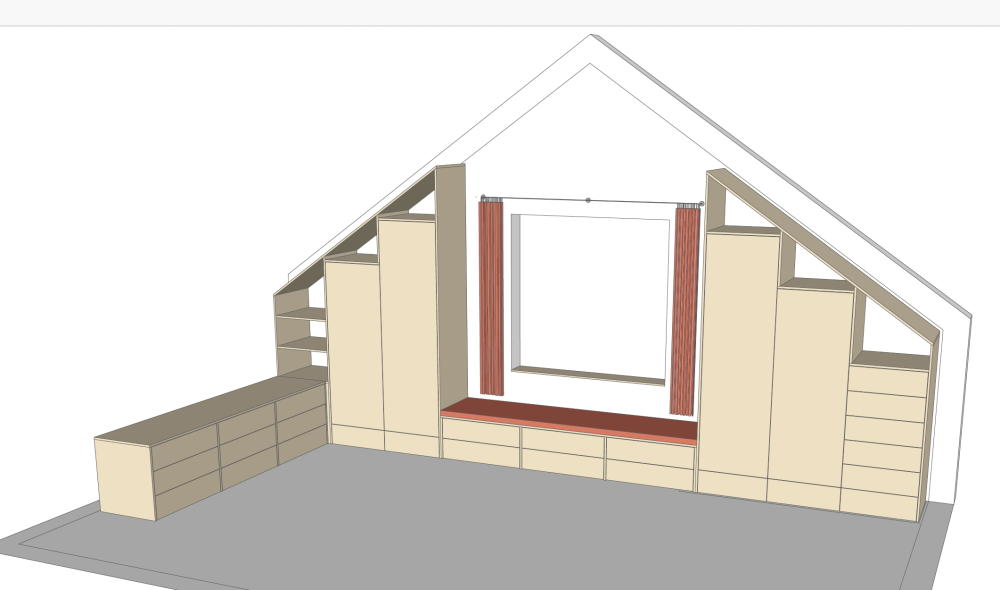

JamesP Posted June 4, 2024 Author Share Posted June 4, 2024 (edited) 8 hours ago, Kelvin said: £30k! Was that with one of the usual suspects or a local company? We have a similarly shaped space and a local cabinet maker said £10k and we thought that was a bit dear. Local recommended joiner / carpenter. Plenty of clients down here in South Devon who have the funds, not me. Looking at using Ikea cabinets with custom cut doors etc. About a 1/3 rd of the original price so far. New drawing using Ikea below. @AliG Wow, mind blown. You have skills....love it. Edited June 4, 2024 by JamesP 1 Link to comment Share on other sites More sharing options...
