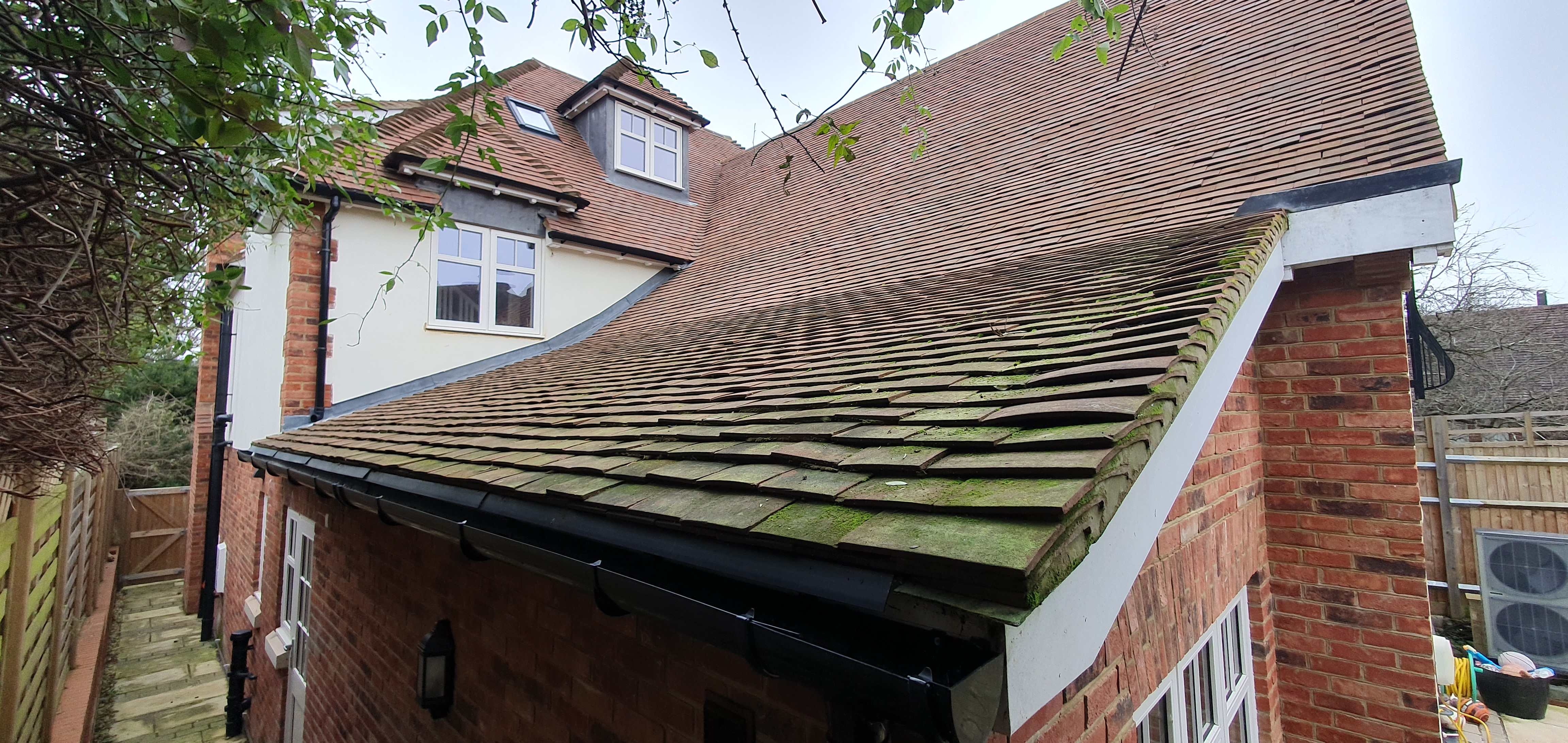

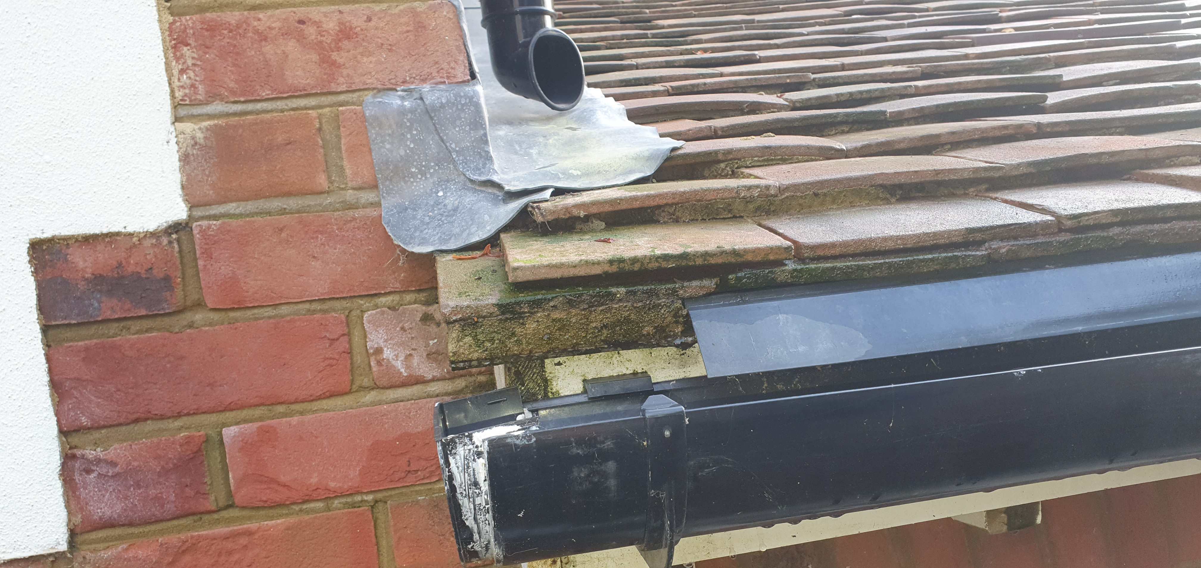

Hey all. Just wanted to say - over a year after the original post - I bit the bullet and had the roof replaced with Solum low-pitch tiles by a local roofer (in a perfect world I'd have tried it myself, but with all the recent rain, I wanted it done quickly, and I think they've done a pretty decent job) It seems to have done the trick as, even with the downpours we've had, the eaves seem bone dry. Thank you to everyone who offered an opinion and steered me in the right direction. Pain it had to be done but money well spent I guess! (PS. This means I have around 1,500 Heritage hand-made clay tiles left behind, that I'm going to put an add on for if anyone is interested! Just saying đ)

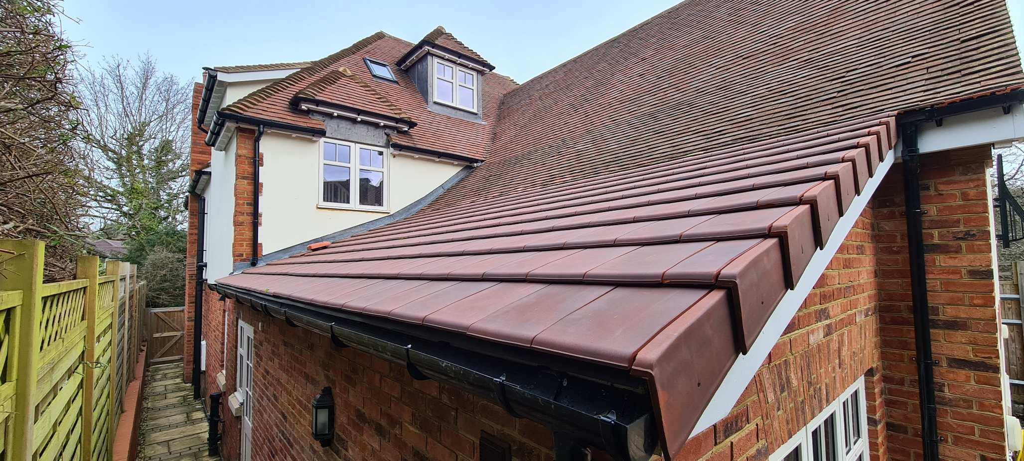

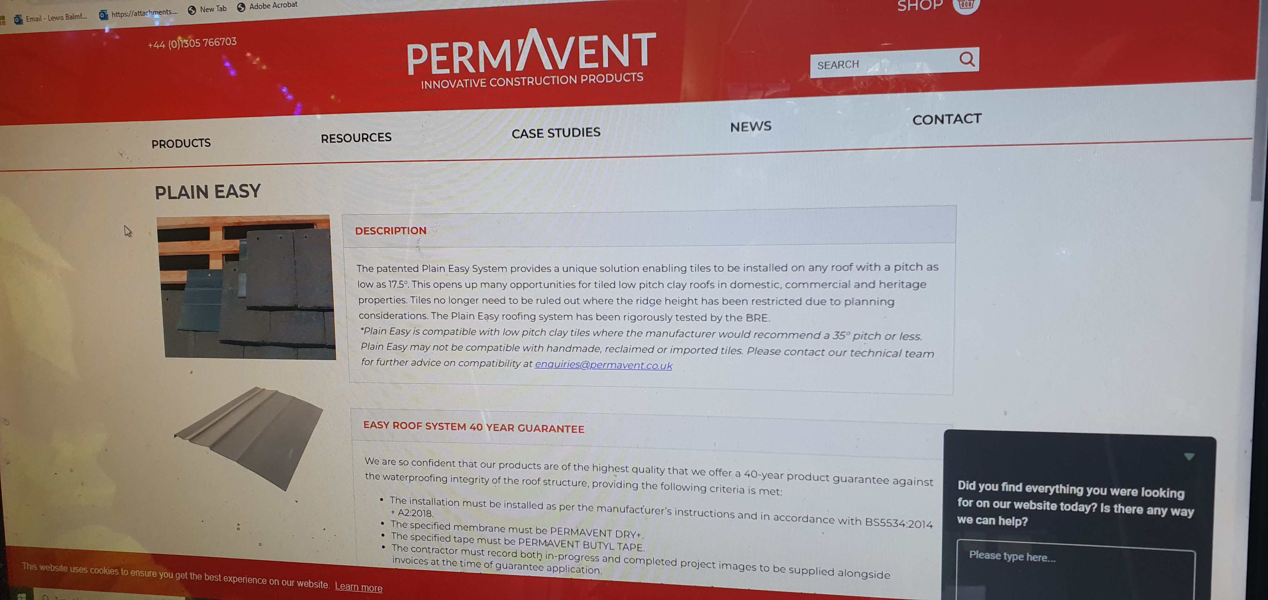

Sorry for the massive delay in getting back to this thread. For what it's worth I thought I'd give an update. I took a sample tile to a local roofing merchant and a helpful guy took a look at it and the photos. His view almost immediately was that the tiles were at too low a pitch. Apparently Heritage are rated down to 35 degrees, but this part of the roof is more like 25 and goes down to almost 10 near the lowest point. He put me in touch with another local roofer who came over and took a look. After quite a bit of chasing I pinned him down yesterday on what he felt needed done: All the tiles on the lower section of the roof (see full picture above) will have to come off as they are unsuitable for this pitch He has recommended replacing them with slate. This is the cheapest option and slate would be fine for this pitch, but it is not at all in keeping with the rest of the roof and I'm not convinced that it would not look awful. The alternative would be to use a Planum Red concrete tile which will go down to around 15 degrees, though these are a lot more expensive than slate. The slates would fit the existing battening but the planum might need the the battening replaced in order for it to fit. There are a number of other items that need to be changed such as lead flashing and guttering, as noticed here. The price of this is likely to be around ÂŖ5,000-ÂŖ6,000 depending on the choice of tiles mainly. Obviously a lot of money but it seems about average based on what I've been reading. Haven't got any other quotes. I've a good mind to ring the original roofer and let him know all this, though what good it will do I'm not sure. Feeling a bit gutted TBH. đ

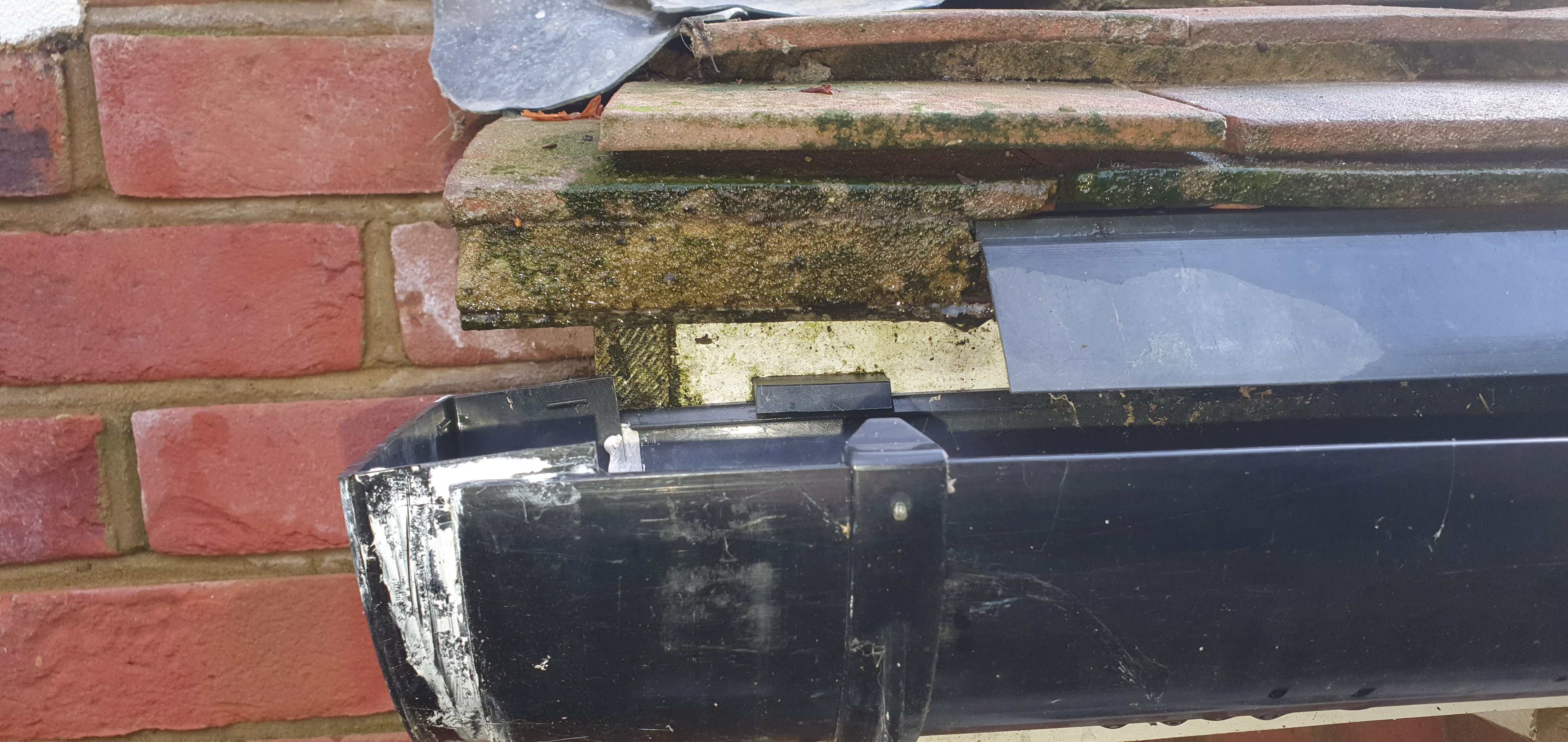

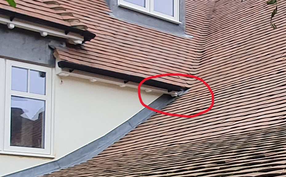

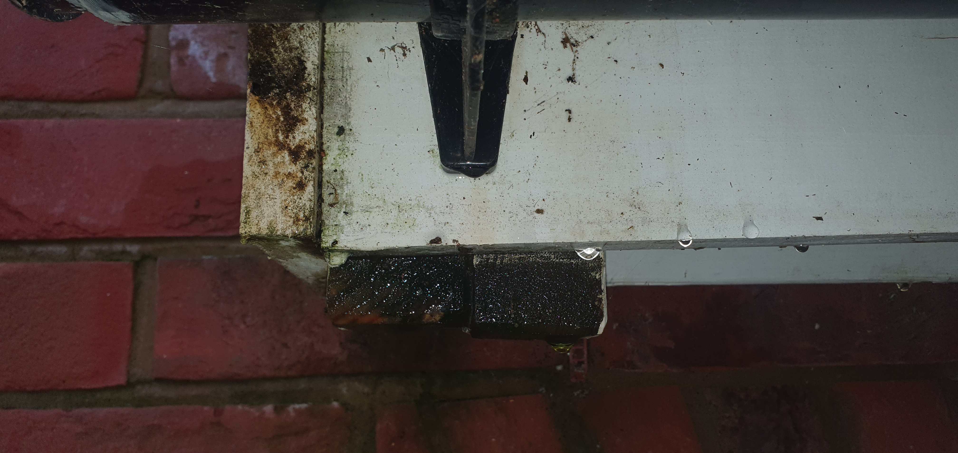

Sorry - a bit distracted with Christmas and other responsibilities. To go through the feedback above (and thanks so much everyone for taking the time to respond) There's a confluence point (see pic detail) where an awful lot of water comes together. I initially thought that this was the problem and that the issue was that the guttering (open ended on the right) should be closed with a down pipe on the left side nearer the window (ugly, but if it works) I also thought the that existing down pipe not shown here but to the left on the other side of the window, should be directed further out on the roof in case the deluge was going under the flashing. However, I have stood in fairly heavy rain and observed what's happening on the roof. Yes, there is a lot of water coming together at this point but it didn't look as if the roof was failing to cope with it. The gutter certainly appeared to be coping with the downpour and was not overflowing, nor was there evidence that the gulley was too tight and the deluge was overwhelming it. That's just from my untrained eye though. I'm therefore disinclined to think that this is the root cause of the problem - though it may still be a problem, I agree - mainly because of the following: There does not appear to be any evidence of damp or water ingress around the area of the flashing on the inside of the house. I admit it may just not have come through yet and I also agree that the flashing - particularly at the bottom - is lousy. The issue of water dripping down behind the gutter onto the facias and rafter footings seems more or less consistent across the length of the lower gutter - not just at the far end above the side door, which implies to me that it's a issue affecting the length of the gable end, not just the valley on the left hand side. Even after very light rain, or when there has been no rain for a day or so, I can often find - like the original pictures - lots of drips and moisture across the footings when the tiles and gutter are relatively dry. This makes me suspect that there is moisture trapped behind the tiles/membrane. On one occasion, the roofer came back and lifted several rows (can't recall exactly how many) of tiles and laid another membrane. This did not make any noticeable difference. The lower guttering does not seem uneven or twisted. As you may see from the original picture, there's a bit of vegetation overgrowth from a neighbours side which I've tried to keep in check to avoid leaf blockage etc. Ideally, two downpipes on this section would have been sensible, I agree, though there is no room for a butt here and the only other drain is a foul from the washing machine/sink, which obvs I'd like to avoid running into. As for a rainwater/gutter calculation, I agree this should have been done. I've looked through all of the documentation that I have from the structural engineers but can find nothing giving such details. It seems odd, but I will have to assume that it was not done. âšī¸ My plan is to get an independent roofer in once things start up again in January, and get an assessment of the issue. I will discuss the rainwater/gutter calculation - thanks for raising it. Finally, I agree that LABC would say that this has not been competently fitted. I would argue back that they had an inspection program that should have picked this up. Whether I am right or wrong in that, I would doubt that it will make a difference. My suspicion here is that the project manager did not pick up that the choice of rooftiles was not suitable for the particular pitch of one section of the roof and the roofer did not pick up on this. I could try to take either/both to the small claims court though again, I suspect I would be banging my head against a brick wall. In the case of the project manager, it seems there are a queue of customers and tradespeople with grievances/claims against him. I guess this answers my initial question of whether an LABC claim would be an effective move. I plan not to do any more on this until I get a detailed opinion on the issue from an independent roofer, with a view to how much it will cost to put right. If the cost to remediate is considerable, then I will have to weigh my options about how to proceed further. Again, I really appreciate all your feedback on this and I will keep the thread updated as things develop.
Yes, I suspect that is what is happening, and I am equally surprised - so much so that even though I suspected this for a while, I couldn't quite bring myself to believe it I will try to get another roofer to give an independent verdict, though if the pitch is the issue, they will presumably all have to be stripped back and potentially battened and rafter end replaced. I'm also rather pinning my hopes on the enclosed product which the roofing supplier indicated would be a way to get round this issue.

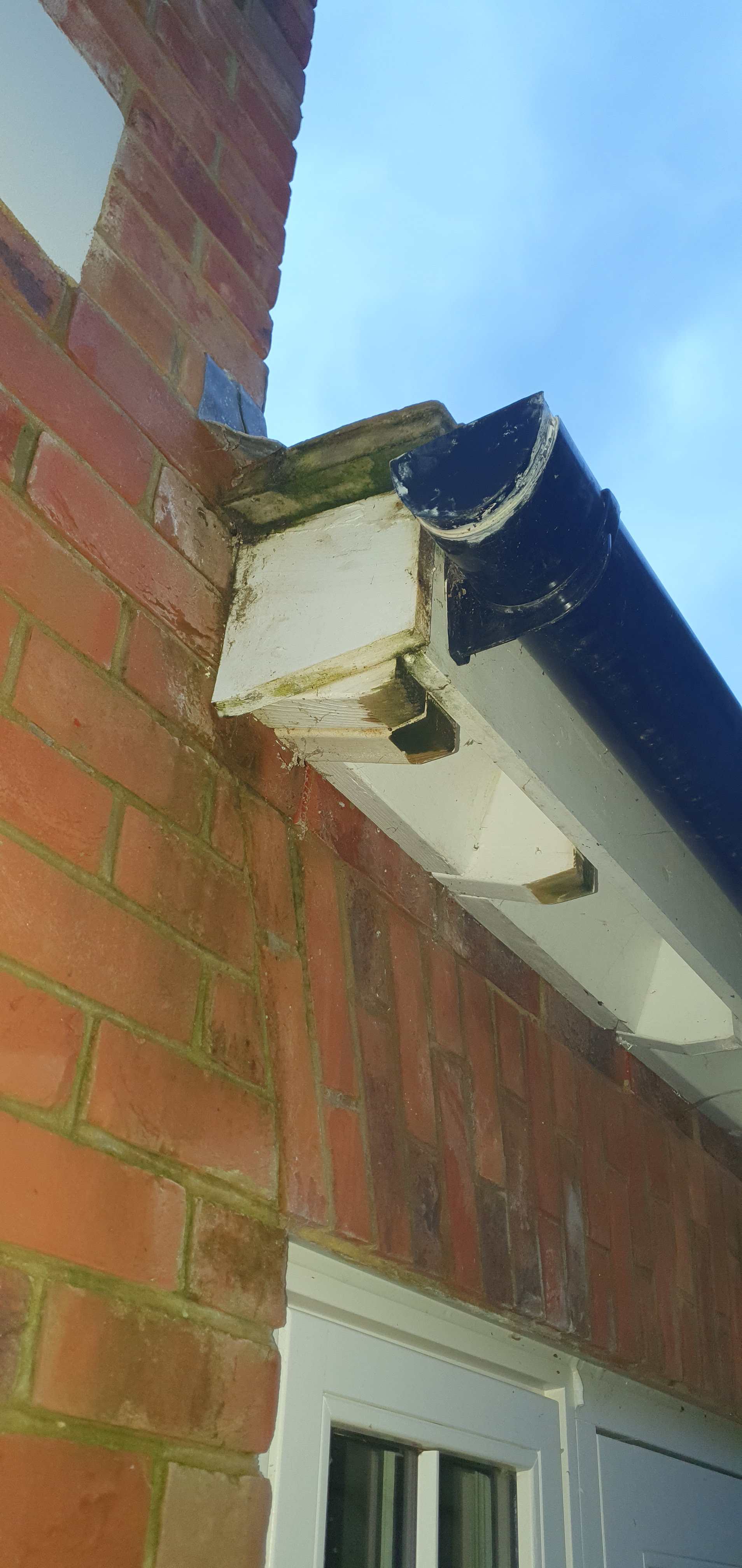

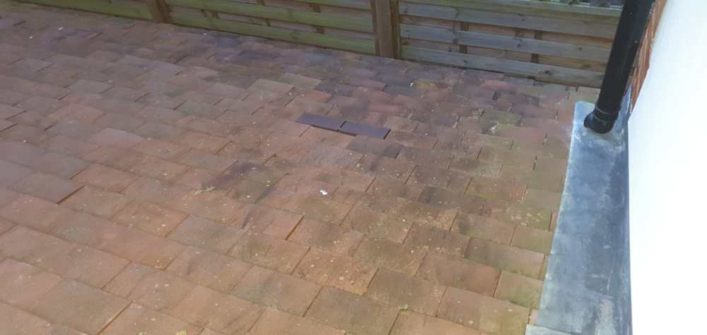

Yeah, I think that's a fair point too. The roof is pretty big above this point with a lot of water coming down off it further up from a higher pitch. I've added a couple of photos - one from the window and one from gutter level - which hopefully give a better idea of the issue. You can probably see from the second photo that the downpipe doesn't actually contribute most of the flow. In fact, most of it comes from, the gable end which drops from a higher pitch to a lower pitch and should be fairly constant across the 6.5m length of the guttering on the left although I agree that due to the confluence off the main roof, there will be more coming down on the far side. You can also see that there's moss growth on this part of the roof which tends to suggest excess damp retention in the tiles & cement board. Finally, you might be able to make out in the first picture that there's a roof-mounted extraction duct blended in there with the tiles. In very heavy rain, we also get rainwater flooding through the extractor fan into the utility below, which makes me feel that the pitch was too low here for this too.
Hmm, if the minimum allowable pitch for the tile is 35 degree and they are pitched at 25 degrees, that's surely a problem, right? It might not be the problem here, but I can't see it helping. As to whether it's the responsibility of the roofer, he was sub-contracted by the project manager. I did not (but should have) seen the terms of this contract, but I would have reasonably expected a roofer with decades of experience to spot straight away if a tile being used is inappropriate for a particular pitch of roof and at least raise questions/concerns - after all it's his reputation at stake - but nothing was ever mentioned. My warranty is with LABC but I agree with you about the likelihood of them paying out. Seems wrong t exclude defective work though when they had an inspector out regularly to check on it.
Thanks @joe90 Yes, you're right, I meant minimum pitch. I agree with your comments about the eave tray being too short and the guttering not extending. It was suggested to right angle it round the edge for good measure. The leadwork here is pretty lousy too - for a professional. I think these are good suggestions and I intend to implement them. However, the issue of water coming round the back of the eaves tray and guttering extends right along the length of the wall which is around 6.5m and there are parts where it was so bad that the painter could not paint it due to the wood being damp. I suspect that this will need more than just an extension on the eaves trays.
Hi All, I'm seriously considering my options, including making a warranty claim for a substandard roof in our 2 year old self-build. Just wanted to hear anyone's views on it. The project was run by a project manager who work closely with a local structural design company. The roof consists of hand made clay tiles and was fitted by a local roofer with decades of experience. All has been fine except for one section where we have had problems of water going behind the guttering and soaking the eaves and exposed rafter feet, which are now showing signs of damp damage. We have of course, had the roofer back on several occasions to look at the issue and he has done some work to remedy the problem, but to no avail. He's also not the easiest or most reliable person, in terms of keeping appointments so this has been over an extended period. Over the last few months, I finally lost my patience and did what I should have done a lot earlier; I did a lot of my own research and asked around the roofing trade online for some opinions. In particular, I got some great help from a local roofing supplier who stated straight away that he felt that the tiles are at too low a pitch on this part of the roof - these tiles should be no less than 35 degrees (in this part of the roof they are laid at around 25 degrees). He stated that the max pitch should be on the plans but I've not spotted them anywhere. He also gave me the name of another local roofer who I intend to ask to visit, give a professional opinion and quote for repair work. I am not expecting this to be cheap. Without mentioning my investigations, I also suggested to the original roofer that the pitch looks too shallow for hand made clay tiles, and that I'd have expected him to spot this. He replied that he didn't think that was the issue but in any case, the calculations were done by the project manager, not him. I should add that I had to let the project manager go since he made numerous costly mistakes, failed to bring the project in anywhere near on time or to budget and was absent for large periods without any explanation. I'm just wondering where all this leaves me. I am unlikely to get anything from either the roofer or the project manager without a costly fight - despite this problem likely being due to their actions/mistakes. That said, if it does prove expensive, I feel I will have to document a case to LABC - the warranty provider - and try to make a claim. Any thoughts or experiences you can share would be very much appreciated, as it's the first time I've considered going down this route.

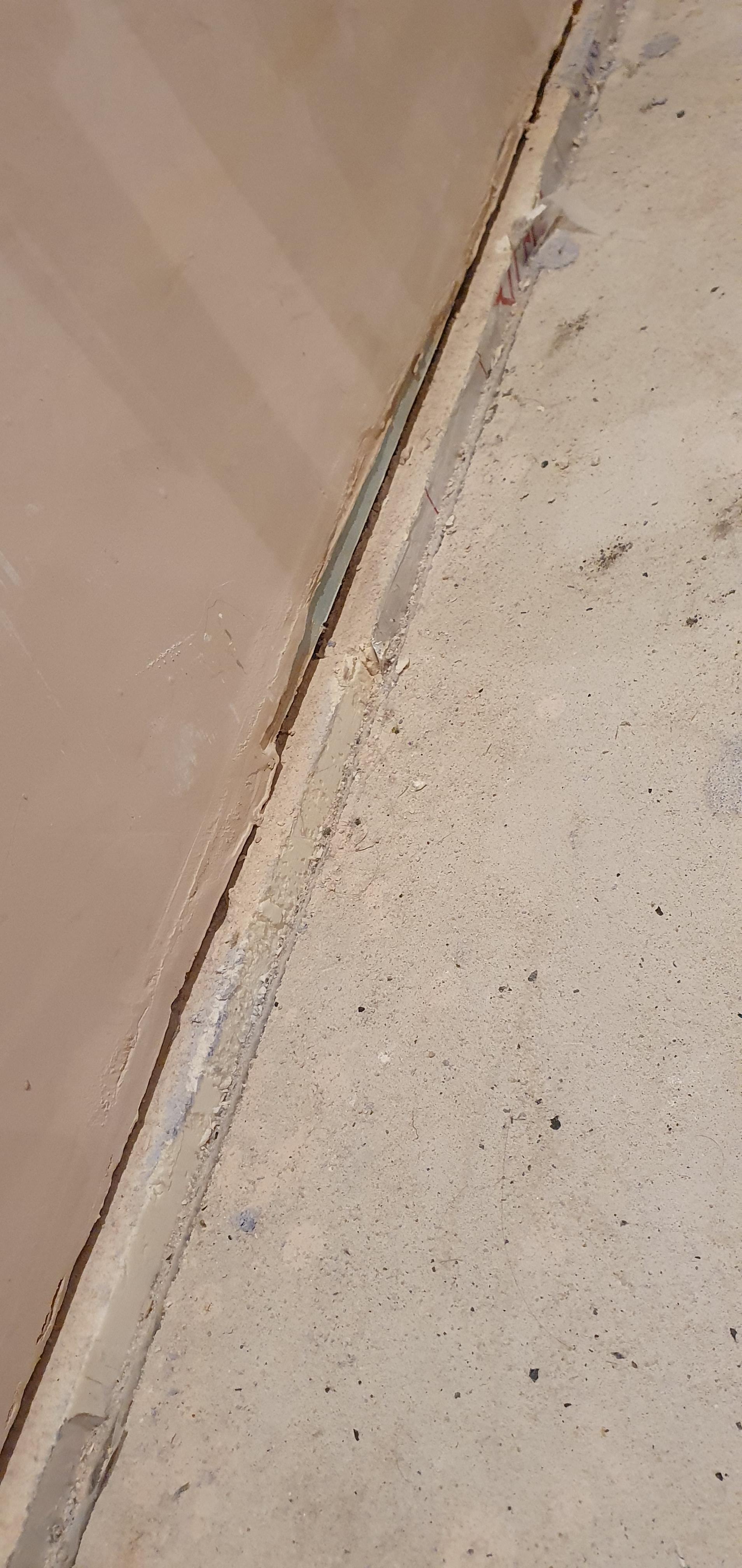

Ah! But you'll always know that it's there!! Alternative suggestion: You could route a vertical dado channel maybe 8mm deep, 6cm from the top to the middle of skirting on each side. Then cut your battening so that the top 6cm is 8mm wider on each side. It then just slots in neatly. This would not only hide most of the profiling gap, but would also strengthen your battening joins to the skirting.

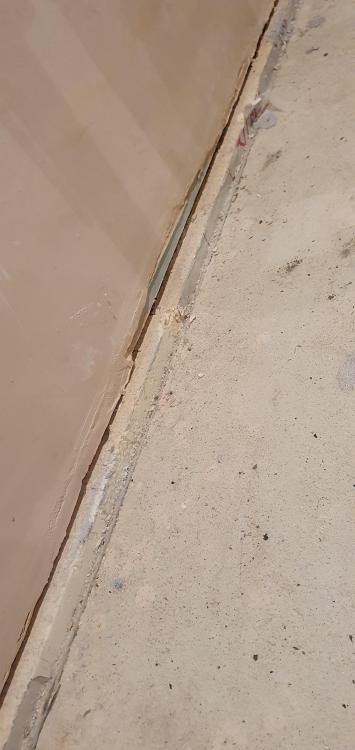

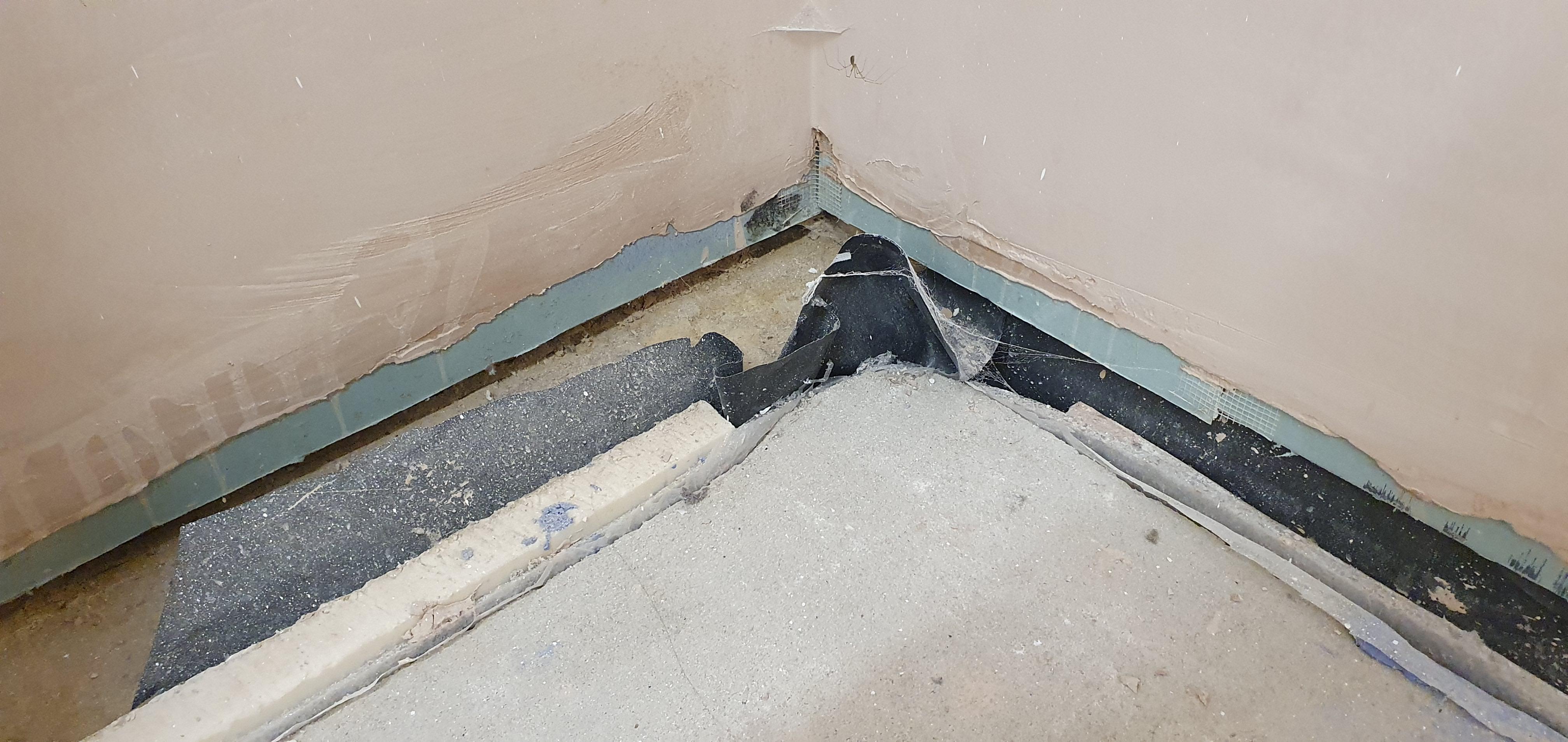

Thanks Conor. That sounds good. Would wood fibre go OK with UFH? Also, the existing screed doesn't quite come up to the wall in many places, but up to foam insulation boarding that surrounds the room. I'm wondering whether I should cut that back since, unless I raise the floor above that level, I'm going to find bringing the laminate up to the wall and fitting a skirting board a bit tricky. -
Hi all, we moved into our self build with the basement still not complete and would like to finish it off. As cash is tight, I'm planning to do the work myself, so ideally would be looking at a solution that is possible for the experienced DIYer. The floors are currently rough screed over UFH and I need to decide how to complete the floor, ideally, before taking the project further. The rooms are: 1. A fitness studio. Ideally this would be a spring wood floor but I don't think this would work well with the UFH. My initial thought would be to pour an initial self leveling latex screed and then finish with either laminate or karndean, if funds and experience allow. 2. A den/cinema room. This is also rough screened with the added complexity that there are two large manholes in the room for the basement sump pumps. So I would have to create an access hatch for these,i guess. Again, I think that a laminate initially would privacy be easiest and cheapest here, but open to suggestions. You might see from the photos that the screed doesn't come up to the wall in many places but to insulation boards, and I'm not sure quite how to deal with these. Should the insulation be cut back level with the existing screed, or should I foam any gaps and bring the screed up to the level of the foam? One particular corner has an elevated concrete block, which is a bit of a pain Ideally I'd have a completely level floor for whatever surface goes on to of it. I'd love to hear any suggestions or experiences with something similar. I'm lacking in experience and confidence and don't really want to make an expensive blunder. Many thanks!!

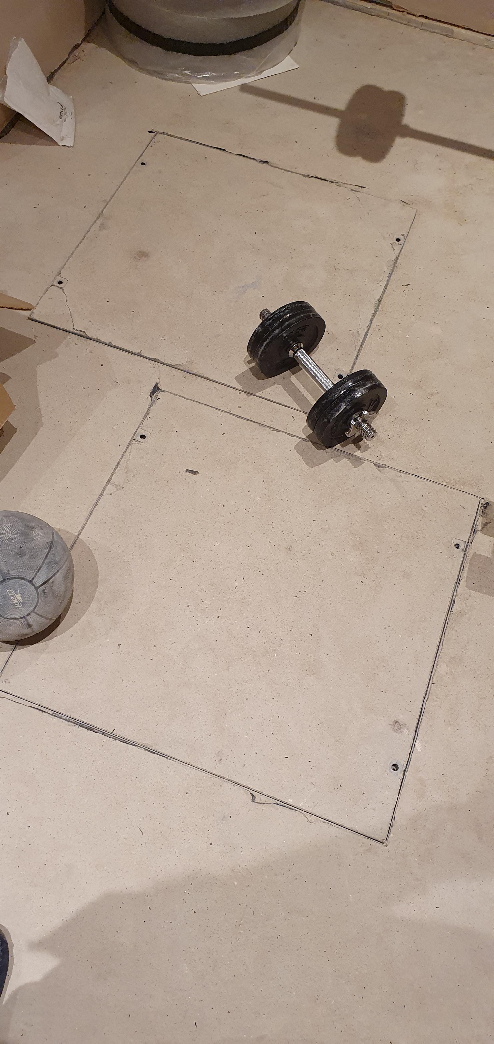

Thanks Tony, I already have a float switch with a monitoring unit and battery backup so fingers crossed, we should not have a flood without prior warning. We also had a power outage of 3 hours last weekend and it coped quite well with that. I had a beef with the pump suppliers who would not warranty their own pumps because they weren't there for commissioning. I offered to pay for them to come out to do a full inspection, but they still wouldn't warranty them. They charge ÂŖ300 + VAT for a service which they say needs done twice a year but that doesn't include cleaning the pumps/sump. They also do various monthly subscription call out packages but the costs are pretty. That might be the average cost for this kind of thing - I'm afraid I don't know - but I'm seriously thinking of just training myself up in it so I can do the work myself. I mean, I'd consider a contract for a 3rd party to do it certainly, but not at those prices. In the meantime, I'd like to be able to do basic servicing on the pumps myself and keep the sumps clean. -
I had a bit of a crisis moment a couple of days ago when the AlertMaxx unit which notifies me when there are pump problems started reporting a power failure on my primary basment pump. To clarify, I have a tanked basement with two sumps, ground and foul, with three pumps, one foul and a primary and secondary for groundwater. similar to this set up. Thankfully, it turned out to be a false alarm as my son and his friends had inadvertently leant against the isolator switches and switched one off! That said, when I lifted the manhole, I was quite alarmed at the state of the sump, which had a lot of limescale and sediment build up. Ongoing maintenance of the pumps and sump is something of a worry to me since the supplier PPS systems, refused to warranty the pumps on the grounds that they hadn't done the installation and commissioning (the pumps had been hastily but properly installed after a temporary pump failed a couple of times leading to floods) and their servicing and maintentence contracts are pretty expensive so, with money tight, I've not signed up so far. I'd like to keep the pumps going as long as I can and do any maintenance that I can reasonably do. Does anyone have any tips or advice on cleaning sediment and limescale from the pumps and chamber? It looks like a fair bit of effort might be required and possibly some chemicals although I'm aware that this is groundwater so I need to stick with something that's kind to the environment and the pumps of course! Any advice, tips, links etc very gratefully received.
