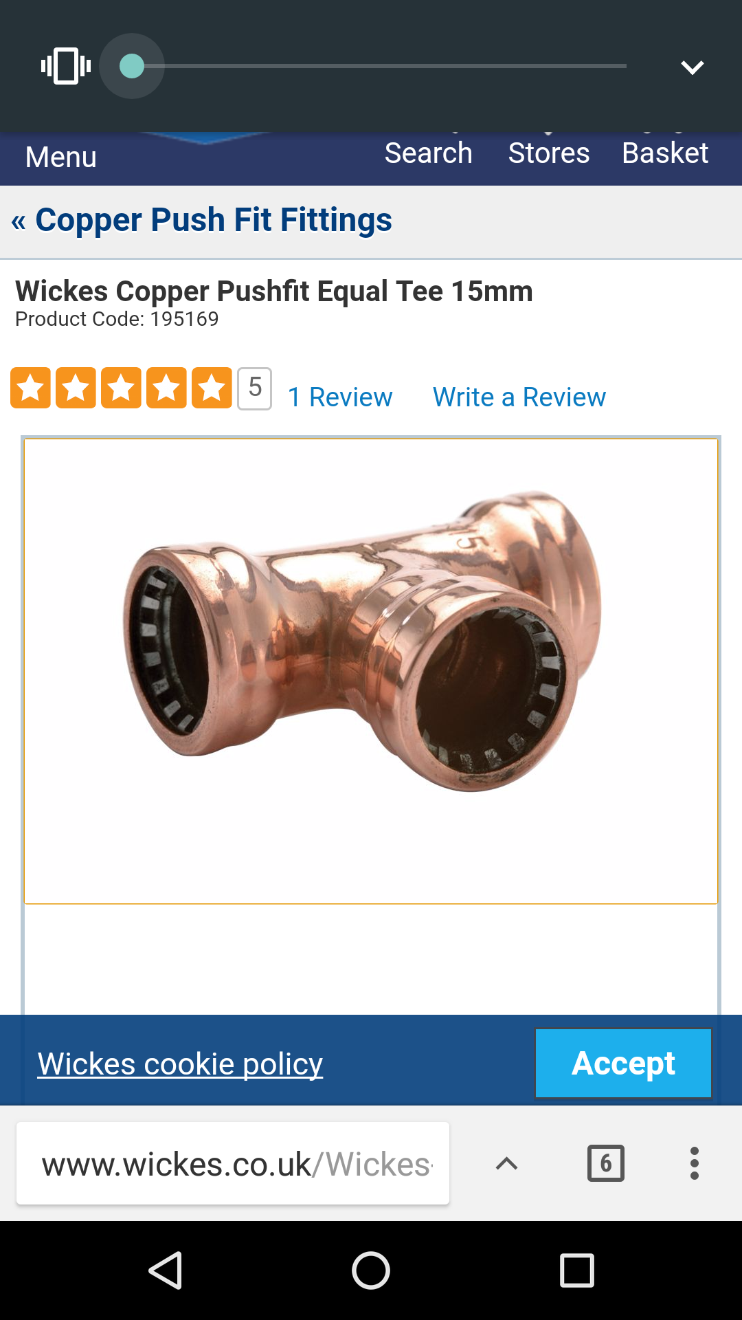

Tennentslager Posted October 17, 2017 Posted October 17, 2017 (edited) Copper looks better if it's on *display* otherwise plastic is faster, easier and the modern stuff is bombproof. Many on here like Hepworth fittings the best. I've also used copper push fit like these, expensive but neat looking Edited October 17, 2017 by Tennentslager Added copper push fit
