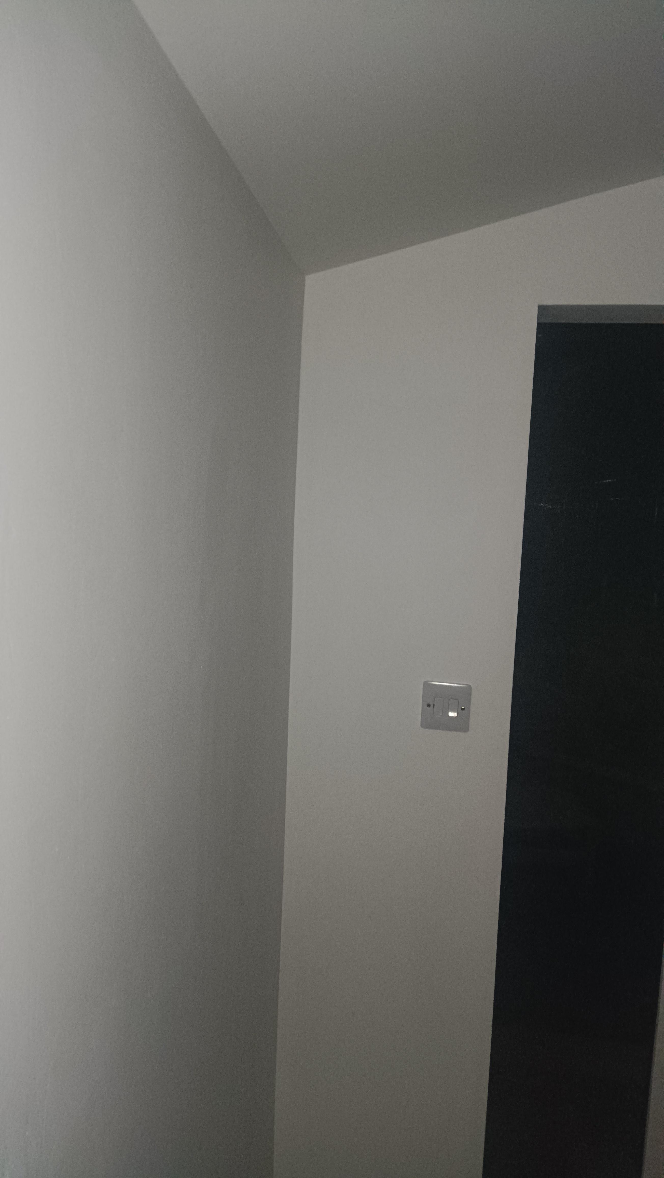

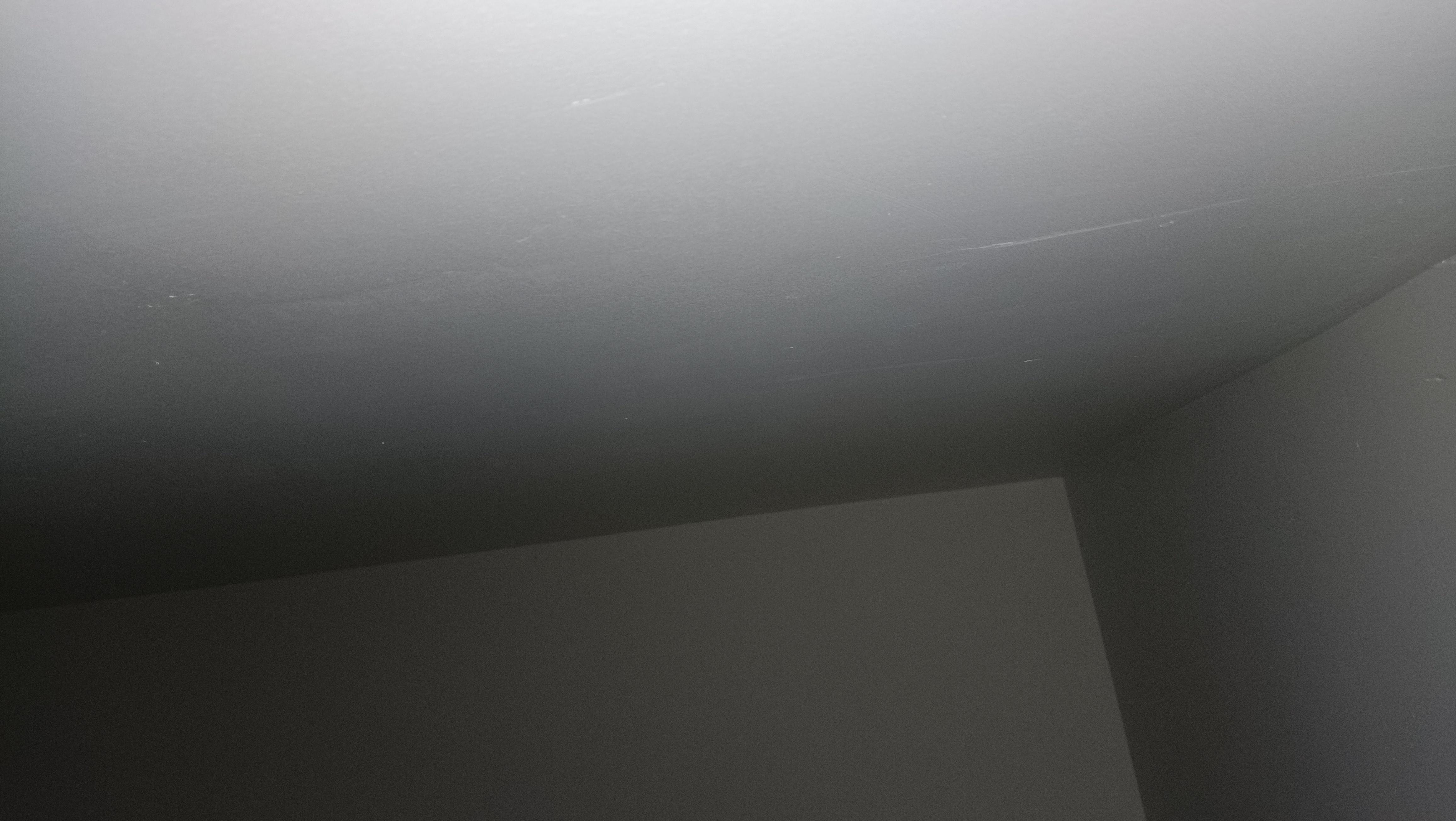

Iceverge Posted May 15, 2024 Share Posted May 15, 2024 Here's some pics taken with my phone torch "along" the wall. You can see the imperfections and occasional gouges. Not @nods pro standard but much better than my tape and jointing. If some prat comes to my office/pumphouse however and does that with their torch, i'll eject them through the second hand pvc door, head over heals into the garden and they'll be followed by pointy end of the skimming trowel looping parabolically towards their nethers. 1 2 Link to comment Share on other sites More sharing options...
Nickfromwales Posted May 15, 2024 Share Posted May 15, 2024 I can say this to you with honesty, openness, conviction, and confidence...... "It doesn't look too shit, to be fair mate" Link to comment Share on other sites More sharing options...
