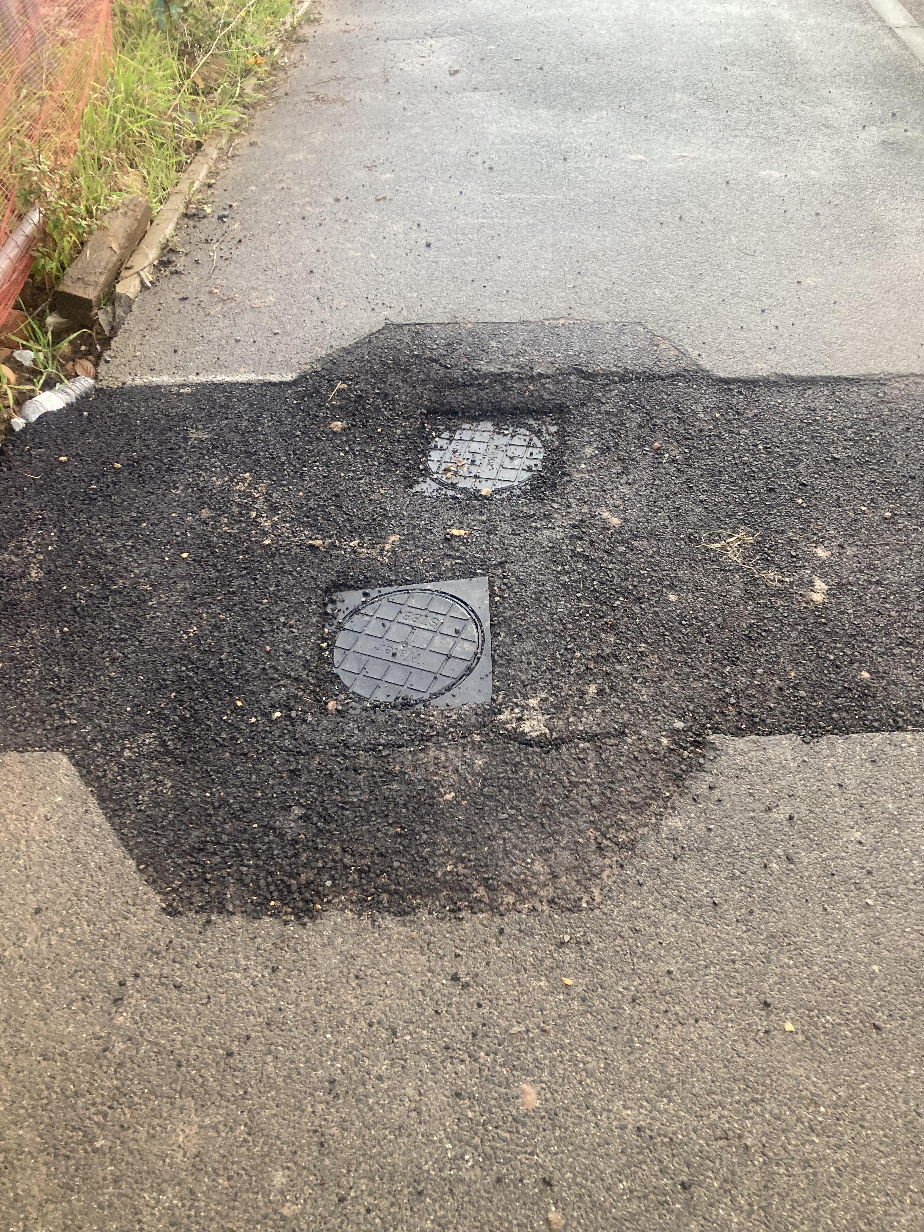

ProDave Posted May 1 Share Posted May 1 Another self builder further down our road had the road crossing for services made by an unregistered builder, i.e did not have any form of street works permit. He made a far far better job than Scottish Water who did mine and did have the right permits. Just proves having a bit of paper proves nothing about actual competence. 1 Link to comment Share on other sites More sharing options...
Canski Posted May 1 Share Posted May 1 1 hour ago, ProDave said: He made a far far better job than Scottish Water who did mine and did have the right permits. Luckily I had severn trent do a masterclass in reinstatement Link to comment Share on other sites More sharing options...

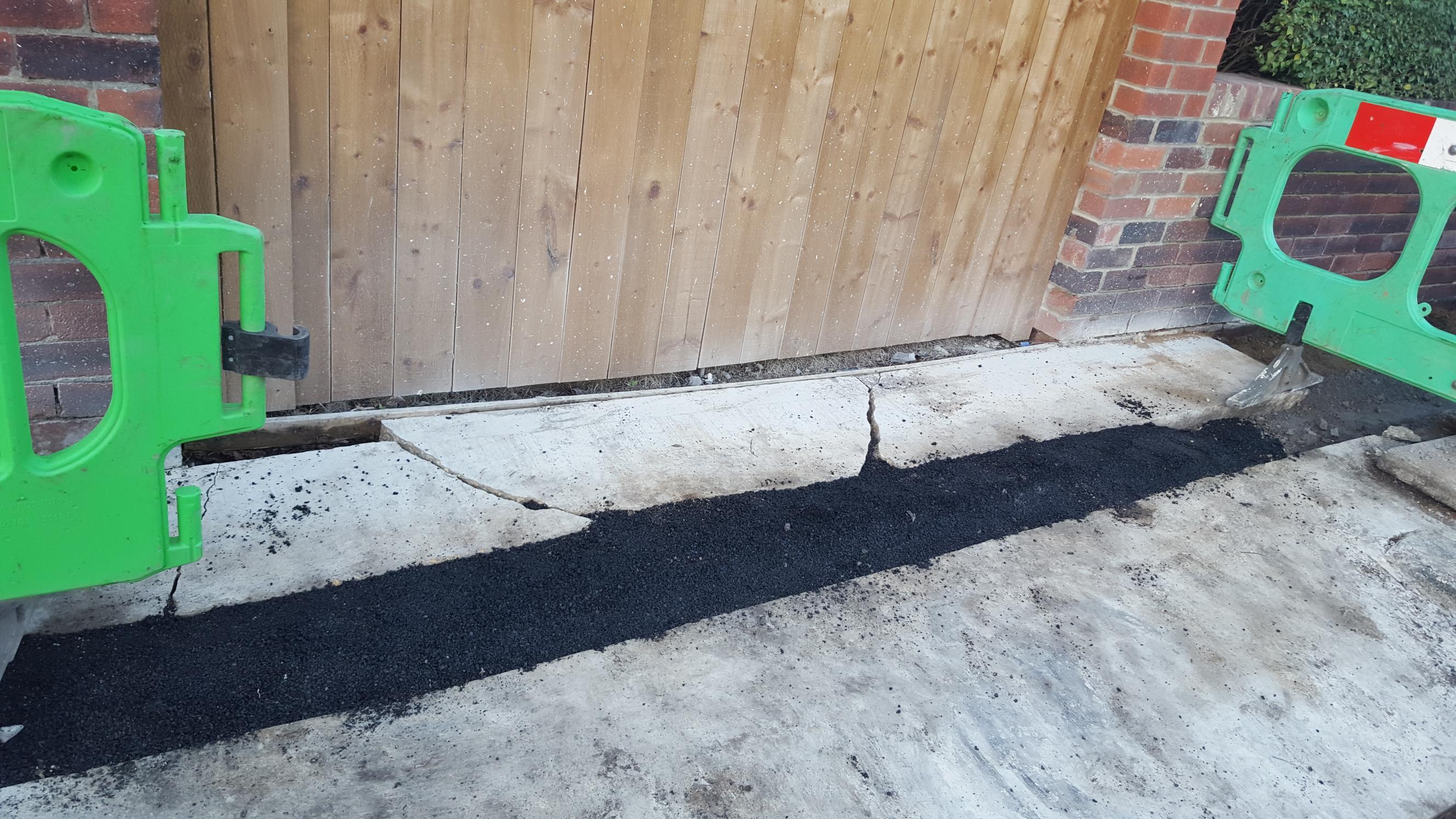

Super_Paulie Posted May 1 Share Posted May 1 brings back great memories of when i had my kerb dropped by the council to the tune of £1200 if i recall. 2 weeks later here come Virgin Media and totally destroyed it while it was still green. When i complained to the foreman, "dont worry we will fix it", came back to this after work. Note the cement dust still on the gate from the initial work, literally days earlier. Link to comment Share on other sites More sharing options...
