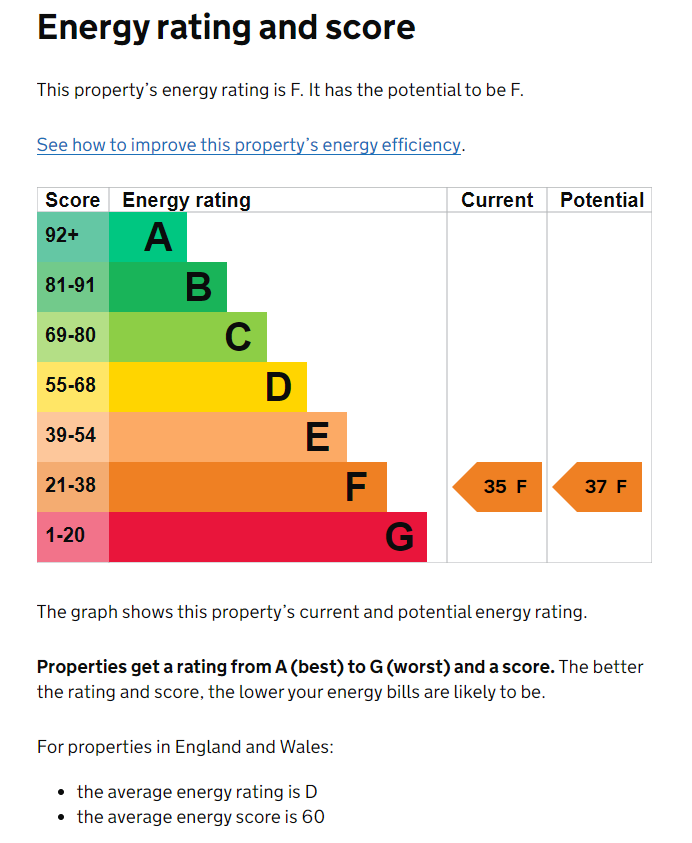

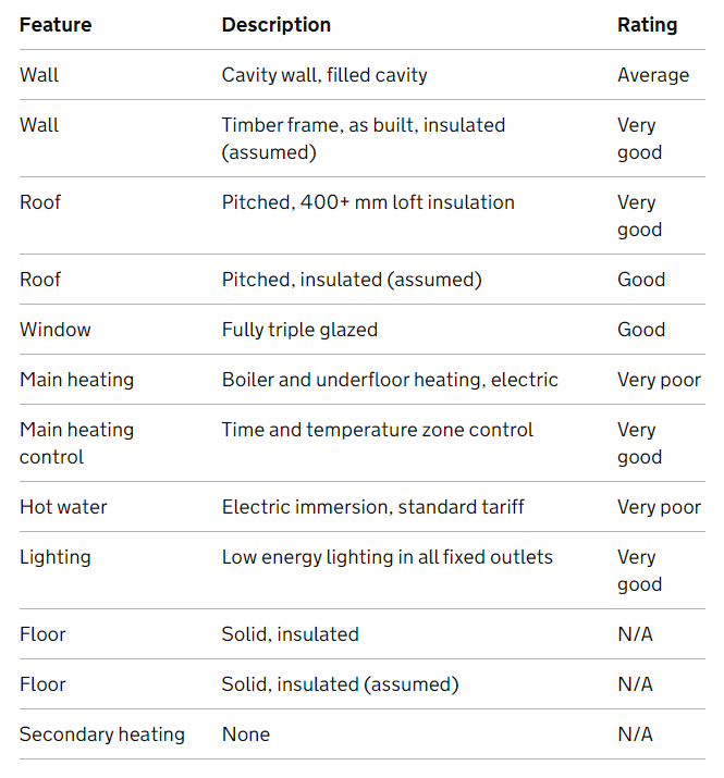

oranjeboom Posted April 26 Share Posted April 26 So had my EPC survey done this week as part of the BUS grant application for the install of an ASHP. My last EPC was a "D" before renovations and extensions with oil boiler and rads. But not this time!! Now after spending ££££s on 3G windows and doors, 400mm of slab insulation, UFH, 400mm loft insulation, MVHR, 2x Sunamp units, low energy lighting, cavity insulation, solar PV, I get an "F" for "failure"! "I've done well over two thousand surveys to date and this result has been the hardest to comprehend." was the assessor's comment. All a bit ludicrous how some of the 'better' newbuilds up the road achieve a "B" when they probably perform much worse on heat loss I suspect. I believe the result all came down to the fact that I have 2 Willis heaters doing the UFH...deemed as inefficient as it was only enterable as an electric boiler. As for the Sunamps, again the software could not compute those. And it also does not cater for 3G doors! I bet if I was totally self-sufficient with PV it would still label the endeavor as a failure due to the fact that it's all electric!! Not looking to sell the house in the near future and assume I could get a new one done after the ASHP is installed...not that the rating bothers me. Well...I'll wait for when the EPC $hit gets replaced with the next improved $hit... Looking on the forum, be interesting to know how you achieved your rating @Russdl !! Link to comment Share on other sites More sharing options...

ADLIan Posted April 26 Share Posted April 26 The SAP energy rating is based on energy cost - being all electric (resistance) for space & water heating looks to be part of the issue as it is the most expensive fuel option. Even lots of insulation, triple glazing etc, etc may not be enough to change the numbers significantly. Beware that MVHR if poorly designed and/or installed may use more energy than it saves! Did the surveyor use default values for the MVHR? I note the house is timber frame - the low thermal mass parameter may also be a factor. The efficiency of a new ASHP for space & water heating should help to improve the rating considerably. Link to comment Share on other sites More sharing options...

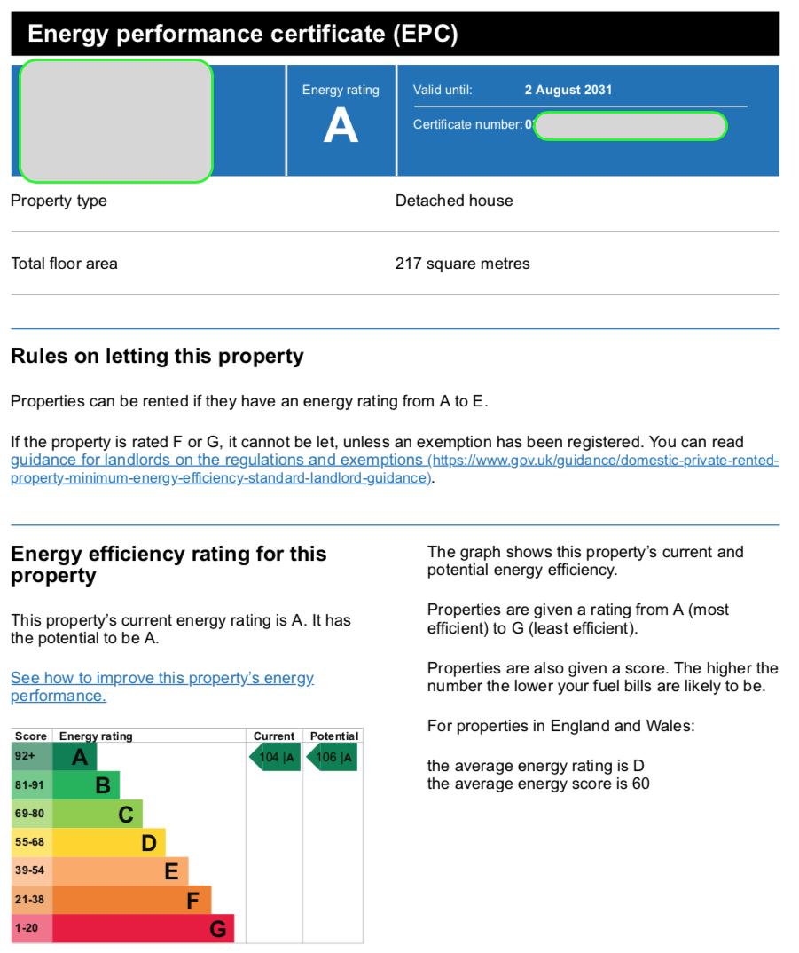

Russdl Posted April 26 Share Posted April 26 2 hours ago, oranjeboom said: Looking on the forum, be interesting to know how you achieved your rating @Russdl !! Actually, that was a typo, we got an A104 not A103. I was surprised considering the Willis heater Sunamp combo and despite not holding these ratings in particularly high regard I couldn’t resist a brief moment of smug self satisfaction. 3 minutes ago, ProDave said: I wonder where us self builders that got an A with a full SAP taking all the actual details into account will fair if in > 10 years time we need to renew the EPC for instance to sell the house. I bet that will be an RDSAP and come out much worse? Indeed. 1 Link to comment Share on other sites More sharing options...

oranjeboom Posted April 26 Author Share Posted April 26 1 hour ago, ADLIan said: Did the surveyor use default values for the MVHR? I note the house is timber frame - the low thermal mass parameter may also be a factor. The efficiency of a new ASHP for space & water heating should help to improve the rating considerably. The extensions are SIPs 175mm walls, 200mm roof iirc. Again, no SIPs option so he went for timber. The older part of the bungalow is cavity filled. MVHR...no idea what default values he went for. 7 minutes ago, joe90 said: That’s mad, fully triple glazed is only good? Should be very good, etc etc. when I had my last EPC on a rental property I could not be there but some “assumed” things were very wrong , I found the assessor and challenged his rating which he changed on my insistence, so you can challenge the rating. Yes, he was friendly enough and took his time to look at all the options. But yeah, no idea why the 3G is just 'good'. Proper German windows too! May contact him to see why!! "Computer says...." 1 Link to comment Share on other sites More sharing options...
JohnMo Posted April 26 Share Posted April 26 (edited) 21 minutes ago, ProDave said: wonder where us self builders that got an A with a full SAP taking all the actual details into account will fair if in > 10 years time we need to renew the EPC for instance to sell the house Could just cut and paste the old one, or more shite in shite out normal EPC. 2 hours ago, oranjeboom said: And it also does not cater for 3G doors They can manually input U values if you have the info to give them. But looks like you ask to see what assumptions they made and reject that one as F...... rubbish. Edited April 26 by JohnMo Link to comment Share on other sites More sharing options...

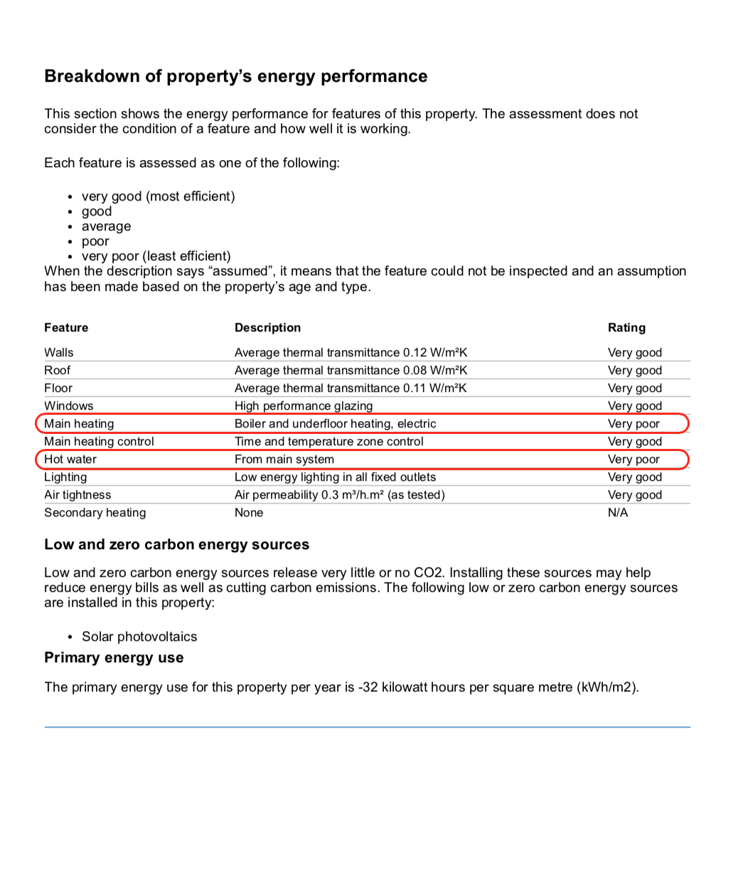

Russdl Posted April 26 Share Posted April 26 Here’s my ‘Breakdown of property’s energy performance’ so @oranjeboom can compare. Clearly the Willis heater/Sunamp combo did us no favours but we obviously did ok on their score sheet all the same. Link to comment Share on other sites More sharing options...
