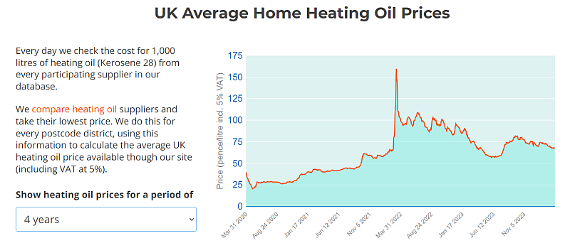

Gone West Posted March 29, 2024 Share Posted March 29, 2024 ASHPs aren't shit, but with current oil prices, oil burners are cheaper to run. 1 Link to comment Share on other sites More sharing options...

Originaltwist Posted March 29, 2024 Share Posted March 29, 2024 (edited) Mmmm Yes oil is looking quite good at the mo. I've just updated the comparison chart for the next cap etc. Edited March 29, 2024 by Originaltwist wrong chart posted 2 Link to comment Share on other sites More sharing options...

Temp Posted March 30, 2024 Share Posted March 30, 2024 On 29/03/2024 at 13:04, Originaltwist said: Mmmm Yes oil is looking quite good at the mo. I've just updated the comparison chart for the next cap etc. What would Electric (eg Fan heaters) with a a battery to time shift look like? Link to comment Share on other sites More sharing options...
