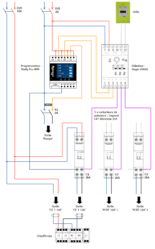

Mike Posted January 27 Share Posted January 27 2 hours ago, TerryE said: In my case I have 3 × 3kW resistive heaters and a UFH pump that I want to control safely and legally, and at a sensible cost I have a similar problem - switching 2 Willis heaters + pump + DHW (probably a SunAmp due to lack of space) - and I need to get it signed off in France by the independent electrical installation inspectorate (Consuel). It won't be up and running for a few months, but I have solution that should work, in theory. I'll be using a DIN-rail mounted Shelly Pro 4 PM in the consumer unit, providing 4 independently switched channels, one for each of the items above. Since the Shelly has limited load-switching capacity, it will switch 3 regular Legrand CX3 412558 silent contactors* in the consumer unit, with only the pump being directly controlled. In fact, as I'm limited to a 52A mains supply, there will be a Hager 60060 load-shedder between the Shelly and the contactors, monitoring the smart-meter and temporarily switching out the contactors when necessary. Provisional schema below. The Shelly can be operated in several ways (demo on YouTube), including manual buttons and via an app or web browser over Wifi, Blutooth or Ethernet. That includes the option of creating a weekly schedule so, with the addition of a thermostat, it would be possible to run everything in a similar way to a regular central heating controller, though I don't plan to do that. The Shelly also comes with an MQTT interface (documentation), so it can also be controlled using Node-Red / Home Assistant. Like you, I plan to run that on a Pi + SSD, with a PiJuice micro-USP with auto-reboot capability. From the software side this should give plenty of flexibility while, from the hardware angle, everything looks like it belongs in a regular consumer unit, so hopefully no sign-off problems. And, if the Pi fails (and while I wrestle the software into shape), the heating & water can still be operated via the Shelly. *25A resistive / 10A inductive, 230V power & control circuits. There's also a model with 24V AC control. Link to comment Share on other sites More sharing options...
TerryE Posted January 27 Author Share Posted January 27 (edited) @Mike, FR building codes are another ballgame. You might want to consider running Mosquitto, MySQL and Node-RED as minimal stack on this RPi. These will all run comfortably on a 2 Gb RPi3. You won't need USB3 class performance for the SSD either. It might be worth running a separate Broker on the separate HA system and ping this with a copy of every relay close / open command. That way you can have an independent watchdog on a separate system to open the relays if the CH+DW RPi dies with the Willis Relays closed. The last thing that you want is for the UFH to run away, though worst case I suppose the Manifold TMV will isolate the Willises from the UFH loops and the Willis thermostats will cut in, but even so a critical RPi failure could leave you with the slab on. Bad news. Far better to have an unattended failsafe reset. Edited January 27 by TerryE 1 Link to comment Share on other sites More sharing options...

joth Posted January 27 Share Posted January 27 For the immersion, I was lucky to pickup a Carlo Gavazzi RJ1P23I50E Semiconductor Contactor 50 A For about £28 on eBay. It has 0-10V input which is perfect for controlling from Loxone, no extra hardware needed. If I didn't have an analogue output spare I'd probably look at a DMX to 0-10V driver, very good prices available on AliExpress. For 24V switching I have a 48channel DMX led driver decoder which has spare channels. These are ideal for driving coupling relays or SSRs. Home assistant to DMX should be pretty simple and means downstream hardware is fairly cheap and standards based so easy to move to Loxone or kmx or any other system in future if desired. Link to comment Share on other sites More sharing options...
