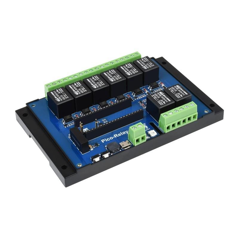

I have a couple of these I intend to use to control 24v  which will then use WAGO 24V relays to control the bigger loads. https://thepihut.com/products/industrial-8-channel-relay-module-for-raspberry-pi-pico?variant=40605655367875&currency=GBP&utm_medium=product_sync&utm_source=google&utm_content=sag_organic&utm_campaign=sag_organic&gad_source=1&gclid=Cj0KCQiA2eKtBhDcARIsAEGTG40_R-cXtRgFbkA_bCKbAX7r1NvSWOReNEeHk8qOv5Sf7LZeswKMf6gaAiS6EALw_wcB
As it takes a PICO directly,  which you can of course bridge out on the Gpio pins, you have a smart relay board to boot.
Thanks Mike and Jack.
For @dpmiller, I note that the board that Mike references uses HLS8L-DC5V-S-C relays which are rated to 10A at up to 30 VDC.
Perhaps the main difference between the Pico and ESP32-based boards is that
  • on the ESP-based boards you have a range of options such as Tasmota, ESPEasy (as well full Arduino Runtime and JS, Python and Lua runtimes for higher level scripting)
  • on the Pico for are pretty much constrained to doing your own custom MicroPython firmware development.
So for the Pico you have to do firmware development whereas on the ESP you can avoid the need for custom firmware development entirely by using  standard OS firmware such as Tasmota which offers and MQTT interface to these type of I/O boards, (as well as having a wider choice of languages/frameworks  if you want to go down the custom route).
I am comfortable with using custom firmware (I helped develop the Lua runtime for the ESPs, after all) but doing to means that I need to think about long term support options whereas both my son and son-in-law already use Tasmota devices in their own Home Assistant implementations.
Here is one example of an equivalent ESP-based 4 channel board that I am considering, and you are spoilt for choice in this space.
