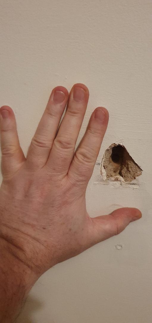

SilverShadow Posted January 15 Share Posted January 15 (edited) Hey all, Back once again to pick to pick your builders brains and gather sage suggestions Over time the factory provided screws & rawplugs have worn loose, to the point i had to remove the radiator for fear of it falling! The screws provided were 60mm long and solid enough for the job. But the old brickwork/plasterwork is incredibly crumbly and left me with huge holes (see pic below) - i could literally pull them out the wall in the end. the radiator is 46kg weight (i'd assume empty), and has 4 mountings with 2 screws in each - that leave the holes in the pic for each mounting So my conundrum is what to do next. I already have some 10mm wide/60ml long sturdy rawplug replacements, but i can see the 1st 20mm into the hole is just dust & wont hold up Would you guys consider any of the following: Buy 80mm (or longer) screws & drill deeper Fill the 1st 20mm with standard masonry filler (add some sort of rock hard adhesive perhaps?). Any brands/suggestions? Use rawplug resin filler & add the original screws/rawplug replacements into the wall, then cake up around it the 20mm layer with resin when it situ? Use rawplug filler pads that line the hole & bond to that? Make fresh holes 10cm along? Something else? Apologies if it's been asked a dozen times before - i couldn't find it on the forum Many thanks for your time Shadow Edited January 15 by SilverShadow Link to comment Share on other sites More sharing options...

markocosic Posted January 15 Share Posted January 15 Impatient? Drill new holes in the bracket. Buy 80 mm screws and brown wall plugs. Drill deep holes in the wall. Push two brown wall plugs deep into each hole using a screw. Use say three screws per bracket. (two at the top and one at the bottom) That should get you into the brick not the plaster. If you're an animal you hols the bracket in position then drill the bracket and wall at the same time with a 6.5 mm SDS then bash the wall plug through the bracket and into the wall without removing the bracket. (the 6.5 mm SDS bit in crumbly brick should give you a tight fitting "just about possible to bash it in using a screw as a drift" wall plug. Some experimentation might be needed depending on brand. Up the screws to 100 mm if you've got solid walls and thick plaster rather than cavity walls. You can't fix into plaster. That's what's probably happened. Maybe yoy hit a mortar line. Either way just whack a hole through the bracket where the wall wants it to be rather than where the bracket wants it to be and you're good. Fill the old hole with some non structural whatever. Or resin in some threaded rod with a nut on the end. Leave the nut loose; hang the radiator relying on the screws; then nip behind with a spanner to finish tighten later because it's cold just now. 1 Link to comment Share on other sites More sharing options...

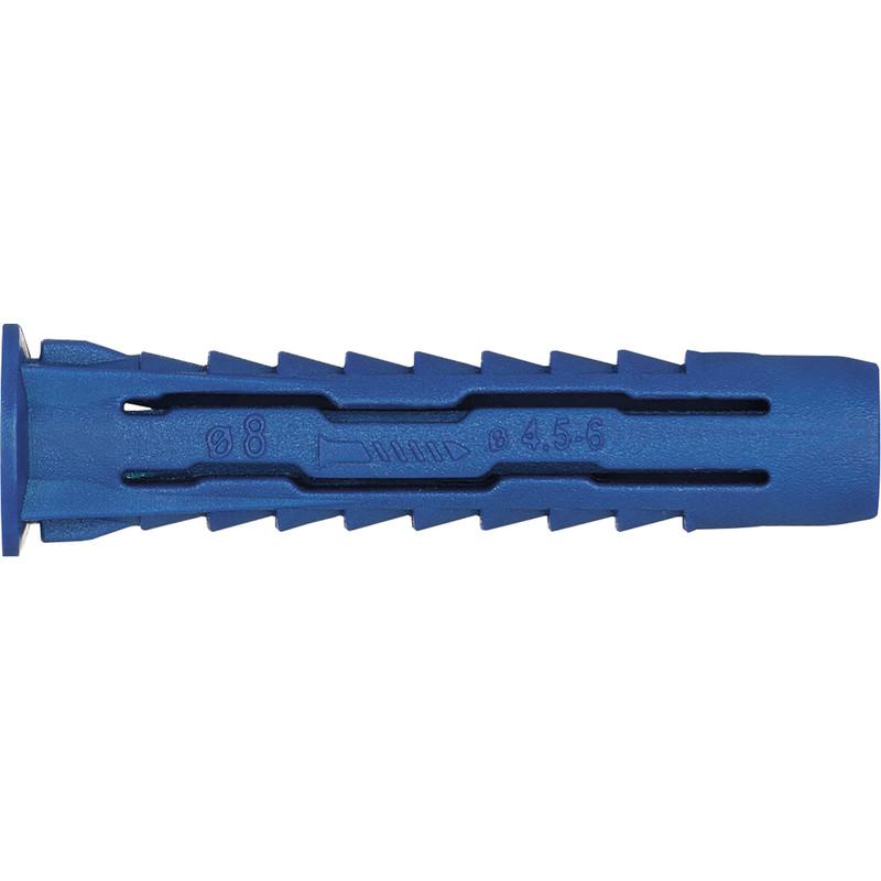

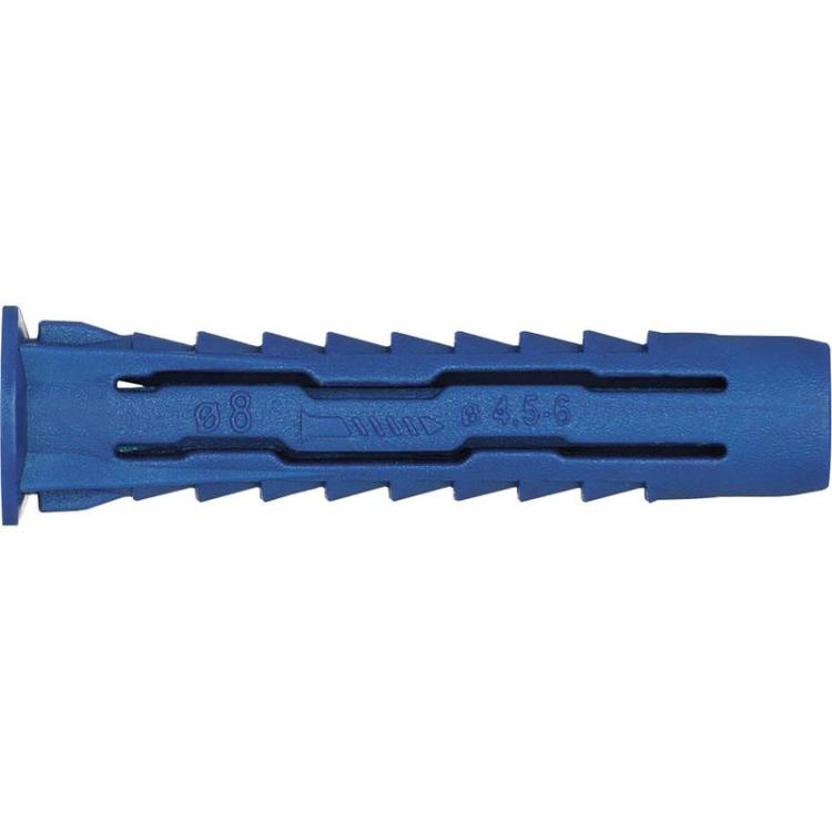

SilverShadow Posted January 16 Author Share Posted January 16 (edited) Thanks again guys 😁 I'll look at getting some 80 or 100mm screws & drill the existing holes deeper. The wall is indeed solid brick with 20mm plaster I have these 50mm × 10mm Rawlplugs, & was wondering if they will do the job nicely if pushed down to brick level? Combined with using resin it should hopefully be enough. Or should I try those mesh rawlplugs down to 80 or 100mm as required? Thanks for all your expertise 👍 Shadow Edited January 16 by SilverShadow Link to comment Share on other sites More sharing options...

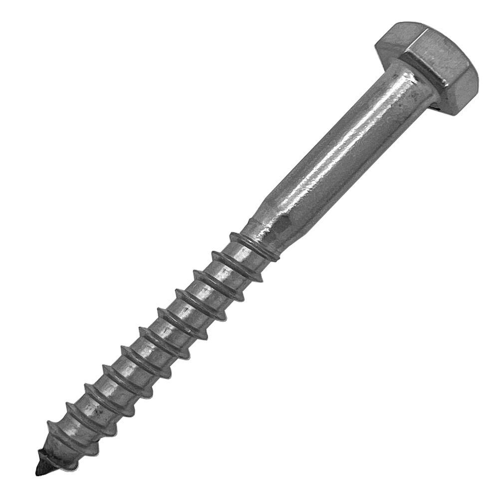

SilverShadow Posted January 16 Author Share Posted January 16 (edited) 1 hour ago, FuerteStu said: If you have a small bendy straw, bit of electrical earth sleeving, or other thin tube they clean out the hole better than just a brush. I've even used a balloon pump to clear a hole of debris before. Resin fixes better than anything I know.. But it's a one time fix. Make sure your brackets are level, or the radiator won't be! Thanks Stu - that was my original concern. I had wondered whether Coach screws would be a feasible alternative to studs 🤔 Apologies for so many daft questions - I'm just exploring whether its possible to use coach screws, to be able to insert/remove later once the resin had set around the rawplug Edited January 16 by SilverShadow Link to comment Share on other sites More sharing options...
