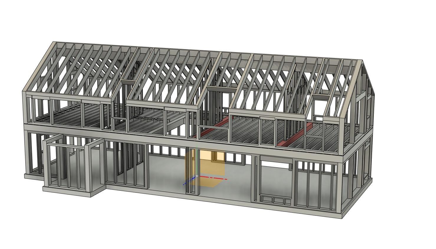

gavztheouch Posted December 25, 2023 Share Posted December 25, 2023 Hi I’m in the process of designing my timber frame. I thought I’d start a thread to pick some brains as I go along. The frame will be c24 225mm by 45mm timber with a breathable racking board on the outside plus 60mm wood fibre. I have engineering and architect drawings and designs. My next job will be to create my own drawings to use myself or pass on to a joiner to complete the actual work. I’m using a cad program called fusion 360 and I plan to 3D print the design to give me motivation and a nice visual model to refer to. I used to build prototype machines in the workshop without drawings, now that I’m older and wiser (hopefully) I find that concept laughable. I need a clear plan to refer to. I’m going to make mistake building this house. I have some time before the spring, building the frame in cad will hopefully help me make at least some of them in the computer before I take it to site. Below is a practice part of the wall. Printed at 3.5% of the original. 1 Link to comment Share on other sites More sharing options...
JohnMo Posted December 26, 2023 Share Posted December 26, 2023 Have looked at Larson strut for the walls? Your 225mm studs will create a thermal bridge at each strut. Which you are mitigating with external insulation. The Larson strut, uses 2 smaller studs joined together with ply or OSB. So you would have say two 4x2s, or a 3x2 and a 4x2 with a gap between, the gap maintained by several pieces of the OSB nailed to each stud. One stud is structural The other to form a depth for insulation. The thermal bridge becomes the cross section of the OSB instead of the stud. You can make a good depth of wall for insulation and could save the time and effort of external insulation as well. 2 Link to comment Share on other sites More sharing options...

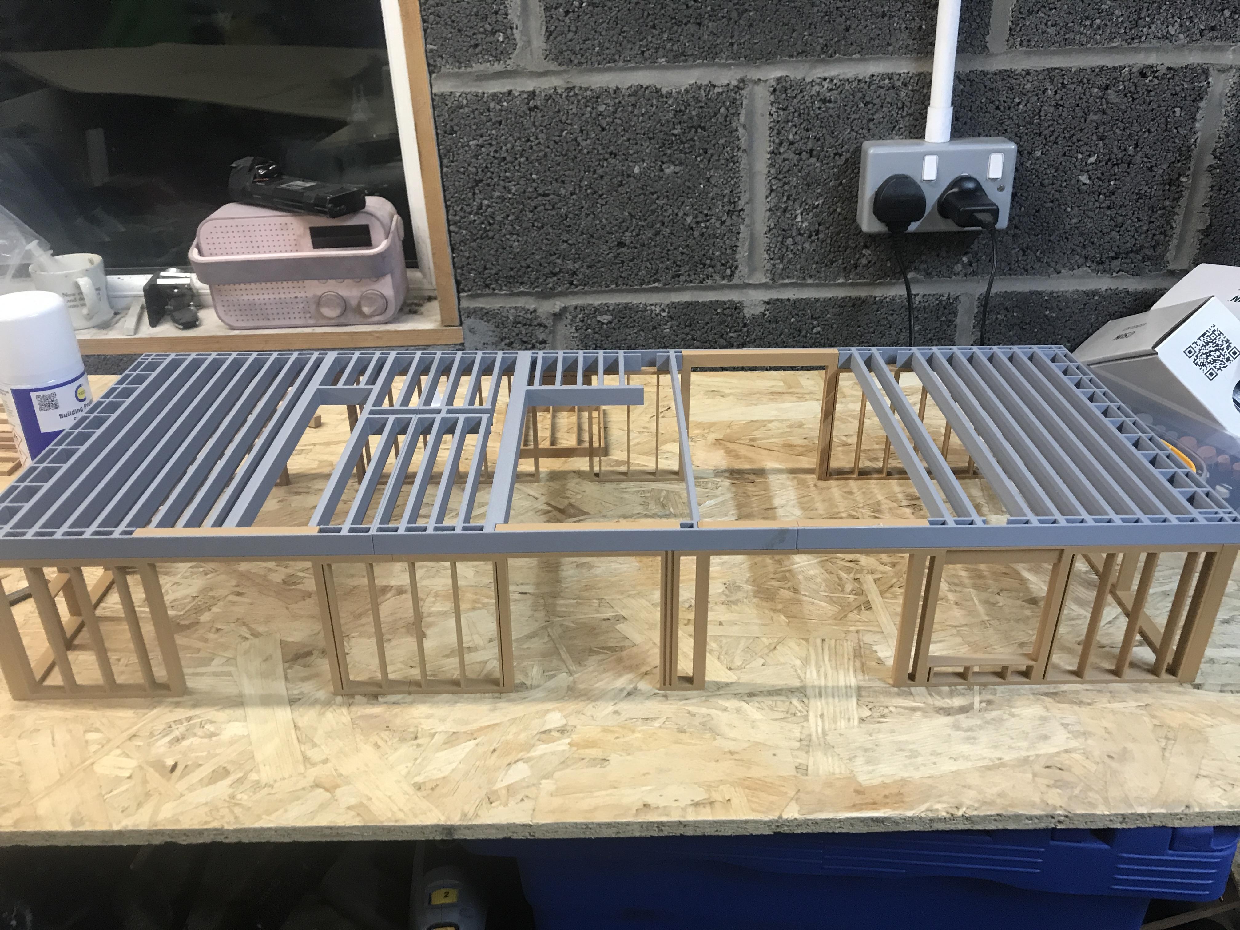

gavztheouch Posted January 13 Author Share Posted January 13 Progress so far, I have taken out the repeating studs at 600mm centres for clarity to focus on the important bits Link to comment Share on other sites More sharing options...
Gus Potter Posted January 13 Share Posted January 13 (edited) 57 minutes ago, gavztheouch said: Progress so far, I have taken out the repeating studs at 600mm centres for clarity to focus on the important bits Well done you for giving this a go.. If you want I can give you a few pointers on what you need to do to get the preliminary sizes for you timber frame (TF) and the grades of timber you may need. To do that I would need to know.. A: The floor plan dimensions, location of the internal load bearing walls roof pitch and need to know about any funny loads you are introducing.. pool tables ect.. B: The ground, first and second floor levels. C :The sizes of the openings.. windows and doors. D : Your post code so I can assess the wind and snow loading. I'm minded to give this a go with my SE hat on as.. 1/ You have made a good effort. 2/ It may help other folk on BH understand what goes into the preliminary sizing of a timber frame. Edited January 13 by Gus Potter 3 1 Link to comment Share on other sites More sharing options...
gavztheouch Posted January 13 Author Share Posted January 13 51 minutes ago, Gus Potter said: Well done you for giving this a go.. If you want I can give you a few pointers on what you need to do to get the preliminary sizes for you timber frame (TF) and the grades of timber you may need. To do that I would need to know.. A: The floor plan dimensions, location of the internal load bearing walls roof pitch and need to know about any funny loads you are introducing.. pool tables ect.. B: The ground, first and second floor levels. C :The sizes of the openings.. windows and doors. D : Your post code so I can assess the wind and snow loading. I'm minded to give this a go with my SE hat on as.. 1/ You have made a good effort. 2/ It may help other folk on BH understand what goes into the preliminary sizing of a timber frame. Gus that is extremely generous of you. Thankfully I have already had the frame engineered by a SE. This exercise is mainly to work out the construction details and find mistakes in the drawings. I’ve found a few so far. I would very much appreciate your eye as the project progresses. Link to comment Share on other sites More sharing options...

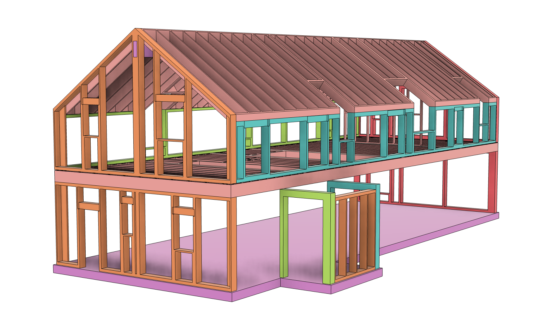

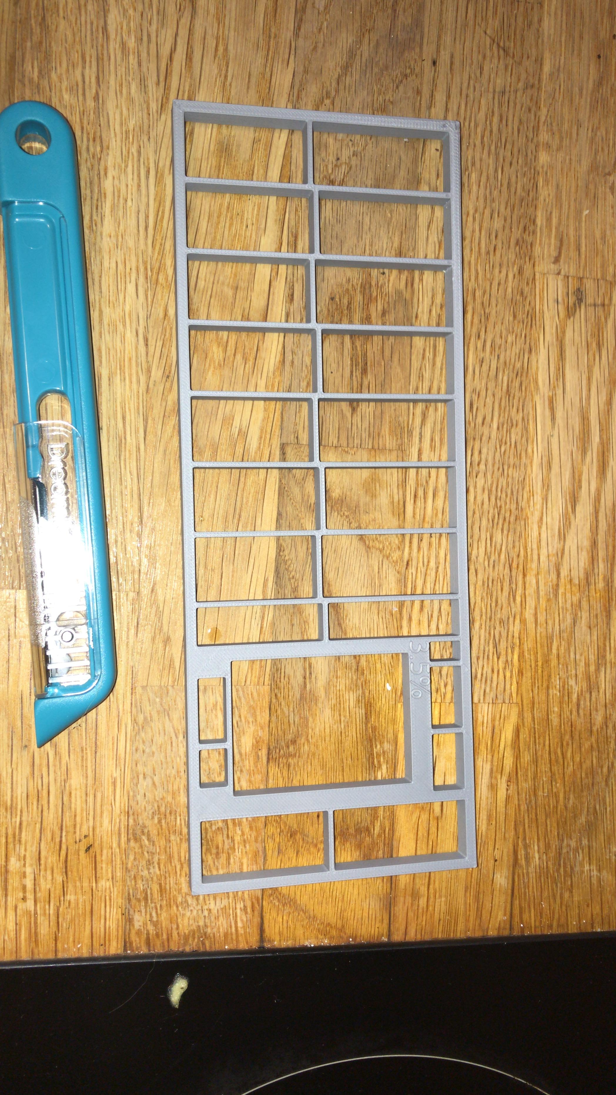

gavztheouch Posted January 21 Author Share Posted January 21 Cad work is done for now. Meeting with the architect next week to try and finalise most of the window sizes and some other details. Almost finished printing the parts for the model and made a start tonight glueing it together. I’m using PLA plastic for the prints and super glue to stick it together. 2 Link to comment Share on other sites More sharing options...

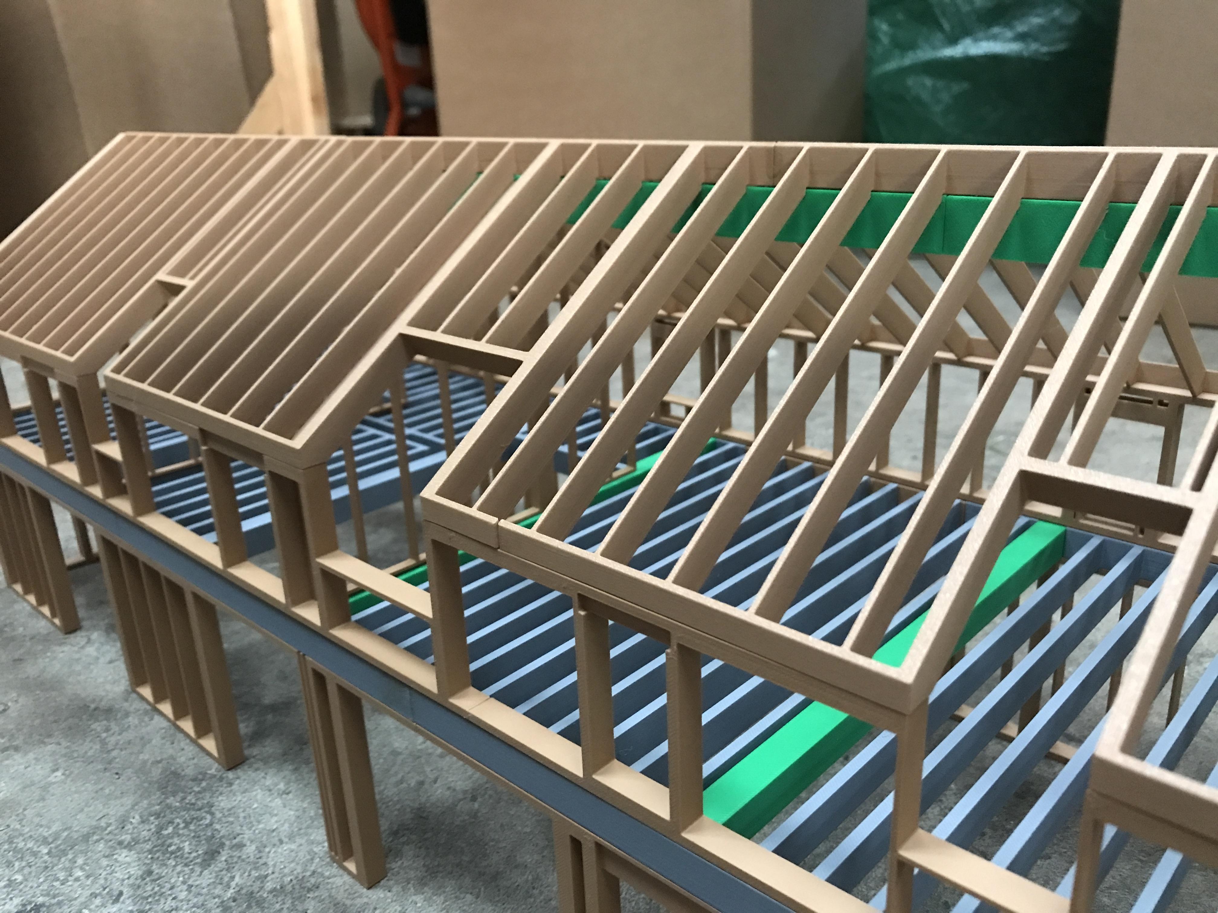

gavztheouch Posted January 24 Author Share Posted January 24 (edited) Model finished ready for review with architect to sort out window sizes and positions. I haven’t added the dormer windows yet. Going to call an end to the modelling for now and focus on the foundations. Edited January 24 by gavztheouch 1 Link to comment Share on other sites More sharing options...
