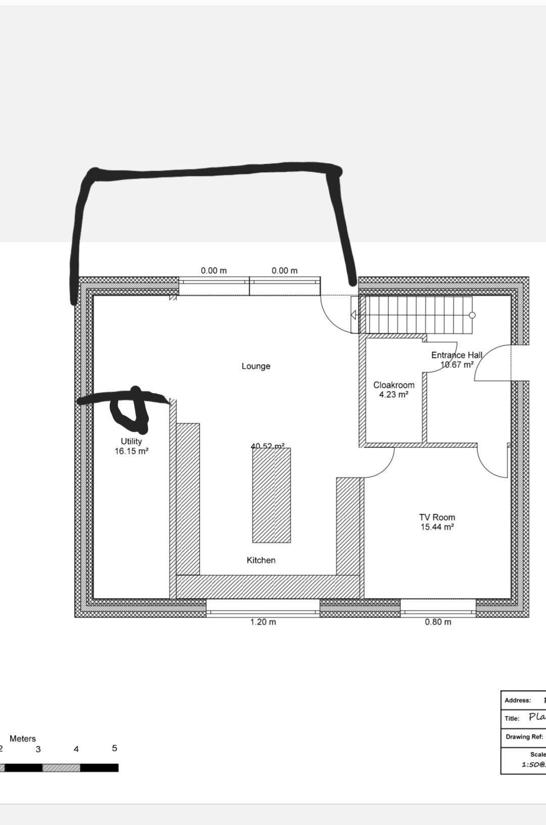

FuerteStu Posted December 7, 2023 Posted December 7, 2023 From the site layout, I think you are missing a trick on enjoying your outside view. Perhaps a conservatory on the back, and shorten the utility (sorry for the rough drawn pic)

Adsibob Posted December 7, 2023 Posted December 7, 2023 8 hours ago, FuerteStu said: From the site layout, I think you are missing a trick on enjoying your outside view. Perhaps a conservatory on the back, and shorten the utility (sorry for the rough drawn pic) I agree. This is so much better.

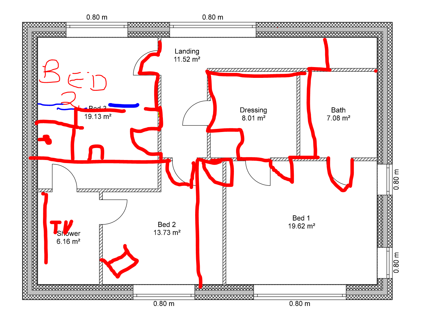

Blooda Posted December 8, 2023 Posted December 8, 2023 Lots to think about, and for you to take in. But, here's my 2 Penneth for upstairs - although I ran out of windows. TV room upstairs in Bed 3. Jack and Jill Shower Room with Bed 2 to Landing - Pocket door to Bedroom. I tried to play with Bed 1 to achieve..... Entry to bedroom direct without going though Dressing, accessing dressing room through bedroom , becomes less of a corridor. I ran out of windows, but wanted to make the dressing room easily convertible to a 4th bed room should you wish to sell in the future [not actually convert but mention in the selling blurb]. Make the TV Room Down stairs the Office / Snug . If you have the TV room upstairs show it as a bedroom for the planners. Best way, forward maybe blank floor layouts with overall dimensions and window doors and a full list of thing that need achieving, such as 1) Bedroom 1 with dressing room and Bathroom 2) TV room At least x metres by x metres 3) office space x metres by x metres 4) Somewhere to store Hoover [other brands are available :)] 5) Somewhere to store Bed Linin [we ended up with an airing cupboard on the landing with a small radiator and extract to MVHR [probably affect the efficiency of the house but it Kept SHMBO happy] 6) Space for Granny's Grandfather Clock. etc etc And see what the very much more informed [and better artists] on here come up with.
FuerteStu Posted December 8, 2023 Posted December 8, 2023 Dressing room couldn't be classed as a bedroom without a window? You'd need to swap with bathroom and add a window
