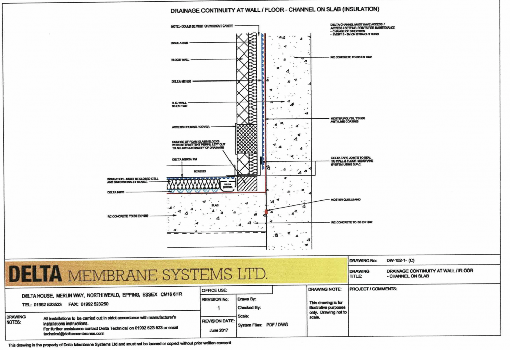

We had the waterproof system designed by a structural waterproofing specialist who was recommended by the ICF company. There are 3 types of waterproofing A, B and C. We need to have 2 types as I understand. Waterproofing outside the basement type A with membrane which also goes under the raft, geotex protection board and drain with backfill of washed gravel ( SE has been asked to guide us on what he wants in backfill) type B waterproof Concrete does not really work for ICF as you cannot see the end result without cutting away the ICF, our only option was Type C internal drain with membrane. This meets building reg standards in Scotland. The type C will hopefully never be used but it’s a fallback if anything does wrong. I know you could a number of years ago use 2 type As but that is not the case anymore. @saveasteading we are on a slope the back of the house is basement level and we have created a return on one side with a retaining wall. So a 2 sided basement not a cassette ie 4 sided basement. The internal drain is connected to outside drainage that then goes to pond and soakaway down my sloped garden. That’s the current plan. @Thorfun yes we have considered not having UFH in basement at all but as the main open wall in basement is north facing and we live in Scotland, thought better to put in during construction rather than regret it later even if we do not have it on all the time. @Conor I would agree but I’m being told that I’m required to provide 2 elements of the Type A B and C waterproofing system by building control.
@Nickfromwales SE knows about it but has not said anything although I understand the mesh reinforcement will need to be bent but that did not come from him. He has had the proposed design for over a month and made no comment, shares office with architect who has drawn it up for warrant. We have asked about the bending of mesh and how he proposes this is to be done, still waiting. Maybe you’re right and I need to go for screed disappointed SE didn’t think to say anything before changing drawings, one step forward 2 steps back. Thank you for your comments, I really appreciate them. I will chase SE tomorrow, yet again the shared experience and wisdom on this site has trumped my well paid experts.
@Nickfromwales our insulated raft is 250mm
@NickfromwalesHead height but also I have 250mm of slab that can accommodate UFH, so screed on top seemed a wasted expense but I’m happy to be corrected. It would be easier as you can see from @Thorfun drawing
Hi @Nickfromwales econekt, they are based not far from us and will be an assisted build
This is our design WYK-SD 039 Stepoc Water and Gas Proofing with Preformed Channel.pdf
@Thorfun we are building a basement open on 2 sides, construction ICF, intended to have UFH in slab only waterproof design has advised us to do in screed, we pushed back and they have given us a design that includes water guard drainage channel which we need to precast in the slab. I think you had the same issue but you went with a screed, is that correct? I saw one of the waterproof drawings and looks like they designed the same channel into the screed. Obviously easier than in the 250mm slab although currently this is what we are looking at doing and trying to get my head around how to actually do it, any pointers! for reference
