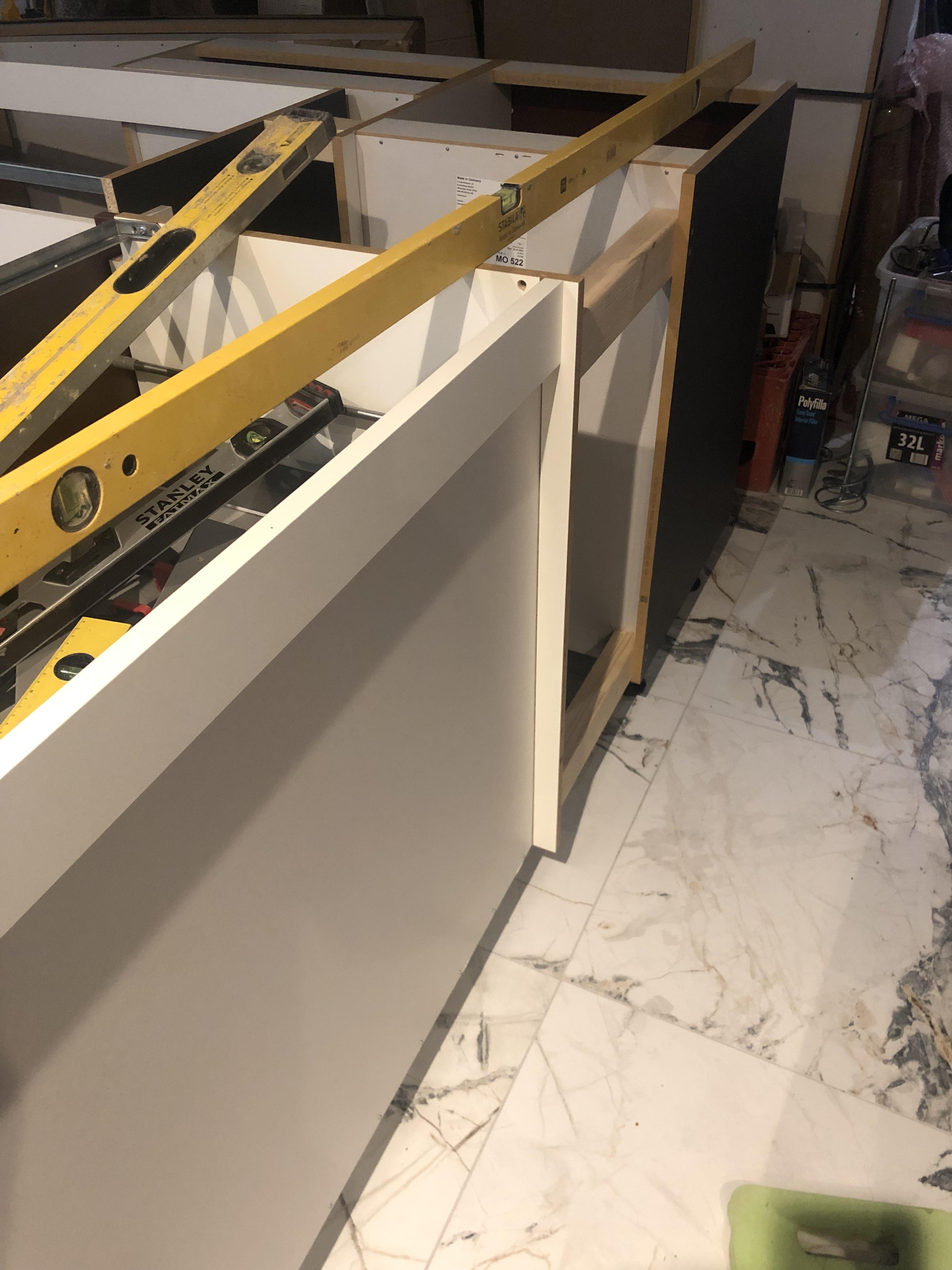

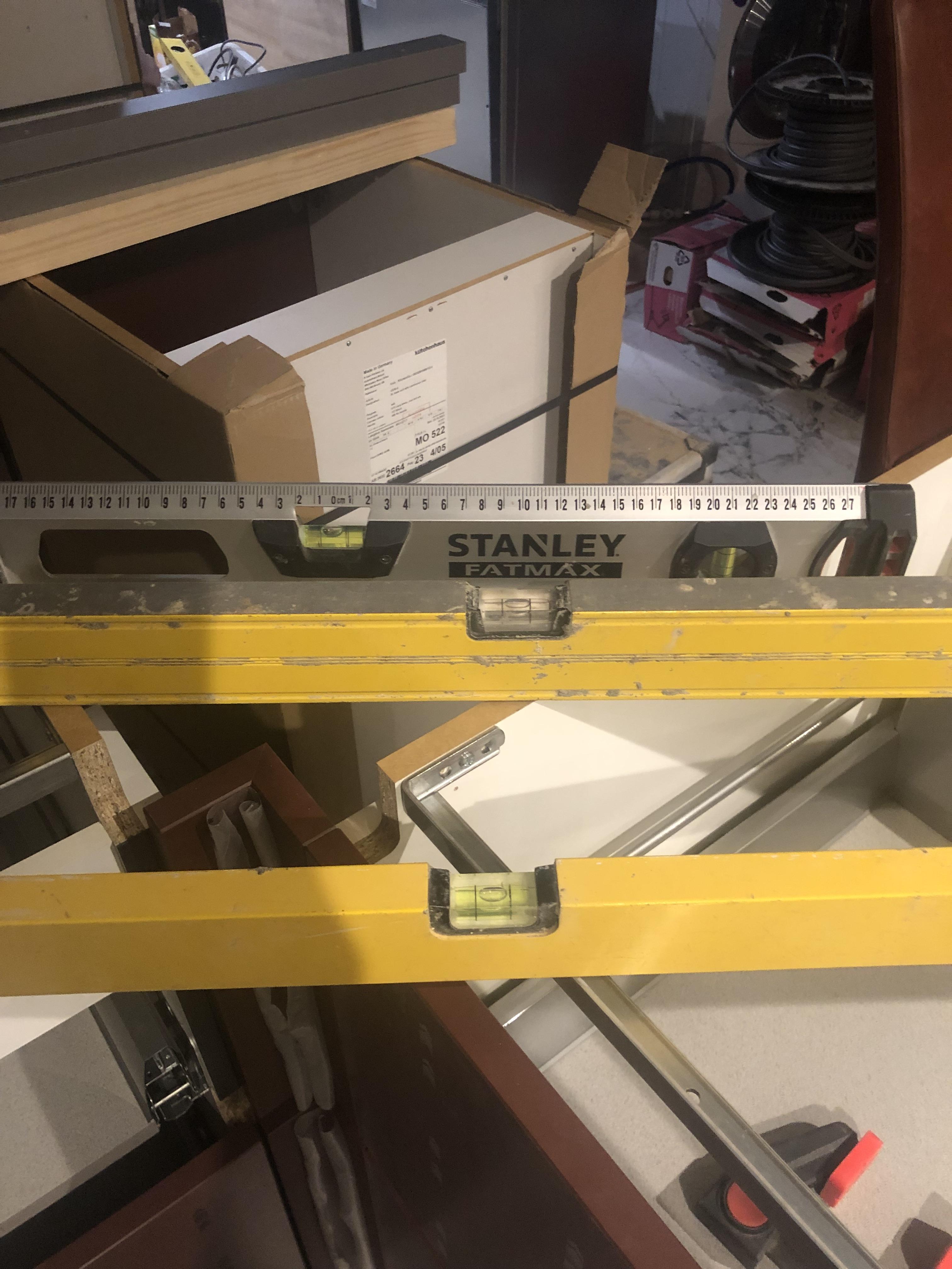

Pocster Posted November 17, 2023 Share Posted November 17, 2023 (edited) Decided I need a professional in to install this . Everything is spot on so far , and rock solid . Edited November 17, 2023 by Pocster 2 Link to comment Share on other sites More sharing options...

Thorfun Posted November 17, 2023 Share Posted November 17, 2023 looks pissed to me Link to comment Share on other sites More sharing options...
Pocster Posted November 17, 2023 Author Share Posted November 17, 2023 29 minutes ago, Thorfun said: looks pissed to me You need more 🍷 to make it look straight 1 Link to comment Share on other sites More sharing options...

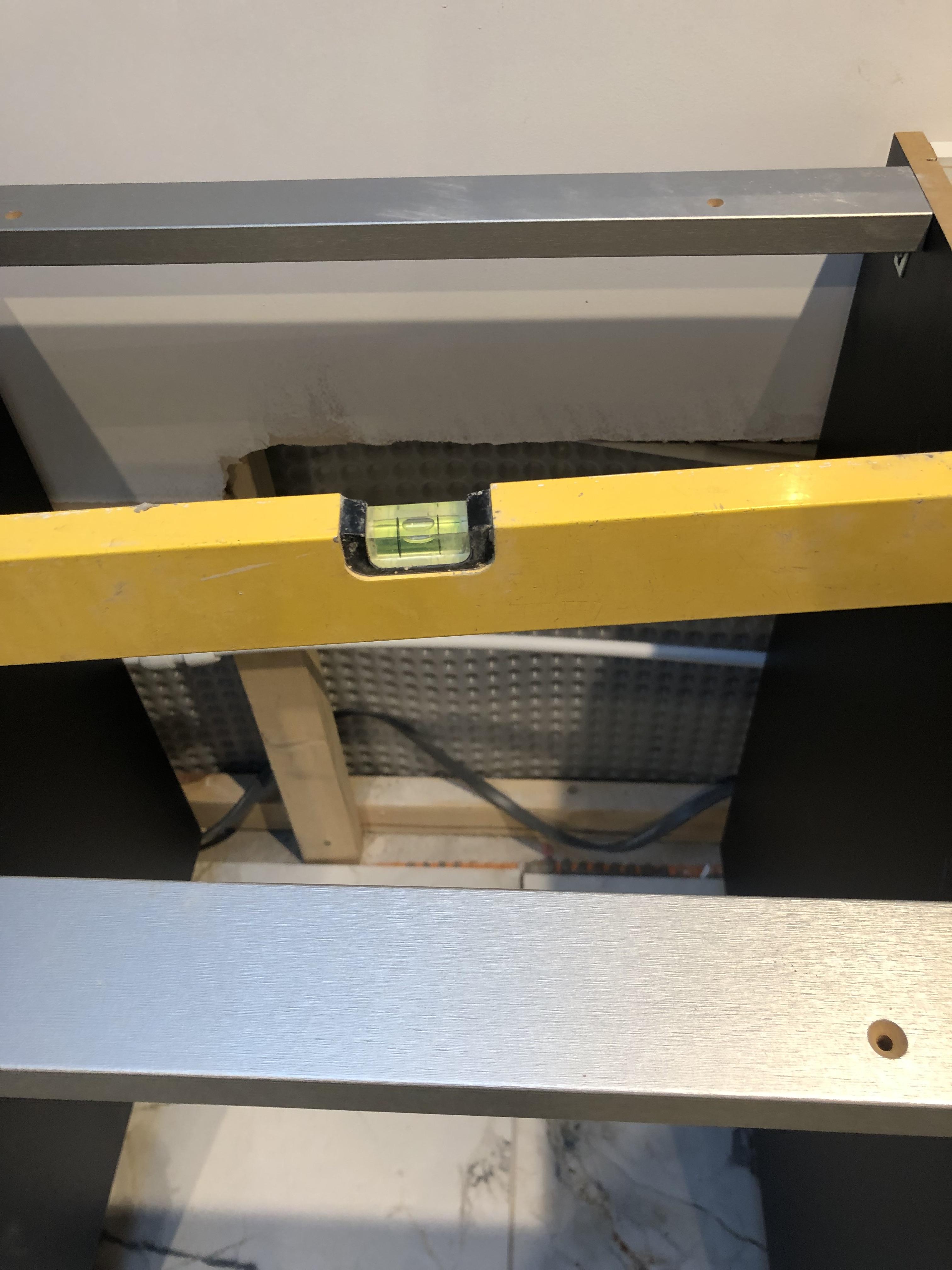

Temp Posted November 17, 2023 Share Posted November 17, 2023 Remember to turn your level 180 and check again in case the kids have used it a baseball bat. 1 1 Link to comment Share on other sites More sharing options...

Pocster Posted November 17, 2023 Author Share Posted November 17, 2023 20 minutes ago, Temp said: Remember to turn your level 180 and check again in case the kids have used it a baseball bat. Ahead of you . I’ve got 4 levels - yes ; I check everything with all 4 now 😊 Link to comment Share on other sites More sharing options...

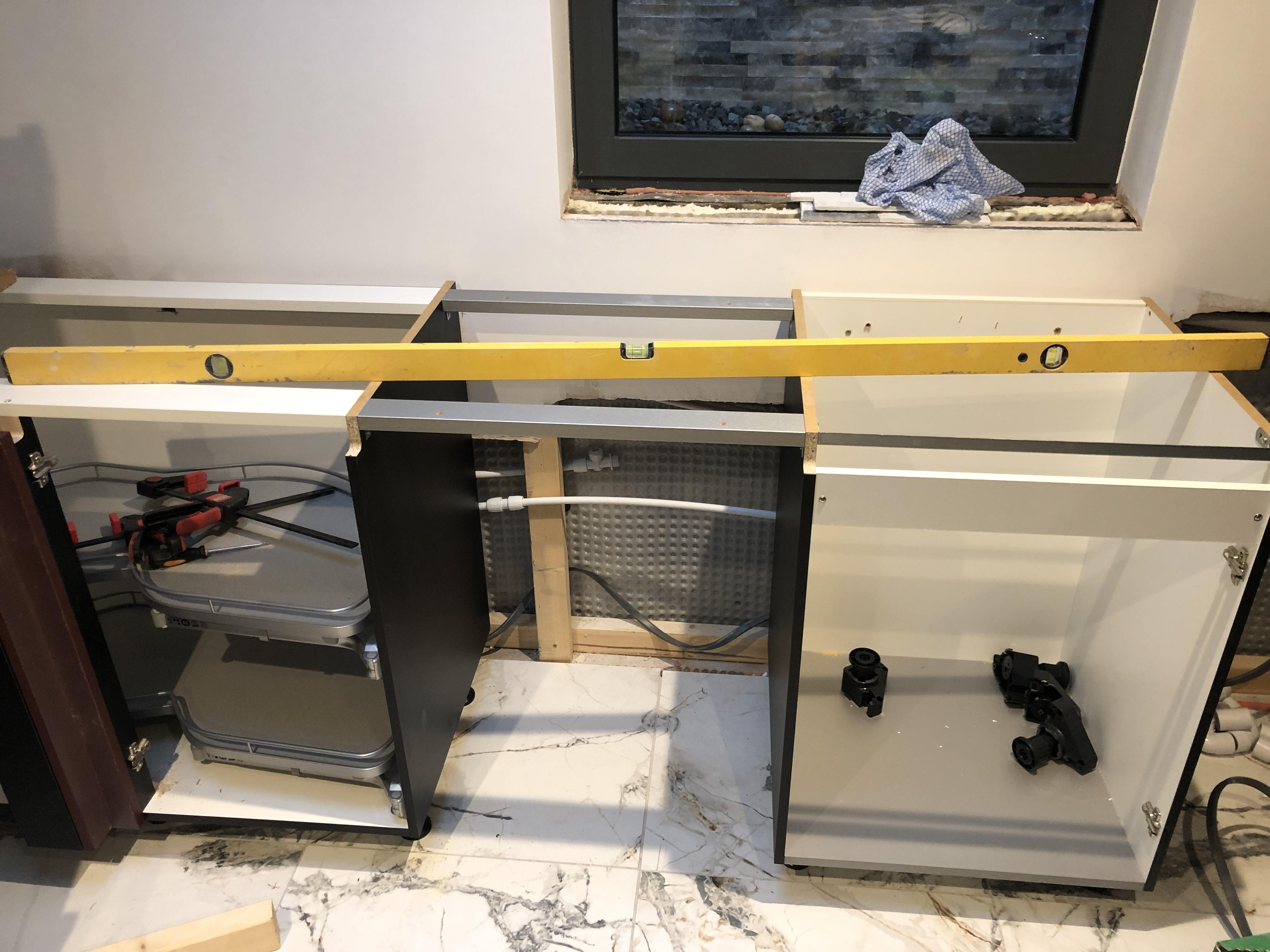

Jenki Posted November 17, 2023 Share Posted November 17, 2023 6 hours ago, Pocster said: Decided I need a professional in to install this . Everything is spot on so far , and rock solid . i I like a self leveling laser level to cast a line around the top of all the units. You find if you move a standard level around the top of the units it changes. With the Lazer you can average out the errors in the units, and it's so easy to level front to back at the same time . 3 Link to comment Share on other sites More sharing options...
Pocster Posted November 18, 2023 Author Share Posted November 18, 2023 9 hours ago, Jenki said: I like a self leveling laser level to cast a line around the top of all the units. You find if you move a standard level around the top of the units it changes. With the Lazer you can average out the errors in the units, and it's so easy to level front to back at the same time . Done that also 😊 1 Link to comment Share on other sites More sharing options...

saveasteading Posted November 22, 2023 Share Posted November 22, 2023 21 minutes ago, Pocster said: When in doubt That creates further doubt. Needs 3 levels and 2 of them to agree. Btw Are lasers always correct? How are they checked? Certainly site levels can go wrong. I know how to check them though. 1 Link to comment Share on other sites More sharing options...
Pocster Posted November 22, 2023 Author Share Posted November 22, 2023 45 minutes ago, saveasteading said: That creates further doubt. Needs 3 levels and 2 of them to agree. Btw Are lasers always correct? How are they checked? Certainly site levels can go wrong. I know how to check them though. Nooooooooo ! I must find more levels !!! 🫤 Link to comment Share on other sites More sharing options...

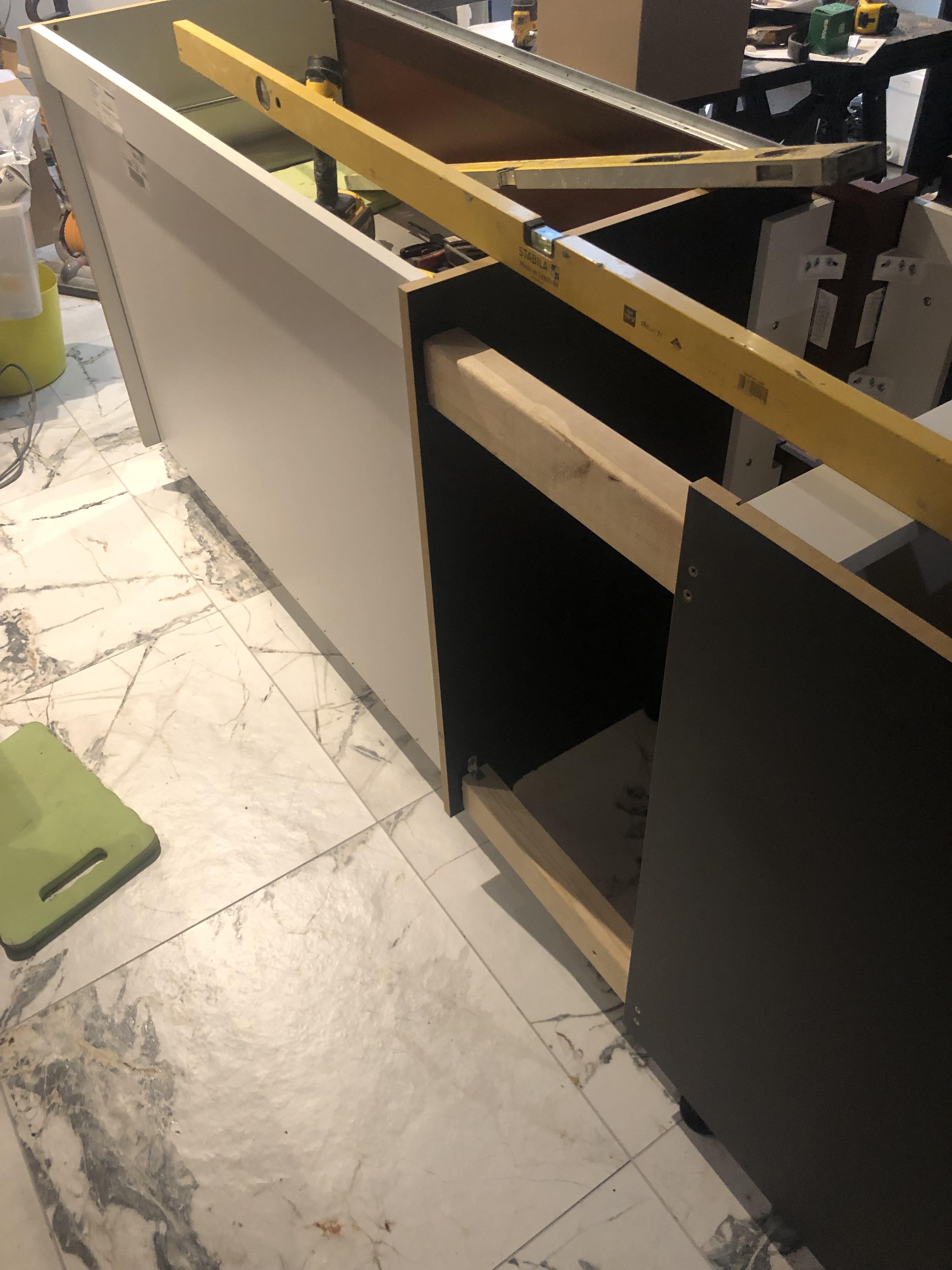

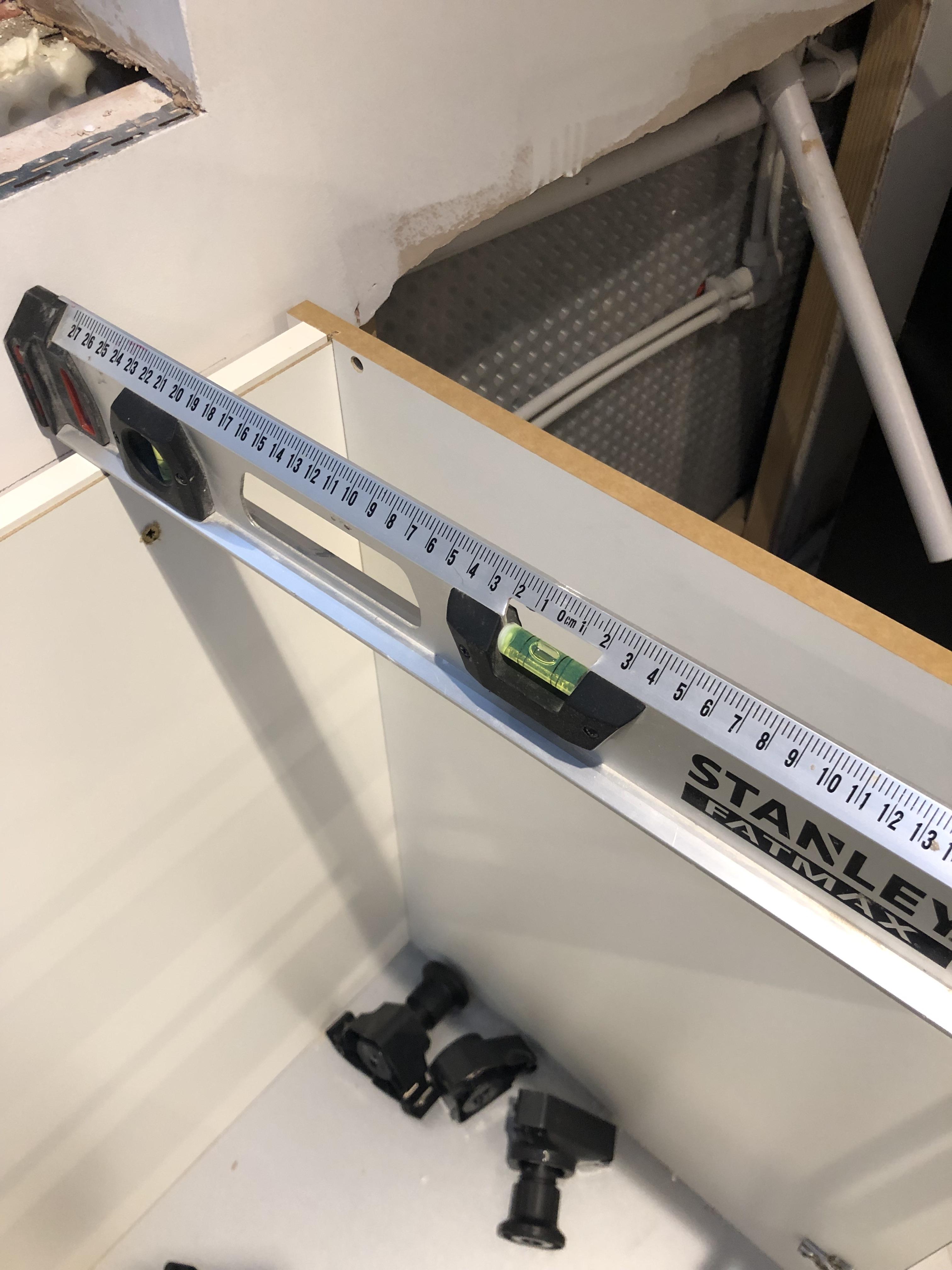

Pocster Posted November 23, 2023 Author Share Posted November 23, 2023 Some big gaps between units so added noggins . Laminate panel goes right down that side . Assume glue ? ( ct1 ? ) . Will have to add vertical noggins on that white unit as otherwise nothing to bond too . Link to comment Share on other sites More sharing options...
Jenki Posted November 23, 2023 Share Posted November 23, 2023 5 hours ago, Pocster said: . Assume glue ? ( ct1 ? ) . Will have to add vertical noggins on that white unit as otherwise nothing to bond too . Screws through the back panels for me, then you've an easy removal if ever needed. glue some filler pieces in place to stop the back panel bowing when the screws are sent home, just measure the panel (18mm)+ gap and add 15mm (assuming the back panel is 18mm) and select the correct screw length. 1 Link to comment Share on other sites More sharing options...
Pocster Posted November 23, 2023 Author Share Posted November 23, 2023 1 minute ago, Jenki said: Screws through the back panels for me, then you've an easy removal if ever needed. glue some filler pieces in place to stop the back panel bowing when the screws are sent home, just measure the panel (18mm)+ gap and add 15mm (assuming the back panel is 18mm) and select the correct screw length. Yeah I was worried about screws . The panels are 18mm. Fear makes me worry that : Not enough bite if screw not deep enough Going through the panel ! Link to comment Share on other sites More sharing options...

joe90 Posted November 23, 2023 Share Posted November 23, 2023 On the white cupboard fit a bottom rail to match the top rail that exists, these then have a 15-18mm gap to the edge of the side panels, glue 15-18mm (whichever it is) timber to the back panel to match the top and bottom ones and you then have up to 36mm to screw into the back panel from the inside of the cupboard through those supports. (I can do you a cad, crayon assisted, drawing if you want 😇) 2 Link to comment Share on other sites More sharing options...
Pocster Posted November 23, 2023 Author Share Posted November 23, 2023 11 minutes ago, joe90 said: On the white cupboard fit a bottom rail to match the top rail that exists, these then have a 15-18mm gap to the edge of the side panels, glue 15-18mm (whichever it is) timber to the back panel to match the top and bottom ones and you then have up to 36mm to screw into the back panel from the inside of the cupboard through those supports. (I can do you a cad, crayon assisted, drawing if you want 😇) What screws for into the laminate ? Just standard wood screws ? - pre drill it ?? Link to comment Share on other sites More sharing options...
joe90 Posted November 23, 2023 Share Posted November 23, 2023 Pre drill a clearance hole in the first piece(that you are fixing through) then twin fast screws, beware to screw slowly if using a power tool as they pull in fast and use the clutch on your driver…Furniture Chipboard / Twinfast Screws, also known as particleboard screws. These self-tapping screws have a coarse thread with twice the thread pitch of standard wood screws, making it easy to drive them into a variety of materials such as chipboard or various densities of fibreboard. 1 1 Link to comment Share on other sites More sharing options...
