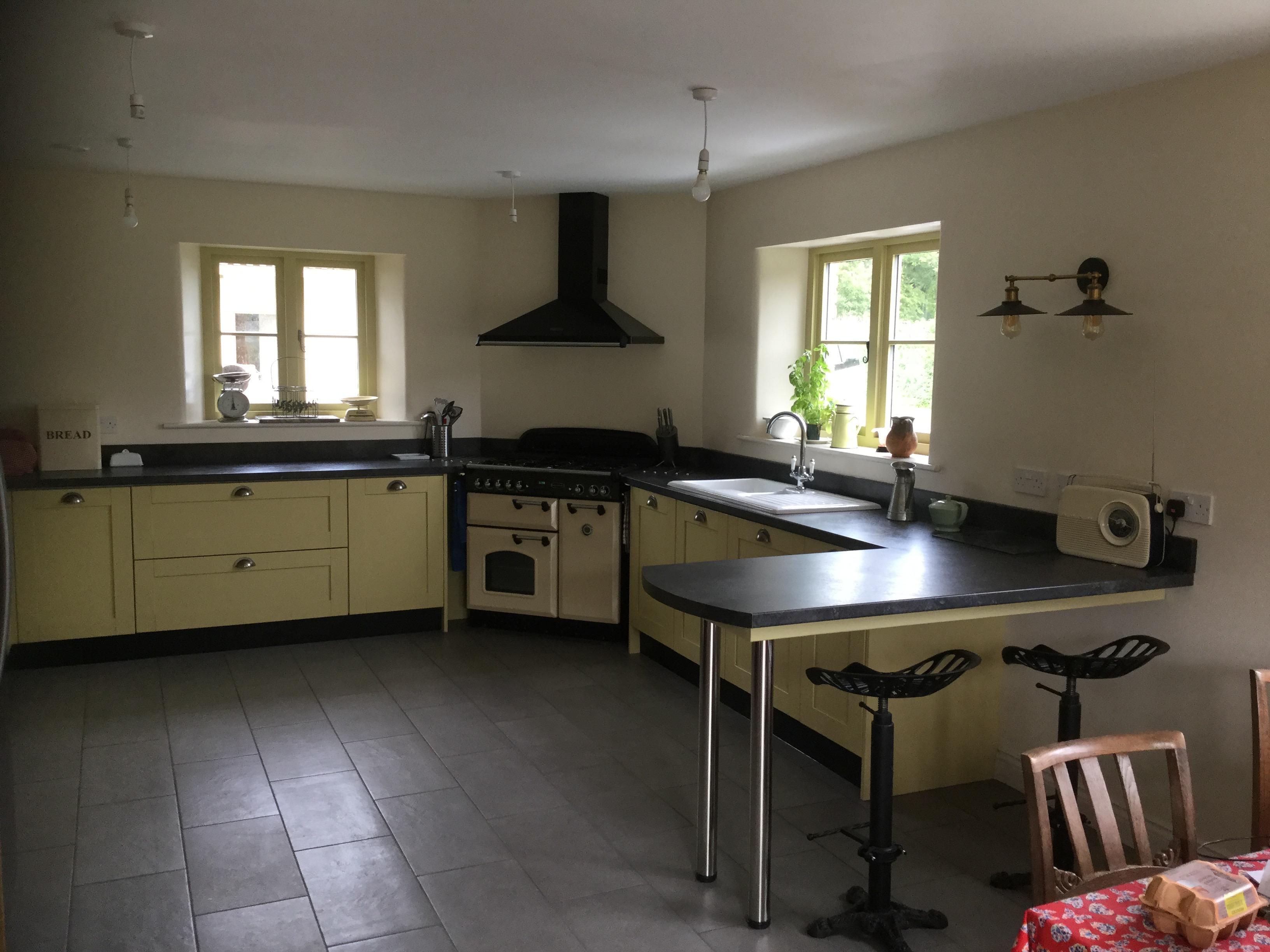

joe90 Posted November 15, 2023 Share Posted November 15, 2023 (edited) 19 minutes ago, Kelvin said: Islands are fine if you have the circulation space around them otherwise they are an inefficient use of the space so a peninsular layout might make more sense for you. With my build, despite having the room you have I went with a peninsular and think it works better 🤷♂️ Edited November 15, 2023 by joe90 1 Link to comment Share on other sites More sharing options...

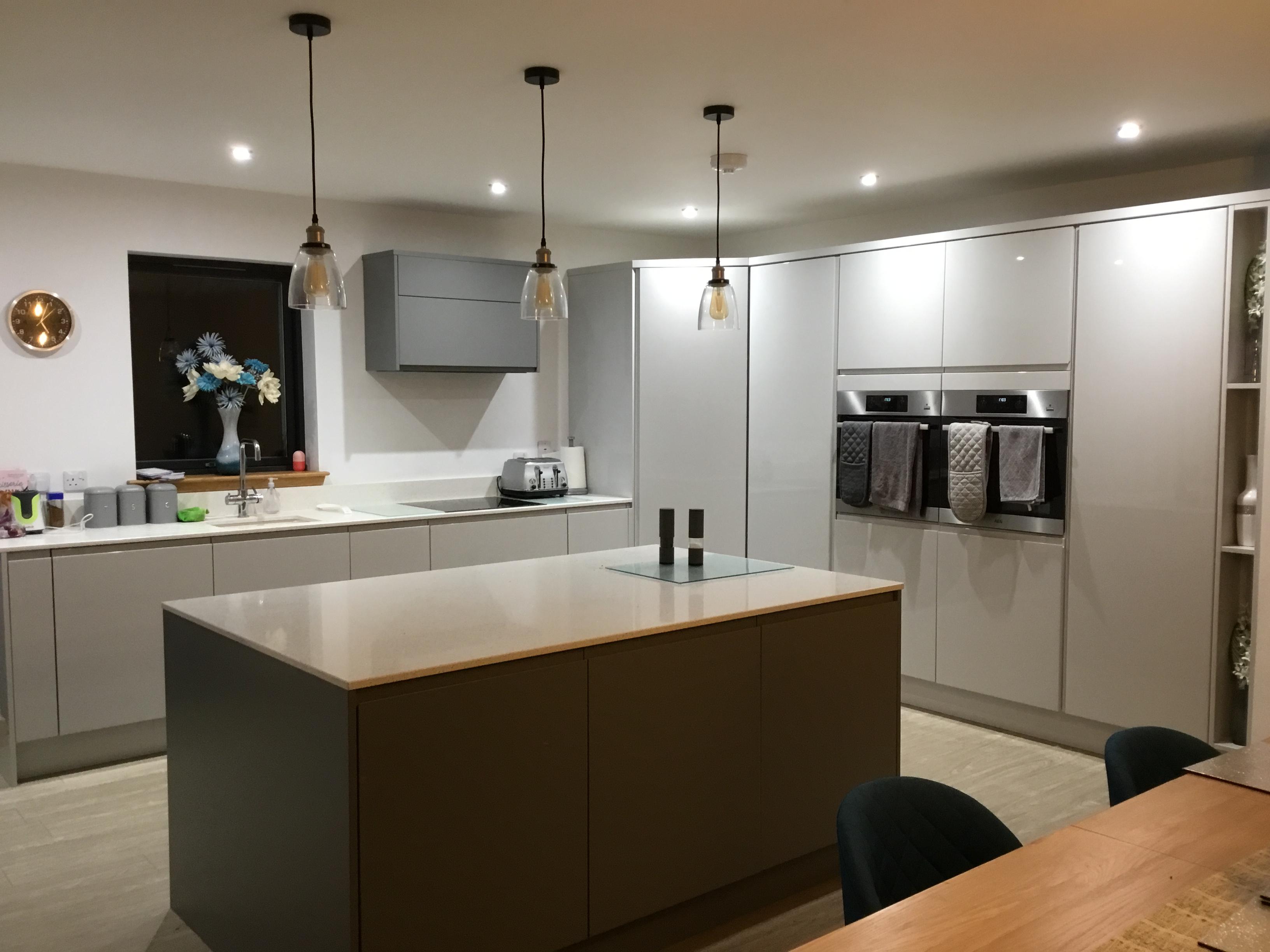

Bozza Posted November 15, 2023 Share Posted November 15, 2023 @jayc89 attached pic of my DIY kitchen, similar room dimensions, and also in dove grey but with darker island. For comparison reasons. We have 1.4m between units and island and that works perfectly. Also have boiling tap. Keeping the island clear of sink/hob has worked perfectly for us. only thing I’d change would be to have a short run of matching wall units off the corner larder unit, to take the extractor. as opposed to what I put in, which matches the darker island. we have plenty of storage in this design. The corner larder is amazing and the pan drawers the other side of the island take all the crockery etc. 1 Link to comment Share on other sites More sharing options...

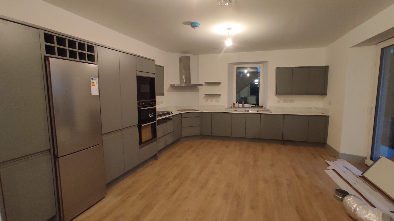

Iceverge Posted November 15, 2023 Share Posted November 15, 2023 Thats ours just before we moved in. from the left, Here's a 2.5 year report. 1. tall sweeping brush cupboard. ( full of crap) 2. fridge and wine(cordial) rack. works well 3. 800mm pantry cupboard. about 60/40 split of useful food storage/full of crap. 4. double oven. top half used once a year. microwave, very good. 5. wide cutlery drawer. works well. other two full of crap. "Mrs Cupboard" on top. Full of crap. 6. 400mm cupboard, works fine. 7. 600mm induction hob in corner, very pleased, drawers for utinsels and pans work well. Extractor fan mounted on MDF diagonal across the corner makes a drumming racket. Not Ideal. 8. 300mm cupboard full of crap. Shelves for tea and coffee above, super useful. 9. 600mm pull out bin, very good. 10. Ikea 2 bowl and drainer SS sink. Very pleased. 11. 800mm under sink cupboard. contains shoe polish, bulbs and various crap. 12. Integrated Dishwasher. 13. Integrated Dishwasher. Above one cupboard full of crap and two for dishes and cups. 14. 400mm cupboard in the corner. Full of crap. We have too many cupboards and the compulsion is just to fill them. Free standing dishwashers would be better in my opinion. I had some issues with the integrated door on one not closing properly and had to dismantle the kitchen somewhat to fix it. Double oven is a waste for us. A boiler tap would have been nice I think. An extractor with the fan at the far end of a very long duct would be much quieter. We used a Laminate worktop. Quite Pleased with it. 600mm cupboards are too deep. The back of them is too deep to access properly. 3 Link to comment Share on other sites More sharing options...
Pocster Posted November 15, 2023 Share Posted November 15, 2023 2 minutes ago, Iceverge said: Thats ours just before we moved in. from the left, Here's a 2.5 year report. 1. tall sweeping brush cupboard. ( full of crap) 2. fridge and wine(cordial) rack. works well 3. 800mm pantry cupboard. about 60/40 split of useful food storage/full of crap. 4. double oven. top half used once a year. microwave, very good. 5. wide cutlery drawer. works well. other two full of crap. "Mrs Cupboard" on top. Full of crap. 6. 400mm cupboard, works fine. 7. 600mm induction hob in corner, very pleased, drawers for utinsels and pans work well. Extractor fan mounted on MDF diagonal across the corner makes a drumming racket. Not Ideal. 8. 300mm cupboard full of crap. Shelves for tea and coffee above, super useful. 9. 600mm pull out bin, very good. 10. Ikea 2 bowl and drainer SS sink. Very pleased. 11. 800mm under sink cupboard. contains shoe polish, bulbs and various crap. 12. Integrated Dishwasher. 13. Integrated Dishwasher. Above one cupboard full of crap and two for dishes and cups. 14. 400mm cupboard in the corner. Full of crap. We have too many cupboards and the compulsion is just to fill them. Free standing dishwashers would be better in my opinion. I had some issues with the integrated door on one not closing properly and had to dismantle the kitchen somewhat to fix it. Double oven is a waste for us. A boiler tap would have been nice I think. An extractor with the fan at the far end of a very long duct would be much quieter. We used a Laminate worktop. Quite Pleased with it. 600mm cupboards are too deep. The back of them is too deep to access properly. I’ve got 30 boxes of “ kitchen stuff” that has been packed away for now 7 years . Or “ crap “ as you technically call it . SWMBO is adamant it’s all necessary. I’ve thrown a few bits out over the years - but it’s hard to make 30 boxes vanish unnoticed. Once the kitchen is complete I assume some will migrate from “ box of crap “ to “ cabinet of crap “ - much like yours 🫤 1 Link to comment Share on other sites More sharing options...

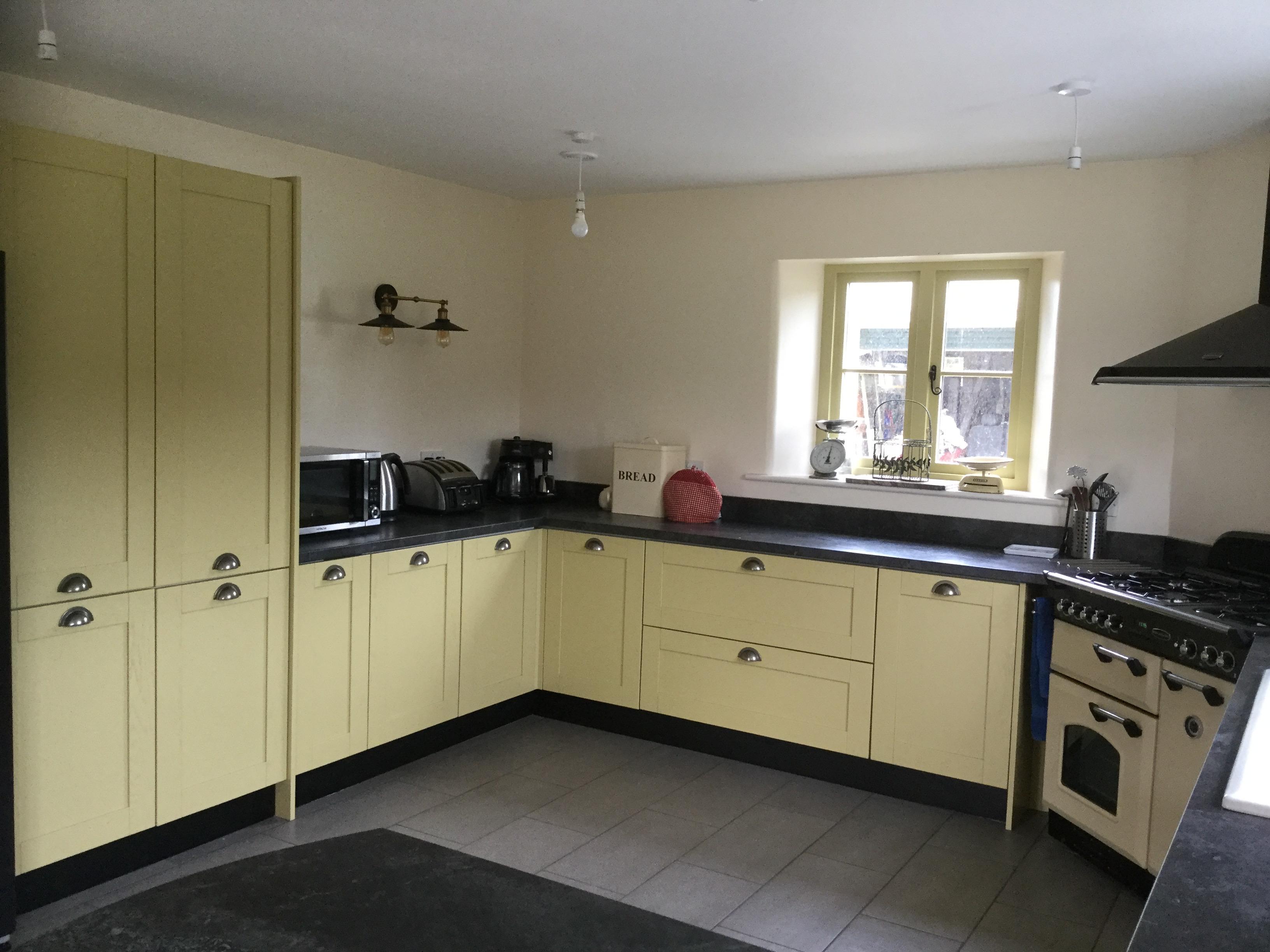

crispy_wafer Posted November 16, 2023 Share Posted November 16, 2023 14 hours ago, joe90 said: With my build, despite having the room you have I went with a peninsular and think it works better 🤷♂️ Now that's why I advocate looking at what others have done! I love what you've done with the cooker position. You see I have windows on two walls too and pretty much discounted positioning the cooker anywhere but on a flat wall. You placed in a corner and I think that works quite well! Thanks @joe90 for posting that! I'm going to send this to the boss and send her brain into a tailspin! 1 Link to comment Share on other sites More sharing options...
crispy_wafer Posted November 16, 2023 Share Posted November 16, 2023 @jayc89 Don't forget about extraction, or a recirc jobbie and position if you need it. Link to comment Share on other sites More sharing options...
joe90 Posted November 16, 2023 Share Posted November 16, 2023 36 minutes ago, crispy_wafer said: I love what you've done with the cooker position. Yes it works very well, I hate corners in kitchens with cupboards you can’t get into. It’s just timber framing and plasterboard, took a lot of working out to end up with the cooker fit with the worktop cut at 45’. That cooker hood is re a circulation one but easy to make direct outside. It also gave a great place to route water pipes etc up to the next floor 👍 2 Link to comment Share on other sites More sharing options...
jayc89 Posted November 16, 2023 Author Share Posted November 16, 2023 Funnily, my parents recently did the same with their hob (45 angle) and say they hate it. Takes up too much room etc. To be fair, I can see their point, their kitchen is a reasonable size; probably 4x3 and that unit just looks overbearing in it - can certainly see it looking better in a larger space. Link to comment Share on other sites More sharing options...
