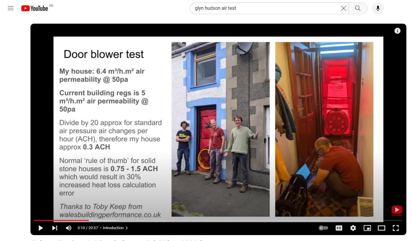

Square Feet Posted November 10, 2023 Share Posted November 10, 2023 I've been very surprised that Booglehead (a guy I follow on YouTube) and Glyn Hudson (same) both passed their pressure tests without doing what I would have thought necessary. Booglehead hadn't taped around his windows at all it seemed and hadn't taped the insides of his SIPS. The outsides didn't look very carefully taped either. He also put a lot of screws right through everything in a way that I thought would have caused leaks. Glyn Hudson got his regular town house (not sure when built, but quite old) pressure tested and that passed too. I was really surprised by that one. Made me wonder what all the fuss is about. Link to comment Share on other sites More sharing options...

Square Feet Posted November 11, 2023 Share Posted November 11, 2023 On 10/11/2023 at 09:56, SteamyTea said: Passed at what level. 0.2 or 5? I passed my driving test, crashed sister's car 2 nights later, then my motorbike, twice, then my father's brand new car, got banned twice for my troubles. Then, at 20 years old, I got glasses and it all seemed to stop happening. 0.45 if I remember correctly. I think Glyn Hudson's was even lower, which was very strange. Here's the links. https://www.youtube.com/watch?v=tFMlJmRiaqo&list=PLzJHPUKEmzWVlbuMLwIeT_52SooH5ROrB&index=4&ab_channel=Booglehead I think Glyn has done the numbers wrong tbh, though he is a techiehead and loves this sort of thing so it seems unlikely, but I just can't wrap my head around how he has calculated it - he claims it's 0.3Ach. https://www.youtube.com/watch?v=kkNx2oSO-S4&t=383s&ab_channel=GlynHudson Link to comment Share on other sites More sharing options...
S2D2 Posted November 11, 2023 Share Posted November 11, 2023 16 minutes ago, Square Feet said: 0.45 if I remember correctly. I think Glyn Hudson's was even lower, which was very strange. Here's the links. https://www.youtube.com/watch?v=tFMlJmRiaqo&list=PLzJHPUKEmzWVlbuMLwIeT_52SooH5ROrB&index=4&ab_channel=Booglehead I think Glyn has done the numbers wrong tbh, though he is a techiehead and loves this sort of thing so it seems unlikely, but I just can't wrap my head around how he has calculated it - he claims it's 0.3Ach. https://www.youtube.com/watch?v=kkNx2oSO-S4&t=383s&ab_channel=GlynHudson 0.3 for the heat loss calculation, not the blower test. Shows in the thumbnail that's after dividing by 20 and the actual blower test result of 6.4@50Pa 1 Link to comment Share on other sites More sharing options...
JohnMo Posted November 11, 2023 Share Posted November 11, 2023 4 hours ago, Square Feet said: but I just can't wrap my head around how he has calculated it - he claims it's 0.3Ach. He is playing with numbers, his house leaks like a seize. A passivhaus is also tested at 50Pa, they have to score 0.6 ACH or better from that test, he scored 6.4m3/m2 at the same pressure. Not quite the same scale, but close enough in this case. So using his example of dividing by 20 a passivhaus would leak at a rate 0.03 ACH. 2 Link to comment Share on other sites More sharing options...

ProDave Posted November 11, 2023 Share Posted November 11, 2023 I thought the conversion from m3/m2 to ACH was very approximately 1:1 but there is no simple universal conversion because it depends on the geometry of the house, i.e is it single storey, 2 storey, vaulted ceilings etc. If it really was divide by 20 them my 1.4 m3/m2 would be 0.07ACH. No way is that the case. Link to comment Share on other sites More sharing options...
