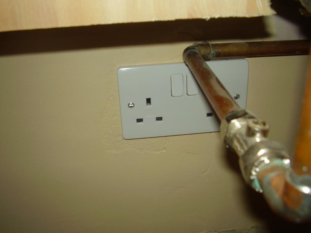

Onoff Posted November 8, 2023 Posted November 8, 2023 I didn't do this just tidied it up. Back box was rattling in the wall, access to inspect was a pig. Stupid, stupid, stupid!

ProDave Posted November 8, 2023 Posted November 8, 2023 48 minutes ago, Onoff said: I didn't do this just tidied it up. Back box was rattling in the wall, access to inspect was a pig. Stupid, stupid, stupid! I bet the original socket had scorch marks from the plumbers soldering.

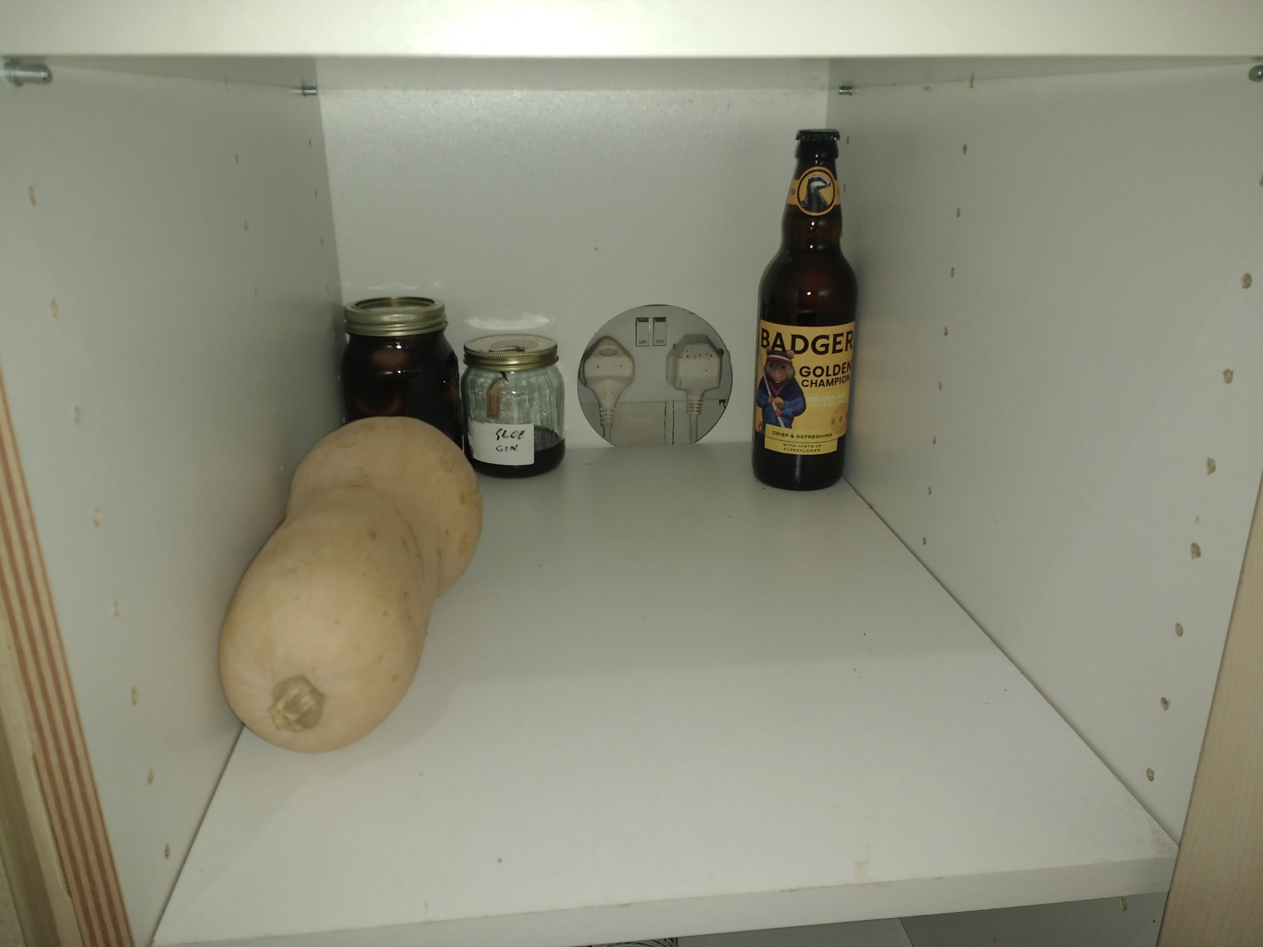

Pocster Posted November 9, 2023 Author Posted November 9, 2023 11 hours ago, Onoff said: That’s a funny shaped dildo 1
FuerteStu Posted November 9, 2023 Posted November 9, 2023 18 hours ago, Onoff said: Looks like a bit of a squash in there.. 2
Onoff Posted November 9, 2023 Posted November 9, 2023 2 hours ago, FuerteStu said: Looks like a bit of a squash in there.. You clearly know your onions!
