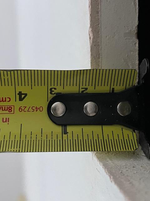

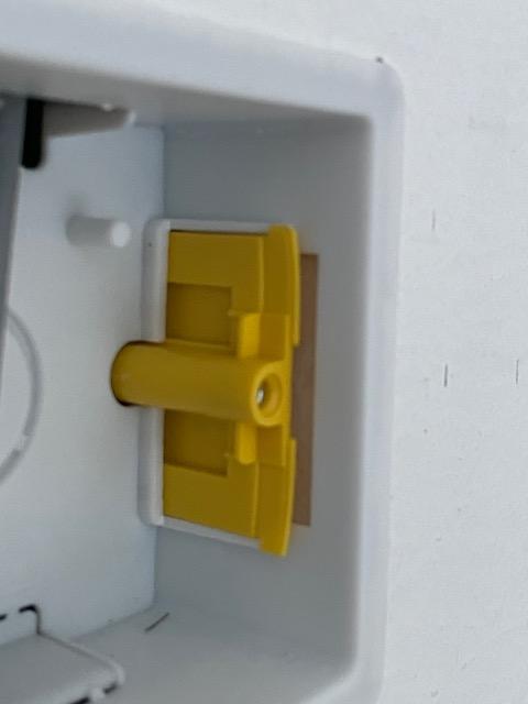

Thorfun Posted November 7, 2023 Share Posted November 7, 2023 greetings. I've started to cut out and fit back boxes but I'm finding that our makeup of 12.5mm plasterboard and skim is about 16mm. I'm using the Appleby back boxes as recommended by @ProDave but I don't get the satisfactory 'click' when the clips fit in place. is that a problem? the back boxes are apparently designed and tested specifically for dry wall/plasterboard, with a thickness of 6.35-15mm. so I'm about 1mm too thick. is there a way to make it fit so they click in to place? or am I being special and worrying about nothing as usual? Link to comment Share on other sites More sharing options...

MikeGrahamT21 Posted November 7, 2023 Share Posted November 7, 2023 Snip the lugs off or buy the deeper box version, either should do the trick Link to comment Share on other sites More sharing options...
Thorfun Posted November 7, 2023 Author Share Posted November 7, 2023 6 minutes ago, joe90 said: I am not an expert but that seems awfully thick for a skim, sand it back? 🤷♂️ might be tricky to sand back just around the back box though! might be easier to cut a bit off the back of the plasterboard! I thought a skim was 3mm with the 2 coats of plaster. at least that's what I worked all our measurements to. which makes me wonder why the back boxes aren't made for 16mm thicknesses. unless these days they don't expect anyone to skim the walls and just tape and fill. or maybe I need to find another brand of back box that will do slightly thicker wall makeups? Link to comment Share on other sites More sharing options...

Thorfun Posted November 7, 2023 Author Share Posted November 7, 2023 2 minutes ago, MikeGrahamT21 said: Snip the lugs off or buy the deeper box version, either should do the trick does snipping the lugs off not reduce the effectiveness of the box being held in place? also, according to the Q&A here https://www.screwfix.com/p/appleby-1-gang-dry-lining-knockout-box-47mm/83270 the 47mm boxes are also meant for 6.3mm - 15mm thicknesses Link to comment Share on other sites More sharing options...

MikeGrahamT21 Posted November 7, 2023 Share Posted November 7, 2023 (edited) 3 minutes ago, Thorfun said: does snipping the lugs off not reduce the effectiveness of the box being held in place? also, according to the Q&A here https://www.screwfix.com/p/appleby-1-gang-dry-lining-knockout-box-47mm/83270 the 47mm boxes are also meant for 6.3mm - 15mm thicknesses It will but you can work around it, dot of silicone on the lug track to hold in place, and once you’ve got the face plate screwed it it won’t move anyway. The other thing you could do it shorten the track guides slightly, this will give a longer run and give you the satisfying click ive butchered a few of mine over the years and they’re still where I want them Edited November 7, 2023 by MikeGrahamT21 1 Link to comment Share on other sites More sharing options...

Thorfun Posted November 7, 2023 Author Share Posted November 7, 2023 34 minutes ago, MikeGrahamT21 said: It will but you can work around it, dot of silicone on the lug track to hold in place, and once you’ve got the face plate screwed it it won’t move anyway. The other thing you could do it shorten the track guides slightly, this will give a longer run and give you the satisfying click ive butchered a few of mine over the years and they’re still where I want them Thanks. Although when you have over 100 to fit that starts to seem like a daunting task! 😂 Link to comment Share on other sites More sharing options...
ProDave Posted November 7, 2023 Share Posted November 7, 2023 Is there anything restricting the depth in the cavity? the time I find the lugs don't click into place are when the back end of the yellow lug has hit the back of the cavity. Get a long flat screwdriver behind the bit sticking out either side of the screw and you can sometimes pull or lever it forwards that last bit it needs. I doubt all your cut outs will be this thick, how many have you cut so far? P.S I usually do the cut outs before the spread arrives. Link to comment Share on other sites More sharing options...

Thorfun Posted November 7, 2023 Author Share Posted November 7, 2023 2 minutes ago, ProDave said: Is there anything restricting the depth in the cavity? the time I find the lugs don't click into place are when the back end of the yellow lug has hit the back of the cavity. nope. this particular wall is 140mm deep so nothing behind. 2 minutes ago, ProDave said: Get a long flat screwdriver behind the bit sticking out either side of the screw and you can sometimes pull or lever it forwards that last bit it needs. ok, will give that a try as well 3 minutes ago, ProDave said: I doubt all your cut outs will be this thick, how many have you cut so far? just 2 to get ready for the AC install tomorrow! many many more to go. 😉 3 minutes ago, ProDave said: P.S I usually do the cut outs before the spread arrives. way too late for that. i did ask the plasterers and they, obviously, said they'd prefer to not cut out before they skim. and as they did the boarding i wouldn't have had time anyway. Link to comment Share on other sites More sharing options...

Alan Ambrose Posted November 7, 2023 Share Posted November 7, 2023 You can make little cutouts at the back of the plasterboard very quickly with a plasterboard saw to make them work, particularly if there's not many to do. Some of my walls here have two sheets of PB, so 25mm thick. Alternatively, for a few mm, you can just be gentle and pull the screws up tight without the tabs latching, and they'll hold the whole thing in place fine. 1 Link to comment Share on other sites More sharing options...
Thorfun Posted November 7, 2023 Author Share Posted November 7, 2023 2 hours ago, Alan Ambrose said: You can make little cutouts at the back of the plasterboard very quickly with a plasterboard saw to make them work, particularly if there's not many to do. Some of my walls here have two sheets of PB, so 25mm thick. Alternatively, for a few mm, you can just be gentle and pull the screws up tight without the tabs latching, and they'll hold the whole thing in place fine. i wonder how removing cutouts from the back will effect the strength of the PB? without the paper there will it make it a bit brittle in that area where the lug is holding the back box in place? Link to comment Share on other sites More sharing options...
