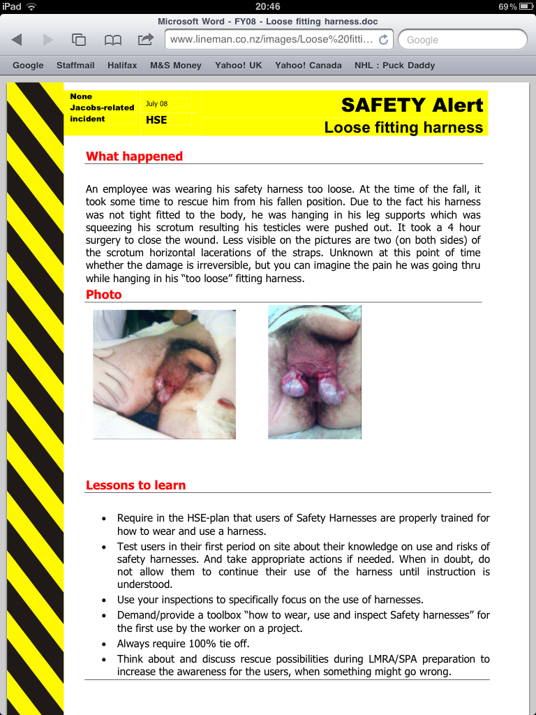

Simplysimon Posted September 7, 2017 Share Posted September 7, 2017 On 06/09/2017 at 09:01, vfrdave said: This is what HSENI has to say about harnesses:- Harnesses should be the last option considered, and only used by workers who have been trained in their use and the use planned by someone competent to take into account: the circumstances strength and location of available anchor points type/length of lanyard suspension height and obstacles means of rescue and if you don't use them correctly.... Link to comment Share on other sites More sharing options...
AliG Posted September 8, 2017 Share Posted September 8, 2017 I think that needed a warning! Link to comment Share on other sites More sharing options...
Nickfromwales Posted September 8, 2017 Share Posted September 8, 2017 I was going to a bite to eat but somehow just lost my appetite.......for life. "Bollocks" . Ouch. Link to comment Share on other sites More sharing options...
Onoff Posted September 8, 2017 Share Posted September 8, 2017 6 minutes ago, AliG said: I think that needed a warning! There's a worse accident of this nature shown on working at height courses now where shall we say you see SEPARATE parts! Remember lads "form a pouch" for your valuables! Link to comment Share on other sites More sharing options...
Nickfromwales Posted September 8, 2017 Share Posted September 8, 2017 My friend worked for British gas a while back. They hired Bristol crown court and staged a mock prosecution where a missing toe board caused a piece of equipment to fall off into a neighbours garden. In said garden was a 5 year old toddler who was struck by said flying object and 'left' with life changing brain injuries. An actual apprentice of BG was hauled as a witness and cross-examined so intensely that he broke down in tears and was excused from the courtroom!! The claim 'would' have run into millions of pounds. The point was made. People just don't know what can go wrong until it does. Should the scaffold companies not be prosecuted if they leave you incomplete or non-certified erections that you've paid good money for ? Link to comment Share on other sites More sharing options...
AliG Posted September 8, 2017 Share Posted September 8, 2017 29 minutes ago, Nickfromwales said: Should the scaffold companies not be prosecuted if they leave you incomplete or non-certified erections that you've paid good money for ? I think that's a problem the guy in the picture might have 1 Link to comment Share on other sites More sharing options...
