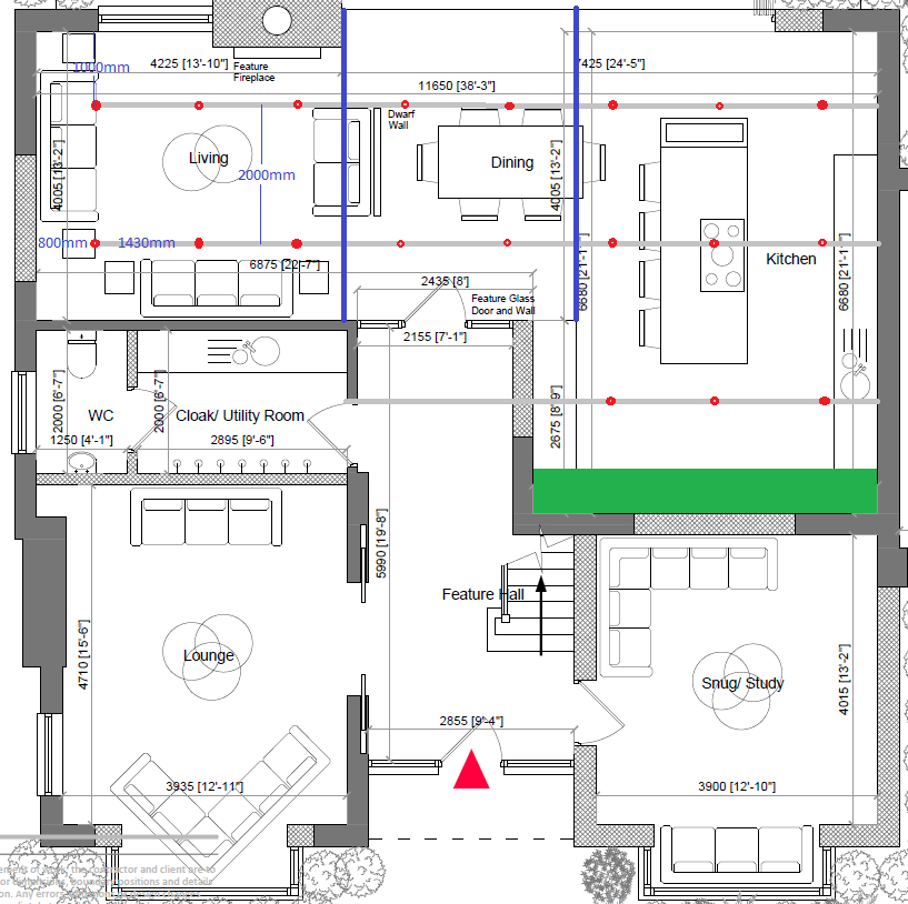

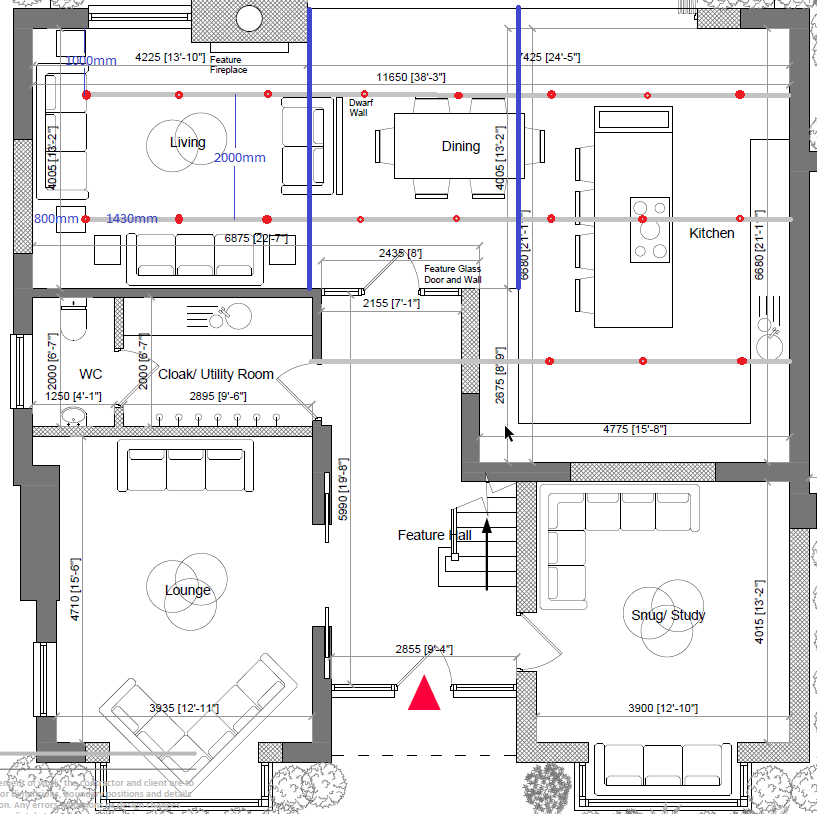

richo106 Posted October 6, 2023 Posted October 6, 2023 Hi all I am now first fixing my kitchen and trying to work out position/number of downlights needed in my kitchen/diner area I have done a layout on the pc as currently on holiday, I have marked on the drawings my rough spacing (joist position depending) The blue lines split up the room with the sofa and table being further to the left within the blue lines I don't want to install too many but on the other hand want to be bright enough, all 3 zones will be switched separately and also a separate kitchen plinth lighting/wall lighting circuit Any comments at all on the downlights would be appreciated Many Thanks
richo106 Posted October 6, 2023 Author Posted October 6, 2023 Meant to add the green section is not worktop they are full height units
JohnMo Posted October 6, 2023 Posted October 6, 2023 I would move away from using small spot lights and use much bigger brighter ones, and way fewer lights. For example our kitchen diner area is like yours, an L shape (we don't have the sitting area you have), but we have 8 lights in total (instead of your 13), the lights are flush fit 150mm dia. The kitchen is very bright with the lights on.
Mike Posted October 6, 2023 Posted October 6, 2023 While I do use downlighters, but am not keen on using them in rows for general illumination - though I know many do. Though for a regular grid of downlighters, I do commend your restraint on the quantity selected which, subject to beam angle, could create some variation in light and shade. But it's not the way I'd do it. Personally I'd first be thinking of choosing lighting to suit the particular uses of the space - so lighting above the dining table and the kitchen island, to the sides of the sofas for reading / watching TV, and additional task lighting over the kitchen worktops. That could be a mixture of pendants, floor / table lamps and spots, for example. Then I'd be looking at highlighting any particular architectural features (including plinth lighting), or where any paintings or other features may go. Finally I'd be considering whether or not there are any particular gaps that may need additional illumination. Ideally, have at least 3 different layers of illumination, with dimmers on at least the principle layer. Other factors to consider are beam angles, light temperature and the colour rending index of the bulbs. 2

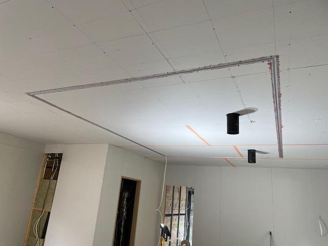

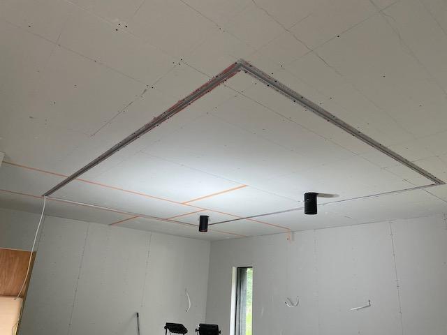

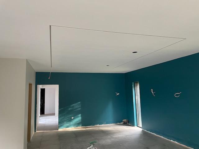

Thorfun Posted October 7, 2023 Posted October 7, 2023 here's what we did after getting a design from a lighting designer. we will have 3 pendants over the dining table and island, directional spots to light artwork/walls etc, led strips under wall units and the walkway around the island we decided to swap out spots for an plastered in LED strip channel. we think it looks amazing and have planned for it to be equidistant from the island so it 'should' frame the island. here's a photo, kitchen is being delivered next week so we'll see if our planning worked out. so the only actual downlight spots we have will be the couple shown in the entrance to the kitchen/dining area. we really wanted to avoid that grid of spots look. you can be so much more creative and your layout for the room really lends itself to be so. using different lighting for each 'section' of the room will help the demarcation of each area and give different mood lighting for the activities that will be done in those areas. we feel that the £1500 we paid the lighting designer to give us a concept design for our house was invaluable. but we'll only know for sure once the house is finished and we're living in it. 3

Eric Posted October 7, 2023 Posted October 7, 2023 @Thorfun do you have a link for these recessed ones? All the plaster in ones that I have seen seem to sit proud & your ones look to be recessed perfectly. Do you have any photos while fitting them also?
Mike Posted October 8, 2023 Posted October 8, 2023 2 hours ago, Eric said: All the plaster in ones that I have seen seem to sit proud & your ones look to be recessed perfectly. Not sure what @Thorfun used, but I've recently bought (not yet fitted) a mix of Faro Hyde and Fresh frameless, under the impression that the latter wasn't orientable. Turns out they are too, it's just not mentioned on the spec sheet. Both can be set, pre-plastering, for a 1 to 20mm plaster depth (though with different adjustment mechanisms). There are some visual & build differences, including: Fresh is a bit larger with a 90mm cut-out, comes with a GU10 bulb connector, a twist-off bulb retaining ring, and a max rating of '8W LED' (though the web page, only, says max 50W) Hyde is smaller but with a larger 104mm cut-out, comes without a bulb connector, has a pull-off bulb retaining ring, and a max rating of '8W LED' As they're going in distinct places I'll be keeping both, but otherwise I'd have standardised on the Fresh and sent back the Hyde. I'll be fitting them with Tridonic modules as suggested by @Carrerahill in this thread from a while back. 1
Thorfun Posted October 8, 2023 Posted October 8, 2023 13 hours ago, Eric said: @Thorfun do you have a link for these recessed ones? All the plaster in ones that I have seen seem to sit proud & your ones look to be recessed perfectly. Do you have any photos while fitting them also? we bought these https://www.ultraleds.co.uk/plaster-in-standard-recessed-plaster-in-led-aluminium-channel-3-metre-length.html but I see they have dramatically increased in price since I bought them! I paid £19.70+VAT for a 3m length. here are a couple of photos after we fitted them. I cut out the channels in the plasterboard after they were put up and then fitted the profiles. 1
Tetrarch Posted October 8, 2023 Posted October 8, 2023 6 hours ago, Thorfun said: we bought these https://www.ultraleds.co.uk/plaster-in-standard-recessed-plaster-in-led-aluminium-channel-3-metre-length.html but I see they have dramatically increased in price since I bought them! I paid £19.70+VAT for a 3m length. here are a couple of photos after we fitted them. I cut out the channels in the plasterboard after they were put up and then fitted the profiles. These are looking fabulous. Do you have a picture with it lit? Regards Tet
Thorfun Posted October 8, 2023 Posted October 8, 2023 35 minutes ago, Tetrarch said: These are looking fabulous. Do you have a picture with it lit? Regards Tet nope. not finished yet. maybe one day though ask me again in about 6 months. 🤣 2

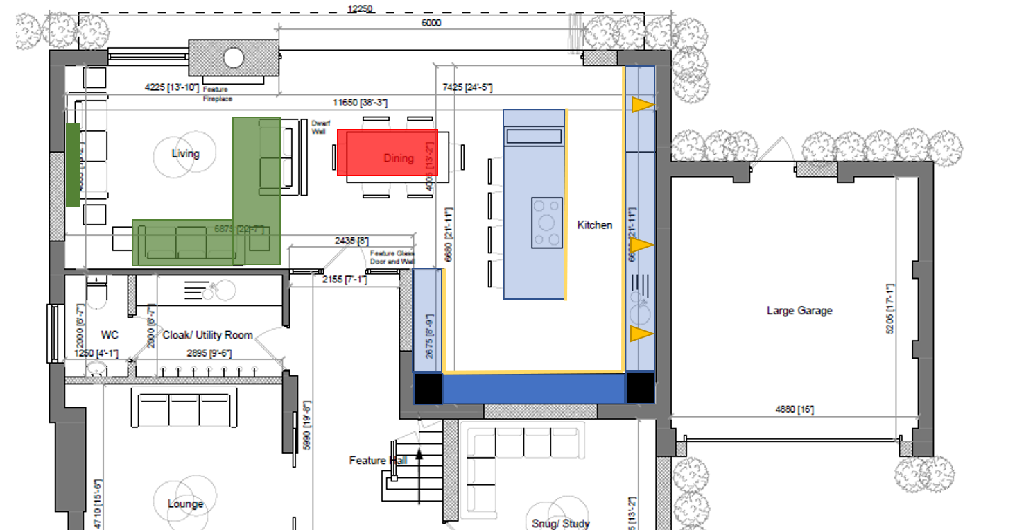

richo106 Posted October 8, 2023 Author Posted October 8, 2023 Thanks all for the comments so far, certainly gave us food for thought! we like the led strip idea but not sure it would fit as we are going quite traditional with our house/kitchen style I have attached what the rough layout would be, the lightest blue is worktop and the darker blue full height units. Red is the dining table (not sure of shape or size etc yet) we are planning to have a L shape sofa in the TV area in green In the kitchen side we are planning to have wall lights (sconces) and plinth lighting to create ambient lighting in the area We are not toying with the idea of having a pandant (s) over the dining table area, we were originally put of this as not sure on what table we would be having, but I feel it would be a big open ceiling with no pendant breaking it up potentially. If people were to add spots to this plan where would they put, I am planning to wire this next week so nothing like leaving it last minute! Thanks again for all the comments

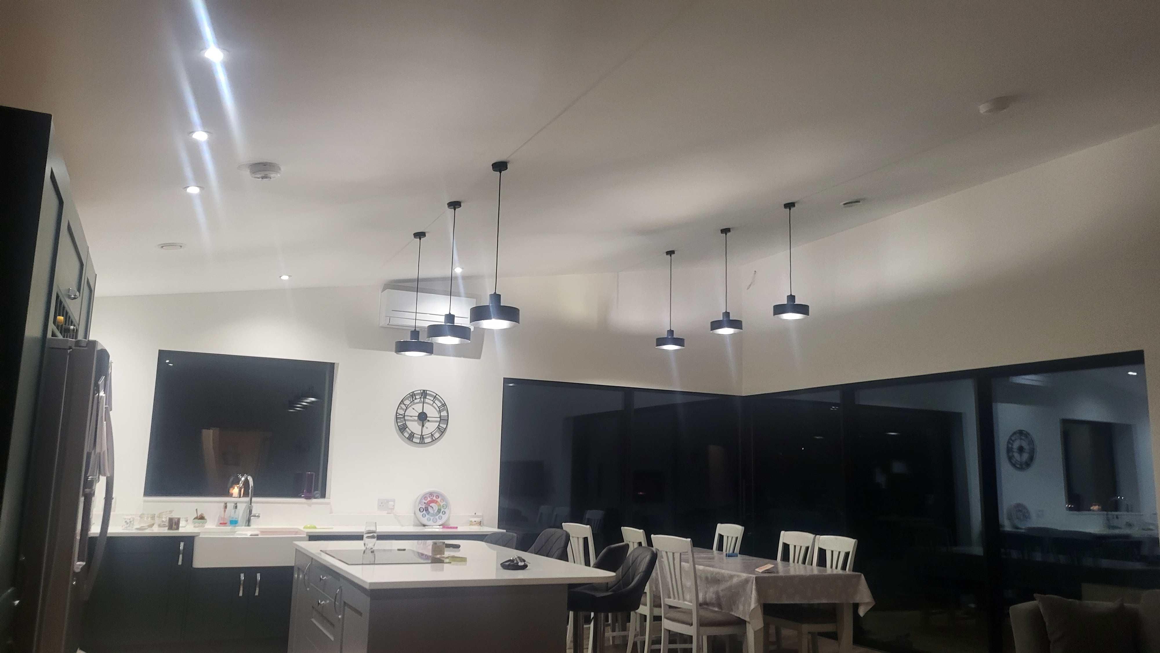

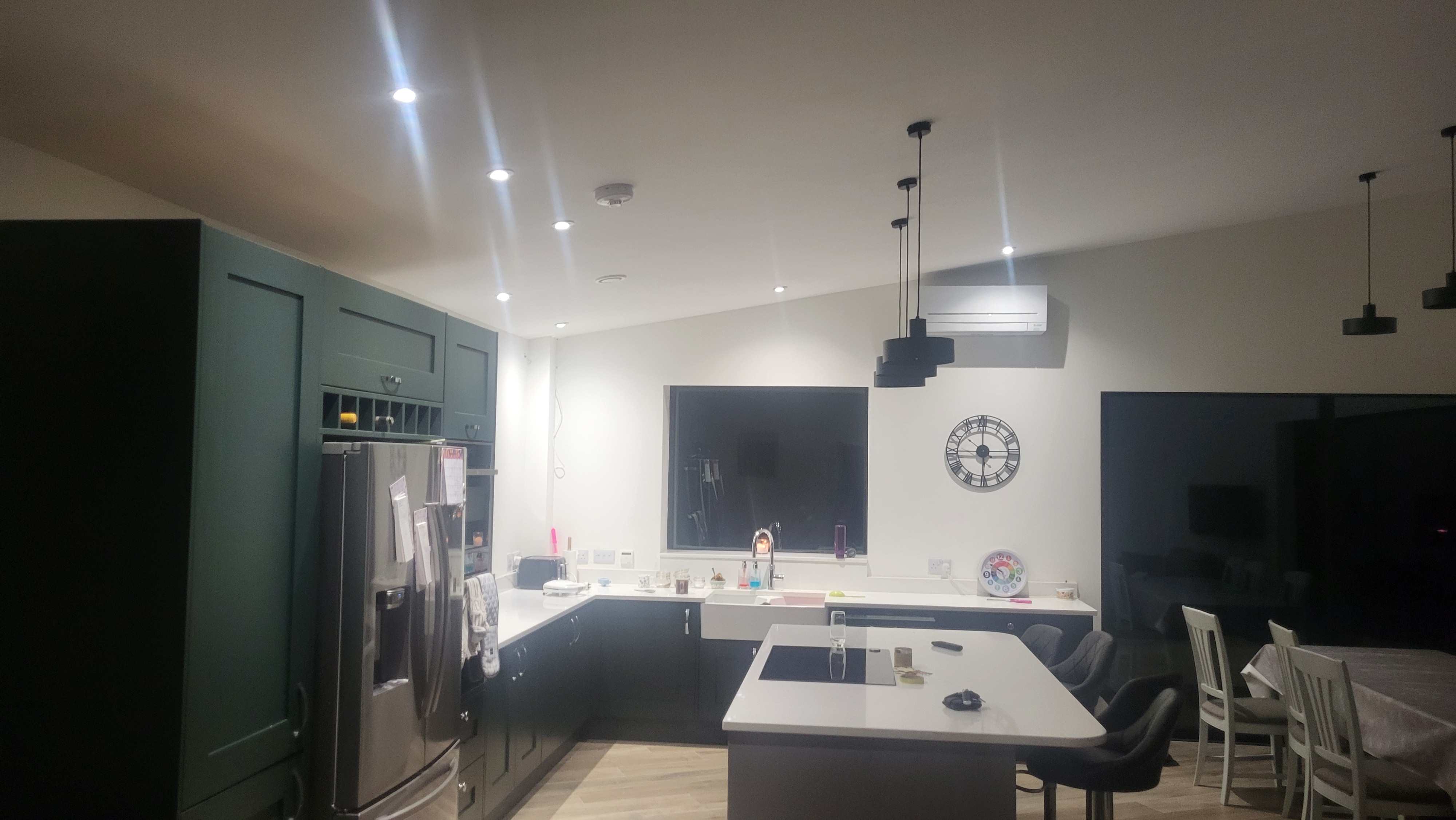

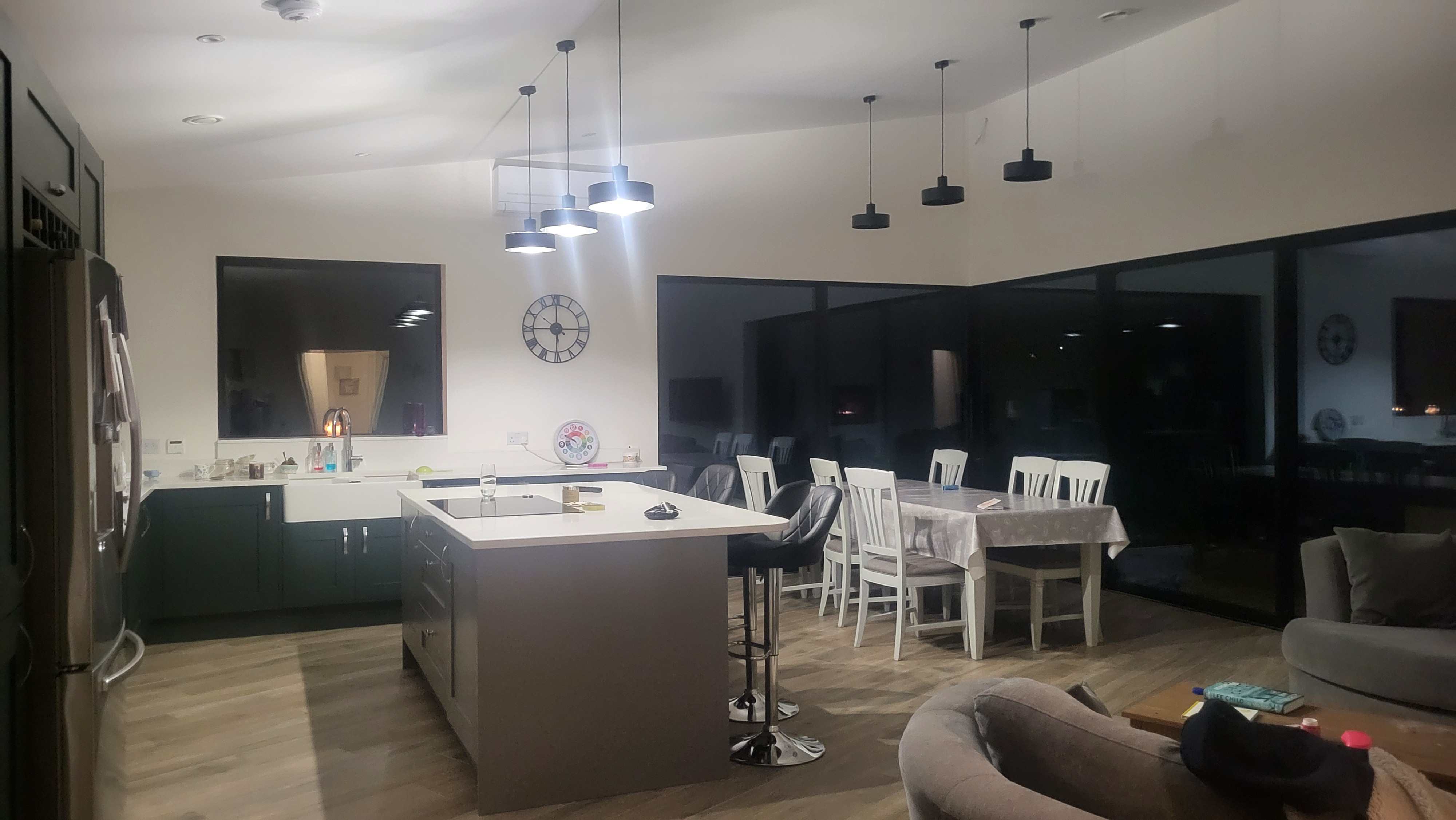

Andehh Posted November 29, 2024 Posted November 29, 2024 Put lights where you need them, not everywhere. Illumination levels should vary based on what you're doing. We did Leds over the counters (food prep) then hanging lights over the table and island (atmospheric). Lounge/study is atmospheric, you don't need operating theatre grade lighting. Terrible pics as camera over compensates the lights, but shows you what we did. Downlights ABOVE the counters so your body isn't casting a shower on the food you are preparing. Leds stepped out so not above the tall units, so the light is between you and the cupboard/fridge/oven. Hanging lights over island which is our default light (atmospheric) . Table downlights for eating when you down need 500 lumens over your head. This works very well. Leds everywhere just tells me your electrician decided the lighting arrangement, and priced per fitting. 1
