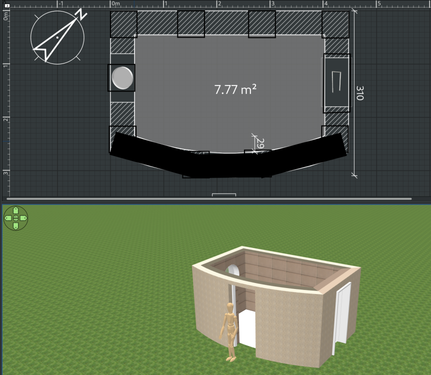

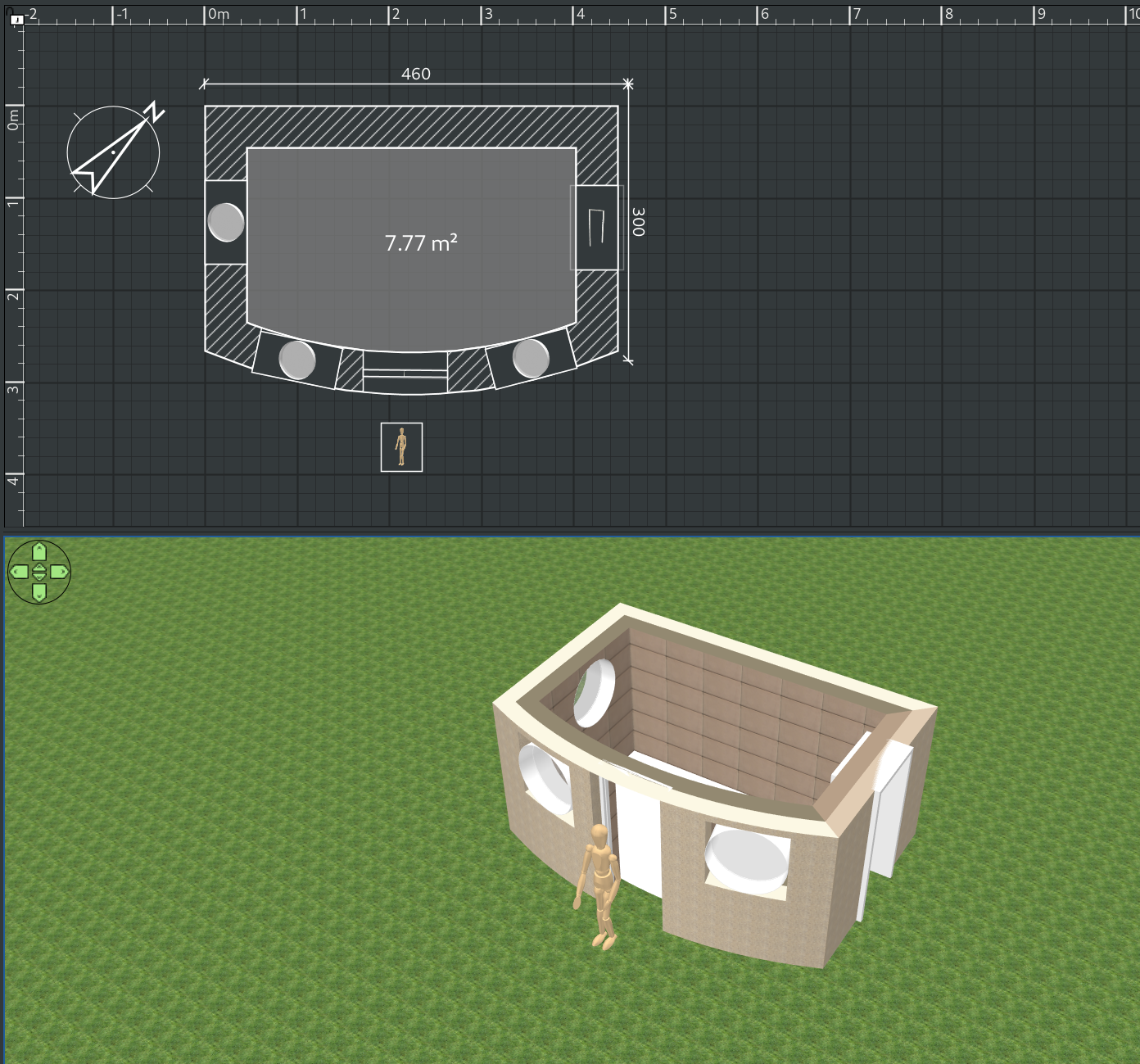

I've been following @ToughButterCup's thread with interest, as I'm just starting to put together a garden room. Thanks everyone for sharing so many interesting things there; my case is different enough that I figured a separate thread would be sensible. went on a straw bale building course in August and rather foolishly bought 100 bales to get building with before clearing the site or planning... well, anything, really. They're in the garage, which I'd quite like back! The site is cleared now and I've started digging with a vague plan, but I don't really know what I'm doing so I thought I'd see if anyone had any suggestions or criticisms.
The basic idea is a ~8sqm unheated, buildings-regs-exempt, planning-exempt room in the back of the garden, maximum height ~2.5M. Three square walls (4.6M long side along the wall, ~3M on the short sides), then a gentle curve on the side facing the house. The garden is a ~10Mx10M square, with a brick wall to the back, running northeast. I don't want to interfere with that wall much or rely on it for support, but I don't mind pushing on it (the level of the road behind it is a bit higher than the level of my garden, and there are a line of existing 2" plastic pipes for water coming from behind the wall. Only one intersects the wall; I'm planning to add a length of pipe to divert the water beyond the wall I'm building).
Straw bale construction is pretty lightweight compared to masonry (~160kg per linear metre of wall once rendered and plastered), and the resulting walls are nice and flexible - and thick, ~450mm. The straw generally wants to be kept ~300mm above ground level, though. The most northwesterly corner of the room has a high ground level compared to the rest of the site, with a ~4M high apple tree growing in it. The site slopes down both to the south and east; it's about a 140mm difference from NW to SE corner. To fit inside the 2.5M height restriction, I've already decided to minimise ground clearance for the straw in this corner - it won't get 300mm, I'll just belt on many types of water protection to compensate, and if that doesn't work, replace the straw there every few years ^^.
Fairly awful screenshot of a model to give pictures to those words:
The door and window placement is all very provisional, and, uh, I don't have much idea of what the roof is going to be like, other than "lightweight". Probably not flat, but whatever will work with the pitch I can get in 2.5M. Asphalt shingles on some lightweight rafters, perhaps. It's unheated, and I'm not planning to insulate the floor or roof much; the walls will be super-insulating, but I'm after the soundproofing more than that.
Since I'm building-regs-exempt, I don't want to overengineer the foundations - I just want them done so I can move on to the fun bits :D. At the same time, I don't want to be jacking up the whole structure in a few years to re-do them because I made bad decisions now.

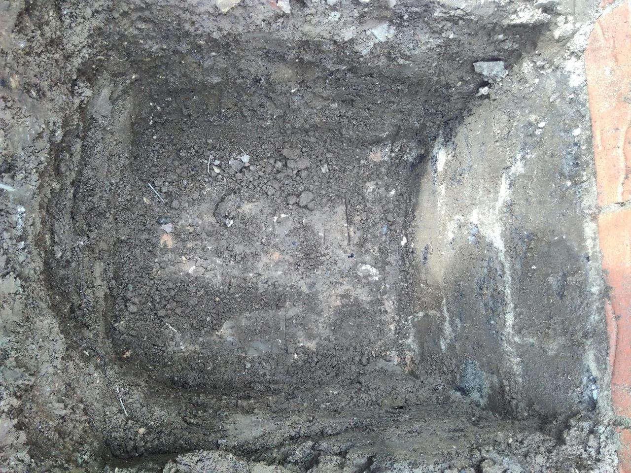

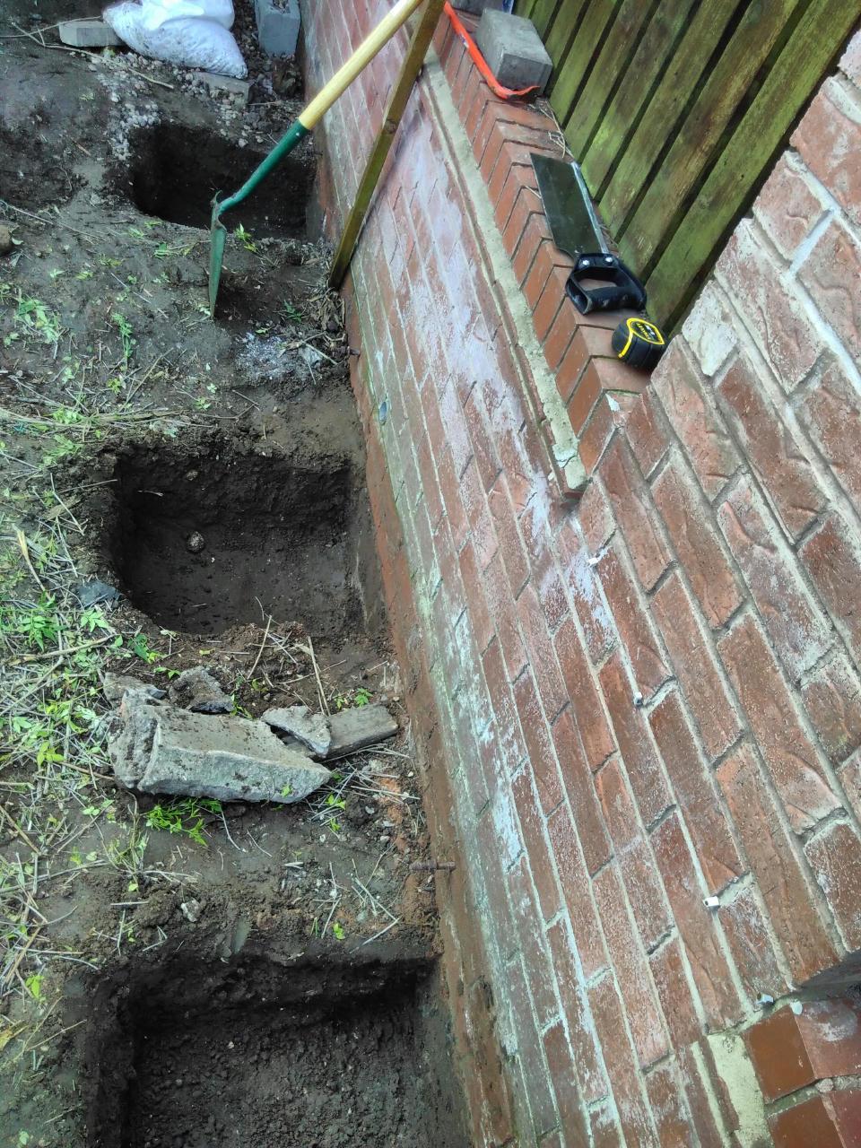

I've been digging along the back wall today, and here's where I've gotten to so far:
image_2023-09-15_16-37-30.thumb.jpg.c36cfb88c0a95d37f42bc2e46e7d344f.jpgimage_2023-09-15_15-43-01.thumb.jpg.235e374c7fd6fb310a6076e508f15e6d.jpg
I've aimed for ~500mm going from the ground level given by the NW corner. As I get further from that, they get shallower due to the slope, of course. The wall is, I think, two concrete blocks of foundation beneath the bricks, and probably poured concrete below that - I've not gotten quite that deep at any point.

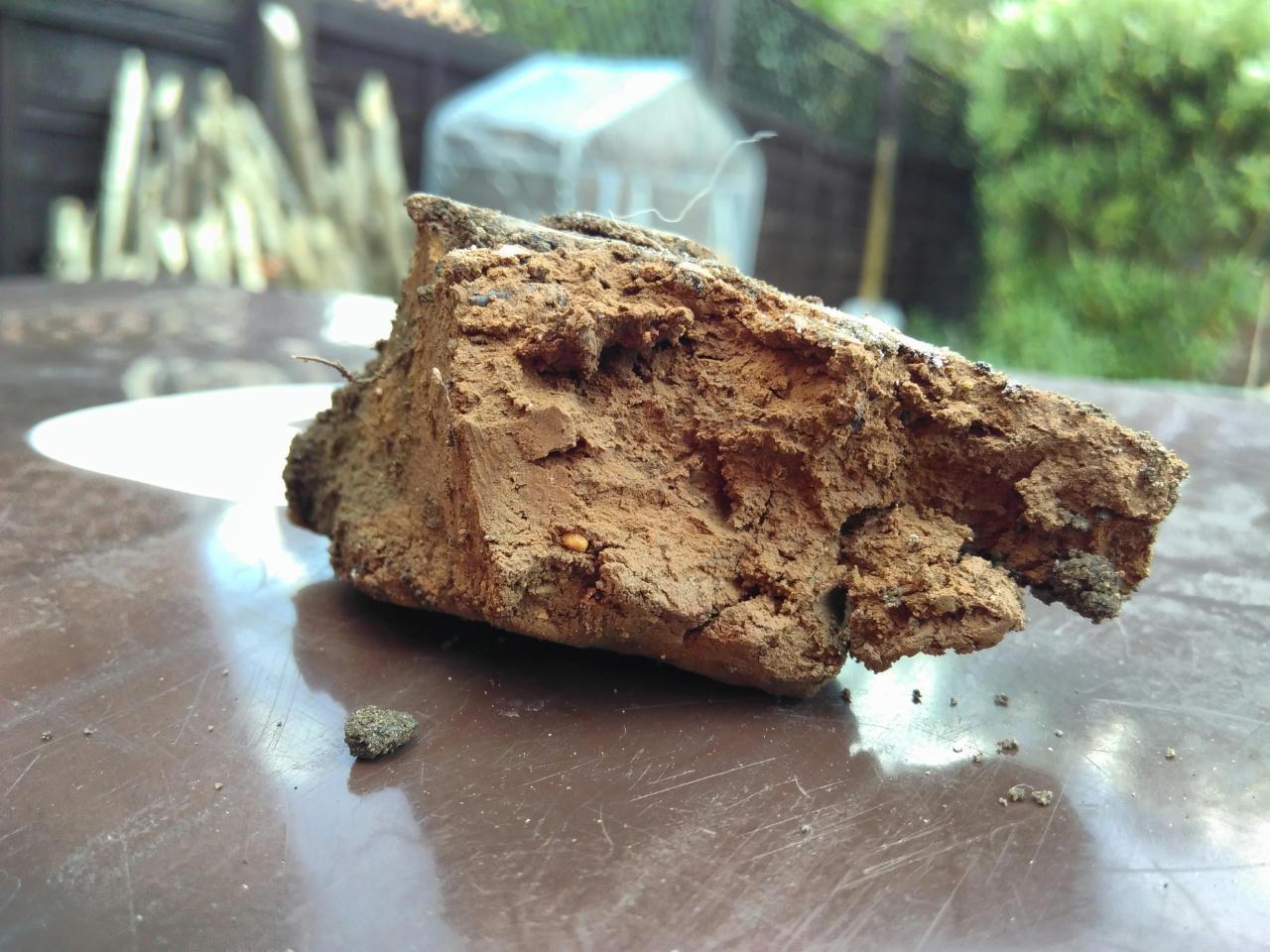

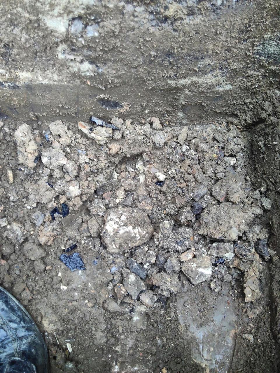

It's made ground with a lot of clay - these houses are built on an old brickworks that was filled in. My chances of finding undisturbed ground with a shovel are pretty minimal, I think (and there's no access for a mini digger). When it's dry, the surface gets cracks big enough to get your fingers in and becomes impossible to get through. Fortunately, we've had some rain so it's a lot softer right now, but going down even this far it really stiffens up again. There's lots of white stone mixed in, and I'm digging up nuggets of clay like this:
As far as I can tell it's "expansive clay", and before backfill the whole area was a "luvisol" soil type - so there'd be a fat shelf of clay at some consistent depth if it hadn't all been turned into bricks. I did a soil jar of the topsoil which had plenty of clay, but also a fair bit of silt and organic matter.
I did some tissue-paper calculations and I'm pretty confident the soil that's there has the bearing capacity for the structure - it's quite light and the pads are quite broad,so it's well spread. Say ~5 tonnes total for the structure and foundation materials, ~5kN. Spread across 10x500x500mm pads, 2.5sqm, gives 2kN/M², which compares very favourably against the numbers in the table here: http://environment.uwe.ac.uk/geocal/foundations/founbear.htm .
The biggest question I have right now is pad depth - would 500mm the way I'm calculating it be enough to minimise other movement (particularly frost heave) in this case, or should I be aiming deeper? 1M? 1.5M? The calculations for concrete trenches get a bit mad when you add clay and trees to the mix, but concrete is really not very tolerant of movement.

As I say, four holes dug so far. I figure I've got 6-10 left to do around the perimeter, depending on how curvy I decide to make it and whether I make the short sides more than 3M deep, and four to do internally to provide support for a suspended timber floor.

Interesting project, my first ideas on self building were in straw bale many years ago and i still think there is a place for them in house constructions. I too went on a couple of straw builds to get some hands on knowledge of the process. I would have thought angular gravel rather than pea gravel would be better for the founds as they bind and stabilise whereas pea gravel rolls around (used on arrestor beds for runaway lorry’s etc). Line  the holes with membrane to stop stone mixing with soil. You don’t mention finishing the straw bales, lime  render ? I will be following this thread with interest 👍

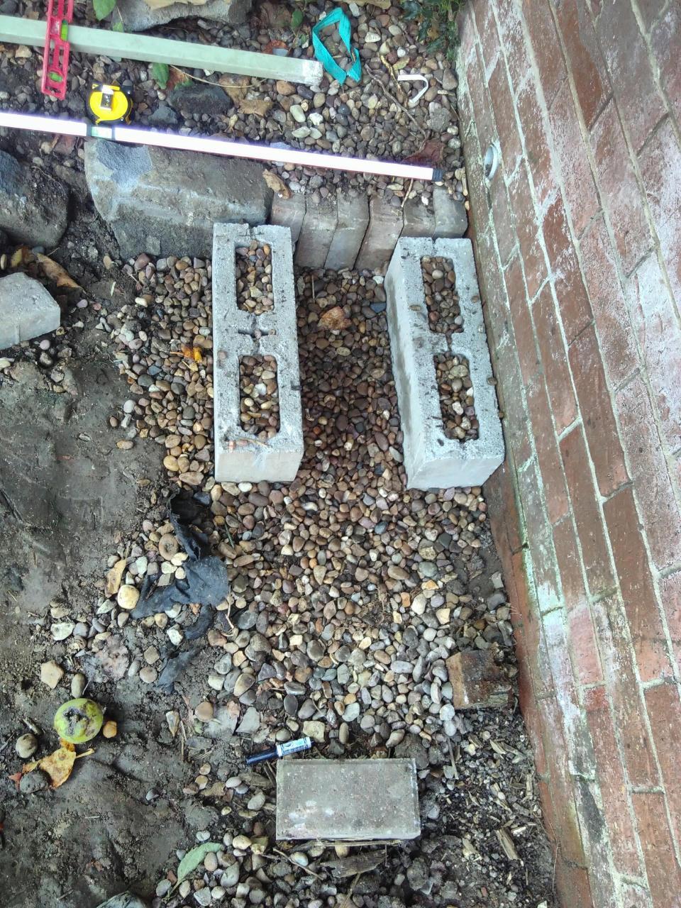

7 hours ago, PeterW said:
Turn blocks on their sides
Thanks, that makes a lot of sense now I stop to think about it. And there are 440x215x215 blocks I could use along the south part where everything is lower (so there's more height to make up). Lovely.
The pea gravel is just what I have lying around. Do you think it makes enough of a difference, once compacted, to be worth using angular instead? For the whole depth, or maybe I'd get the same benefits from just having a layer of it on top of the pea gravel?

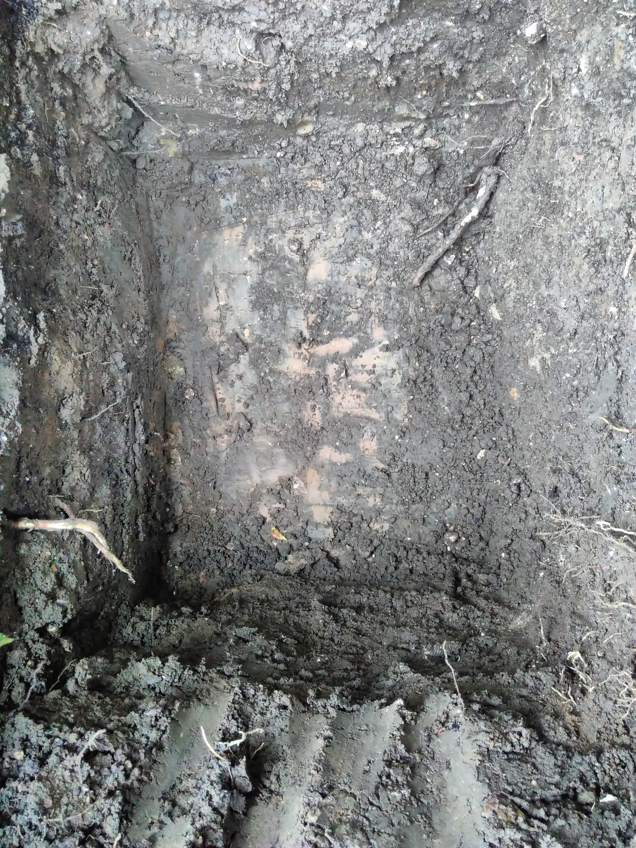

Overnight I decided to have a go at digging deeper, since the back four pits would be more difficult to access than any of the others in case it turned out they *needed* to be deeper. I'm glad I did - against expectations, I've found a lovely flat hard horizon at about 0.7M below ground level. It seems the brick wall goes at least four concrete blocks down, and I'm around the middle/bottom of the third one down at this point. At 0.5, I was still in topsoil 😬 .
My spade just bounces off this layer. I can dig into it with a pick - it's mostly compacted gravel, various other bits and pieces mixed in, a few whole bricks and so on. This depth must be fine. SURELY.
Mind you, this bottom 0.2M is easily as much work as the top 0.5.

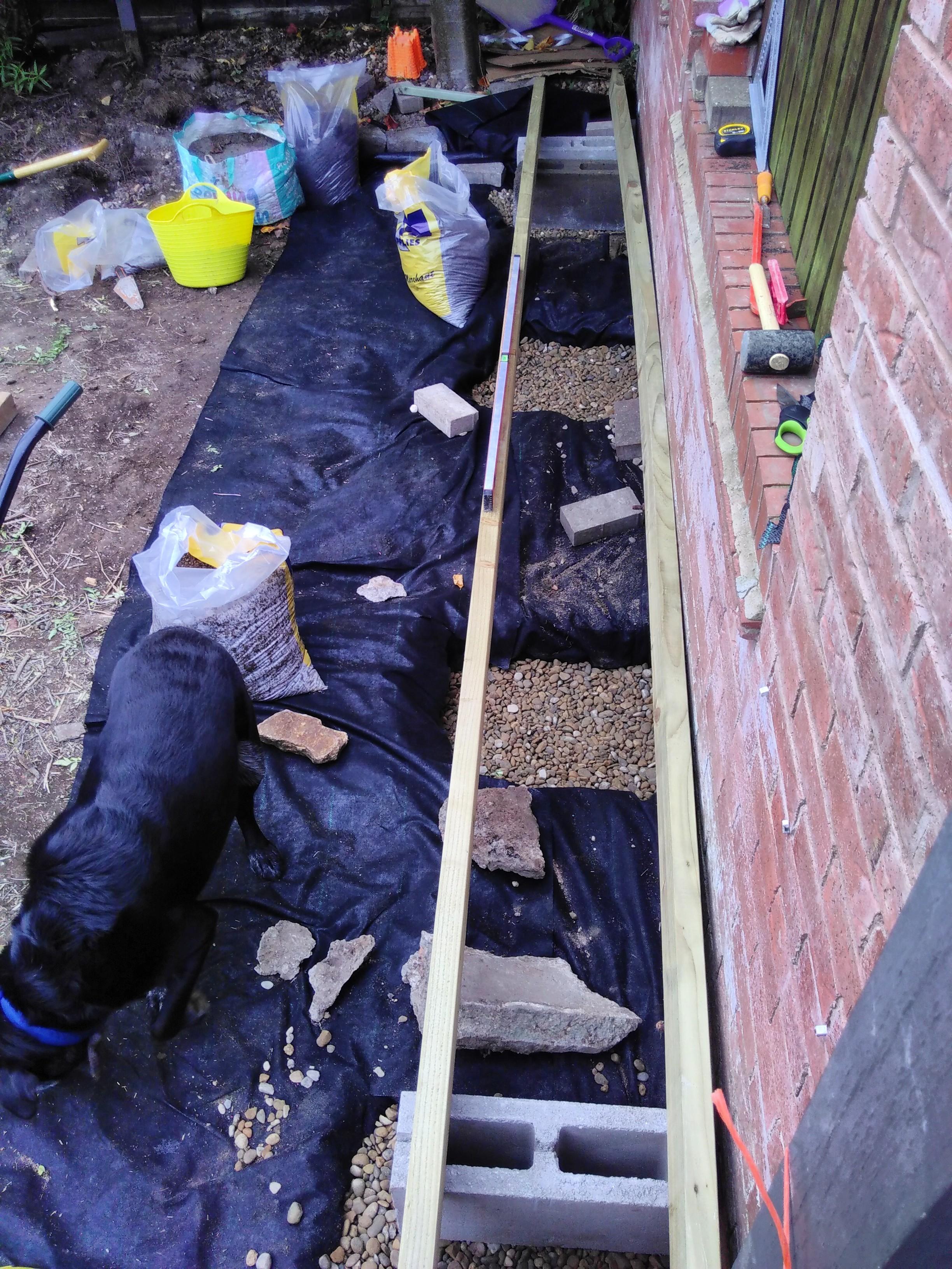

Onto a bit of progress -

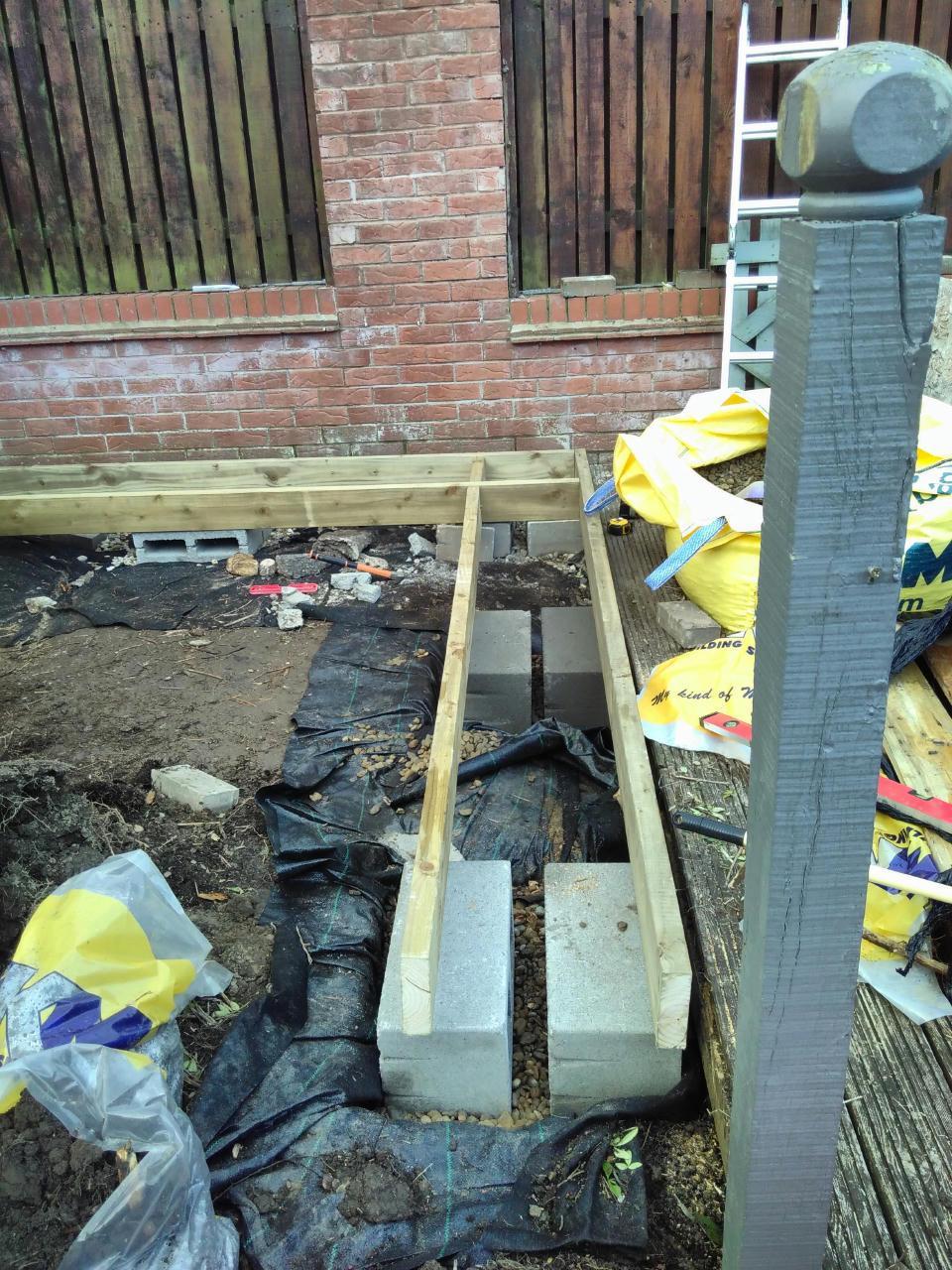

Hole number five, this one in the SW corner (so 3M closer to the house). No made ground here that I can see, just a smooth surface of very hard clay, gently sloping down towards the house. The ground is pretty saturated at the moment and the clayey topsoil is sticky and plastic, but I was pretty much bouncing off this layer. In theory, I'll be digging another hole a bit like this in spring to gather material for the internal clay plaster. A bulk bag of the stuff is £600!
Here I'm just filling the other four holes with gravel and compacting it down. Still haven't laid the blocks on their sides, but that will come once I get my "L" shape together, which is one pit away. I've gotten some 440x215x215 blocks and should be able to get a decent level by varying the amount of pea gravel in each hole and using different heights of block.
This timber is 100x50mm C16, and not strong enough to span the 1M gap between piers according to a random timber calculator. Instead, I've got some 150x47 C24 which the same calculator is happy with. Butt join, 450mm wide, more or less following the "box beam" strawworks detail.
I'm currently umm-ing and aa-ing over whether it needs OSB3 top and bottom for the box part of the box beam. Presumably it adds significantly to rigidity against lateral loads, and it gives a space that can be insulated (for this space, the acoustic, rather than thermal, insulation is the important bit), but not much to vertical loading? The sheets aren't cheap, and need a bunch of precise cutting, then gluing and nailing, so it's a saver if I can skip it. Fortunately, I've got plenty of time and a mock-up to run through before that decision needs to be finalised.
Well done for giving this a go, thanks for posting as very interesting.
Fair enough the walls are light in weight and I assume so will be the roof. How are you going to tie it down to stop the roof and walls lifting up in the wind? Are you going to use the long spikes to pin the roof wall plate down a good bit into the bales?
Bit of house keeping on the maths mainly for all in case they use the same sums.
5 tonnes =  5000kg. Convert to Newtons 5000 x 9.81 (just say 10) / 1000 = 50 kN (not 5). If you have 2.5m^2 of pad area then roughly the pressure at the bottom of the pad will be 50 / 2.5 = 20 kN/m^2.
If it is a temporary structure (say snow loading with a return period of 20 years as a ball park figure add some 0.35 kN/m^2 to the roof loading unless you are at a high altitude UK wise.
A good bit of that soil you see next to the wall will be backfill (made ground).. ask how are the founds for the retaining wall formed. How far do they protrude into your garden? Is the soil you see just well compacted fill?
The main thing here to watch out for is that if you are digging next to a retaining wall is that they are designed for two main things. One that they don't tip over and two that they don't slide into your garden. The sliding is important here. The sliding forces are resisted often by the friction under the found and also by the soil on your side and this can make a big contribution towards sliding resistance. I would avoid disturbing more of the soil close to the wall on your side or lowering the ground level on your side close to the retaining wall.
I would give the OSB a swerve as I have my doubts about it performing well in this application.. it is thin and you have fixing issues.. and any long term moisture is not good for it. What about using cheep fencing slats with some 3 -5 mm gap between that are treated, these are more breathable than say OSB? Anyway it keeps the ethos of using more natural rather than highly process materials (lots of glue) such as OSB. If you have doubts get a bit of OSB and leave it out in the rain / in a bucket of water for a while and see what happens to it.
As the thing is light weight how are you going to stop it blowing over sideways in the plane of the retaining wall? I assume you are going to make the roof like a stiff beam that transfers the sideways wind load to the rear wall?
In high winds you could easily get 100 kg/m^2 wind uplift on the roof unless you live in a very sheltered spot. At the same time you get the wind blowing on the sides of the building wanting to push / suck it over sideways.
I think it is these wind stability issues you need to concentrate on rather than the founds, although they are important.. settlement won't generaly hurt anyone (unless left unchecked) where as the thing collapsing or bits blowing off and hitting folk in the wind is a concern.

I did read and appreciate your thread on that, and there is a box beam detail using timber i-joists: https://strawworks.co.uk/wp-content/uploads/2021/08/05-02-Floor-plate-structural-box-beam-details-with-timber-i-joists.pdf . Thought of going this for, ooh, at least 30 seconds before deciding it was over-complicating things ^^.
The roof gets attached to the roofplate with regular fixings, it's just wood->wood. That's both pinned with hazel spikes going into the bales, and held to the bales and floorplate with packing straps. What we did on the course was squash this whole sandwich of baseplate, straw, roofplate, together with trucker's straps, then used packing tape to keep the compression in place. There are also timbers running the full height of the wall to act as posts for the door and window frames. They're not structural, in the sense that the walls support the roof even if they're not there, but they get tied to baseplate (and box beam) and roofplate, so help to hold the whole thing together.
How to attach the whole thing to the foundations is a bit more of a question. I was planning on using more of the packing straps to hold the baseplate to the concrete blocks, which adds ~280kg to the overall weight of the structure, but they're just sat on the pea gravel with nothing holding the whole thing down. I was thinking about driving a metal or timber support down and tying that to the blocks, but only vaguely so far. I suppose the friction forces could be calculated and compared to the wind loading, but...
Ooof. Thanks for checking my maths here, it's really never been my strong point, but that's a pretty awful fail. I'm still well in range for hard clay soil, at least. You had me hastily re-checking my timber beam calculations, but I don't seem to have made the same mistake there, which is fortunate as I didn't have anywhere near as much margin while cheaping out on the timber!

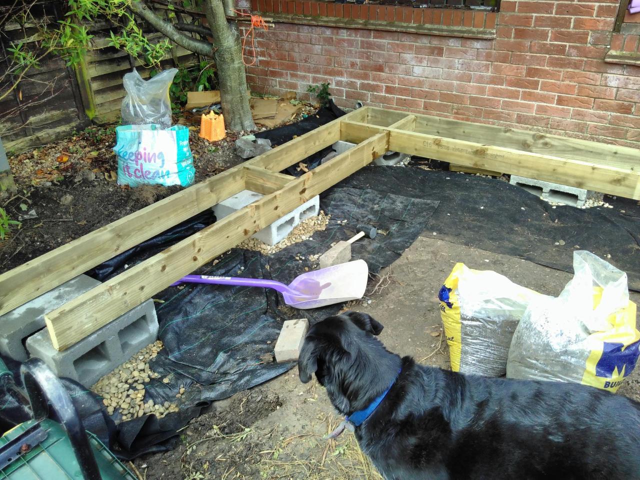

A bit more progress - I have (some of) a structural box beam on top of piers \o/
image_2023-09-22_15-38-56.thumb.jpg.4ab6e4c5f6d0bf0504d76ff79e7ccb34.jpgimage_2023-09-23_17-20-29.thumb.jpg.c10cac1103f83b212cf7b5fda30c0489.jpg
Still got a fair bit of levelling to do (might cheat with some packing sheets), noggins to put in over the piers, and prep for the vertical beams the doors and windows will be attached to. The positions of those are pretty much finalised now - where they were in the original plan, but minus the two additional windows on the curved section. The doors I've got lying around are half-glazed, so I reckon there'll be enough light without those - and if it's not, I could always add a rooflight.
I also need to get that final, curved side in (two more holes to dig!) To do that, I'm just going to attach straight beams at a 15° angle going out to each of the middle piers, then straight over the central gap. That seems like it'll do the job with only the tiniest bit of overhang here and there, which isn't a problem - the finishes will overhang the beam too.
So much easier than trying to make glulam beams out of ply 😅.

1 hour ago, TonyT said:
What are those strange to me at least blocks with holes in them?
These are hollow blocks. I've not seen that small  size  recently.
It saves concrete and sometimes cost, lighter to handle,  and allows for the addition of reinforcement in a wall.
Also quite a lot weaker so maybe not a great idea as shown here.
Link to comment
Share on other sites
They're rated for 7.3N/mm², although I don't know if that's in both orientations or just the voids-vertical one. Easy to break in half with a hammer through the thin walls, anyway (I needed a few halves). I wasn't really thinking about the possibility of them failing, but none of the timbers happen to be placed only above the void space - the weight is always spread across some of the solid bits.
Originally they were placed with the voids running top-bottom, but another poster upthread suggested this orientation and I like it for being able to easily strap them to the wood. There were solid concrete "foundation blocks" I could have gotten instead, but I quite like these in this application. Real stone would have been better, but isn't £2.50/piece ^^.
Link to comment
I'm pretty sure that is only when upright. I wouldnt be happy with these and would fill the voids with drypack concrete, though that completely defeats the object of saving concrete.
Otherwise, it probably won't fall down,  and if it did, the bales will crumple and stay standing.
It's your experiment.

2 hours ago, saveasteading said:
I wouldnt be happy with these and would fill the voids with drypack concrete [...] It's your experiment
It is, but I'm here for advice and I'm trying to take things people say into account ^^.. Just spent a bit reading about cars and boats crushing these things when laid side-on, which is sobering. I'll flip them upright, re-level, then strap through them vertically. It's not that much harder. Thanks for bringing it up!

On the hollow blocks. Upright will be much better. If not too much hassle or cost, can you fill them with gravel?. I couldn't prove any improvement but it would add some stability, especially at any weak points ( which these blocks sometimes have), and would increase the bearing surface if the timber, spreading the load.
