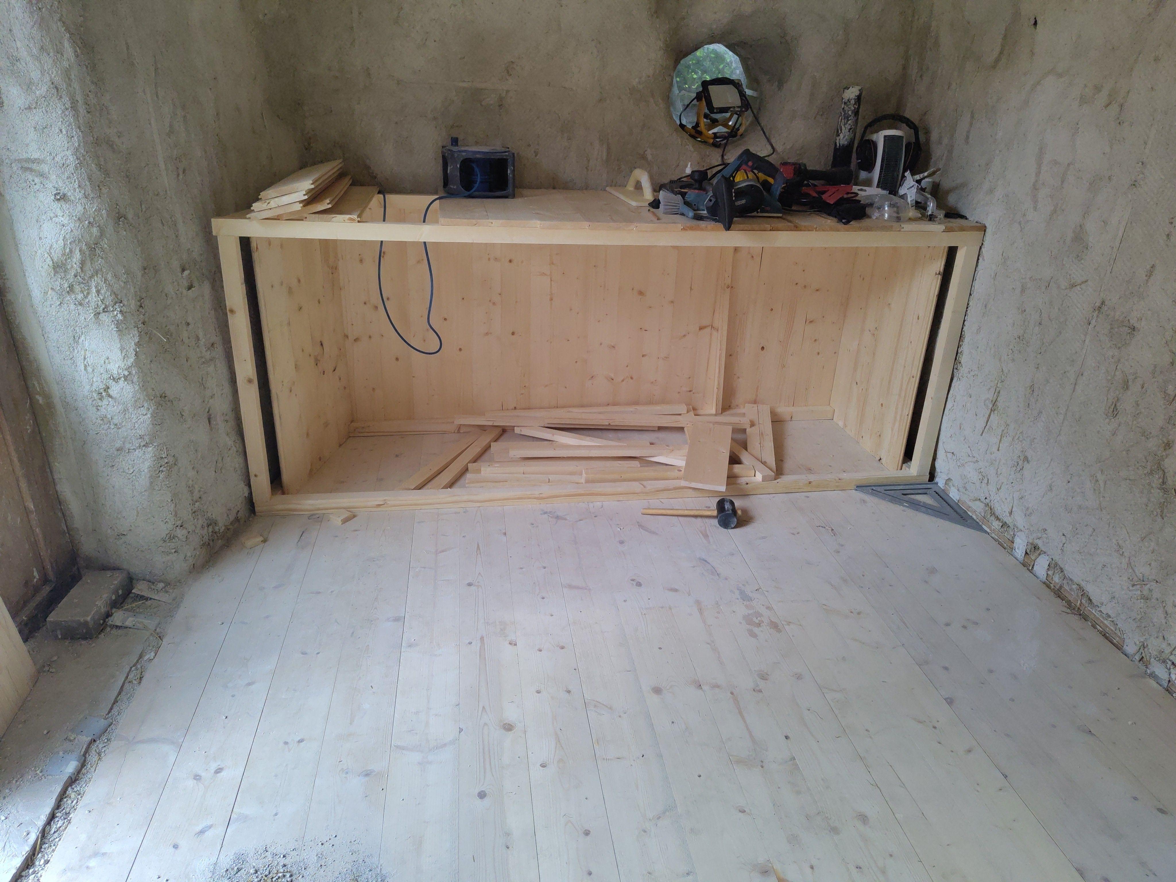

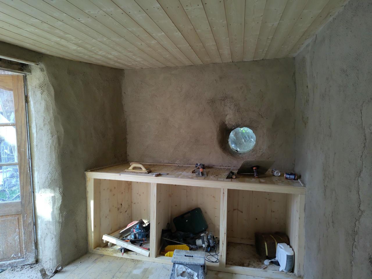

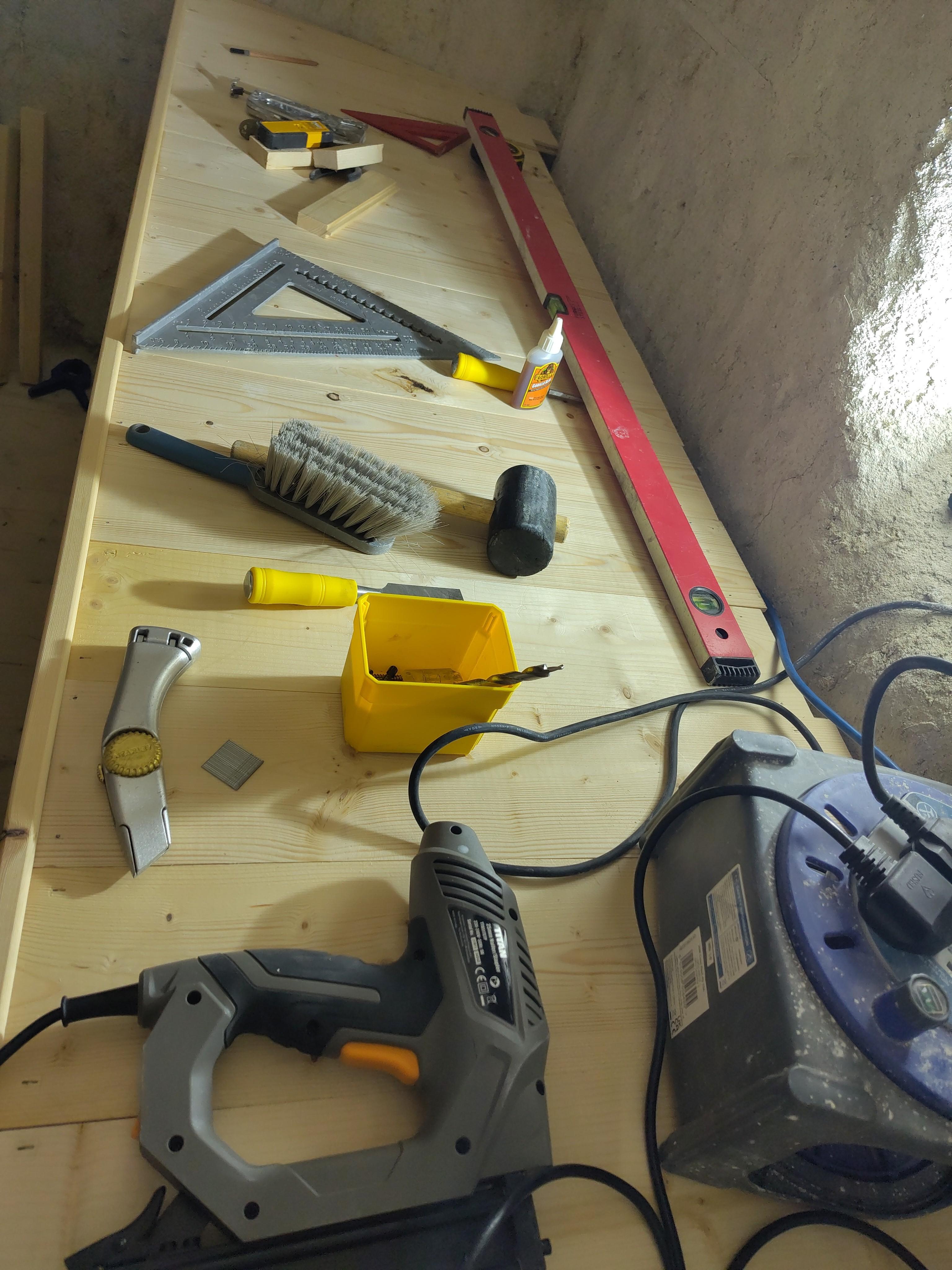

I'm having a break from the lime render before starting the next coat. Decided to convert a bunch of offcuts from the ceiling and floor into a unit running the length of the round window wall. I can screw it to the floor joists and render right up to it, to make it integrated AF. Leaving the render behind it just basecoated will save me some too.
I had to buy some 2x1 and 2x2 to make a frame to hang everything off, and all I could get on a Saturday afternoon was rough-sawn from b&q, so I got to play with an electric planer too.
Progress so far... well... it's a pine box ^^. Don't stand on it yet. I'm planning to divide it into three compartments with panels made out of planks surrounded by 2x1, which will make it a bit sturdier. The perimeter is all 2x2. I was going to have a go at mortise and tenon joints, but chickened out and am just using lots of glue and pocket screws.
I guess I'll need trim pieces on the front, and some jiggery-pokery to get the wood closer to the lime. The sink will be in the corner closest to the door - probably a counter-top one, to minimise holes through the worktop, with a couple more bits of 2x2 to support it underneath. Then a couple of sockets in each of the other compartments. Cables and pipes will come through from the back.
Doors? I guess? They'll have to be flush with the trim, the floorboard offcuts being used for the worktop aren't long enough to give me a decent overhang ^^. Each compartment will be about 7000mm wide at the front, so 2x 350mm doors? I don't have any wood for them yet.
I need wood for shelves too. I've got some old decking boards that were going to be the floor; maybe they'd look alright, planed up a bit.

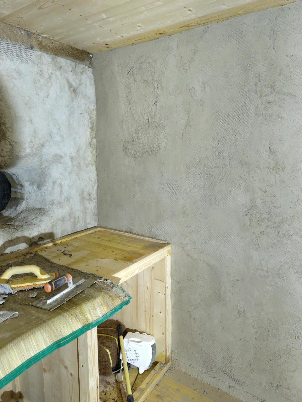

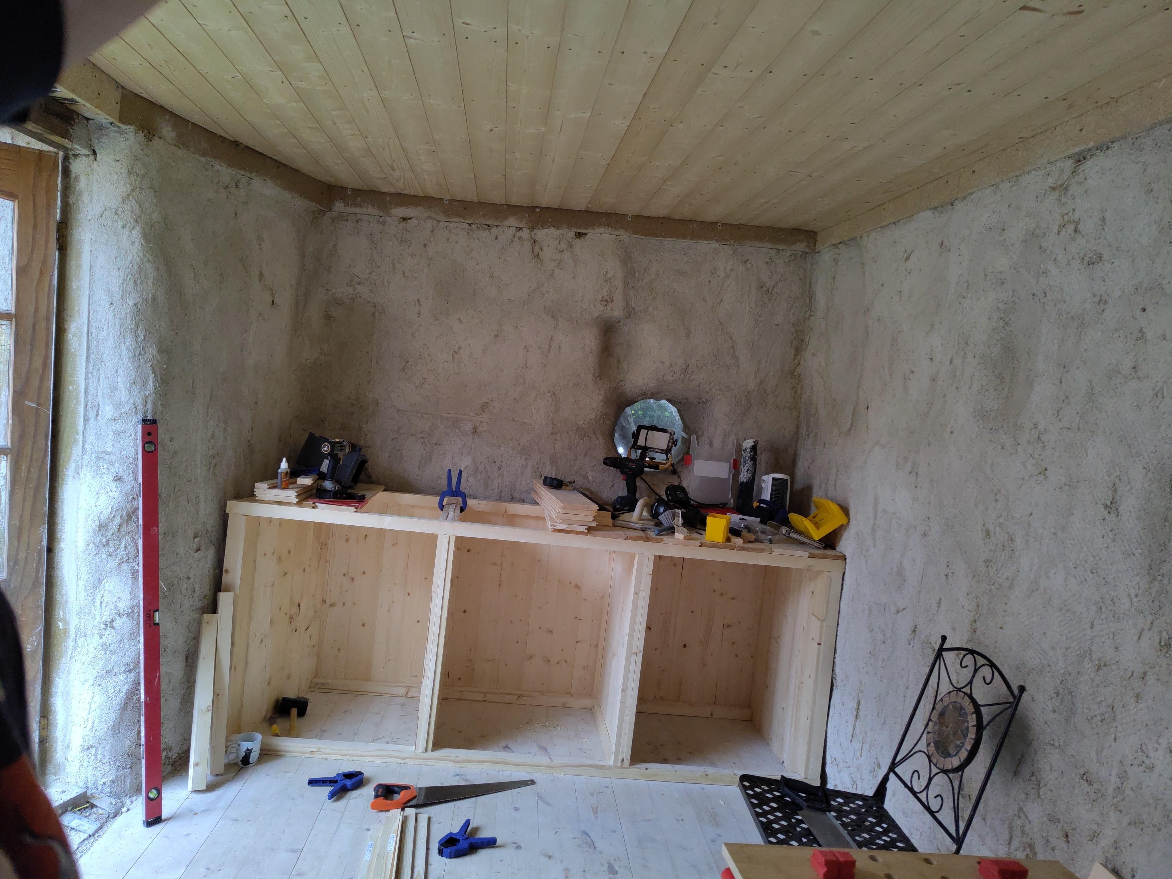

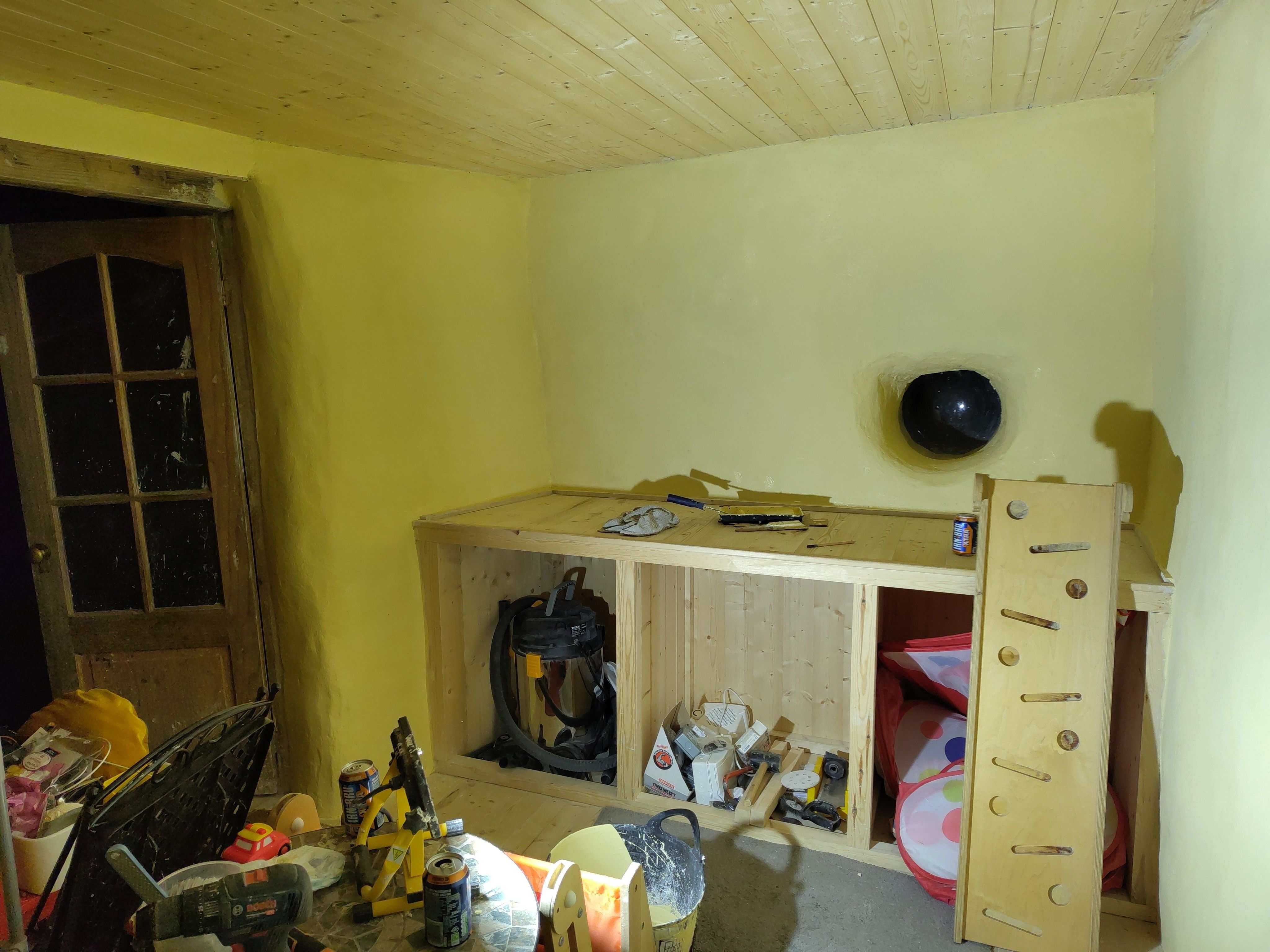

OK, unit finished except for shelves, doors and trim. Sink is arriving tomorrow, so I get to start fitting services soon. I figure I'll make them all temporary and pluggable until I can dig a trench and get a Real Electrician™ out for that side of things.

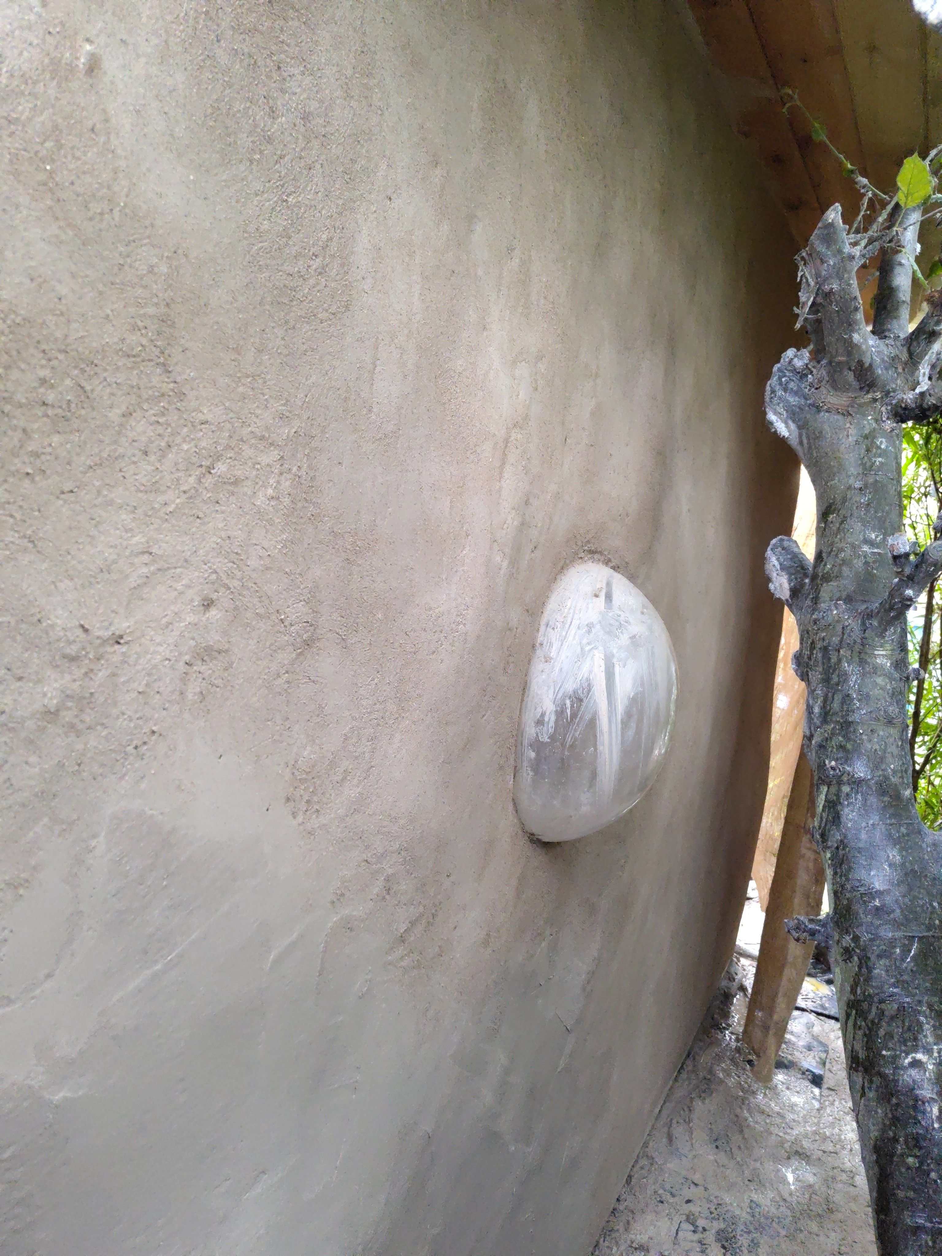

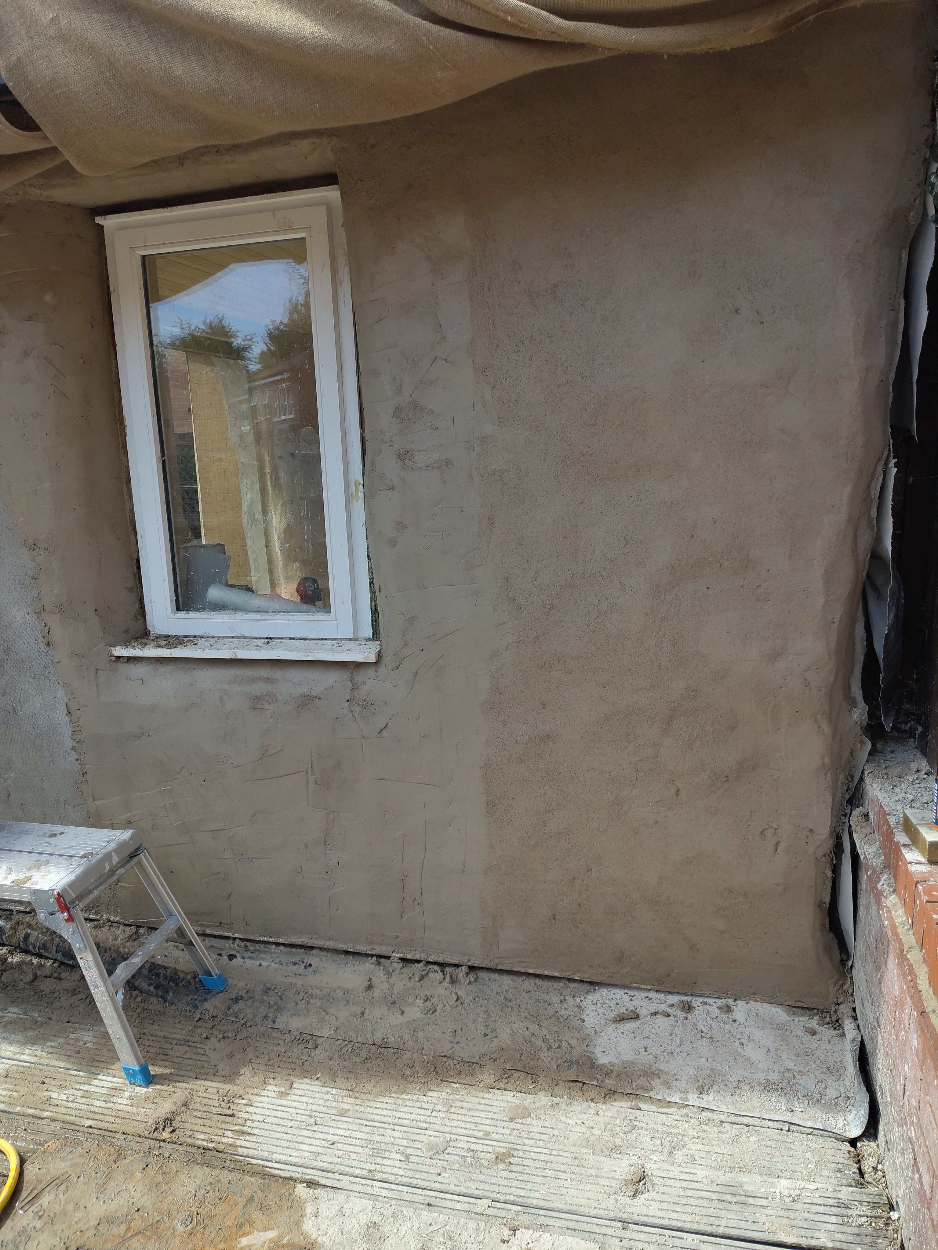

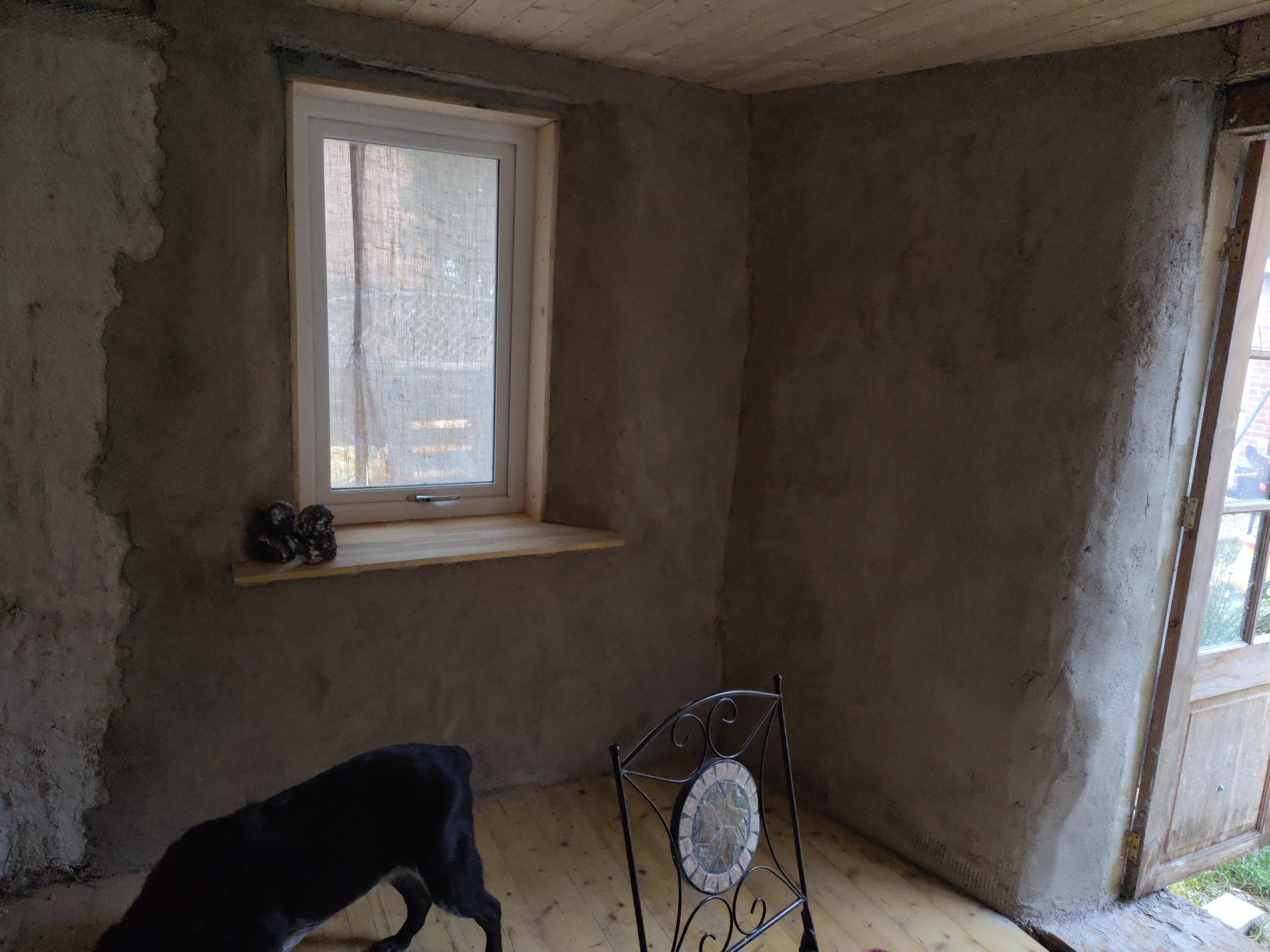

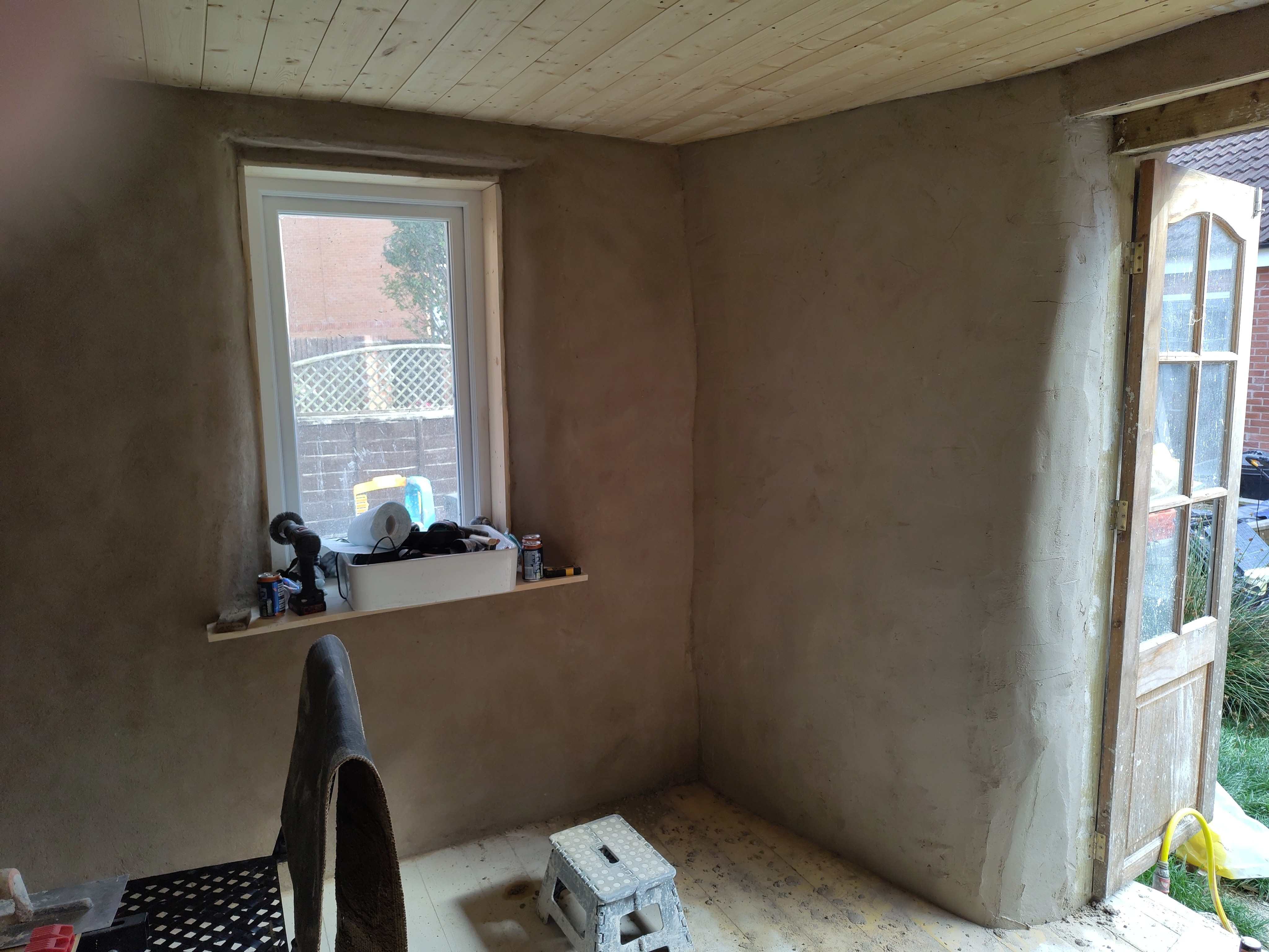

Got a second coat on the east wall, and it's looking much better than I expected it to. It still undulates, but most of the smaller-scale variation is just... gone. Trowelling it on is much harder and slower than slapping it on with my hands though ^^. One bag went pretty far; the remaining seven ought to be enough to finish this coat everywhere, but I'll definitely need more for the final coat.
Edited by Nick Thomas
Another bag down. Managed to destroy my foot somehow doing this, so I'm out of action for a bit now. Tendonitis or something? From going up and down the ladder in stupid shoes? Sigh.

Back in action. Finished the second coat outside, and got started on the inside today.

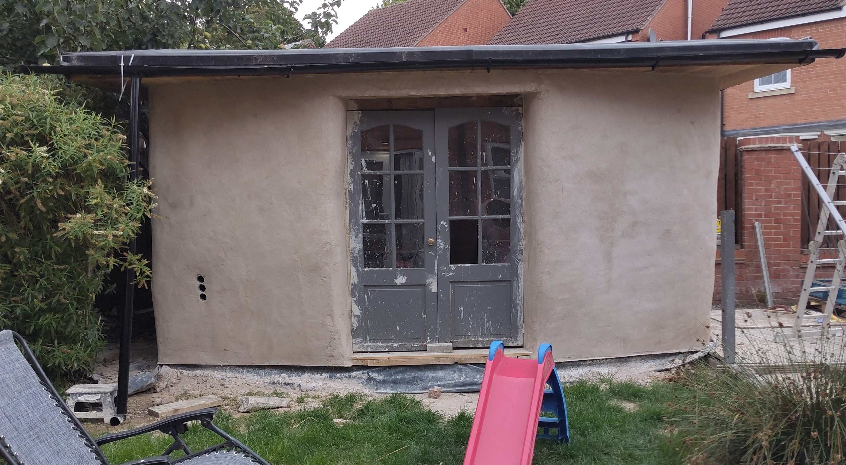

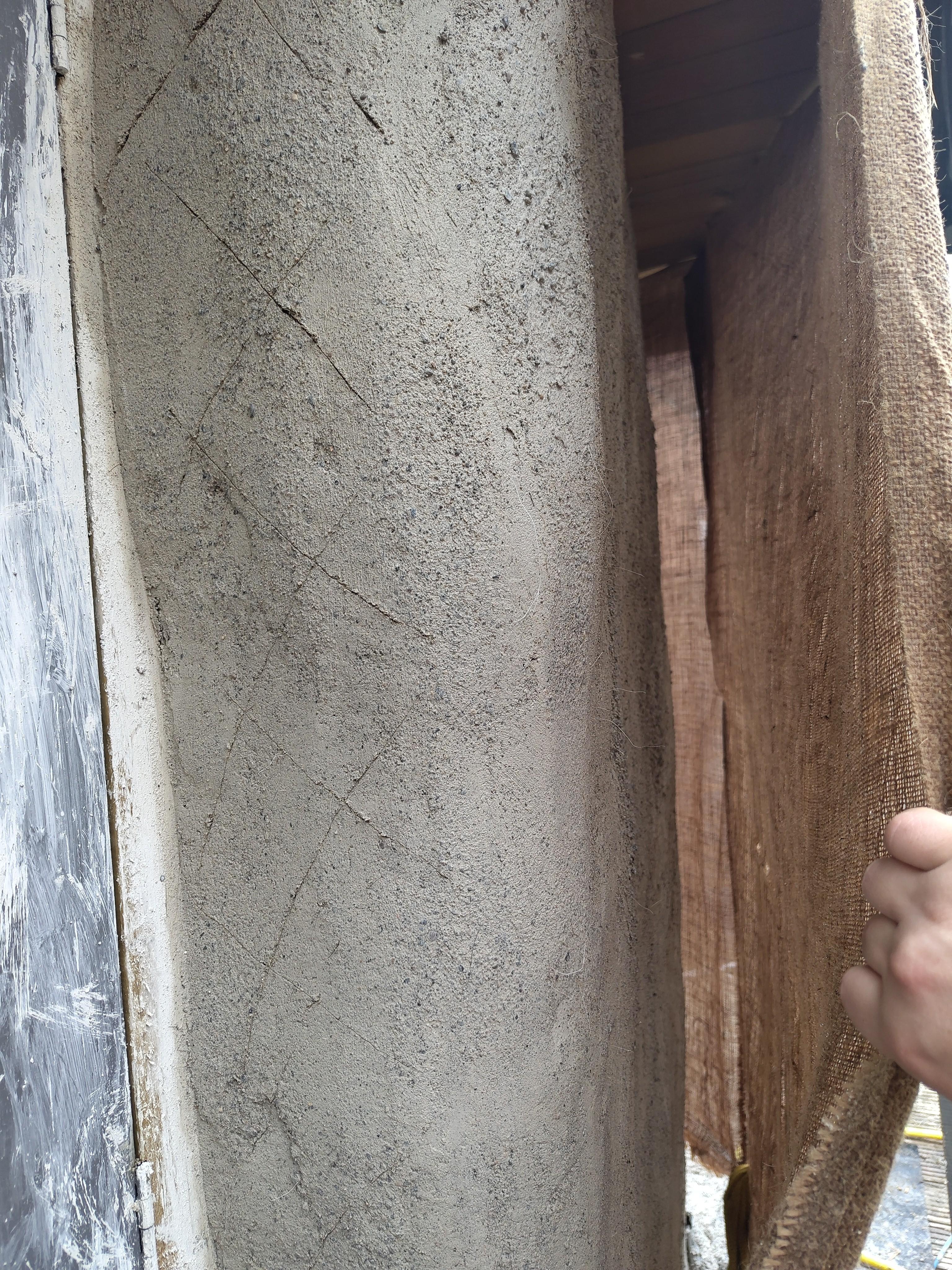

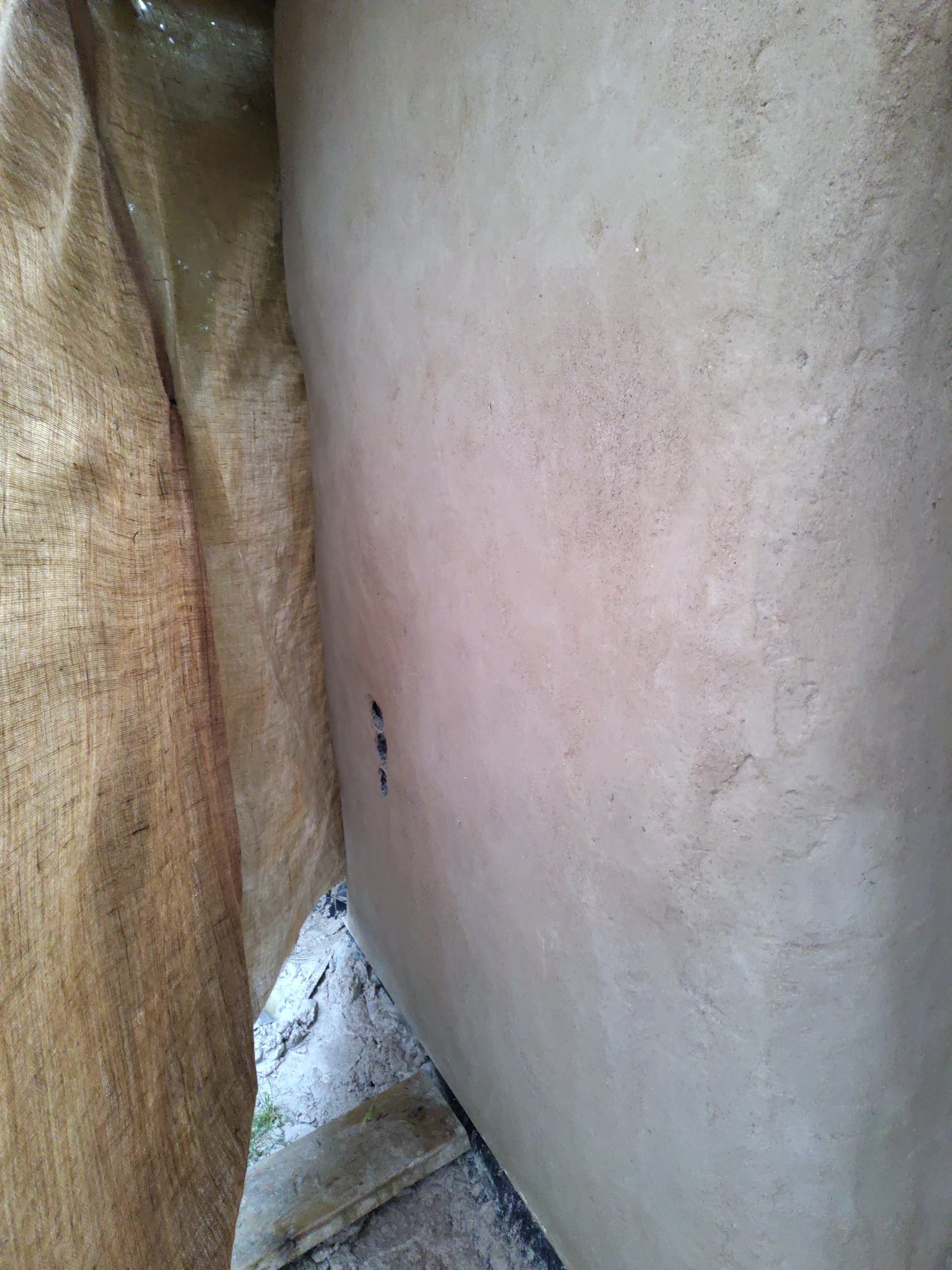

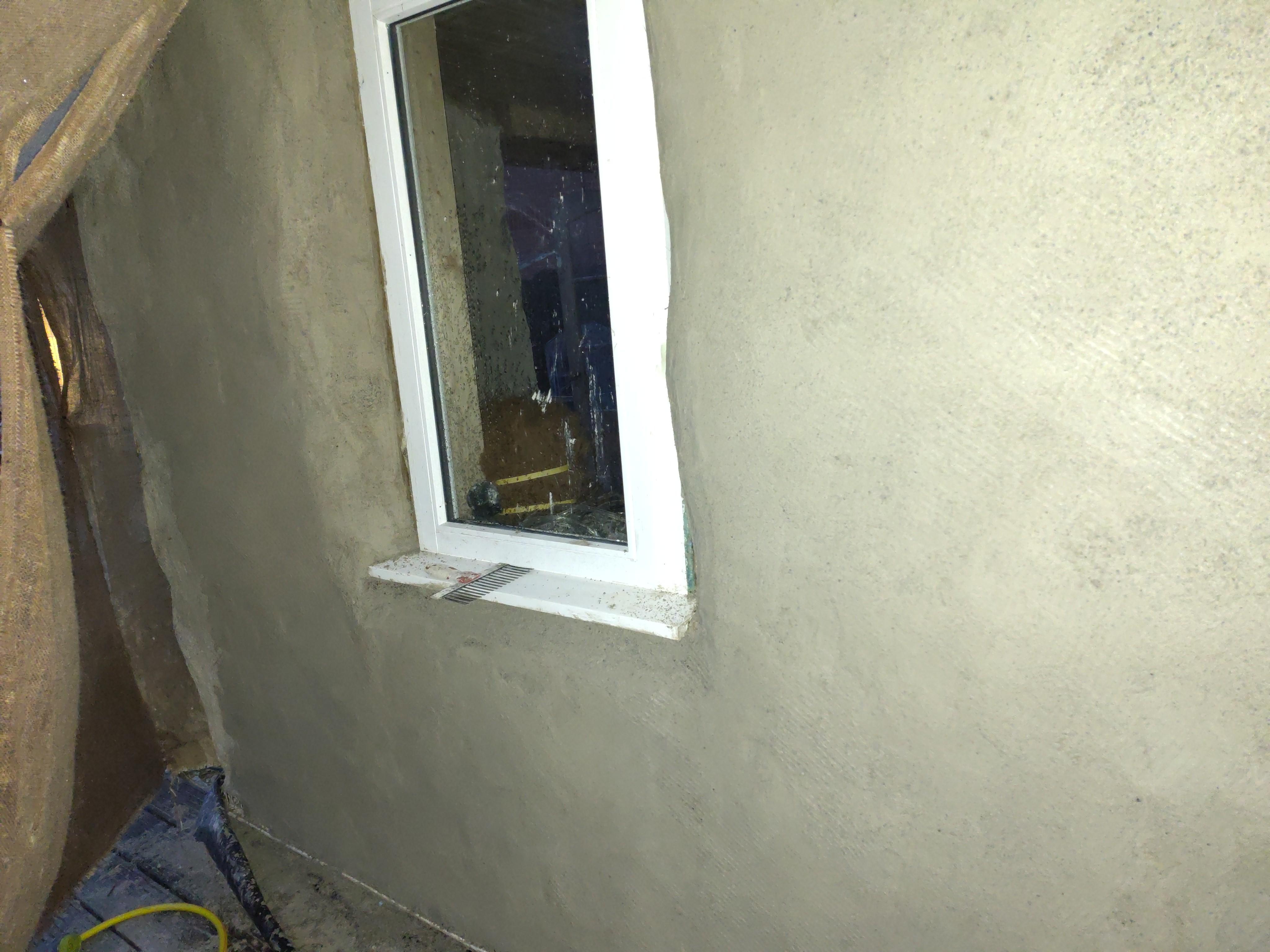

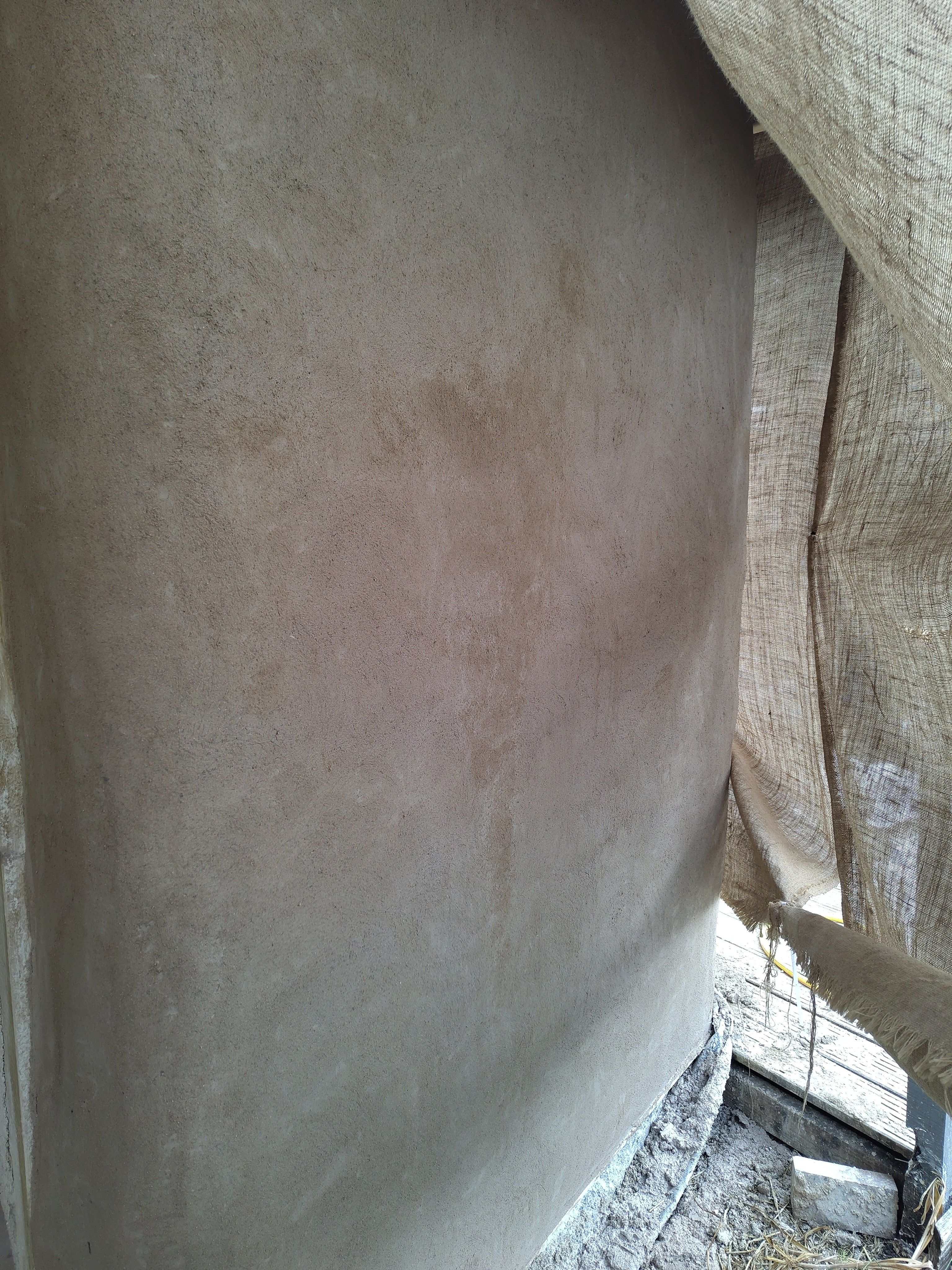

This is actually working \o/

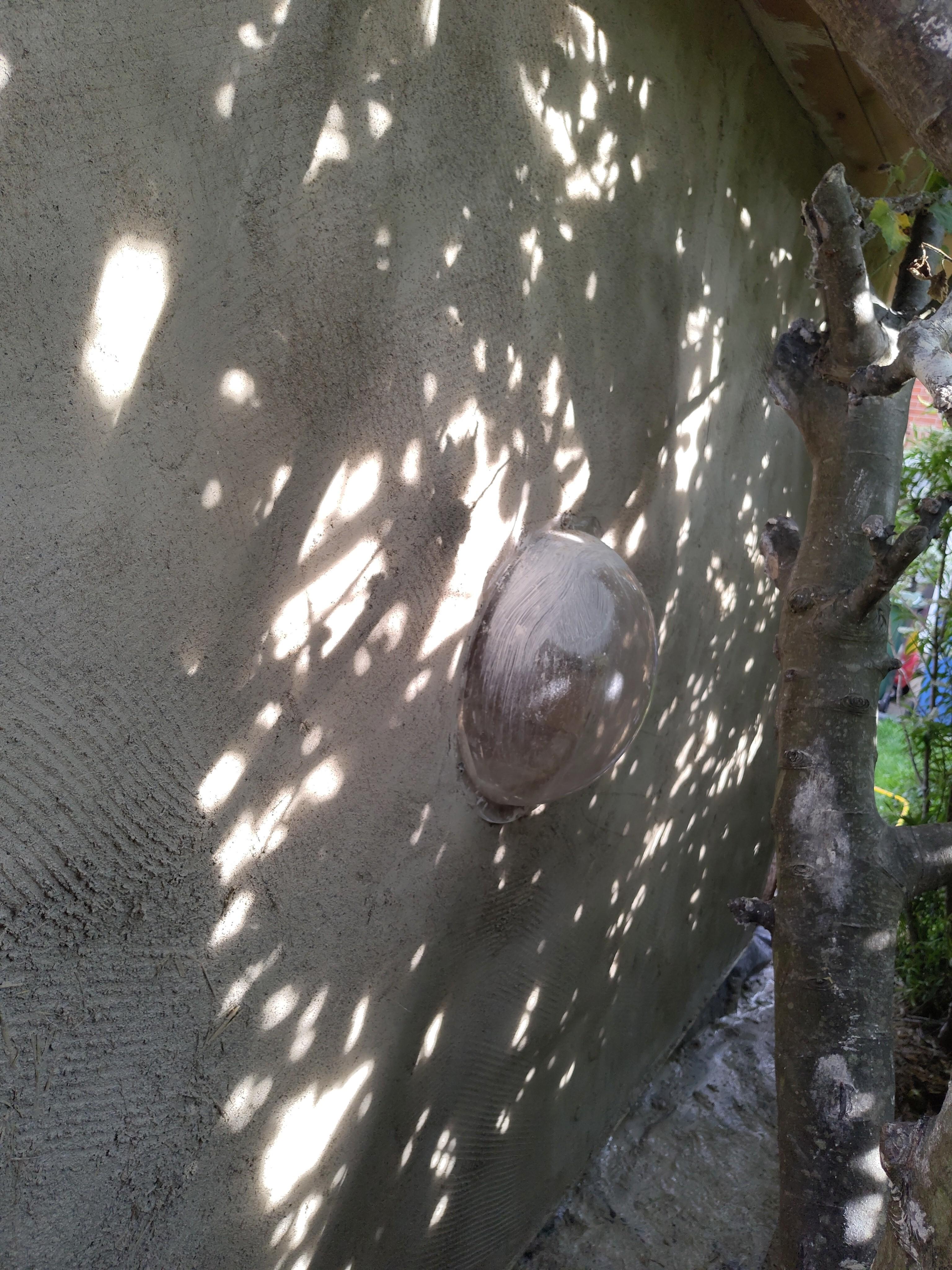

(Right hand side is rubbed up, left hand side is not). Managed to get two bags on in one day yesterday, right the way up to the door at the front. The finer sand really aids workability, although it's not *great* stuff, there are some big pebbles in it, and a little bit of sharp glass. Found some charcoal as well? Still, 3 more long days of this and I should be finished.
A few hairline cracks have shown up, especially in the very first section, where I think I put it on a bit thick. So far they've all rubbed out without issue. Limewash apparently helps to heal them as well, once it's time for that. Or I can always cut bits out and re-do, but hopefully it won't come to that.
Still not level, obviously.

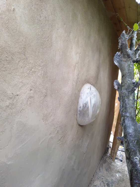

Got there in the end. A break from rendering to let the hands heal from lime burns (d'oh) is in order before the final coat inside. Plenty of other stuff to do though.
It's going to be great to take the hessian down in a week or so, although I've got one awkward set of neighbours who have already telegraphed that they're going to hate it (and hate everything already done; and hate that I replaced a rotten pergola with a huge viney beast straddling it with a modest building). They've been out measuring, bless 'em, but it's definitely <2.5M. Fortunately, the other neighbours range from indifferent to fascinated.

Yeah, OK. That looks decent enough to me. It'll scrub up nicely.
The drainpipe is temporary, eventually it'll come in under the overhang via 92.5' elbows and run down close to the wall.

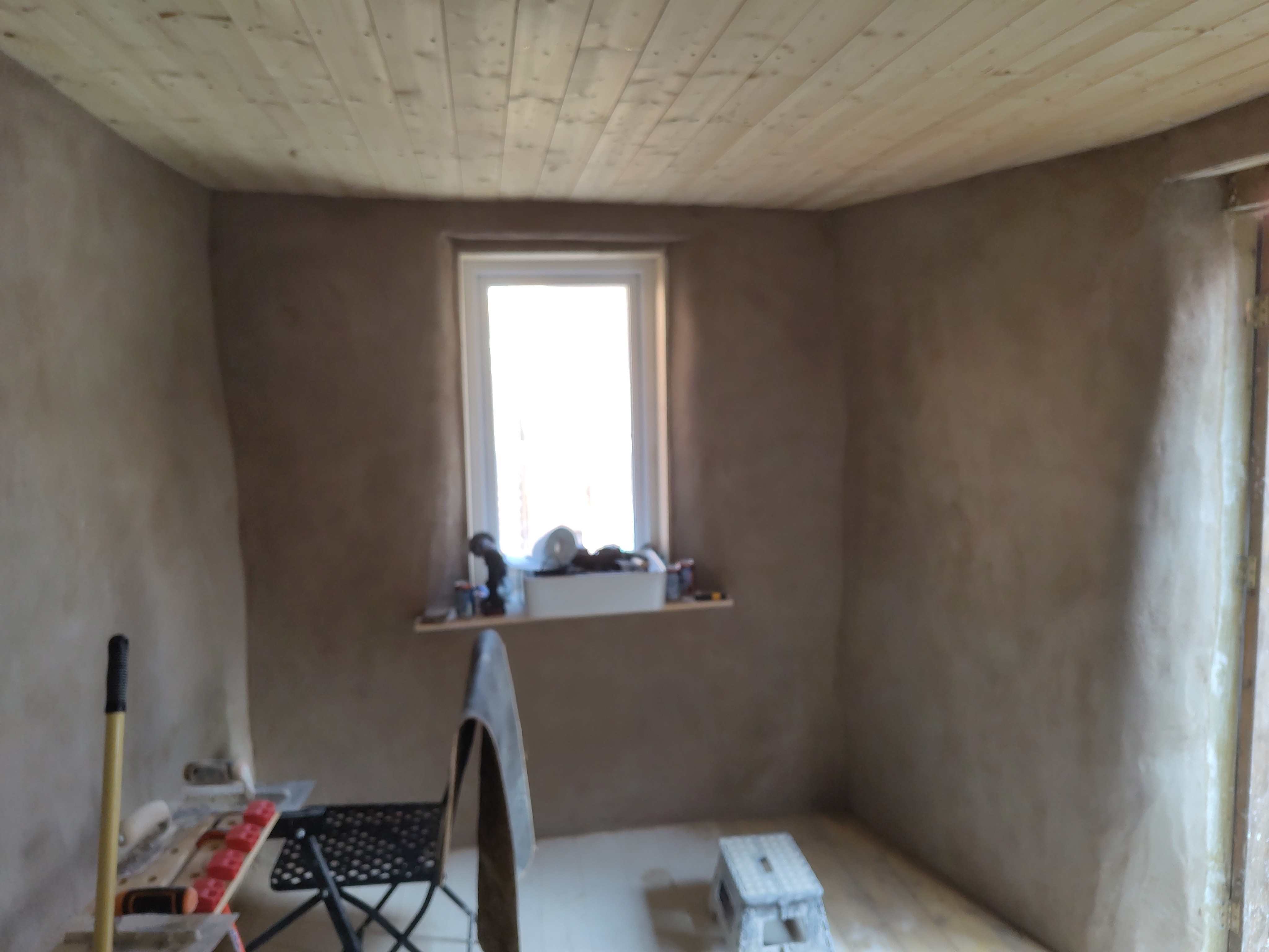

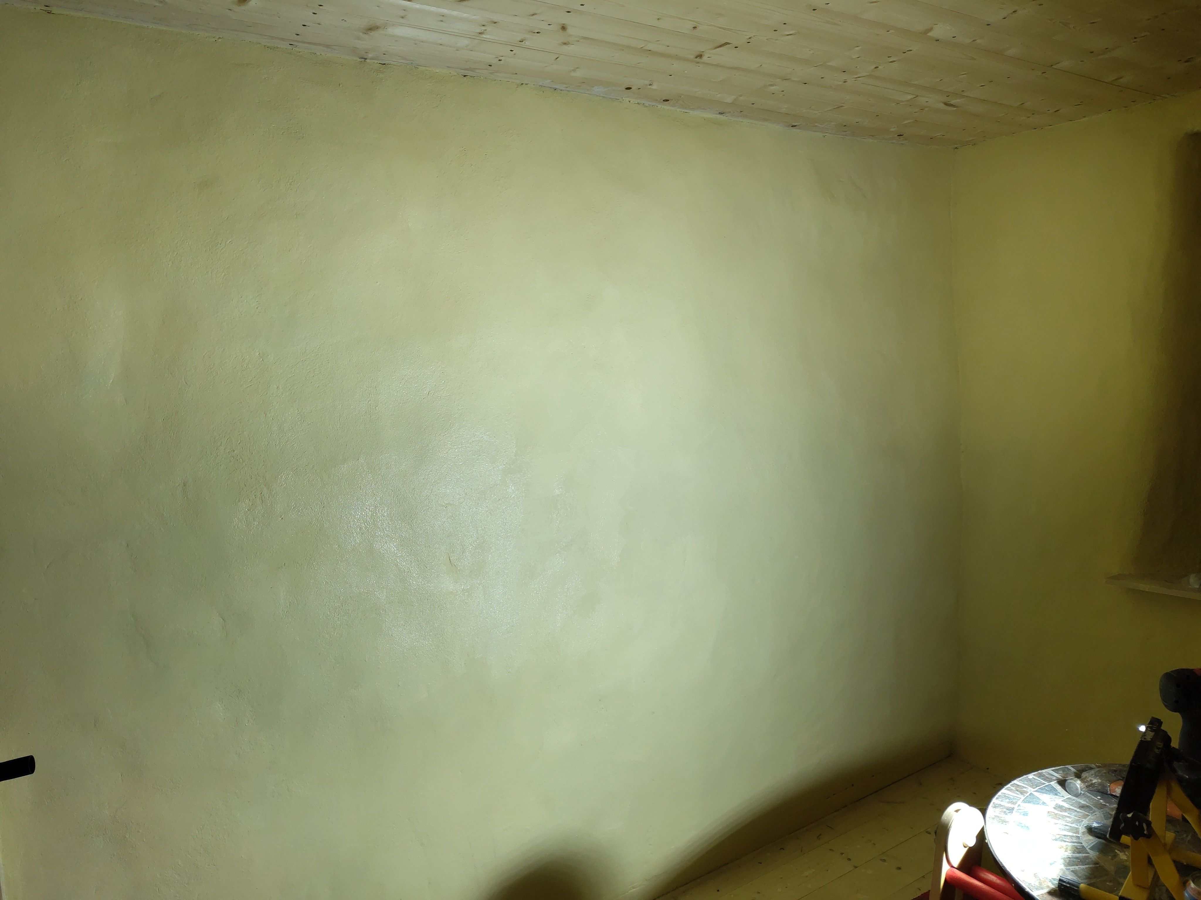

Managed to injure myself down at the allotment, so a bit delayed on the plastering indoors. Just finished now; it took 3 bags of lime and all the sand I had left. Phew. Now for a week of checking it several times a day for cracking.
Once it's had some time to cure, it'll get painted. I'm thinking whiteish silicate paint outside and earthborn "claypaint" inside - they have an offensively yellow shade which is reminiscent of the straw. Dunno if either will hide hairline cracks, or if I'll need to do something about any that show up first.
I still need to get doors on the unit, shelves in, oil all the wood and fit the services too, but that's everything that could be called construction finished.

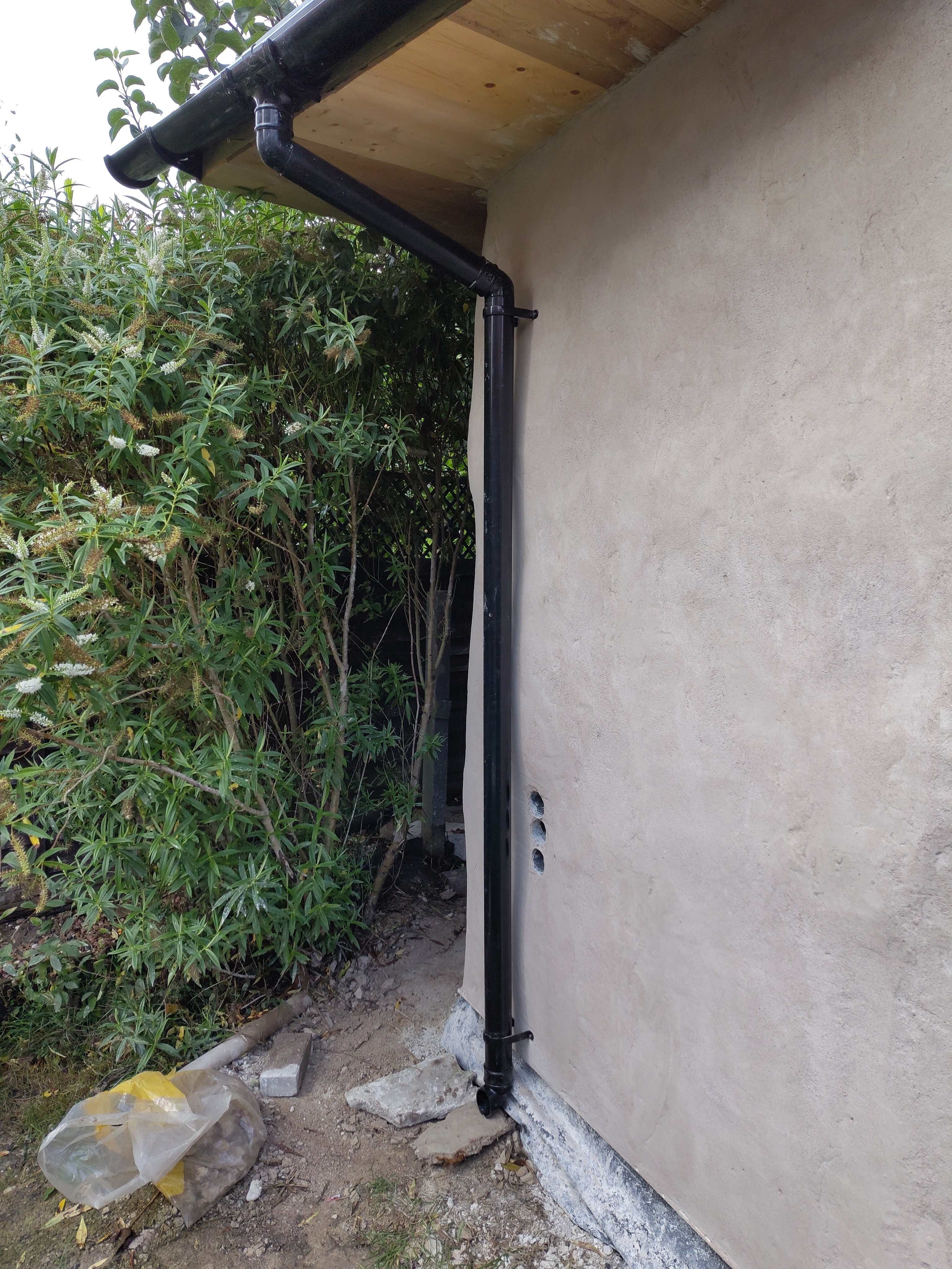

Downpipe installed. Not quite how I imagined it, but functional ^^

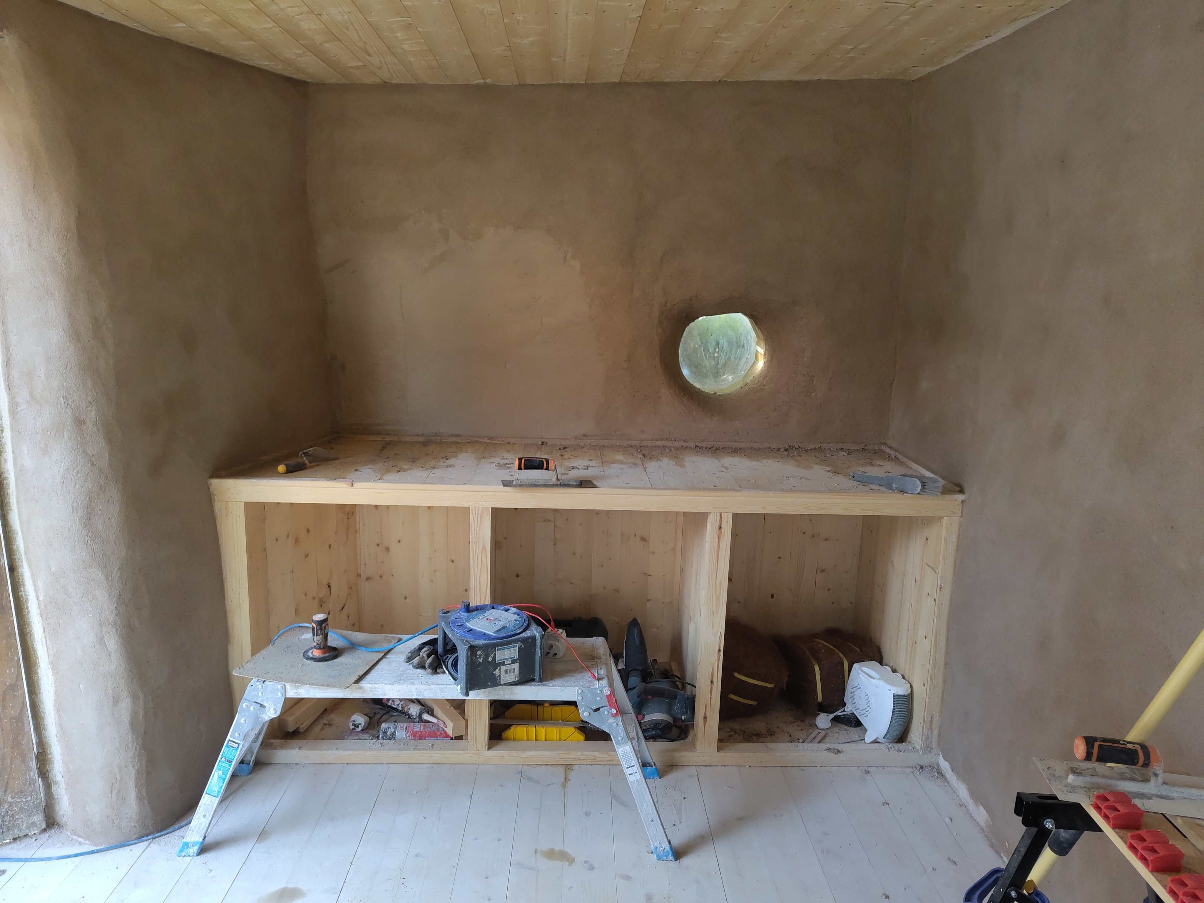

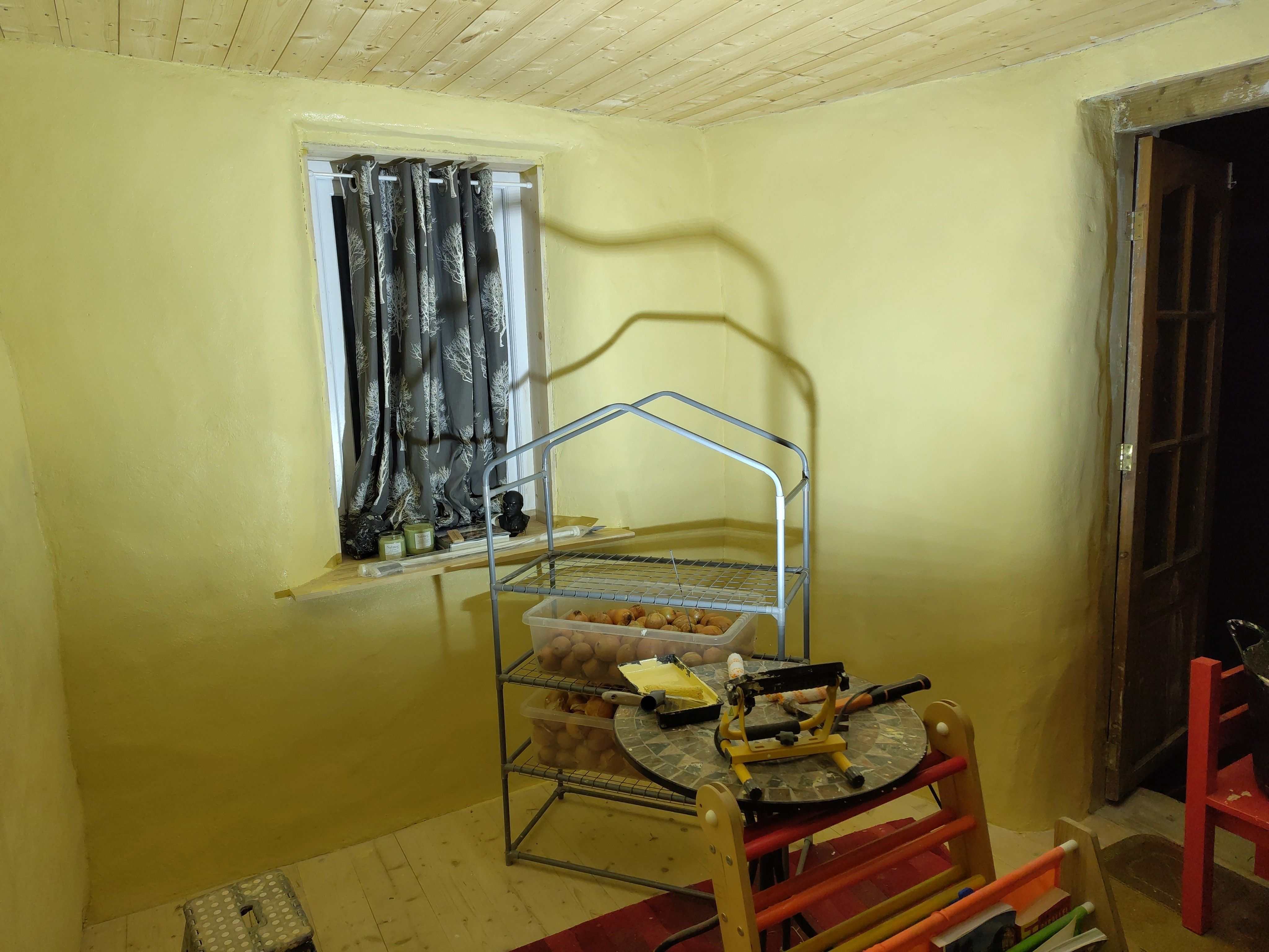

And the inside painted. So nice to wave goodbye to that horrible grey.
painted-east.thumb.jpg.bda172c77be4e08d26001d043089387a.jpgpainted-north.thumb.jpg.c34c8f2a6159f26d73c52e23ac083b0a.jpgpainted-west.thumb.jpg.cdb2e9cda69f1f92abe424c613971456.jpg
It needed to be vapour-permeable, and I went through a bunch of options. Ended up using "Farnovo", which comes as a powder you add water and pigment to - https://dpm-mashel.de/en/wandfarbe-farnovo.php. One 5kg bag + 40g "rusty sun" pigment was enough to do two coats with plenty left over - ~20sqm per coat - and it has hidden all manner of sins. That top coat of plaster ended up cracking a fair bit as it dried, but good luck spotting any. Expensive stuff though.
I looked at earthborn "claypaint" which comes wet, but they add some preservatives to it which seemed unnecessary and allergenic to boot. The mixing is very easy, I might go this way for painting inside the house too ^^.
I've also run some 4mm² SWA in conduit between garden room and garage - it's about 25M, going under the garden room, then the decking, then along a fence - but I've left it there for now and am poking electricians for quotes. Seems I can't just do it as a spur since it's an outbuilding - it needs to go from the consumer unit as its own circuit? Grumble grumble.

Powerrrrrrrr. I'll cut some holes through the worktop for easy access to the sockets once the doors are on , and get some shelving in.
