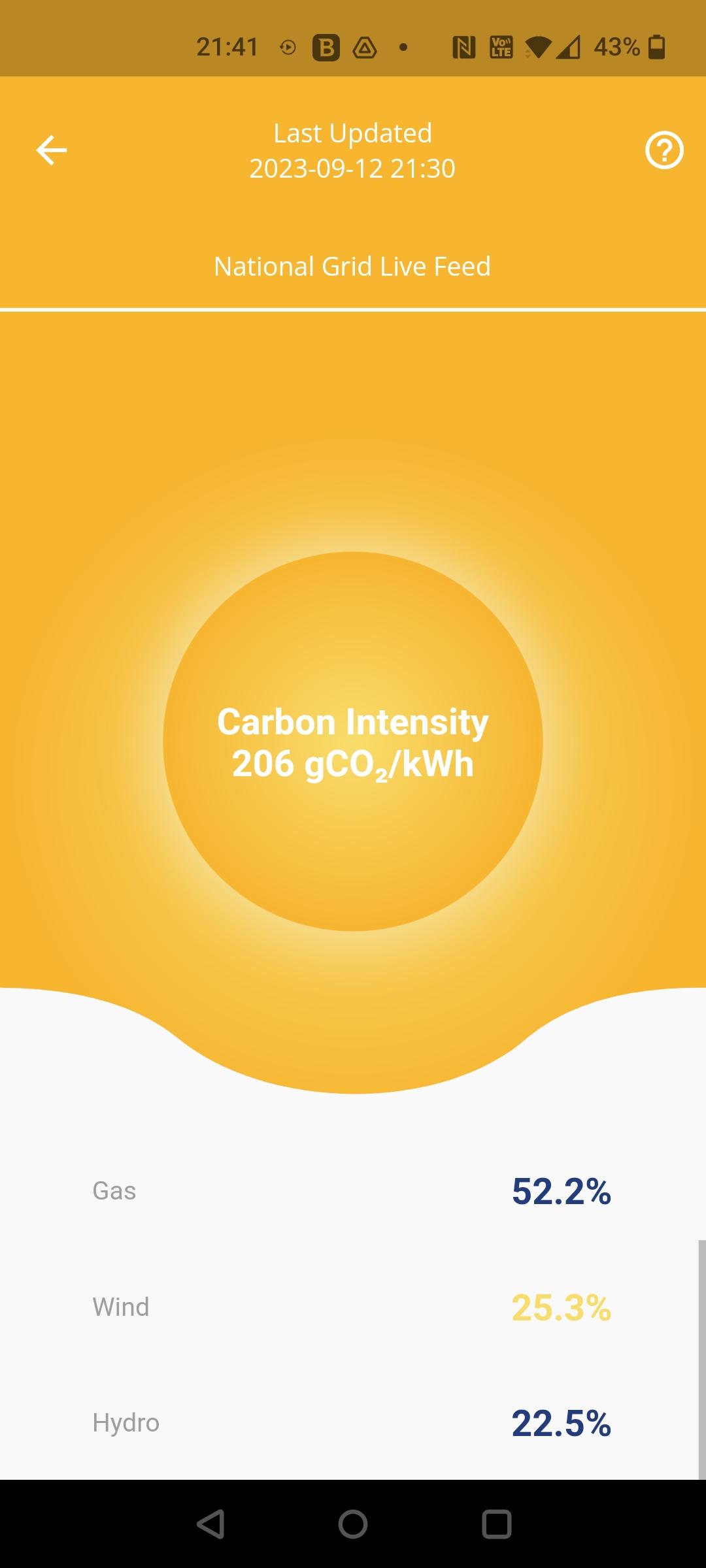

George Posted September 12, 2023 Posted September 12, 2023 On 12/09/2023 at 19:42, ProDave said: Anyone who claims a heat pump is cheaper to run than a gas boiler is a brave man. My view is an ASHP running with a COP of 3 and electricity at 3 times the cost per kWh of gas, the ASHP could equal the cost of heating with gas. So for a property that does not have gas, it is a way to equal the heating costs if you had gas available. An ASHP will be better for the environment eventually as more electricity is generated by renewable means. Re the heat loss from the building. How technical are you? How much do you know about the building design and proposed insulation (if's all buried in the SAP report if you have the full report not just the summary) Then have a look at this. Expand CO2 per kWh delivered is already a lot lower for ASHP, thanks to the '200%' of energy coming from the ambient air. Mains gas is probably cheaper for the next few years but that could change. In my calculations oil and LPG were more expensive, especially if you have solar panels/battery/smart tariffs.
JohnMo Posted September 12, 2023 Posted September 12, 2023 On 12/09/2023 at 20:18, George said: CO2 per kWh delivered is already a lot lower for ASHP, thanks to the '200%' of energy coming from the ambient air. Expand Current energy mix for my post code A modern A-rated gas boiler will emit 215 grams of CO2 per kWh of heat delivered. So on face values pretty similar, except the SCoP of a heat pump should be over 4, so CO2 emmisions a 1/4 of gas.
Lofty718 Posted September 12, 2023 Posted September 12, 2023 Most gas boilers aren't running at 100% efficiency, more like 80%
JohnMo Posted September 12, 2023 Posted September 12, 2023 On 12/09/2023 at 21:36, Lofty718 said: Most gas boilers aren't running at 100% efficiency, more like 80% Expand Same is true for a lot of heat pump installs they are not 400% efficient, but get rid of zones, run on weather compensation, no reason they shouldn't run at over 100% efficiency for gas and 400%+ for a heat pump.

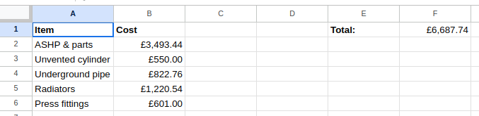

HughF Posted September 13, 2023 Posted September 13, 2023 (edited) My current costs to upgrade a 40yr old back boiler system... Still got to buy some copper, and some electrical items. Probably another £500... I'll probably use half those press fittings (I bought a job lot, I'll adjust the costs afterwards once I know what I used) Edited September 13, 2023 by HughF
